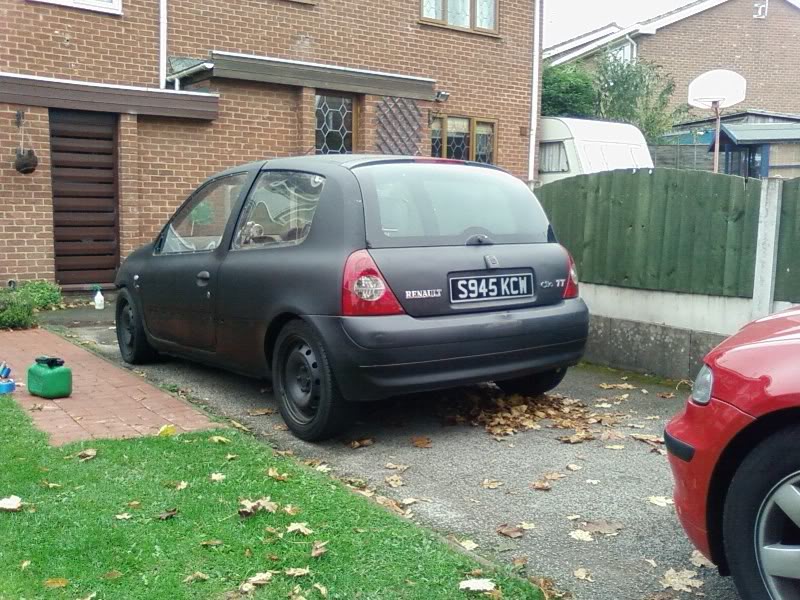

so the time come, i went and picked the **** up, OK she was looking ill to say the least but i had to have her- yes I'm a glutton for punishment!!
all loaded up and the journey started!!!...minus the windows!!!
i get it home, various arguments erupted, but i didn't care i could see the light!!
the car was home!! first jobs where to get the parts fitted that were missing for its mot IE mirrors, lights (or working lights) in that matter and also so perspex windows that weren't wafer thin and gonna shatter in my face!!

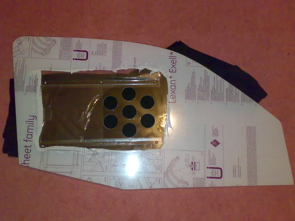

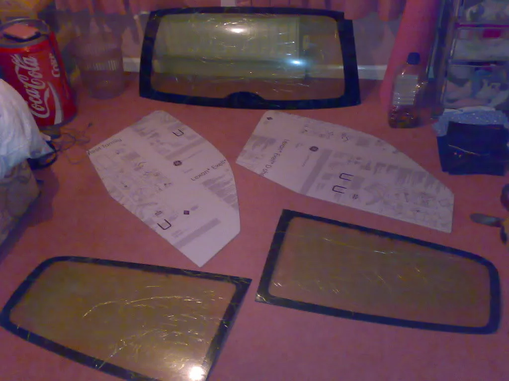

next on the agenda was the plastics4performance lexan window kit.....
they arrived....one problem....no slider,vent holes- so took to work to not normalise them as didn't want to die from petrol/exhaust fumes tbh!!

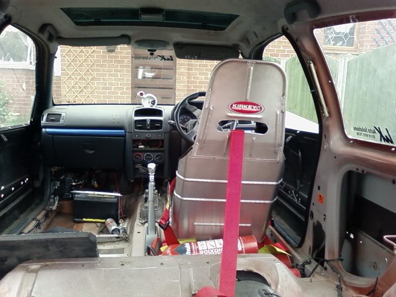

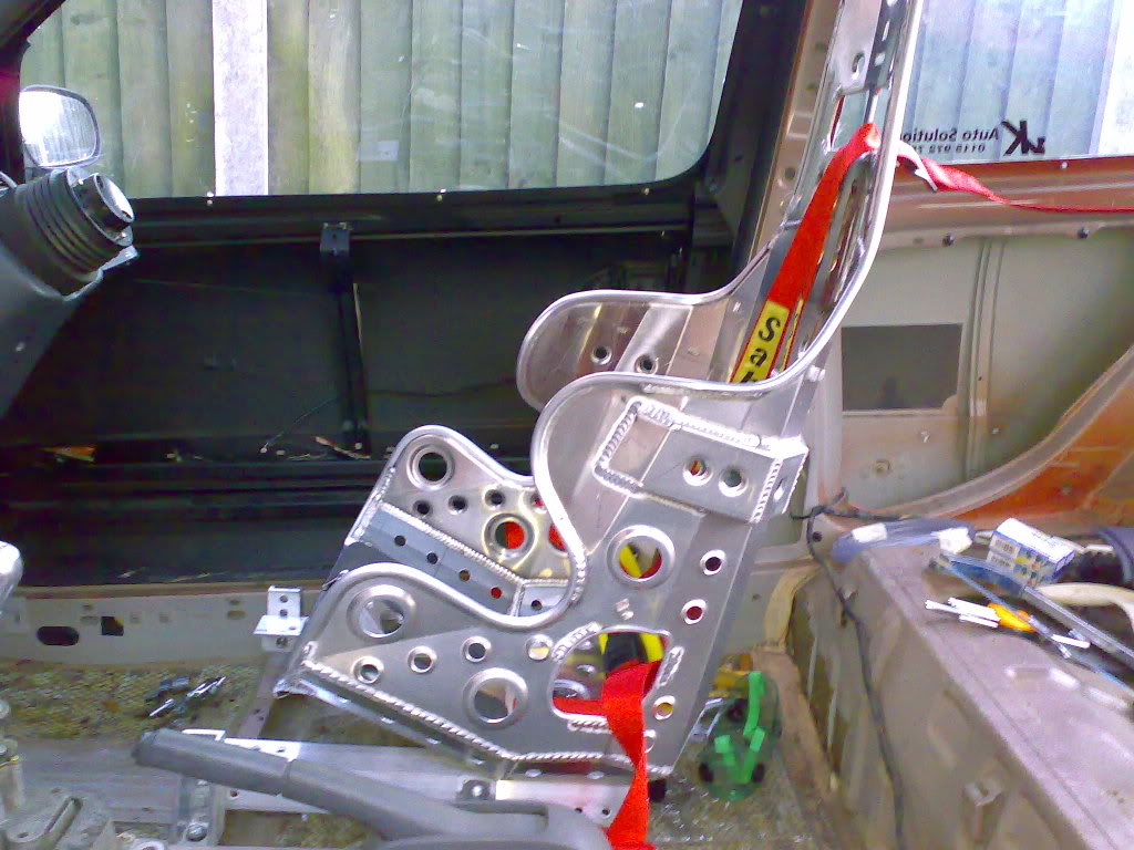

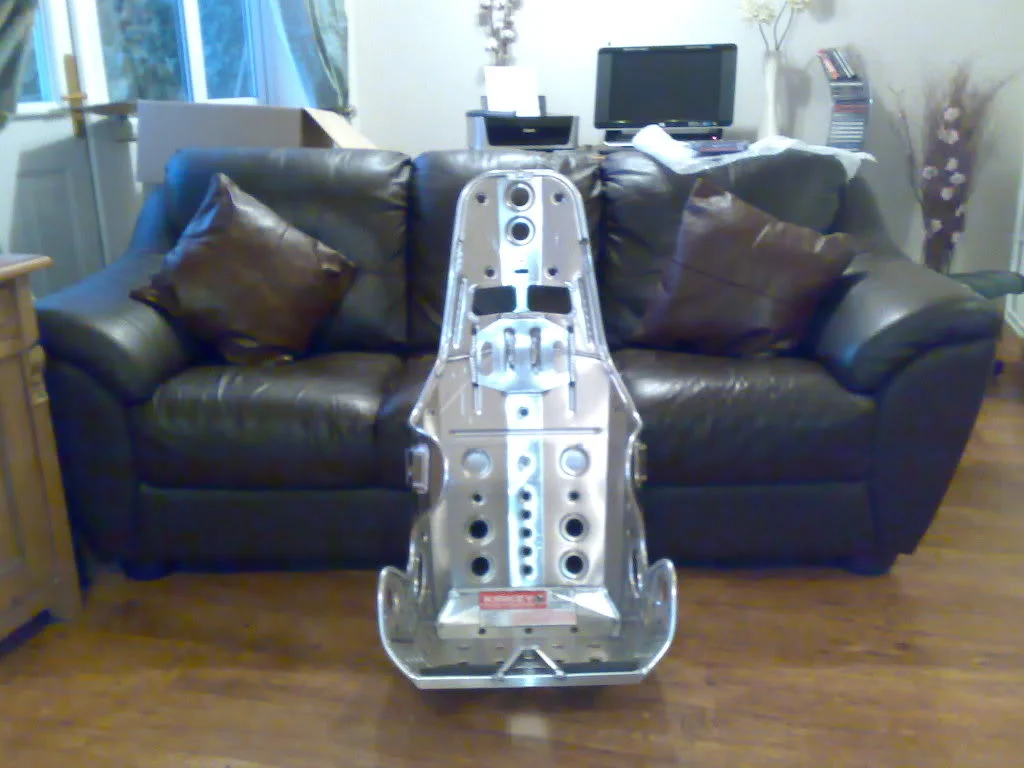

start of '08 saw a refreshed norm eager to get started again!!, first thing on the agenda was the seat!! the old one wasn't the best fitment and most supportive seat in the world!!...so scoff being scoff offered it a new home!!
old
supplied by my mate James at tweek's, the new item arrived....
few days later it was fitted....

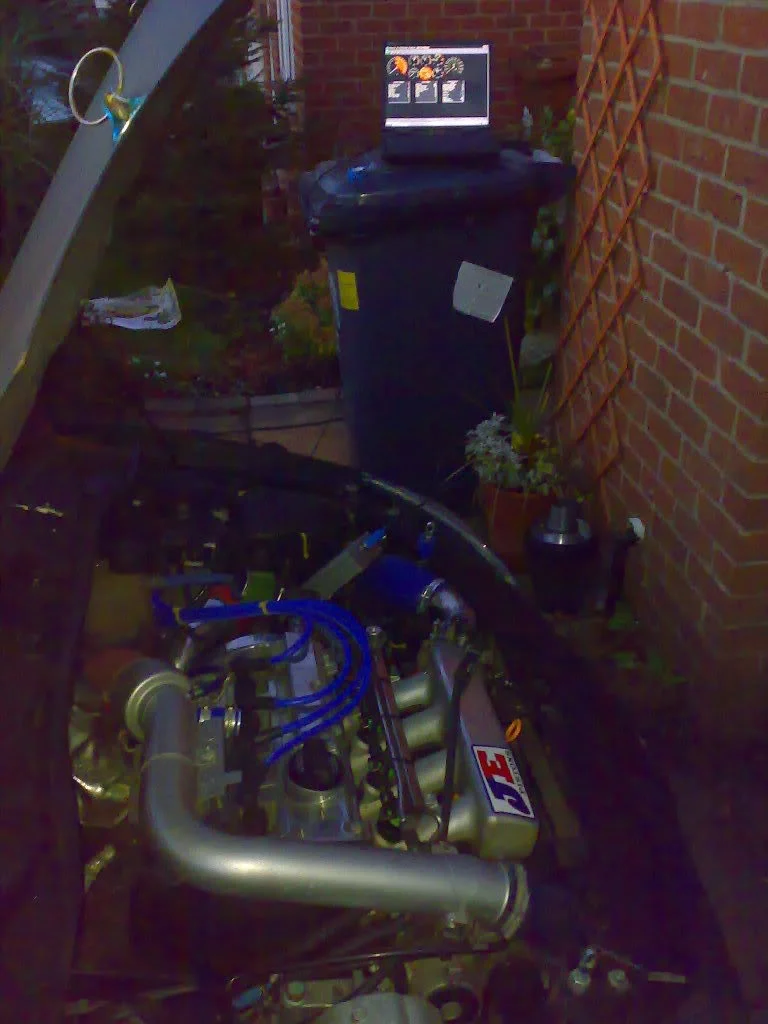

so mapping commenced, scoff spent up-teen hours mapping the start up map as this was just no existent when i bought the car, it was that bad to start the car we had to tip fuel down the inlet!!!.....no ideal to say the least!!!
so mapping commenced....

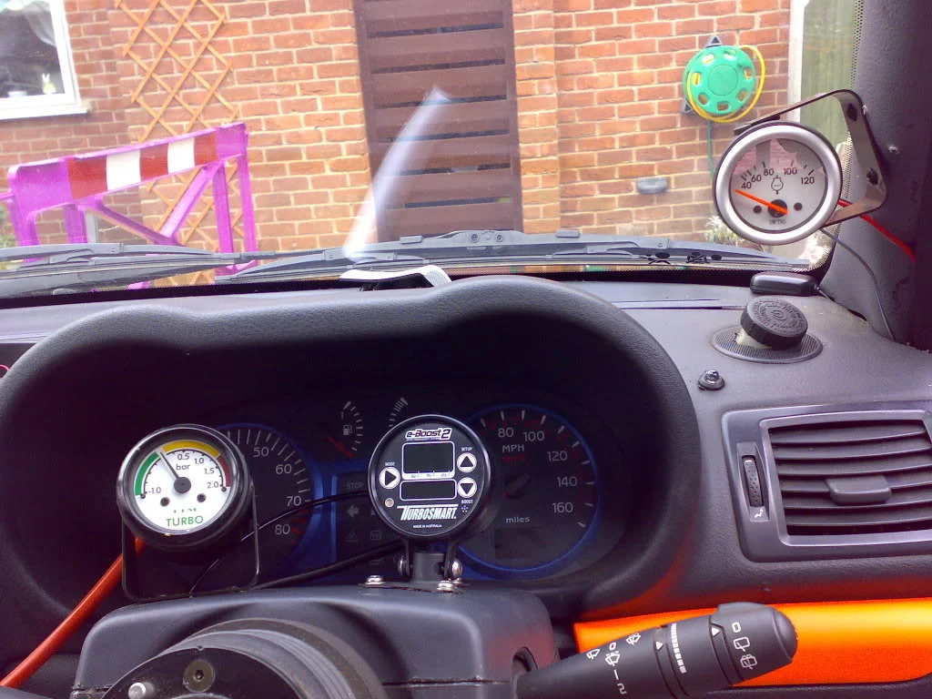

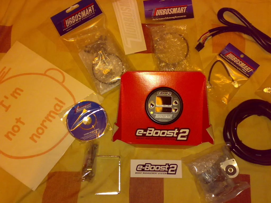

with the start map ''okay''....we fitted the new boost controllers....
that fitted the boost was ''preset''....oh and the dash strips were painted!!......

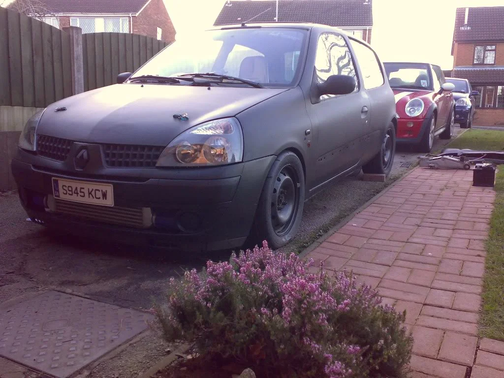

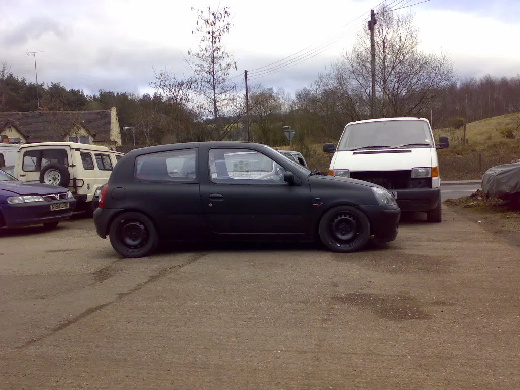

the IOM venture ended:(......but the TT building never!!! with all the mechanical side of things A1 i started on the tarting up side of things!!!

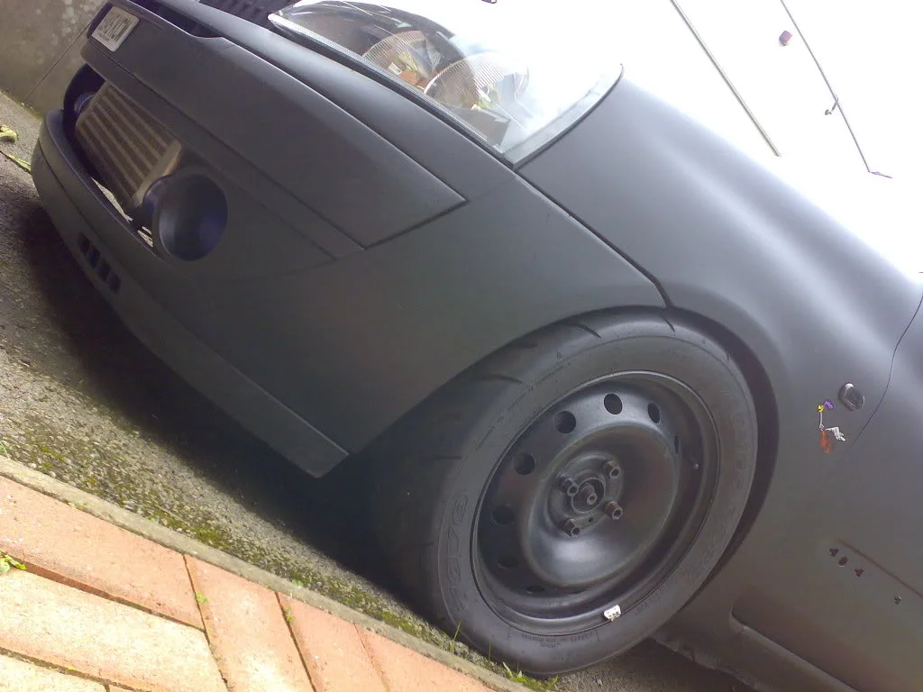

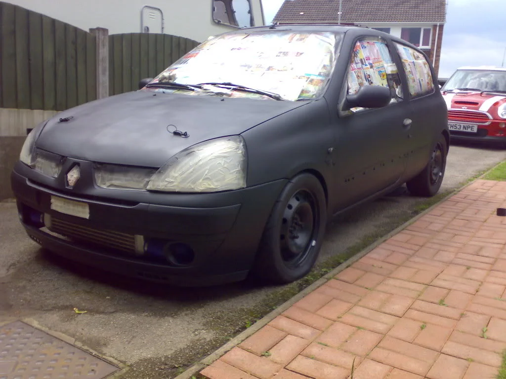

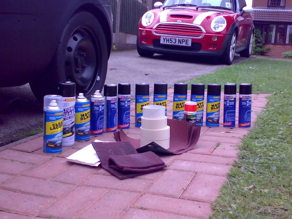

first of all i resprayed using the ''legendary'' rattle cans....
first of all masked up......
then went a raided my local factors for there paint....tankachooo
and result was mint...very happy TBH

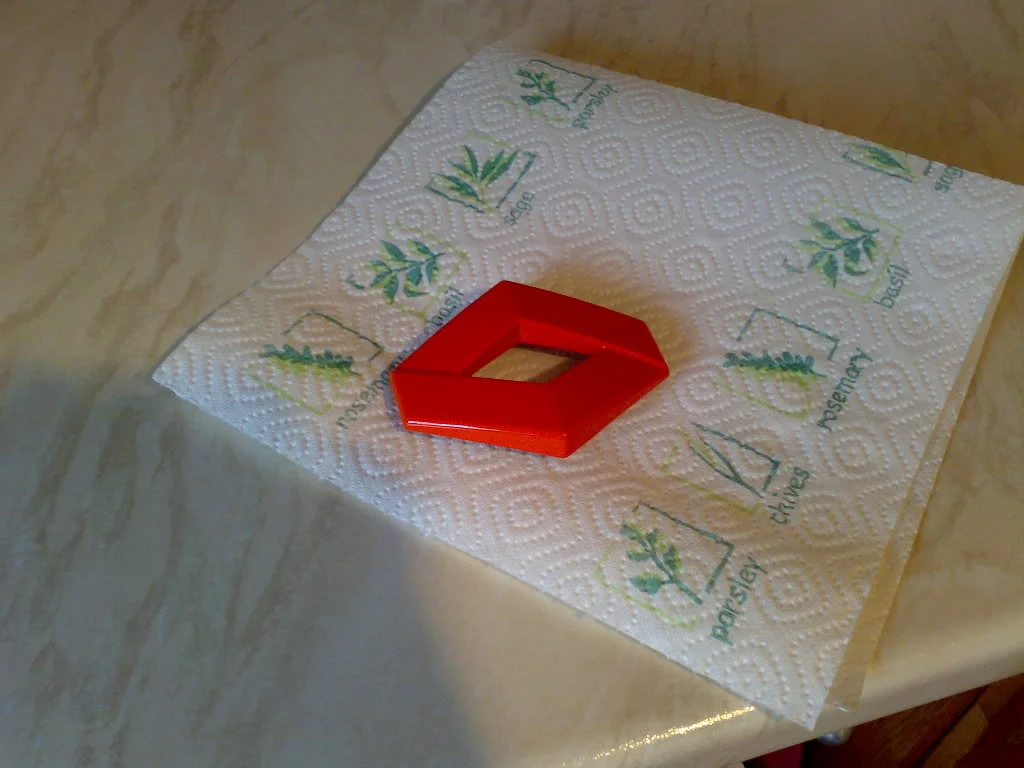

the car sprayed i bling'd the badge with the ''not normal'' orange..

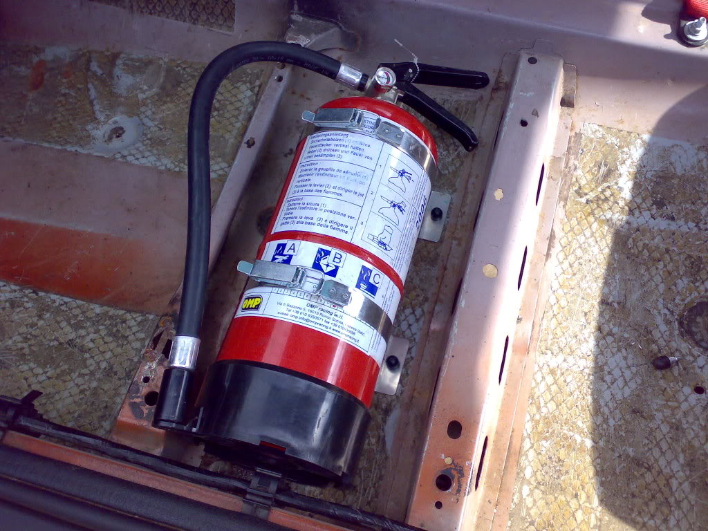

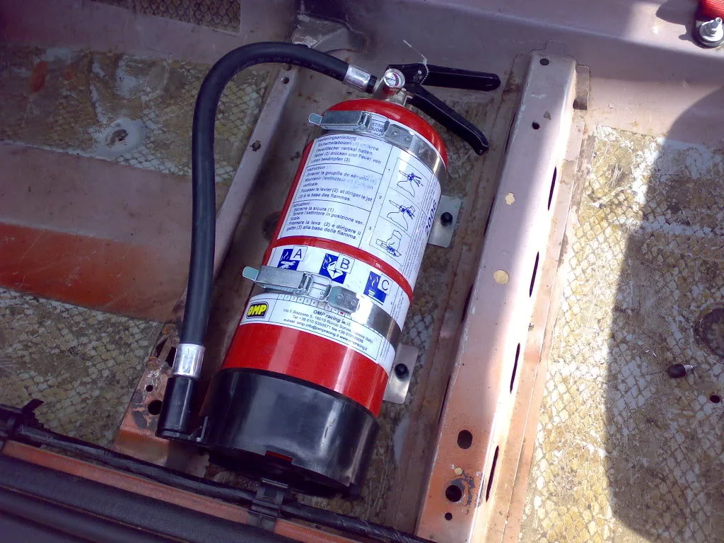

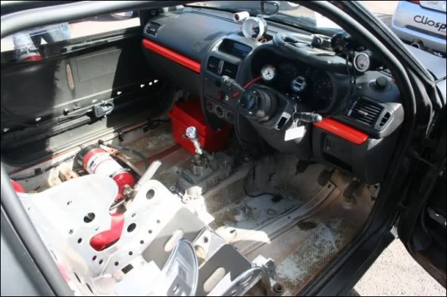

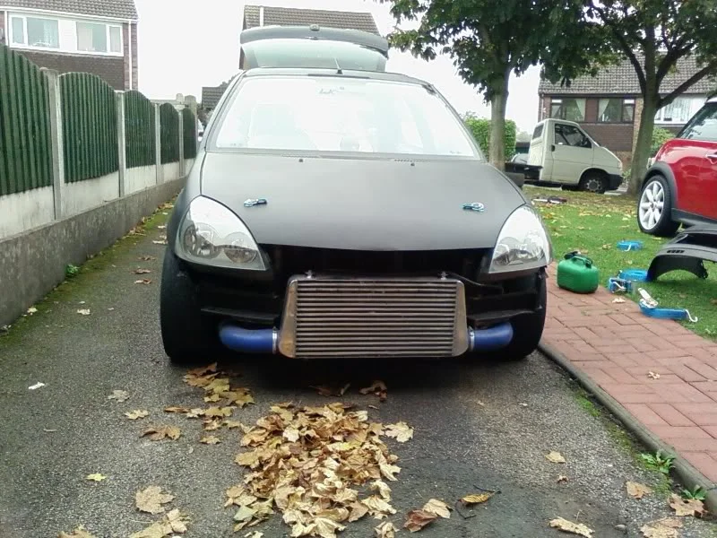

that picture brings me up to the last few weeks or so....i fitted the battery box, fire extinguisher and new main earth.....
battery box
that brings be up to last Saturday for FCS decided to paint the suspension turrets and generally clean the engine bay...

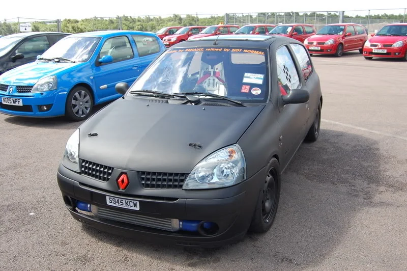

that done....i stickered it up and journeyed to FCS......

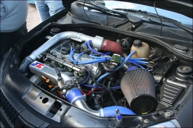

as for the engine spec its has follows
engine
1.8 20vt apy block (overbored to 1.9)
82.5mm JE forged pistons
scat forged rods
steel crank
headwork by high flow heads
shrick cams
jabba manifold
jabba inlets
hybrid vf34 (bigger internals)
3 core intercooler
dta e48 pro standalone
gttdi 6 spd box
atb differential
thats a basic list of the spec mate, got quite a bit more going on here to::)
