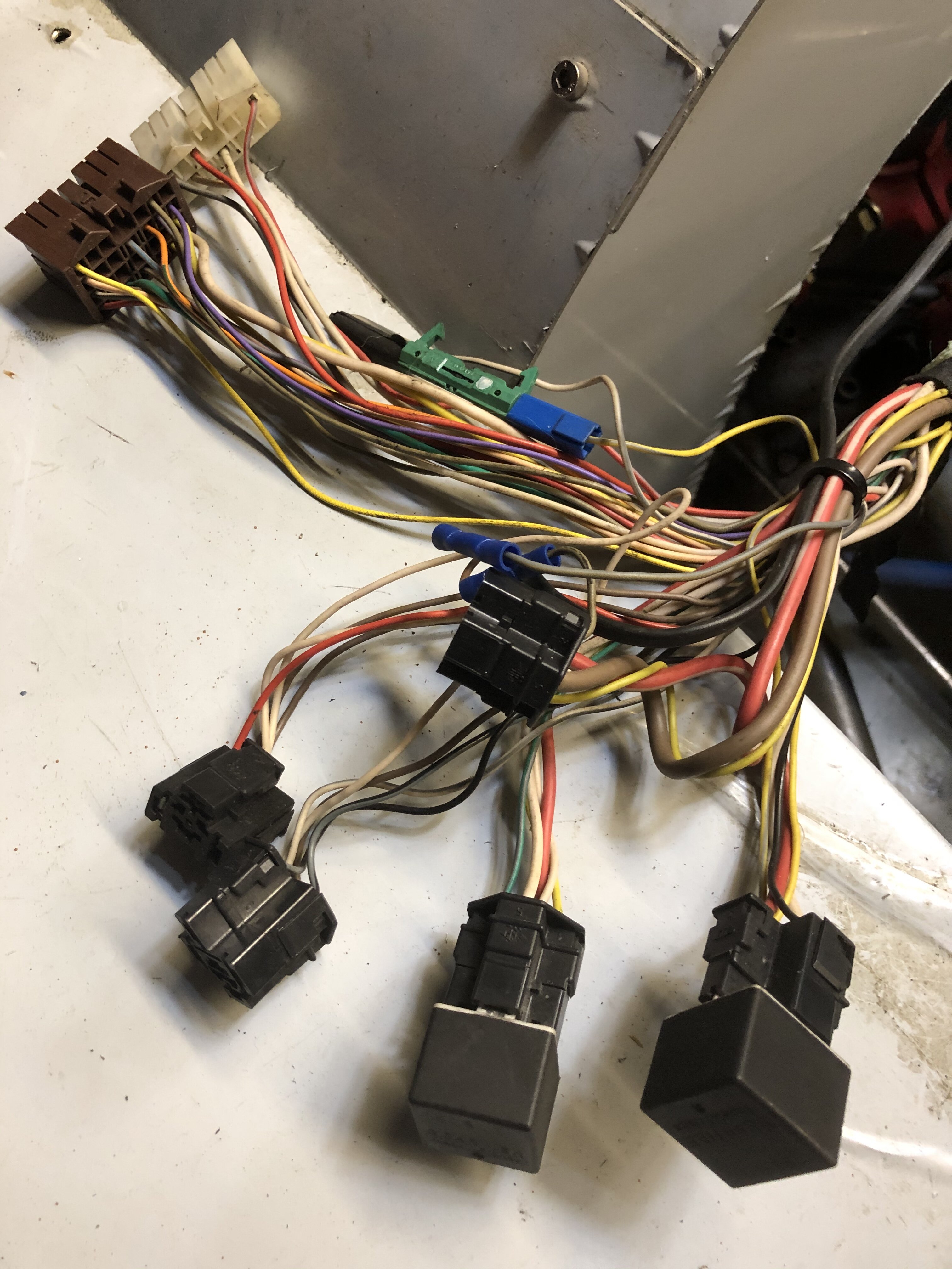

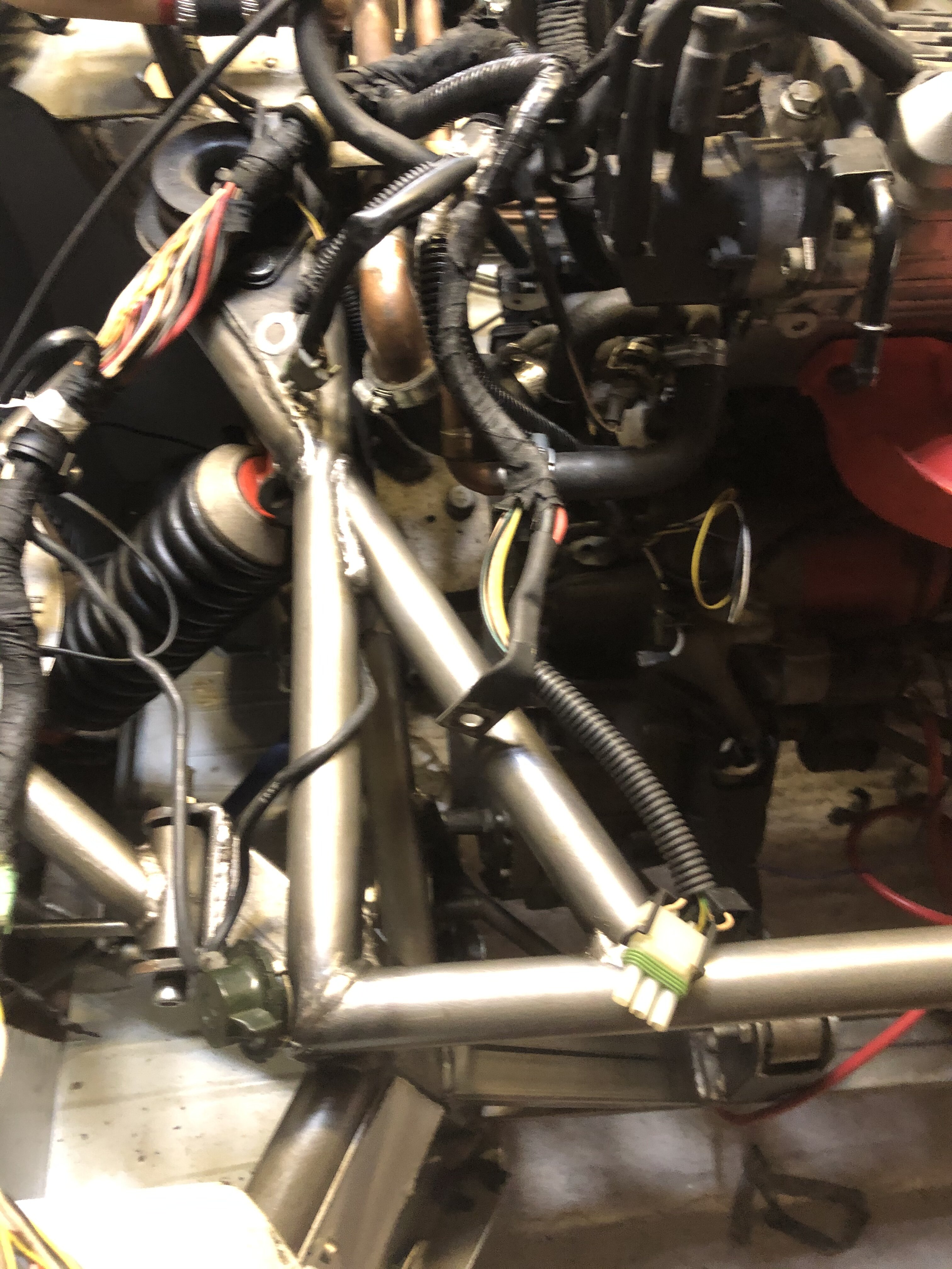

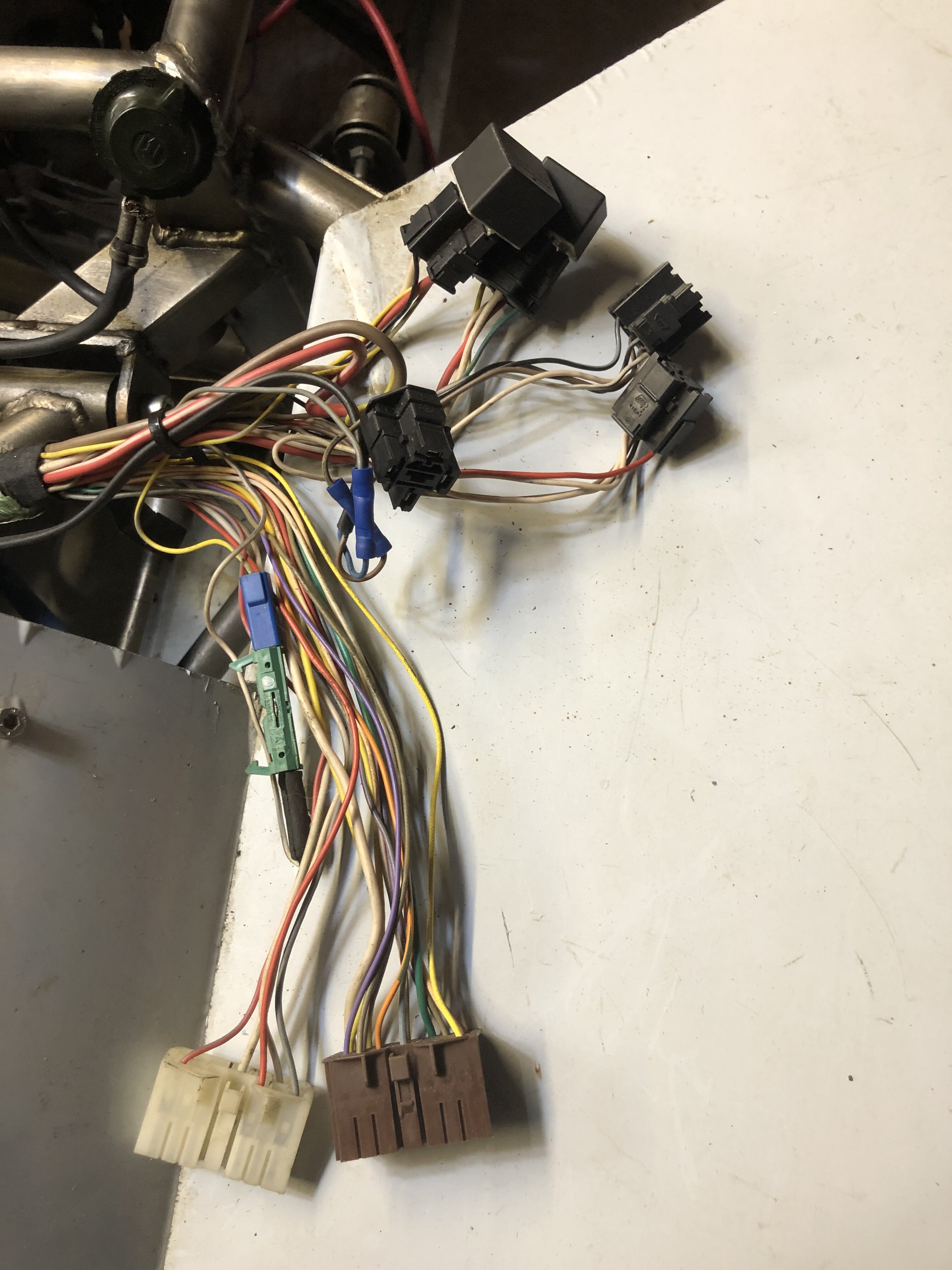

Thanks for the reply, I am not to sure( I have never touched these kind of engines before) is there a way to identify ph1 from ph2 , many thanks David.
These are the photos of the loom plugs etc as exiting the engine bay , hope this helps with identifying the loom ,the engine is fitted with an accelerator cable , not done by wire , many thanks David.
This loom looks like it’s off an early Renault going by the connections.
Pre 99 or there abouts.
