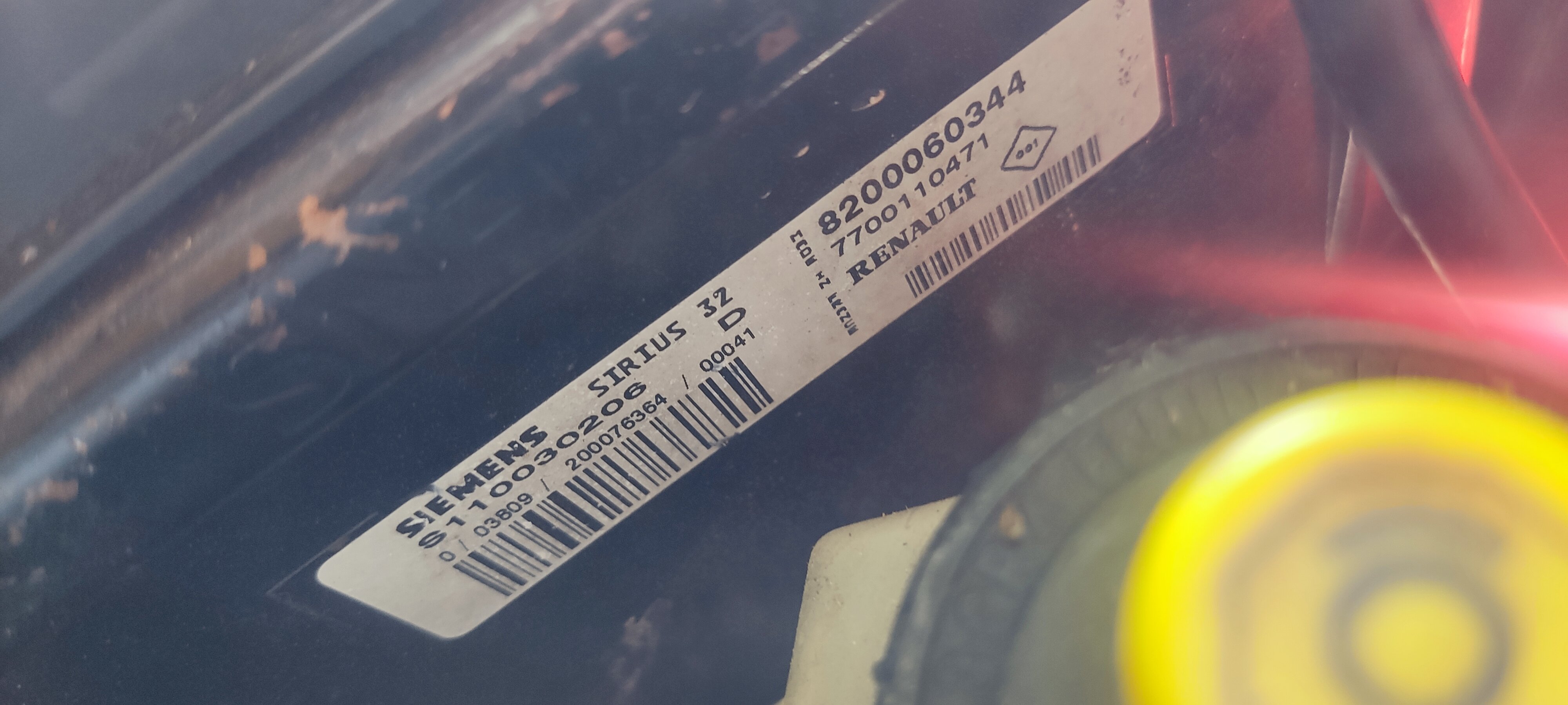

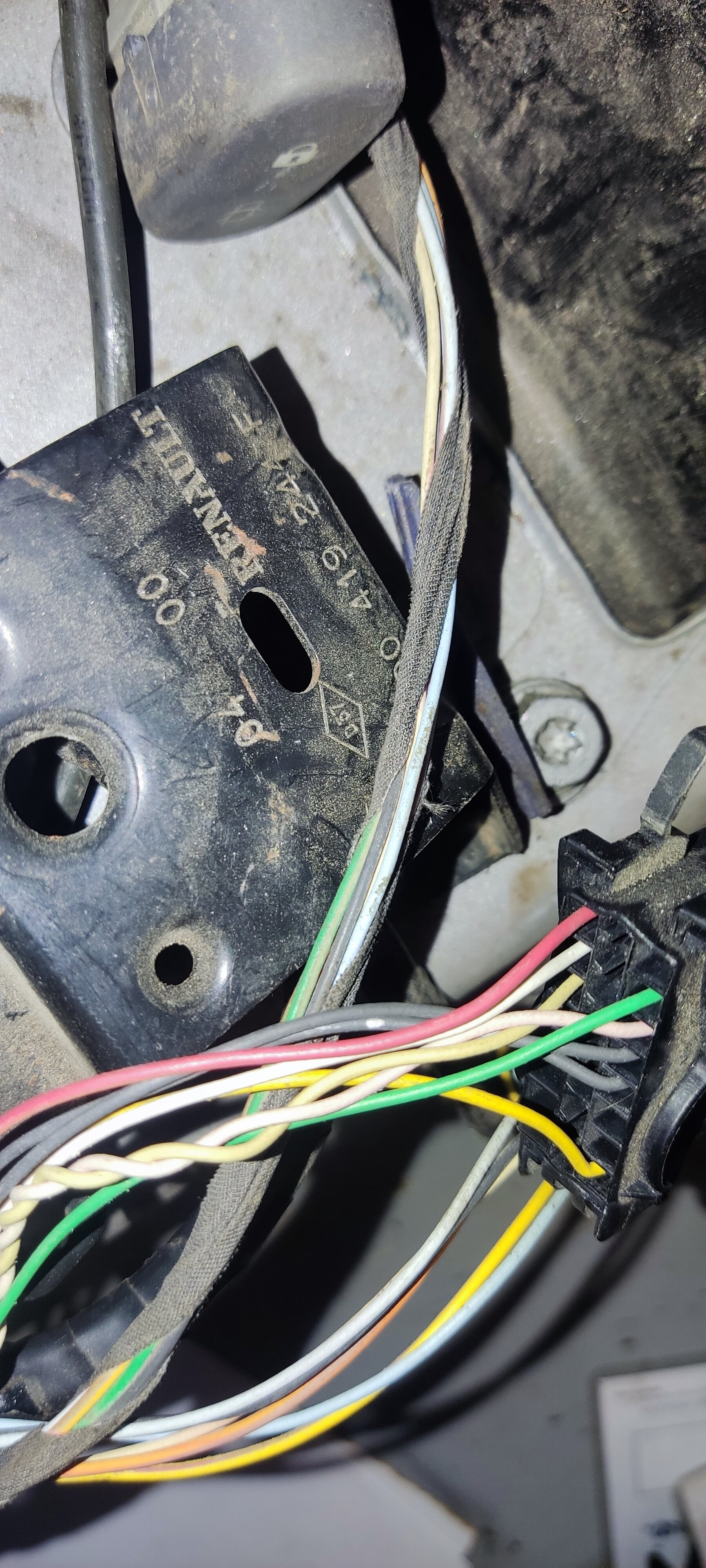

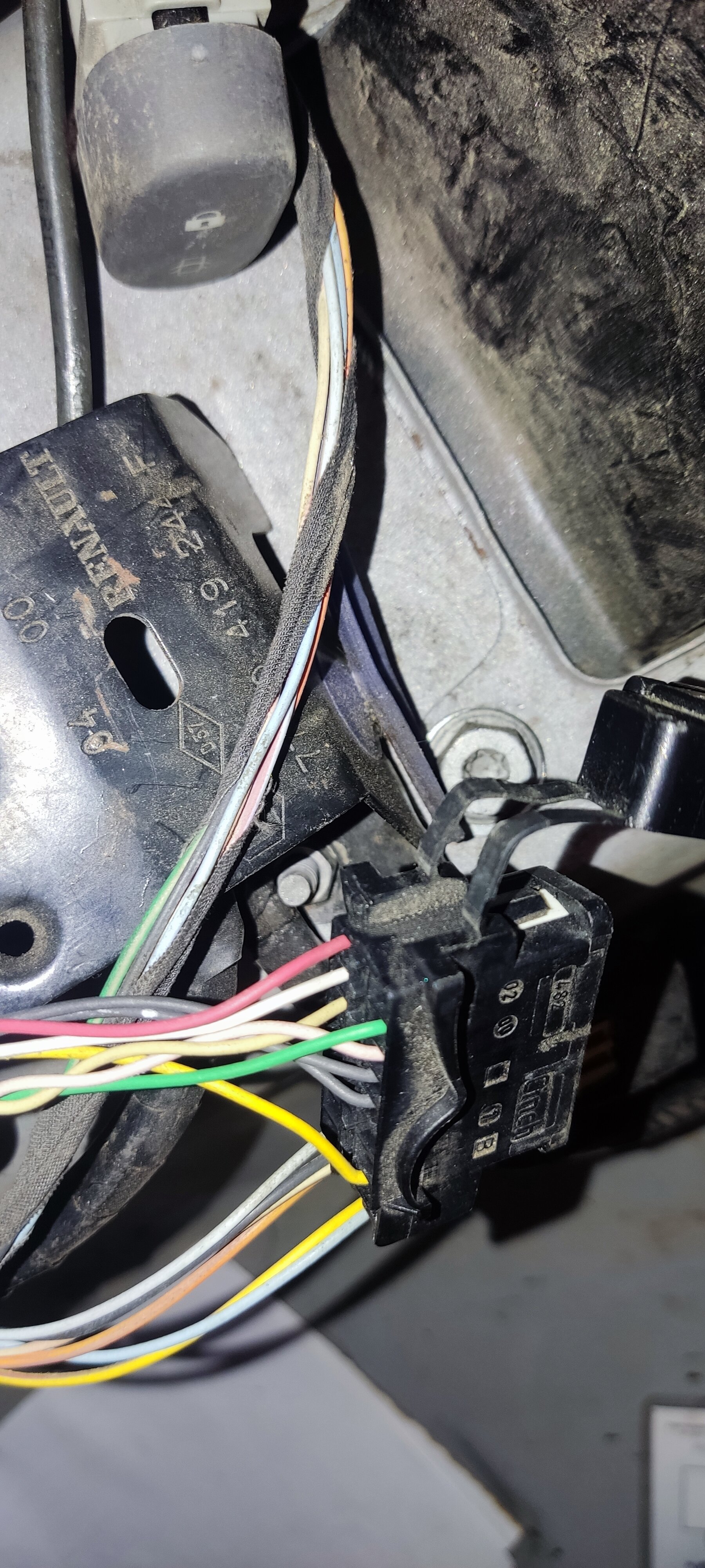

Hi guys,can you help me with no connection to the engine,immo is ok,diagnostic tool is can clip.I was trying another ecu,problem is same,fuse for radio,...is ok.Grounds,12v are ok.The yellow cable in my case pin 8,which should be kline was checked by multimeter in pin 28 on ecu,is ok.But other cables on obd I cant identify,so cant checked.I heard that I can use delphi ds150 when move obd pin 8 to pin 7,without results.

I did advice on checking the wiring as it has no comms to the ecu .
Couldn’t tell you if it’s a runner or not .
There was problem with one cable from obd to ecu.I dont know where is broken just tried use another cable and connect it to the pins.And I have different pinout like was written in fb or somewhere else.I dont know why,but obd 15pin is on 26 ecu and obd 7pin on 56 ecu😐.
Do you know if its possible connect Delphi Ds150 on this ecu sirius 32?of course its necessary re-pin obd?
