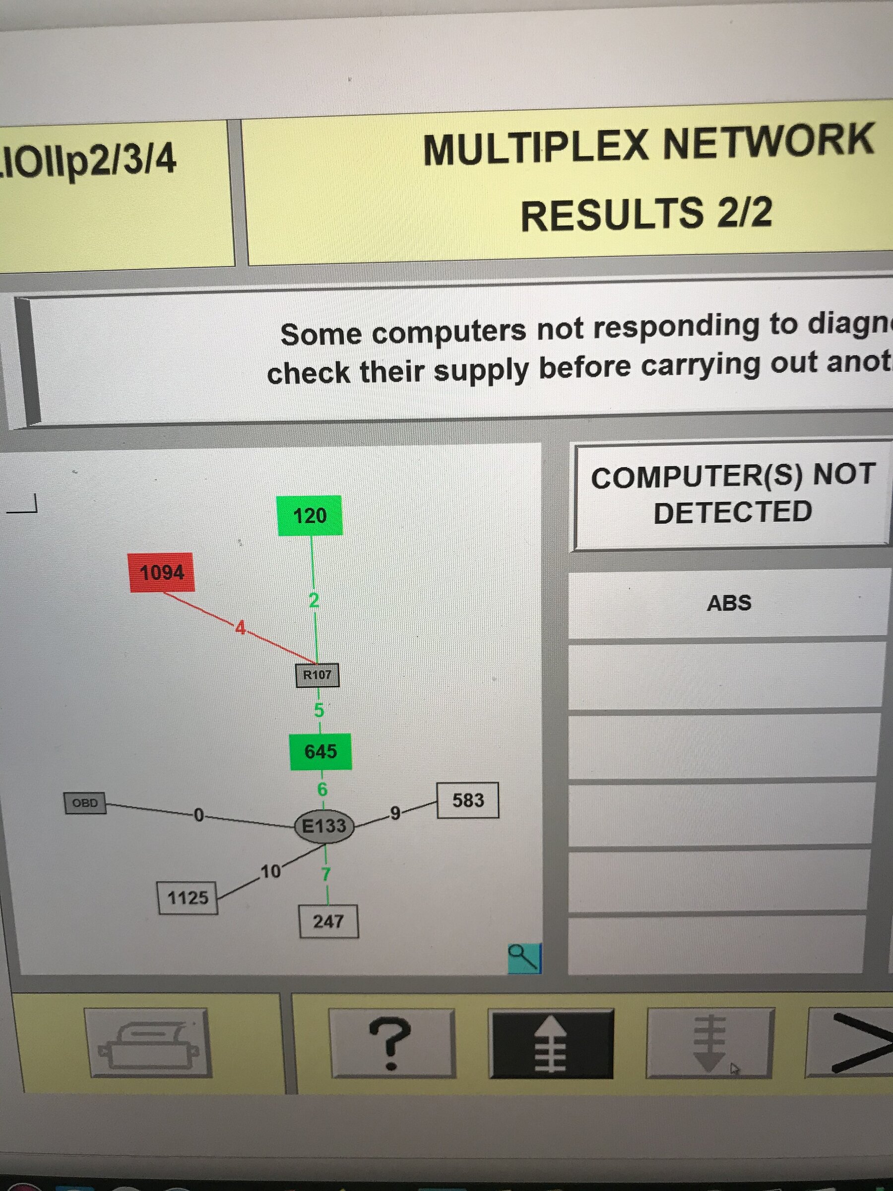

Clip not reading abs pump

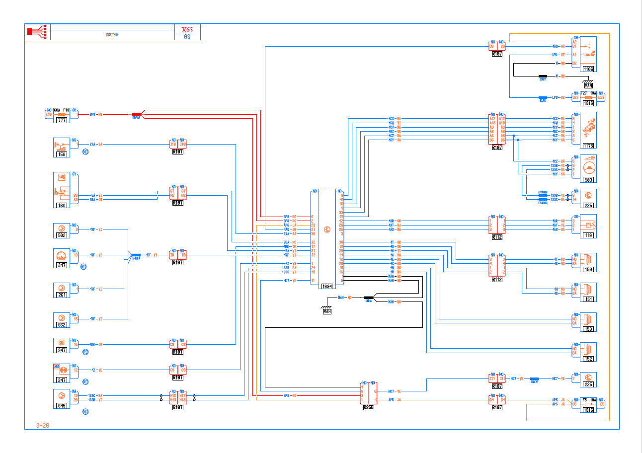

Trying to start bleeding (lines still dry) but want to check the system is ok first and it isn’t. This is the problem, am too dead to search for wiring diagrams right now if anyone knows about this or has easy access to the diagram?
