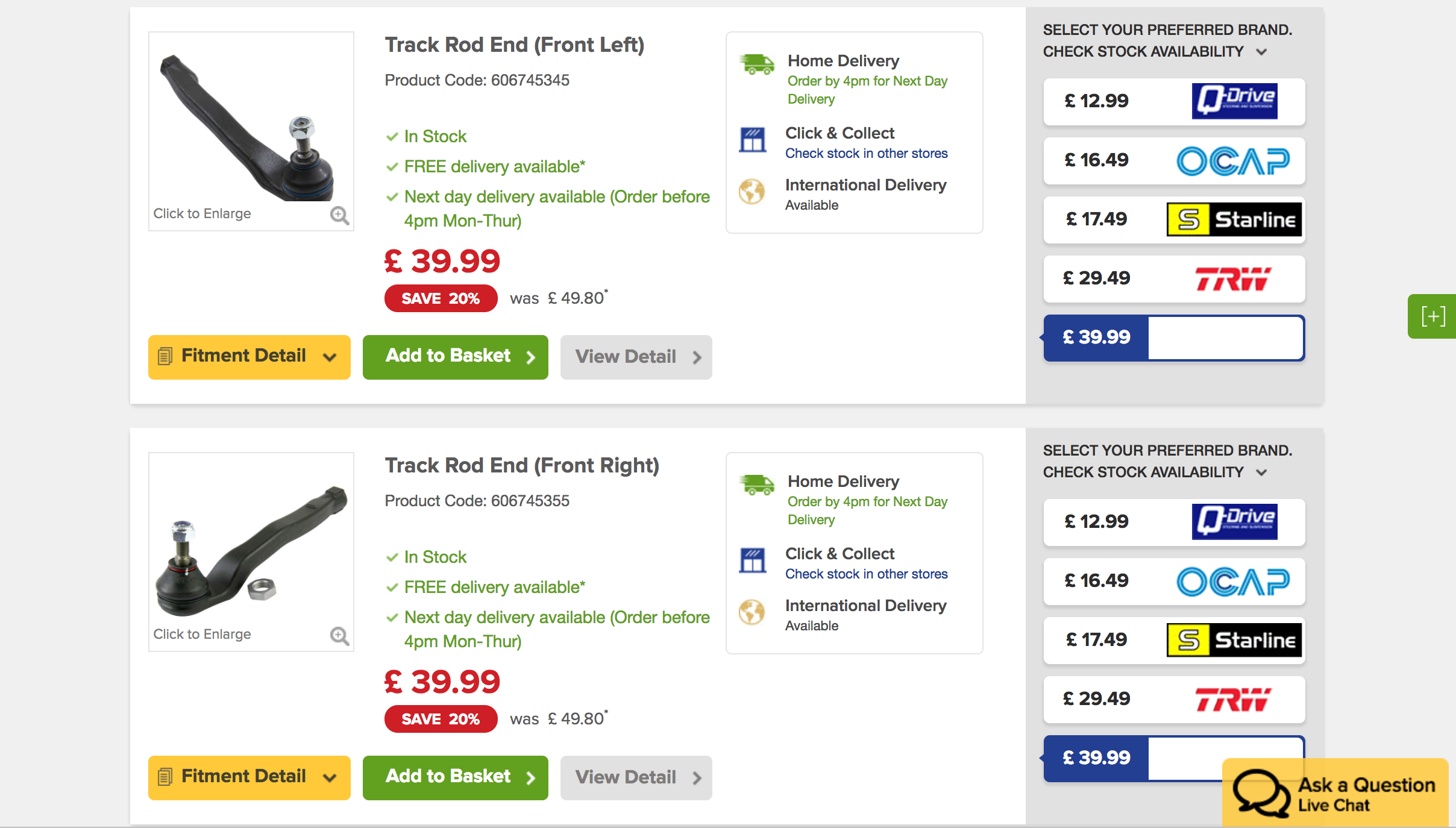

The tracking is now badly out, hoping it's just an alignment it needs. Just for a heads up, what other parts could I have damaged and may need to replace?
I'm thinking track rod end, Euro have a deal on but I'm not sure which is the best to get, don't want to just go on price. I'm thinking the £39.99 ones are OEM? Any advice would be great. Going to have it looked at this week before buying anything but want to be as prepared as possible.

Genuine rentault ends are only about 30 quid from renaultparts direct.
