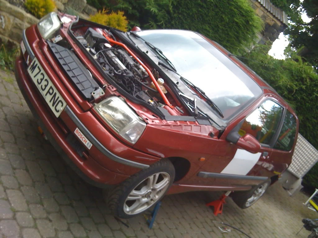

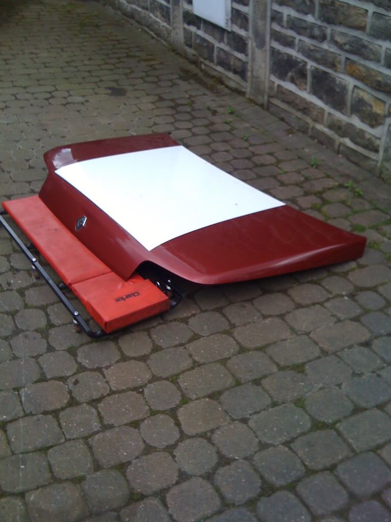

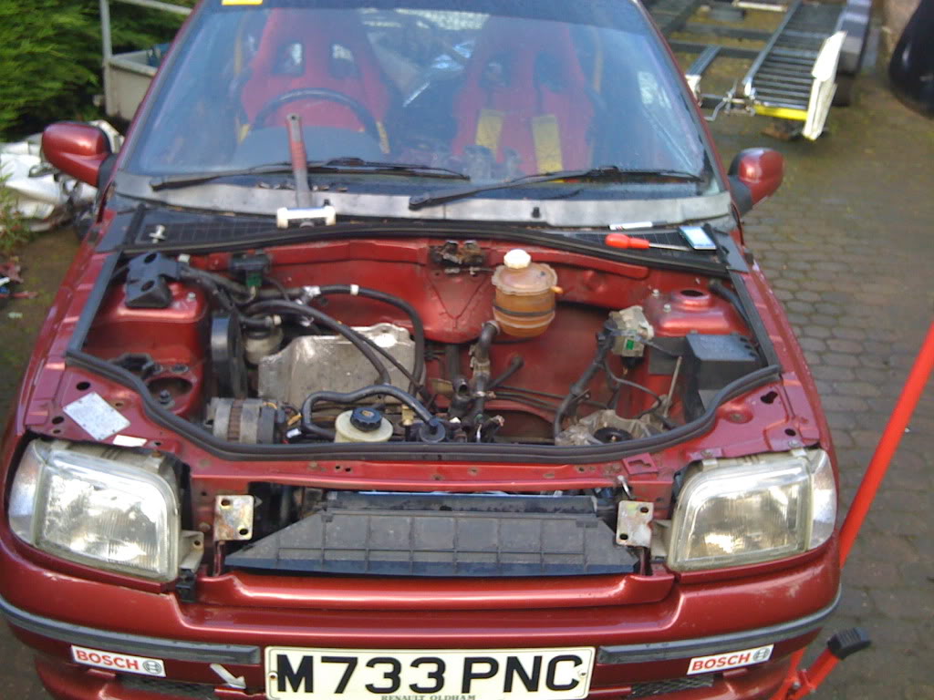

decided that while it was off road before its mot we decided to do a few odd jobs to him, first was a cambelt change, and full gasket change so to make things easier... the bonnet came off
which made things 100x better, so up the car went to sid on axel stands
off came the strut brace... which was a challenge in itself as the sus had to come off

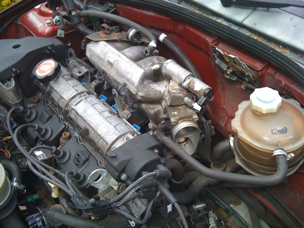

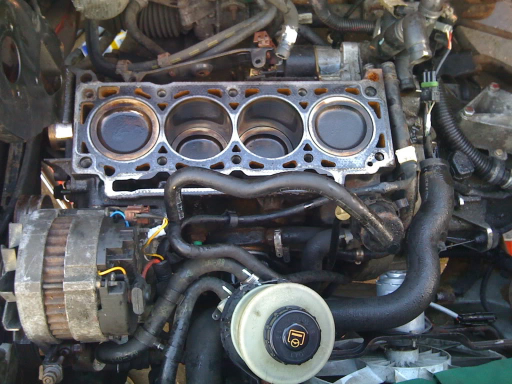

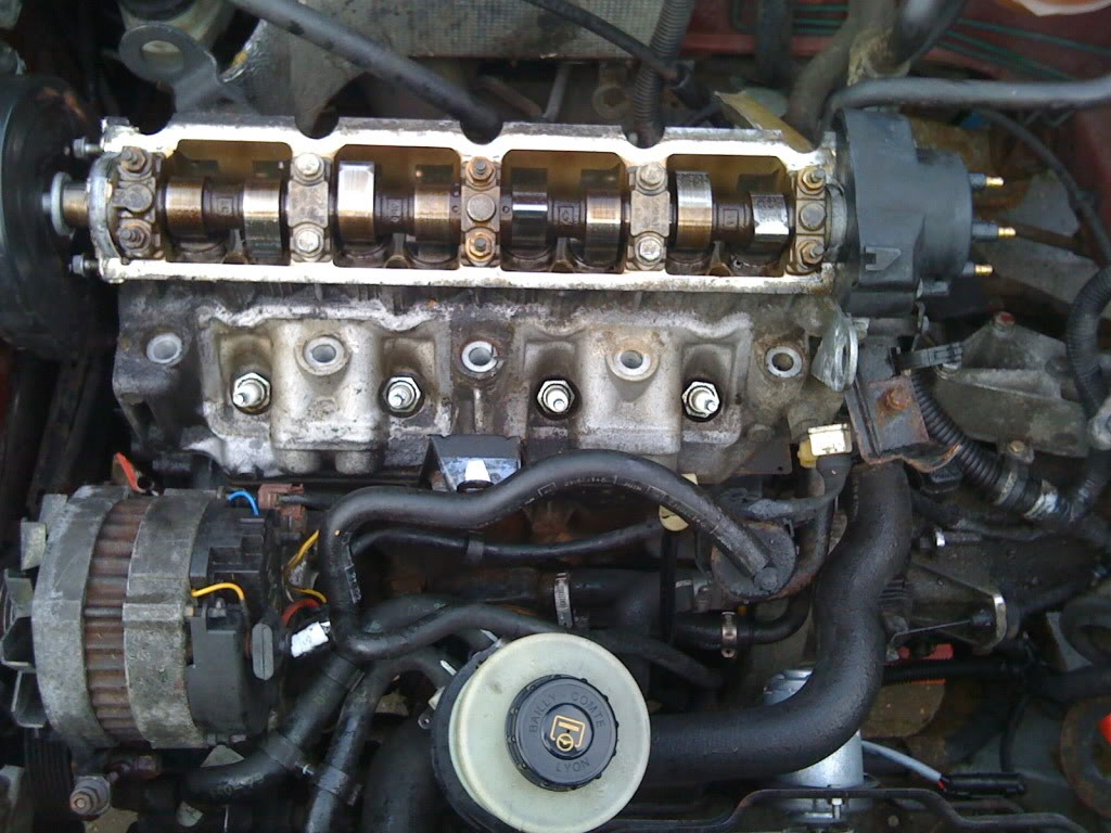

and then off came the rocker cover
ahhhh 8v single cam power
off came the head
everything went soooo easy, had the head skimmed, and cleaned up the block, which, suprisingly just cleaned up with a bit of elbow grease and a cloth

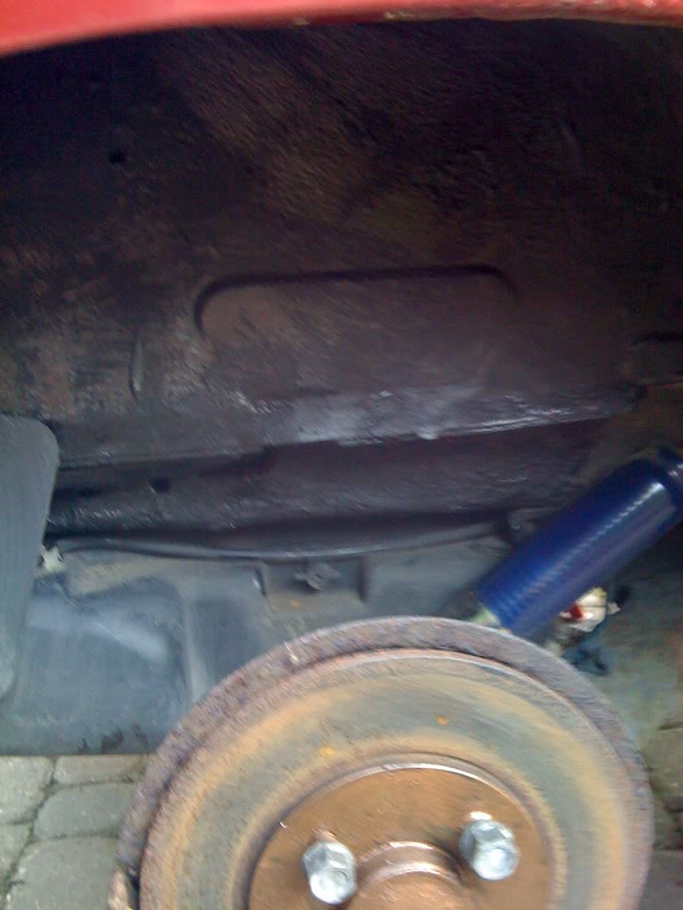

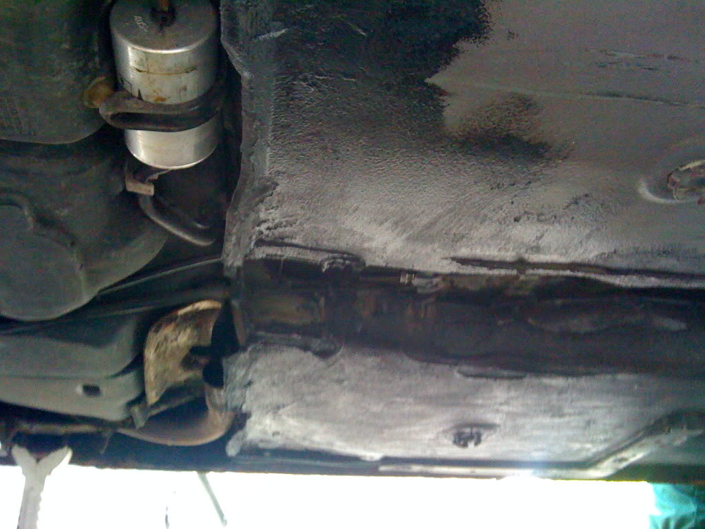

one the gaskets were done and the cambelt had been changed it was time to look at the underbody, was a bit tatty and messy, so we rubbed the whole lot down, and re-undersealed the WHOLE car looking boooootiful

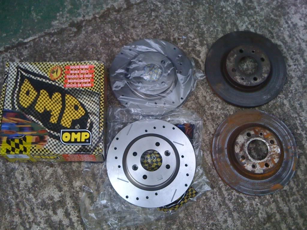

this took a few coats, and a few days, so afterwords, we thought a break upgrade was in order

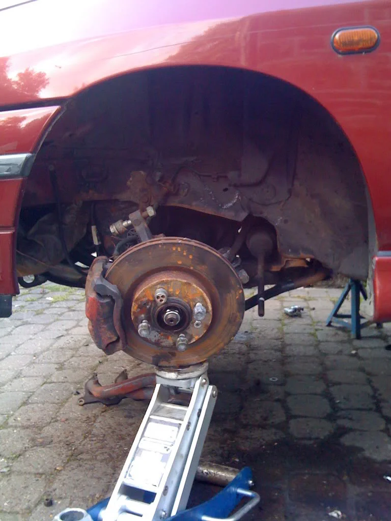

, the old ones (standard rsi brakes) just wernt looking the part...

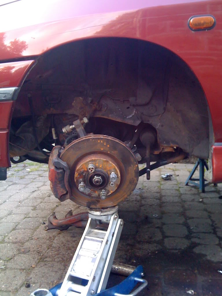

looked old, tatty and the whole arch just looked a mess... so decided to sort this out... but uh oh... problem...
has anyone tried to take a track rod end out of a 14/15 year old car?? trust me... it wasnt at all easy, after alot of hammering... heating... cutting... more hammering... we managed to do it
both sides were a pain, but the drivers side was just stupid... took around 2 days of messing about to get the track rod ends off
once everything was off, we undersealed all the arches of the car, just to protect them, and make them look nice

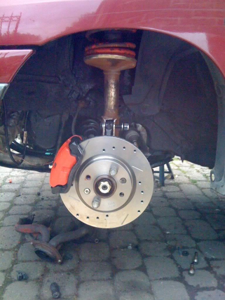

ooooooh goody, now to the new brakes YUMMMY!

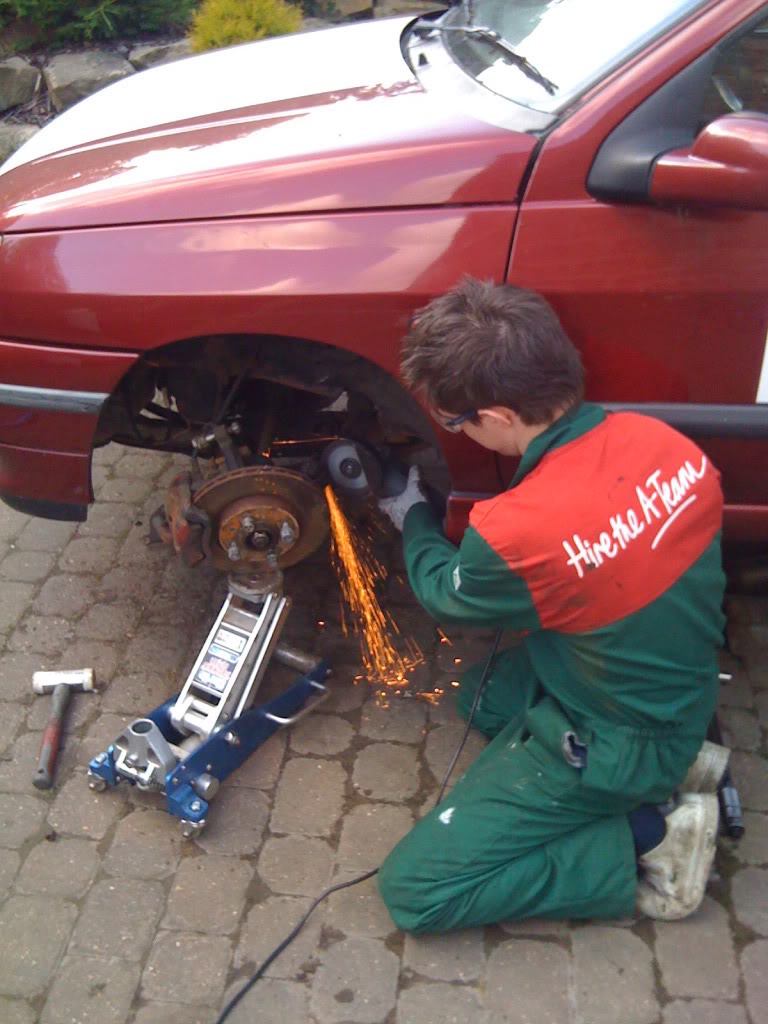

before these were put on, we decided we may aswell change the bearings... and holy christ!!! what a ball ache these were, to get the bearings out... we tried tapping them out with a hammer... this didnt work... so we tried hitting them out with a lump hammer... this didnt work either.... Mmmm wondered for a bit, and decided to take the hubs to my mates work to use his 5tonne hand press ... but the smile soon turned to
even with the 5 tonne press... the bearings would not budge, it pretty much just started to flex the hub :O so we stopped!! god damnit... time to use the big gun... the grinder, been careful we finally managed to get the bearing out, thank f**K!!!! okay, new bearings in piece of piss put hubs in the oven on high heat for 20 minutes, took them out... new bearings just dropped straight in ohh joy
