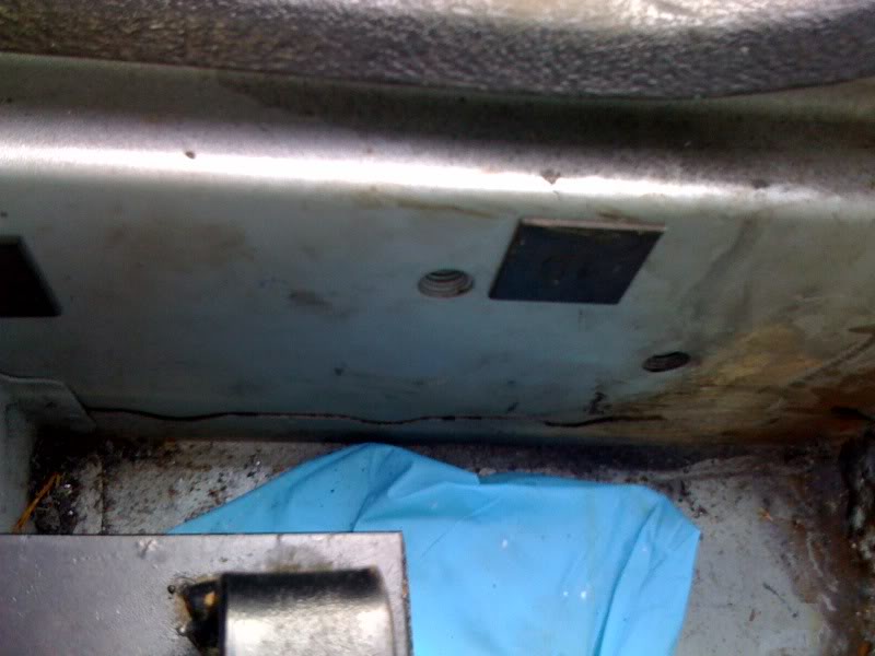

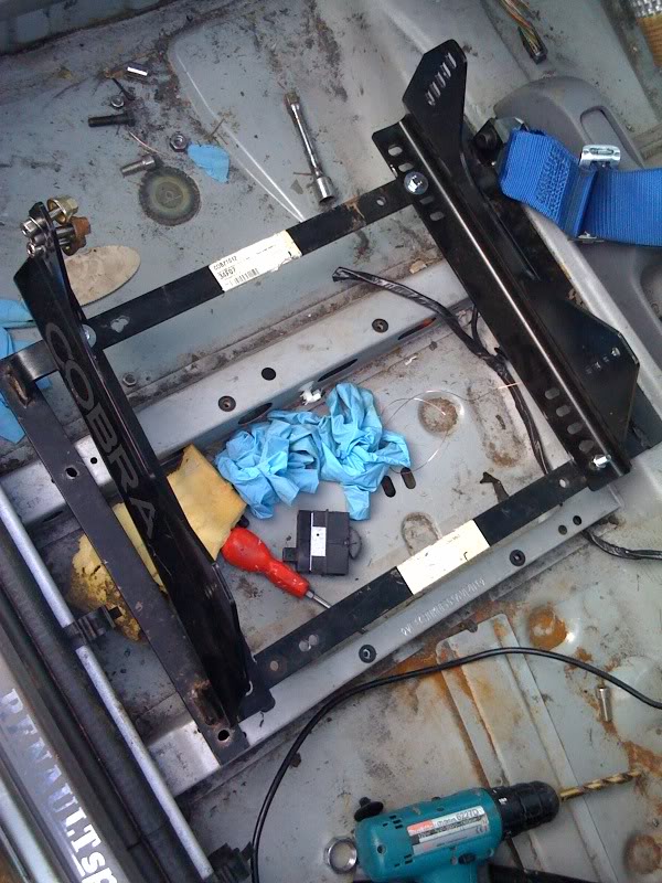

I agree safety is paramount but to be honest there are other parts of the mounting system that are as weak as the subframe using only 4 bolts to the floor, the four bolts that locate the sliders to the subframe (my nuts were flush so nothing to be gained by fitted bigger bolts or removing the spaces, I did check having read about previous problems) or the sliders to the seat would therefore be the weakest link if that side mount is used to the chassis, the standard seat is mounted with 4 bolts so I'm some what confused why Cobra felt the need to add addional support on the side.
Be great to see that side mount being utilised or a pic of the inner sill. Might pop the plastic cover off and have a look (thankfully my car's not used during the week so should this mount be essential I'm not risking anything by not having it bolted yet).

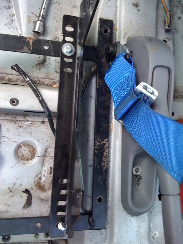

i personally dont think that the outer lug is designed to bolt to inner sill, but if there is a hole behind there that lines up with that lug, then i presume you could screw a harness eyelet through the frame and into the sill?
  Clio 172 Cup
Not sure about putting the harness eye through the lug and into the sill, not usually that much thread on those eyes to get through the 1/4" plate on the lug and into the sill I wouldn't think but who knows. The only other thing I can think is that the seat mounts to the floor are quite offset so it does mean the rear frame mount on the outer edge is quite well forward, putting this mount to the sill would give some additional support towards the rear of the frame.

You cant fit a eyelet in the tapped hole in the sill, the thread isnt a UNF.
There is a hole for that tab on the sill.
The inner tab is to mount your harness too.
You can mount the outer harness on the old seat belt rail bolt (torx head)
Cheers

My non low frames for refrence, mine does not have the outer tab.
The two holes
Harness connection on the inner

Great, good to see those tapped holes in the sill. Still seems a little strange why they add that extra lug, I presume just that little bit extra security of a 5th mount point.
  C63 AMG, F430 & 172
Yeah seems strange. There made out of s**t anyway, the cheap steel will snap before it rips the shell!

so ben would you say, if the lug fouls on the inner sill, it would be better to just cut out that section in the sill so it sits flush. and then undo that big torx bolt holding on the seat belt rail and screwing the harness eyelet into there?

rich y2 - have cobra asked you for any measurements on that outer lug on how far it's fouling on the inner sill?
i spoke to cobra again today, apparently they are going to change the length the outer lug sits out towards the inner sill so should sit flush.
jenny at cobra told me that the x-low frames i order on friday will be the ammended version so should hopefull sit snug.
  Clio 172 Cup
Didn't have any email from them yesterday so they've not asked that, I presume this clears up what the intended use of that lug is? Sounds like Cobra's intention is that it is indeed for harness mounting and not chassis mounting?
