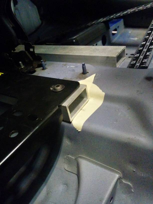

Hi,
I purchased 1 inch alloy box section (nice and light) for my drivers seat about £25.00 for fitting my Corbeau Club Sport seats to the custom seat frames I bought from Jon Foz on this forum.

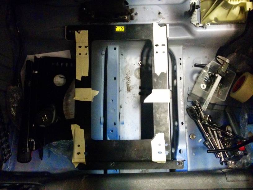

If it helps, this is what I did with OMP subframes and also recentered them. Also added black plastic end bungs to finish it off....
The box section you've used is exactly what I had in mind, yeah I've seen them plastic end caps they make a nice touch!
