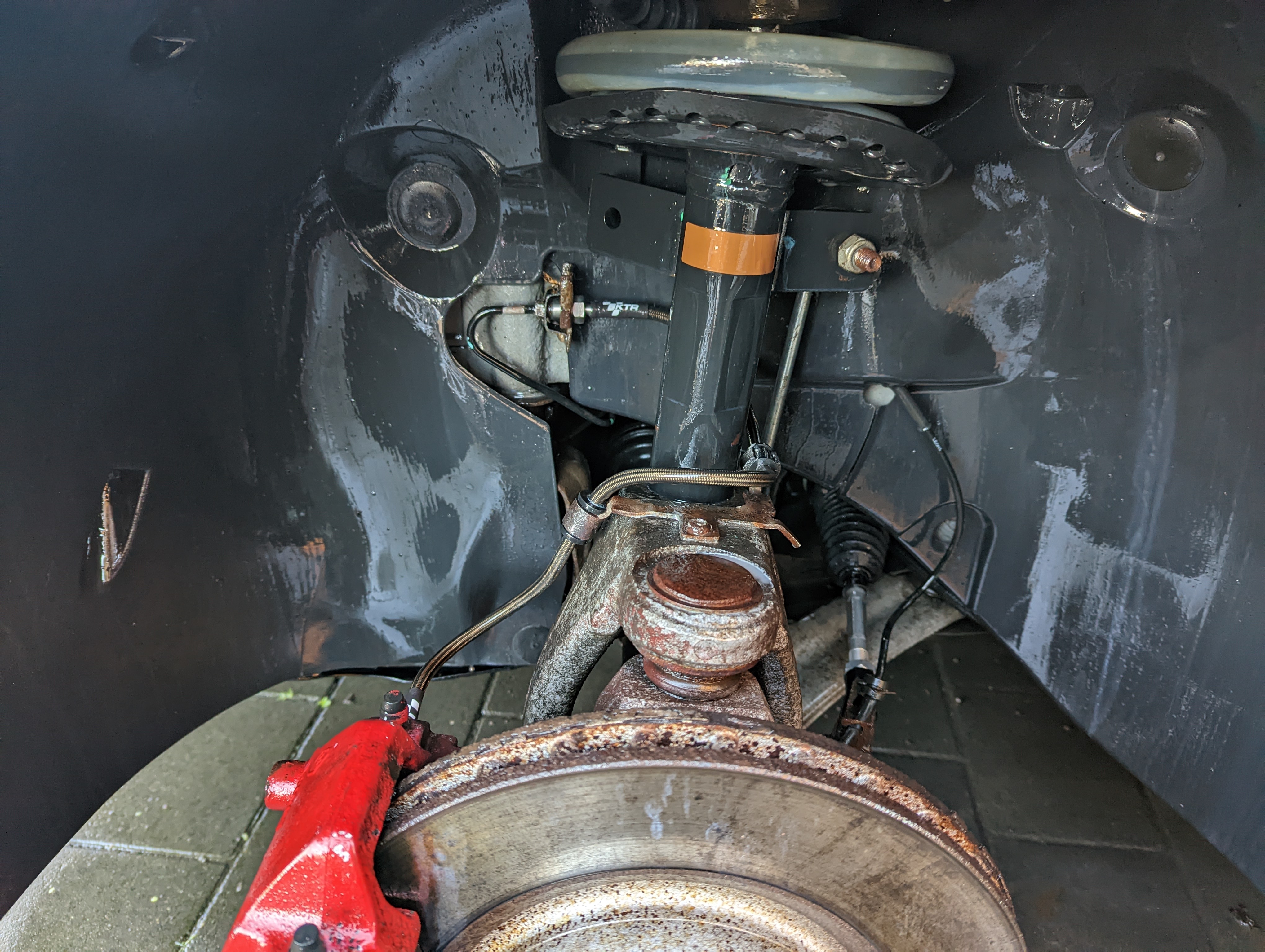

Coil spring rubbing 😢
  Clio mk3 06
Hi everyone, long time lurker, first time poster 👋
I’ve noticed my coil spring rubbing on the strut , then noticed the top mount was missing a chunk of plastic 😩
Do you think changing the top mount would centre things up a bit better, or is there something else going on here?
Much love guys 🙏
R3k1355
You've snapped the top of the spring off mate.
You need a new spring and quite possibly a new top mount.
  Clio mk3 06
Hey buddy,
Somebody else said exactly the same, but it’s a brand new spring.
I’ve got another to do the other side, and I’ve compared them both and nothing seems to be snapped off 🤷‍♂️
OssPoop
Hey buddy,
That's odd then. I'd buy new top mounts and strip it down to see what's wrong.
  Clio mk3 06
Yeah I think that’s the best bet mate.
Can springs be put on upside down? Left or right?
Maybe I’ve got the wrong spring in there 🤷‍♂️

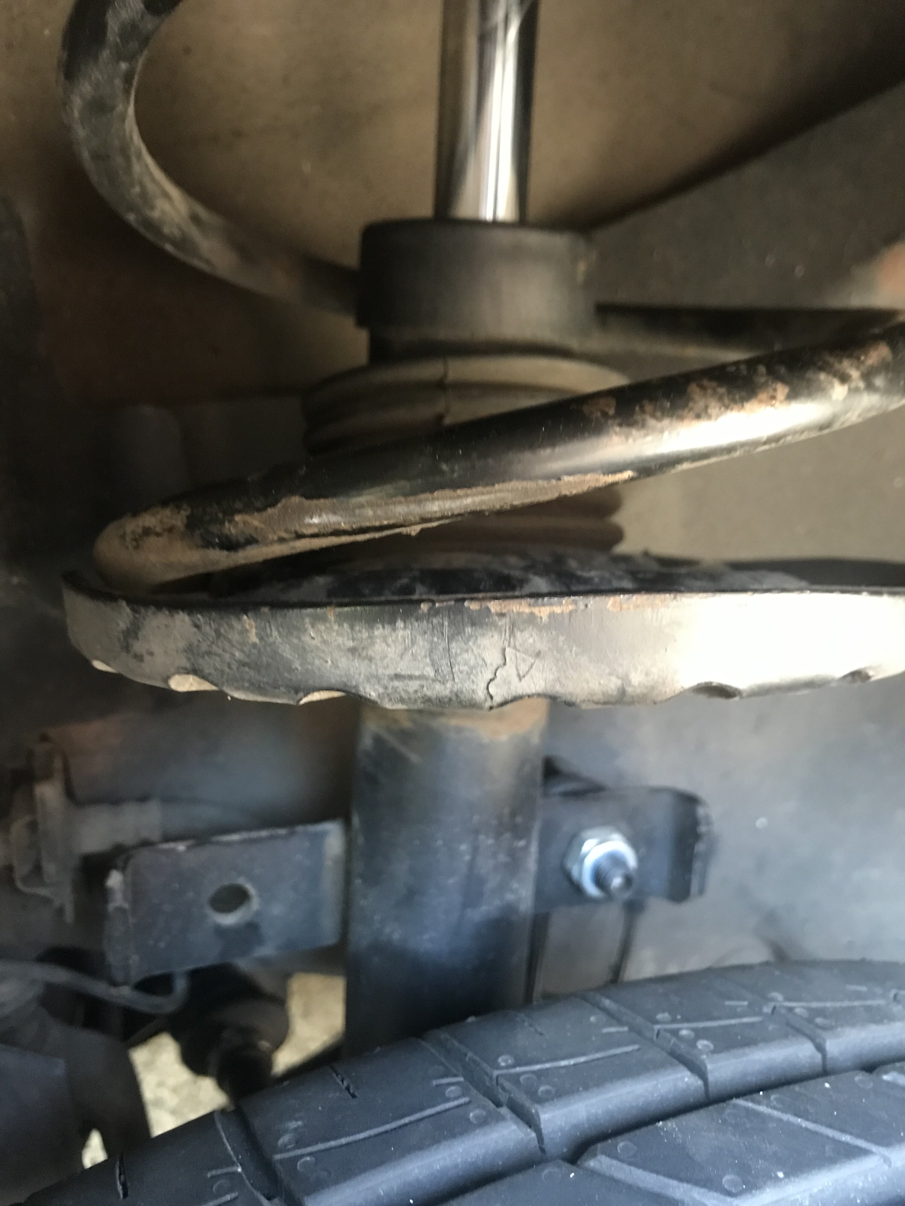

Martin_172
Normal with cheap motor factor springs, this is why the genuine ones have a rubber cover over the bottom few coils, you will be getting knocking over bumps etc
only pic i could find, you can see the rubber cover
