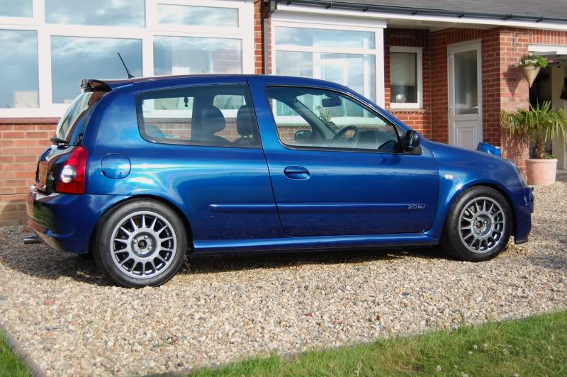

A s**te photo but this is what it looks like:
When the car was on coilovers:
Stopped the scrubbing

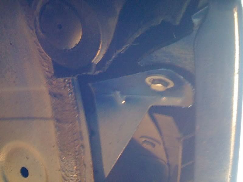

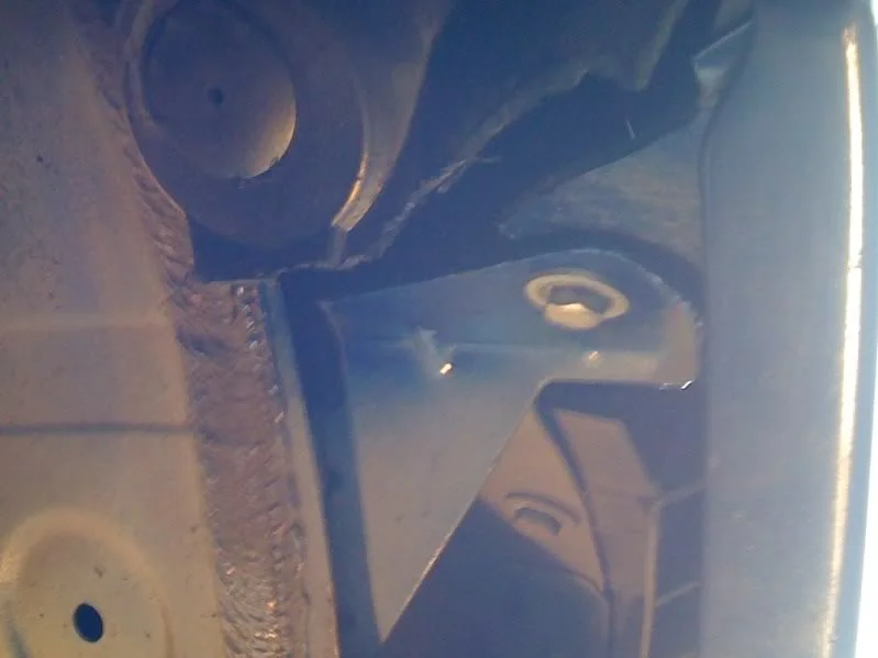

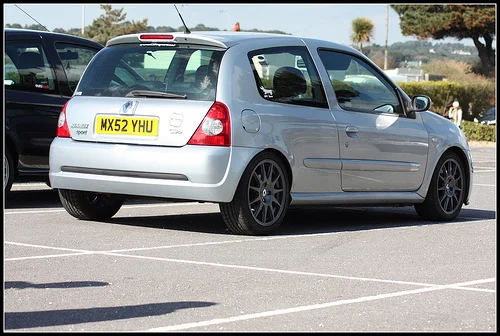

Right... this is what i've done bud. hope it helps. Similar pictures to The Boosh really.. just my arch rub was caused by the tyre rubbing on the bracket (on hard cornering)
I'm not sat too low...
this is what my bracket now looks like...
sorry the pic is so poor! hopefully if you can comapre it to the one above you can see what i've done. the only arch lining i've removed is the front section (it removed itself really :p)

As you can see hardly 4X4 drive ride height ;) and no rubbage issues at all.

I can see that mine is actually rubbing part of the metalwork around where the bumper meets the wing. Only on real hard cornering and with a passenger tho.
Cro
  Meg'd r27
Think thats the part Si is talking about Pablo. Out with the dremel, thats what I had to do
