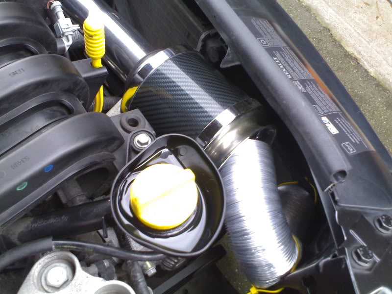

What? 65mm ID is too big? My old viper was bigger than that. My new Hill Power comes with 2 65mm feed pipes.
if you're going from here VV
upto the filter, I think you need a bit more than a metre, sure mine was about 1200 but cant remember!
On looking to fit mine I have found there should be enough room for a 70mm feed which should easily be enough if fitted correctly. Hill Power kit is supplied with 2 60mm ID feeds. Hopefully there will be room. I think the idea is to replicate the original feeds, one down inside the wheel liner and the other into the rear of the n/s headlight.
i just got a few quids worth of flexi ducting stuff and a bag a tie wraps.. does the job and only cost like £3!
ahh good point.. forgot about the extra 800 odd cc the bigger boys have :(
There is no room to that in a sport.
Rubbish

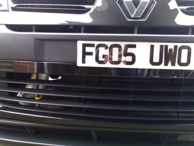

Ive got a 4 inch bore pipe running from the fog right up to the space bellow the battery.
Just had to relocate the horns over a bit thats it
So like i said there is no room to do what addz did ;)
whats 4 inches in real measurements? I can't be bothered to take all my car apart.
