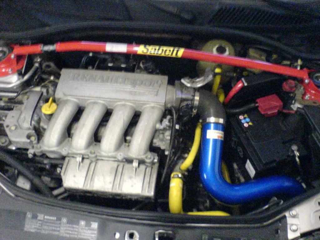

I bought a K&N typhoon inlet.
http://img339.imageshack.us/img339/1135/dsc00479cw5.jpg
much better sounding and much better looking than original with bigger pipes.

I've got a silver one, how it's like??
well when my girlfriend drives (she shifts gear at 3000rpm), you don't hear the difference.
but when I'm driving (on the good side of 3000rpm full throttle) it gives a great roar, much louder than standard, I LIKE it hahahaha.
I can't feel much powerdifference, standard inlets with upgraded inlethoses give also good cold airflow.
just wanted to get that bulky plastic bucket out and a nicer looks/sound.:cool:
bought it on ebay 218gbp,not cheap but excelent quality
