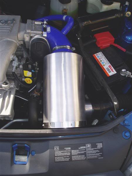

Here's one i made for my k+n cone filter . It uses both the original air feeds , its closed at the front , it will be at the back when i can be bothered , lol . It definitely doesn't lose power , sounds sweet when you boot it ;) . But i'm pretty sure it's contributed to my poor mpg ,the k+n filter has a larger surface area than the orginal panel filter .
MrBilly - Sweet! That's exactly what I had invisioned. For the closure on the outlet end of the casing I was thinking, a circular plate with a hole in for the aperture from the filter - surely that would suffice as a backing plate - the rubber around the tubing would act as a seal there, and a bit of mostic/ silicon around the diameter of the plate would provide an air seal. A fully enclosed system would probably work better as it would "suck" the outside air in because the box would create a partial vaccuum - you'd probably get more power out of it that way (and more MPG as the fuel would burn more efficienetly).
Nice, quality work bud but, unfortunately until you enclose the rear of the filter, the rest of the work is pretty pointless. As, it'll still be sucking in warm air, and unless there is forced air coming down your cold air feeds, they won't be functional either.

^^^ The actual back of the enclosure is almost closed as thats where the back of the cone filter is and the diameter isn't much less than the actual diameter of the enclosure. So it's getting most of the air from the 2 air feeds .

I've made a circular plate with a 70mm hole through , i just haven't got round to putting it all together yet .
