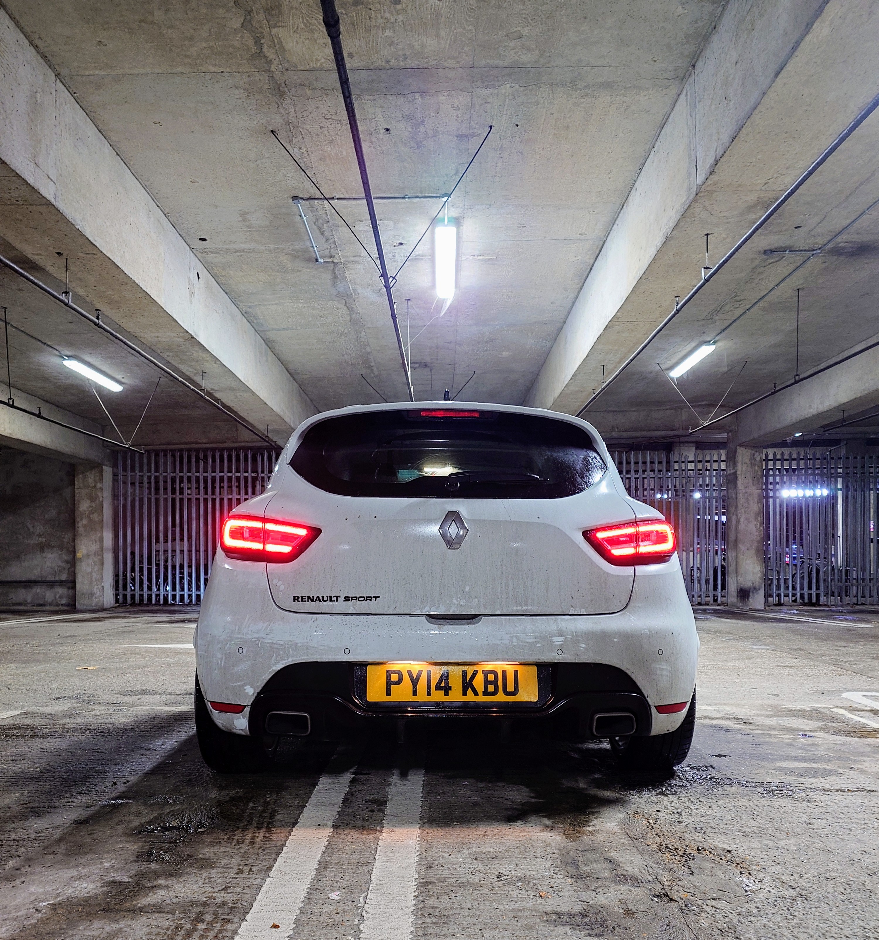

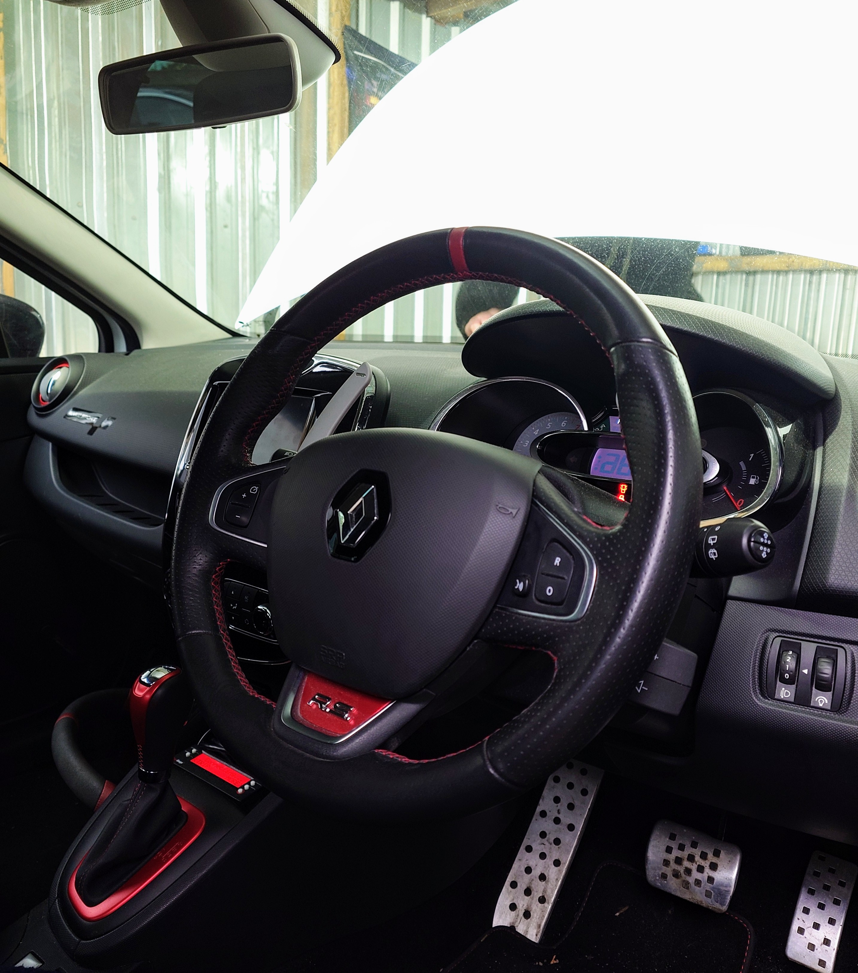

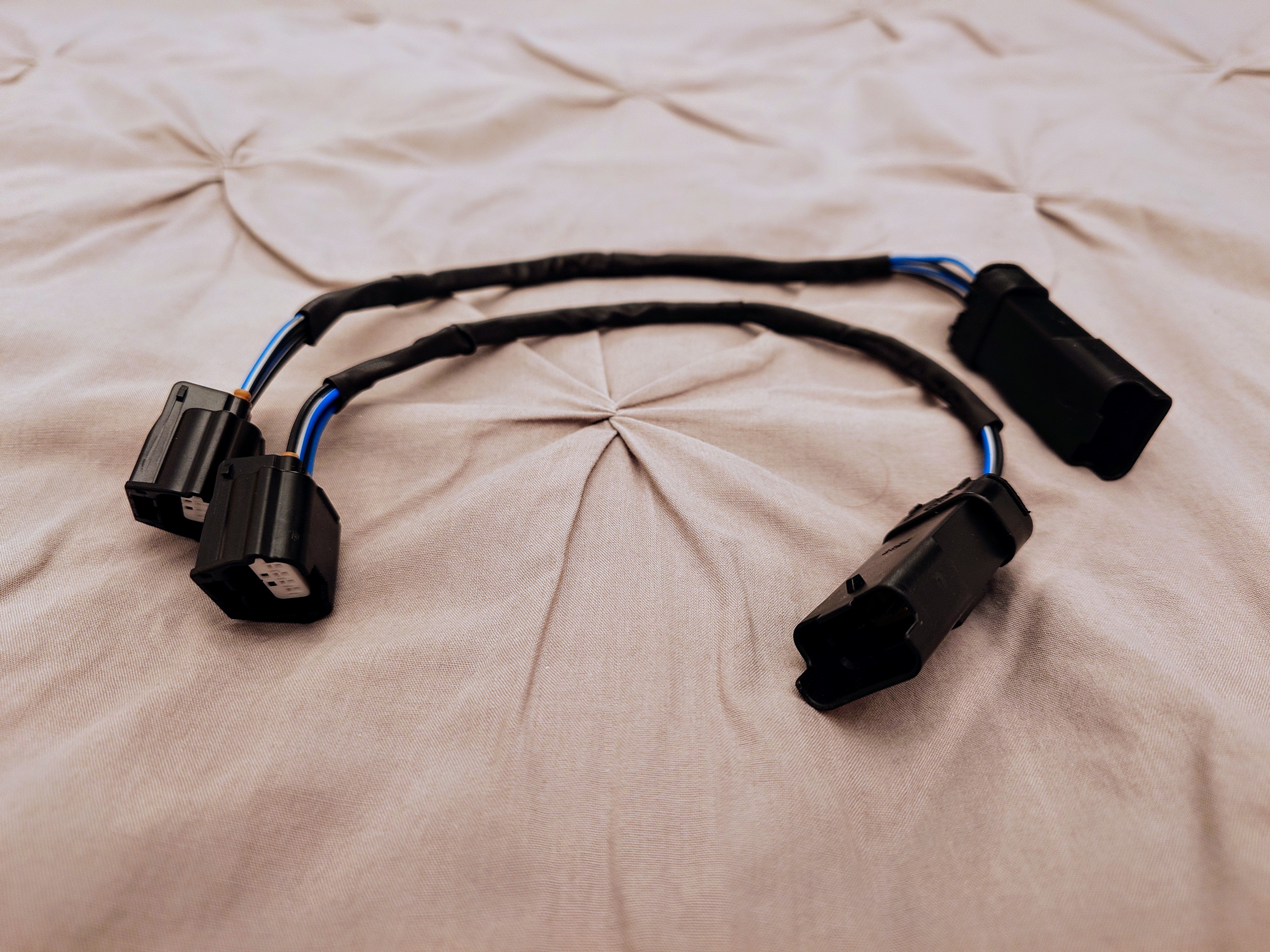

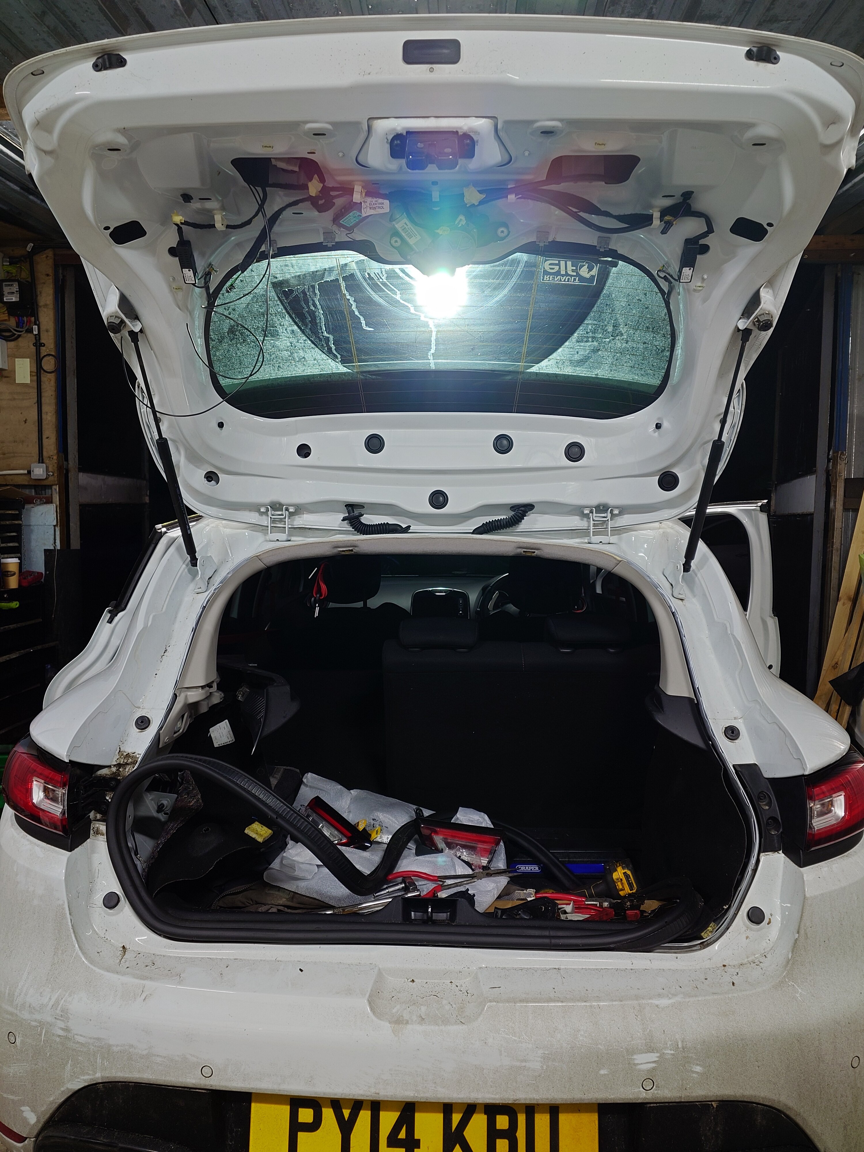

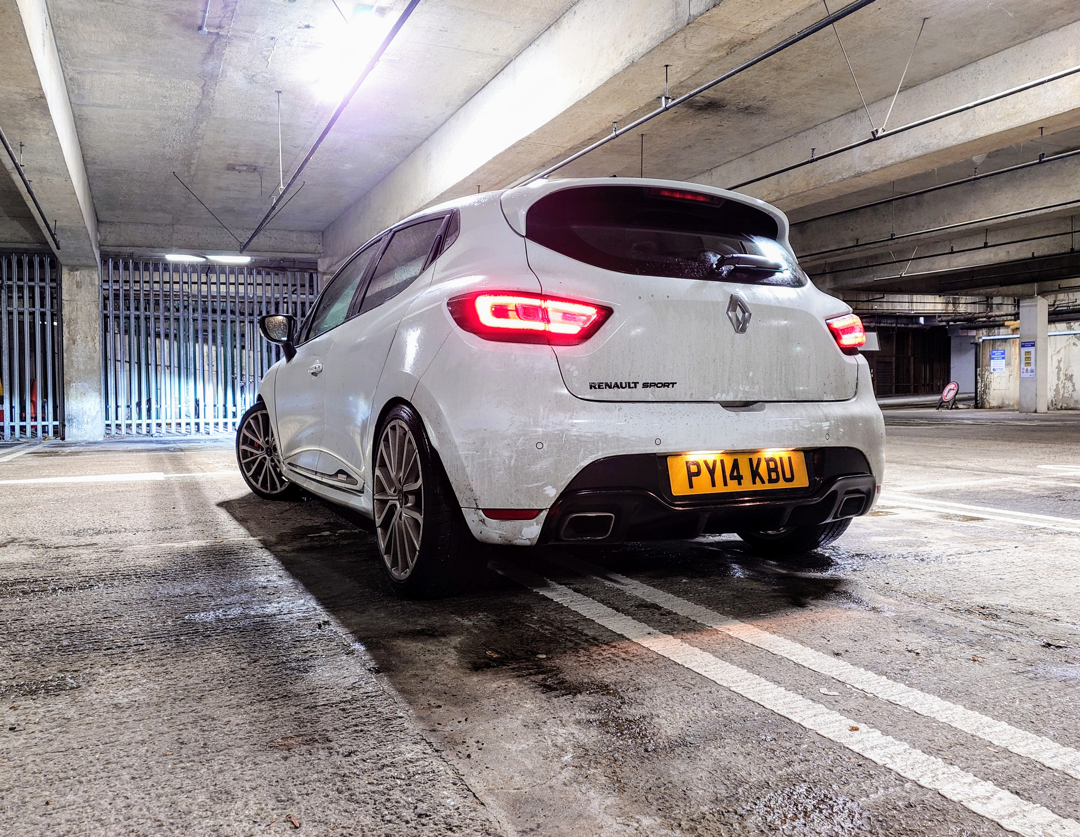

Steering wheel and rear LED lights finally fitted! After having a friend make the loom adapters I had the Clio booked in again with ELF Automotive to do both jobs.
Swapping the light units over on both the car and tailgate is one thing but you need the adapters as the original loom connectors are different, you also have to run 2 wires from the light loom behind the carpet on the passenger side of the boot into the tailgate to connect to the tailgate lights. This means unclipping interior parts, the back of the headlining and tailgate plastic. As well as loom splicing this was something I didn't want to get involved in 😁
A couple of hours later and we have a back end with updated rear lights and a steering wheel I won't cry at every time I get into the car.

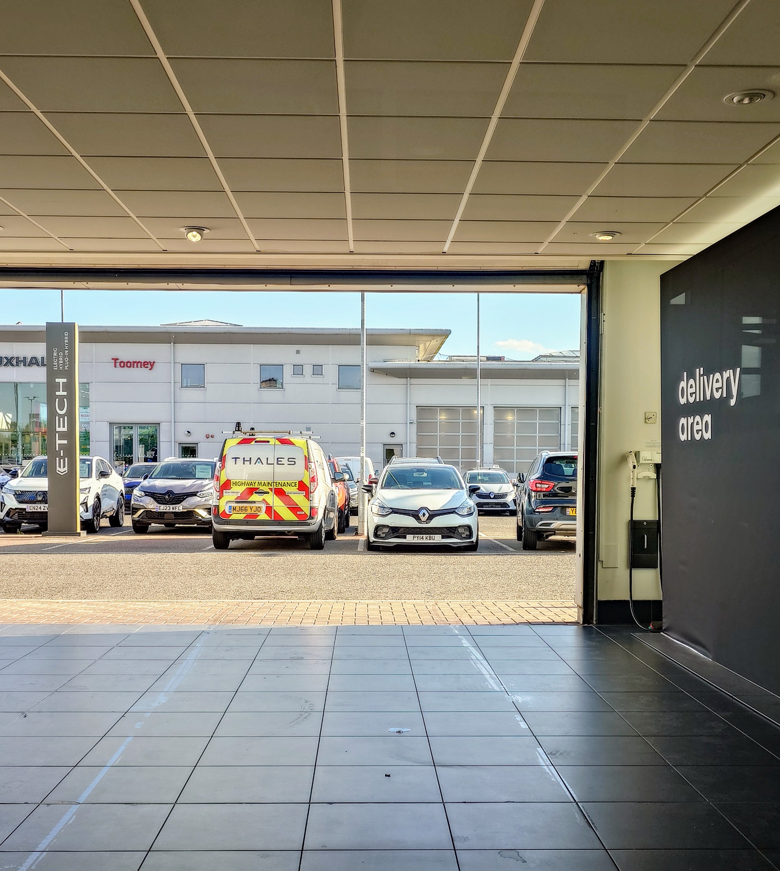

Popped into my local Renault dealer on Friday to order the wheel bearing. RPD price £79.95 reduced from £106 on their website page. Parts guy won't budge on their price of £106 "no we don't do discounts, you don't have a trade account to do that and you don't spend enough money"
My loyalty to the brand and coming to the local main dealer over the last 15-20 years and the fact I'd rather spend my money here than go to another dealer or even motor factors means nothing.....
Ok.......
Thankfully I know the branch and brand manager.
" Everything ok Rich?"
"Well not really, explained I've been coming to the dealers for years for parts, daughter bought her car from here etc" which they know
Chap walks to parts, insists they honour the £79 price and to order the part "This guy has been coming here for years, run it through at that discounted price"
Thank you very much 👌

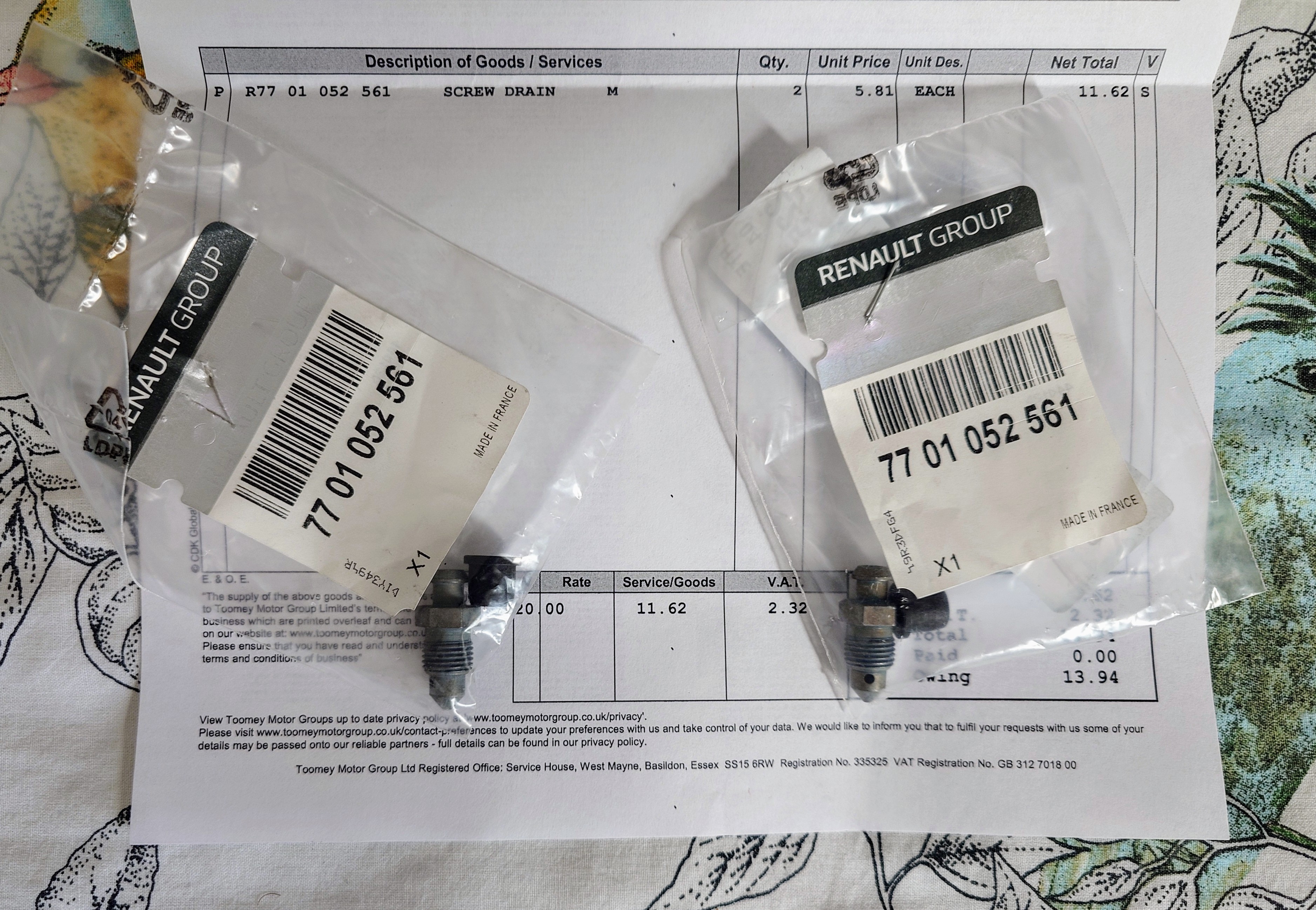

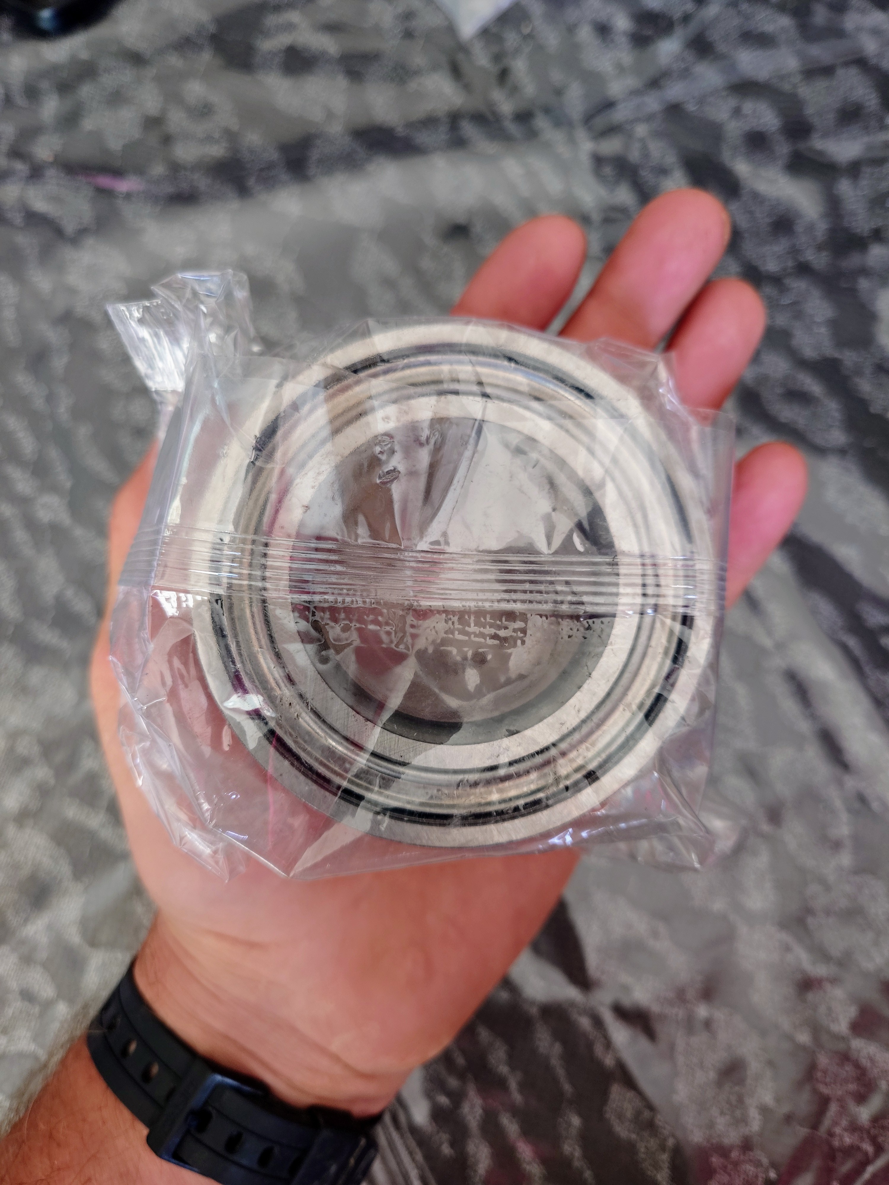

Picked up the wheel bearing from Renault today and ordered 2 bleed nipples for the rear calipers after being made aware that 1 of them was a bit temperamental.
Wheels bearings are a little bit chunkier than the old school Clio's from back in the day 😁
3 3/4" in diameter

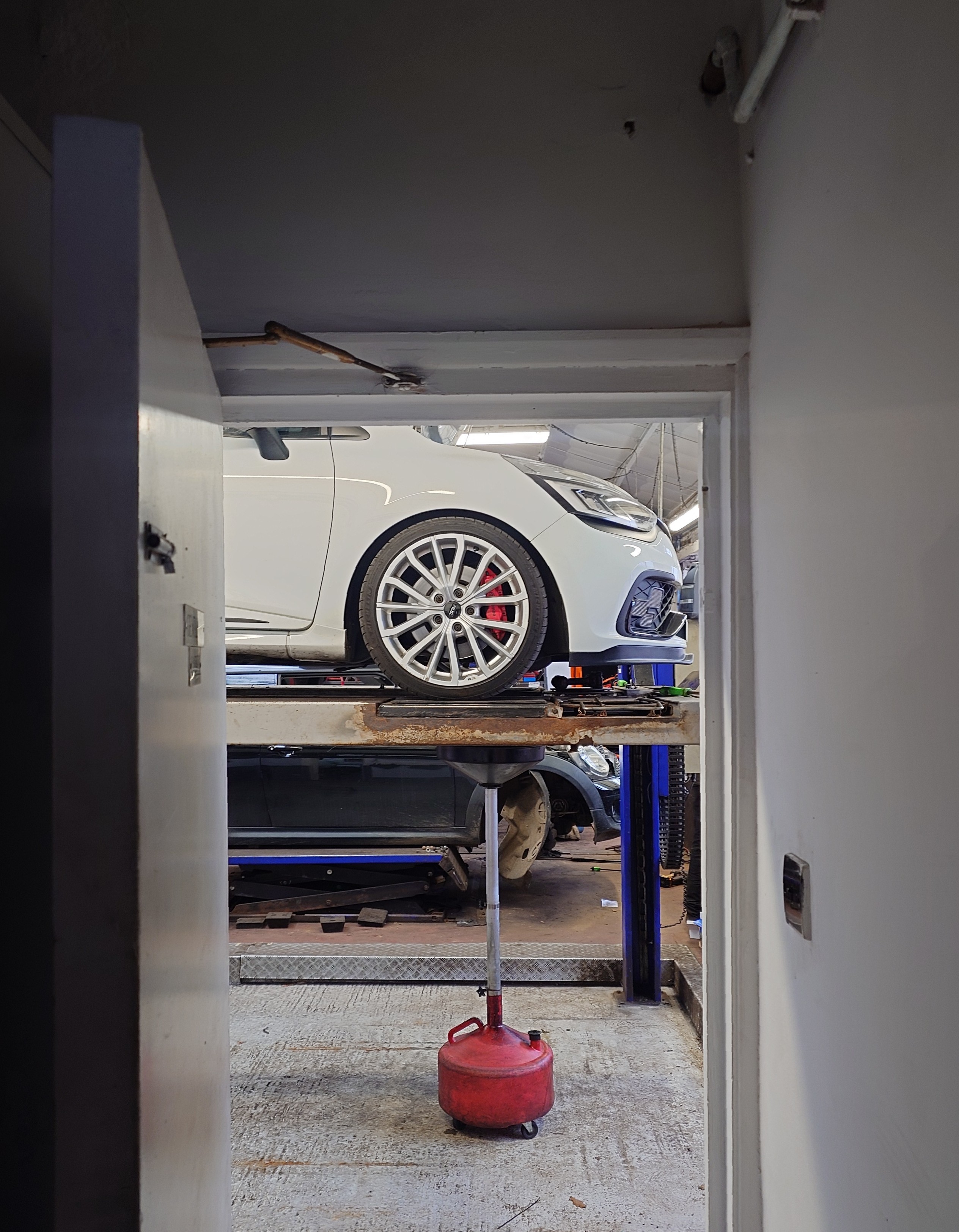

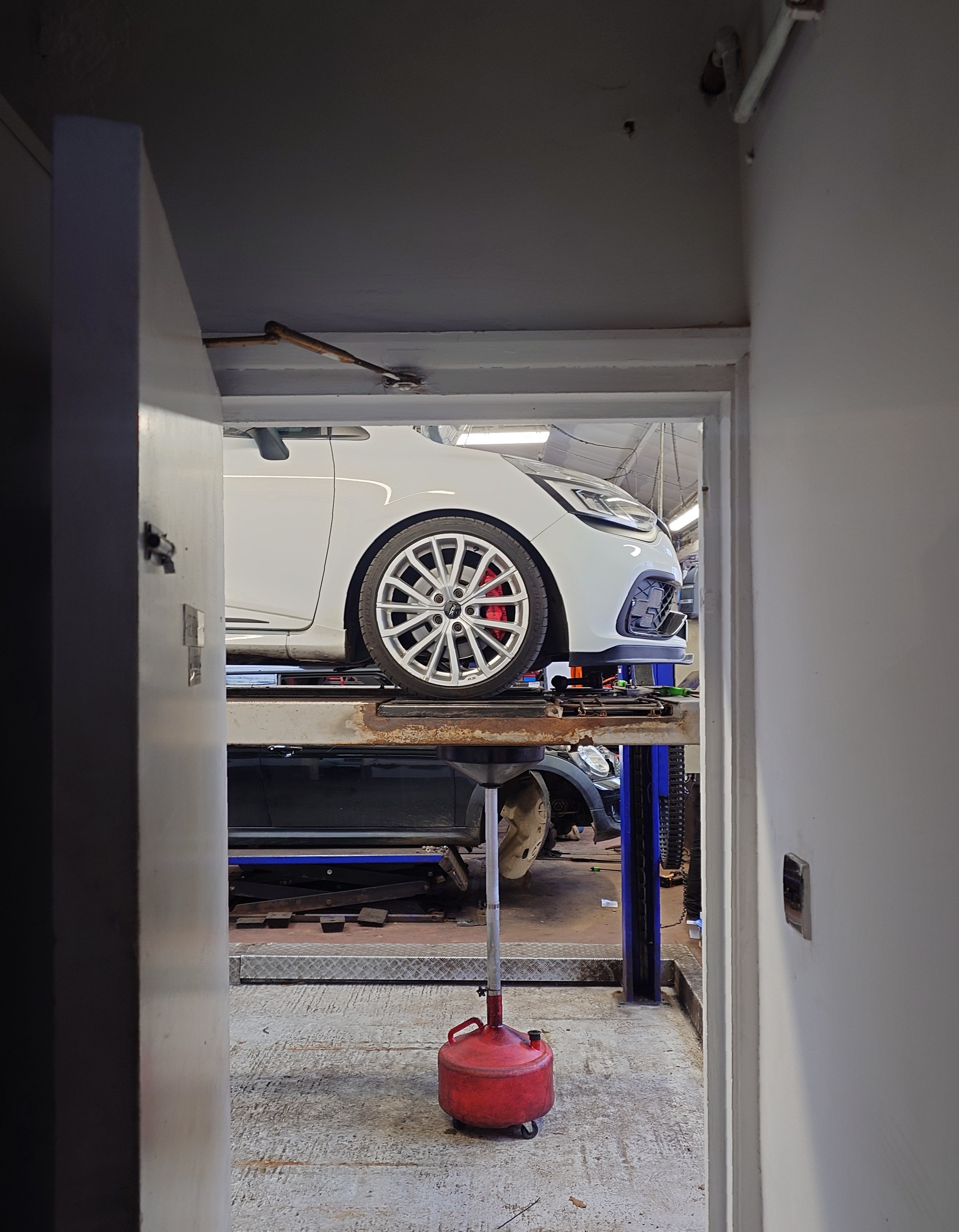

Wheel bearing fitted, fresh Motul 600 brake fluid and genuine bleed nipples from Renault fitted on the rear calipers. On picking it up at Eds workshop we discussed a couple more jobs I'd like doing, Type D coolant change and the aux belt kit. Popped into Renault on the way home and picked up enough coolant to add to what I already have and will order the aux belt kit from RPD.
I think once those jobs are done I've then covered all the service items for the age and mileage (91k) of the Clio

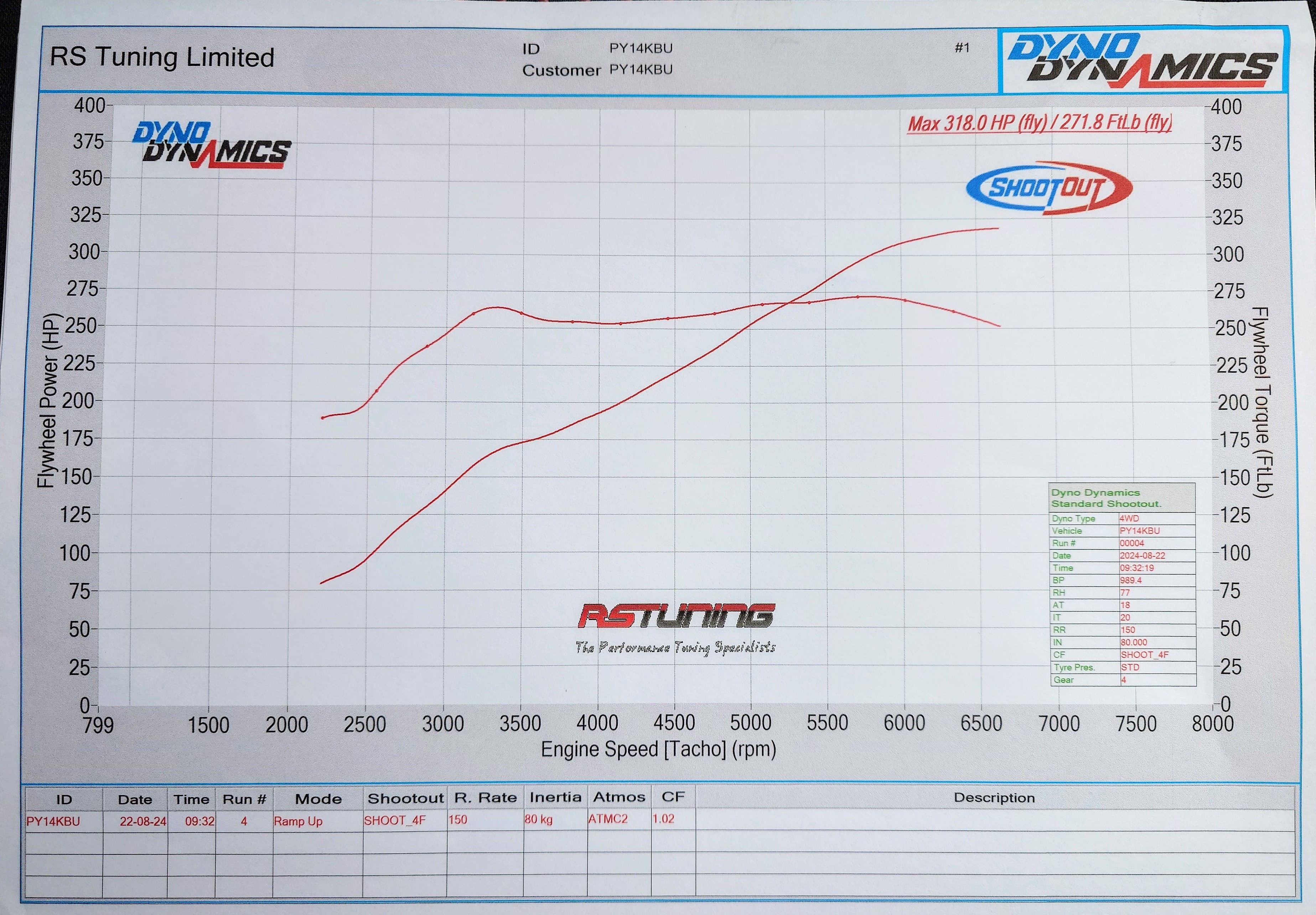

I'm slowly ticking off the jobs on my to do list and this one has been on it for ages. It's one thing hearing about the power and torque from the previous owner but I wanted to see it for myself, and to basically make sure after nearly 3 years of owning it that everything is as it should be.

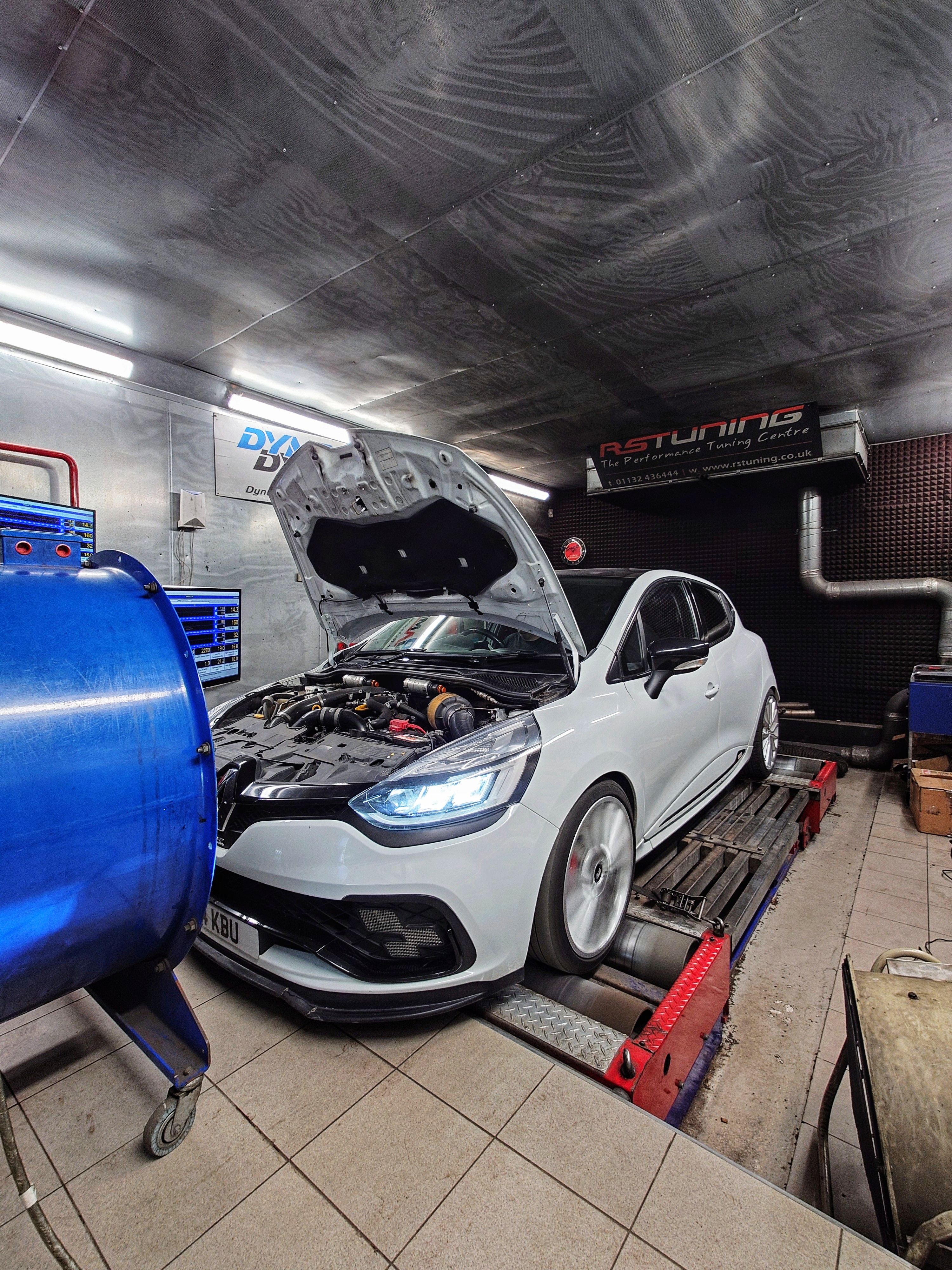

I booked the Clio in a week ago and made the 456 mile round trip from Essex to RS Tuning in Leeds. A few power runs later confirms it's still healthy with the map absolutely fine.
456 miles for a rolling road is commitment! nice numbers, totally reliable?
It's where it's had all its mapping done throughout the years. 2 iterations of turbos, different diameter exhausts, different inlets, different induction kits. All to find the right ingredients to make what's it's doing now.
We were talking about this yesterday, the Clio has been mapped and modified power wise for 90% of its life, 60% of its life with a hybrid turbo. It's on 92k now so you'd estimate it's done about 50k on the hybrid turbo at least.
To think way back in 2016 my first 200 EDC stock was 189bhp and 172ft/lbs, so to what I have now and for how long it's been done that way I think that's pretty good.
If you take everything into account above then I'd say yes reliable for this particular Clio, who knows if someone else had gone down the same route modification wise how long it would last.
I mean who knows how long the clutch will last. It's still standard, the torque has been capped to help but as a wear and tear item they're designed to go at some point.

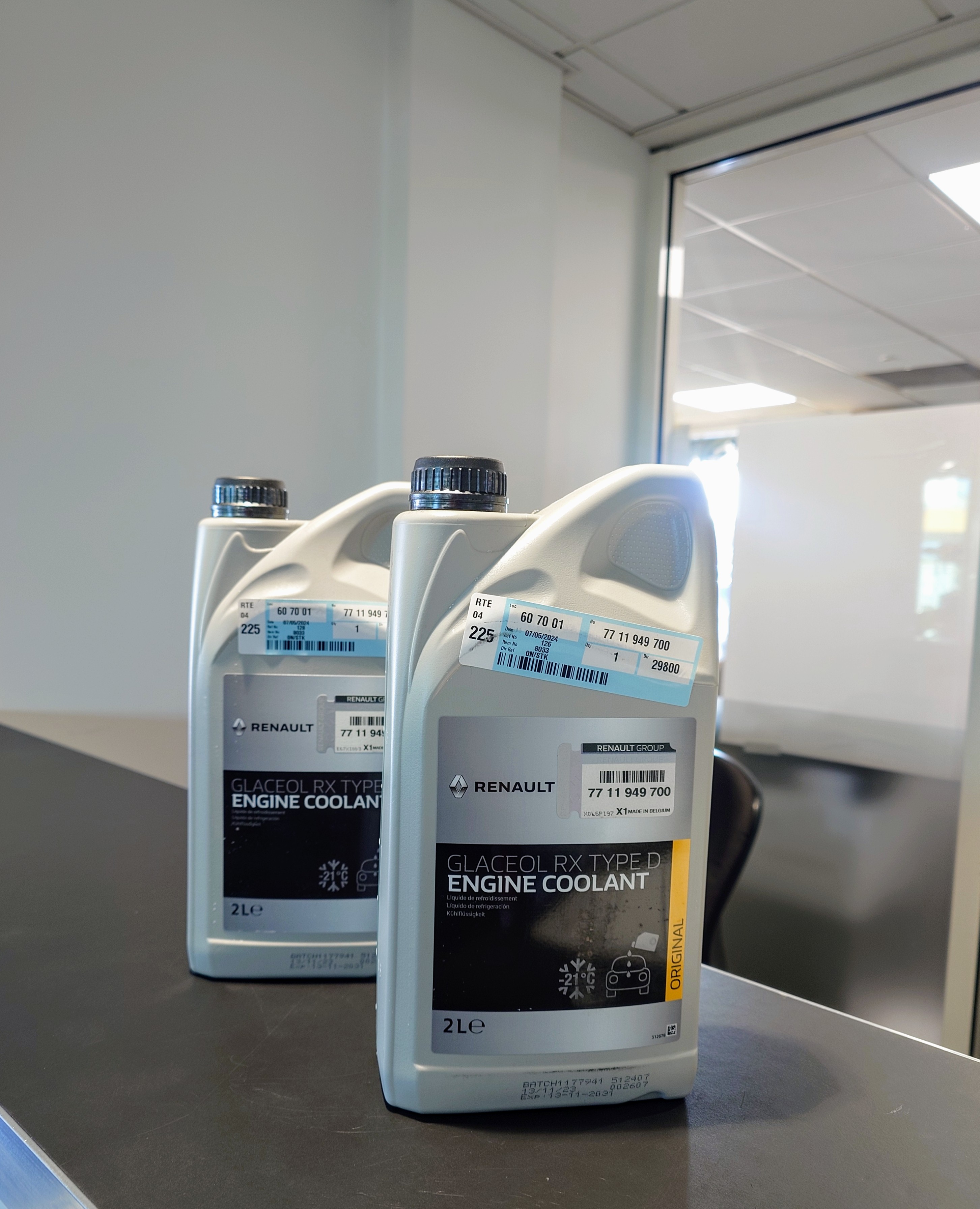

Another job ticked off, coolant dropped and fresh Type D now in place. Visual inspection of hose clips while underneath and ironically one of the OE clips cracked when being refitted so swapped out for a new jubilee clip.
System bled through, ran up to temp, topped up. Gave it a run out for 15 mins to get the thermostat open. Topped up to MAX, the Scangauage reads the temp between 83-85 degrees.

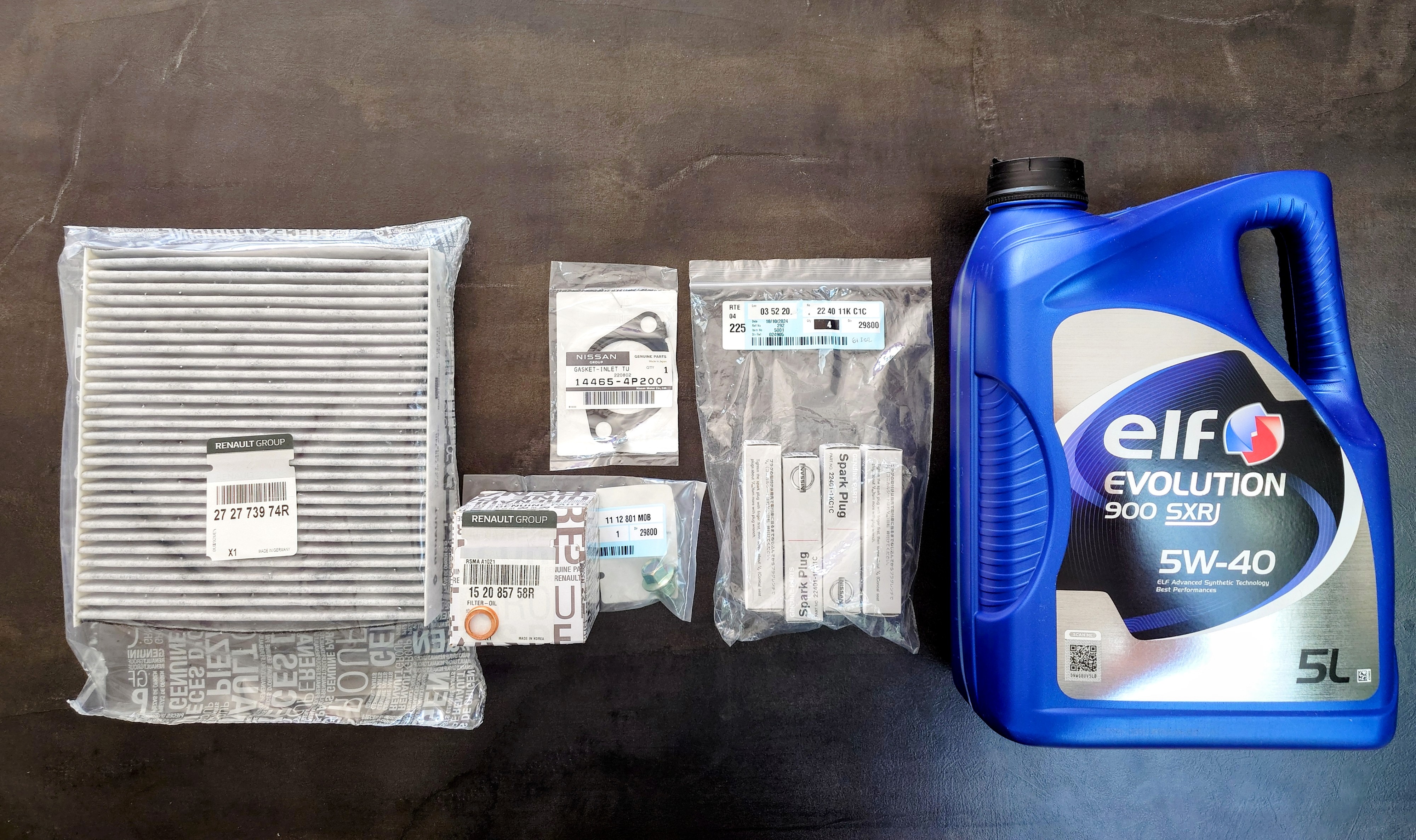

MOT and service booked in for 15th July, I think off the top of my head it's only done a thousand miles since the last MOT. I really need to use it more as it's not moved since the coolant change.
OE ELF oil from Opie
Oil filter
Sump plug
Sump plug washer
Pollen Filter
Spark Plugs
Turbo pipe gasket
School boy error, where I've left the car sitting so long it drained the battery. Not good when I need to take it for the MOT and service so that has been rebooked for the 23rd July.
It's only done 900 miles the last MOT in August 24 so I really should, like really use it more so the last couple of days I've given it a run out with a splash of V Power and a quick jet wash to blow off the cobwebs.
Still, an opportunity for photos. I really don't fully appreciate what I have as I hardly ever use it. I think as I'm a world away from the days of tinkering on cars and meeting up with friends back in the days when that's all we did, the Clio isn't high on life's list.
There are things I'd like to do on it, I just need to find that enthusiasm as it's been a little neglected.
