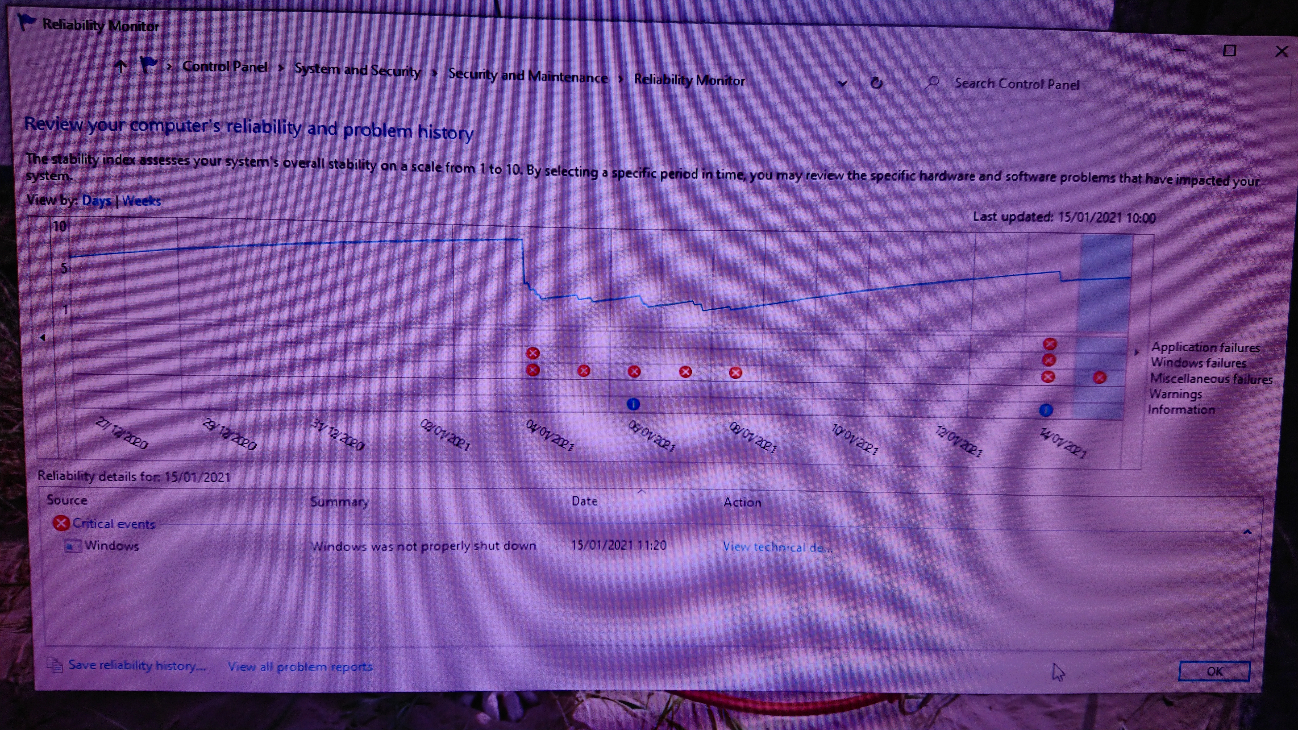

If you have a pair of sticks of ram - you could try just one at a time and see if it falls over - i've just gone through this whole process - tried new graphics card, tried replacement memory - it was just the latest windows update that was causing the crashes like your having with the fuzzy screen etc.. I looked at the reliabilty monitor it said why it was crashing and then just reverted the windows update back and it worked. Prob explains why was working good with win 10 on ssd then its updated and bosh - your having the issue. Same motherboard as you too.

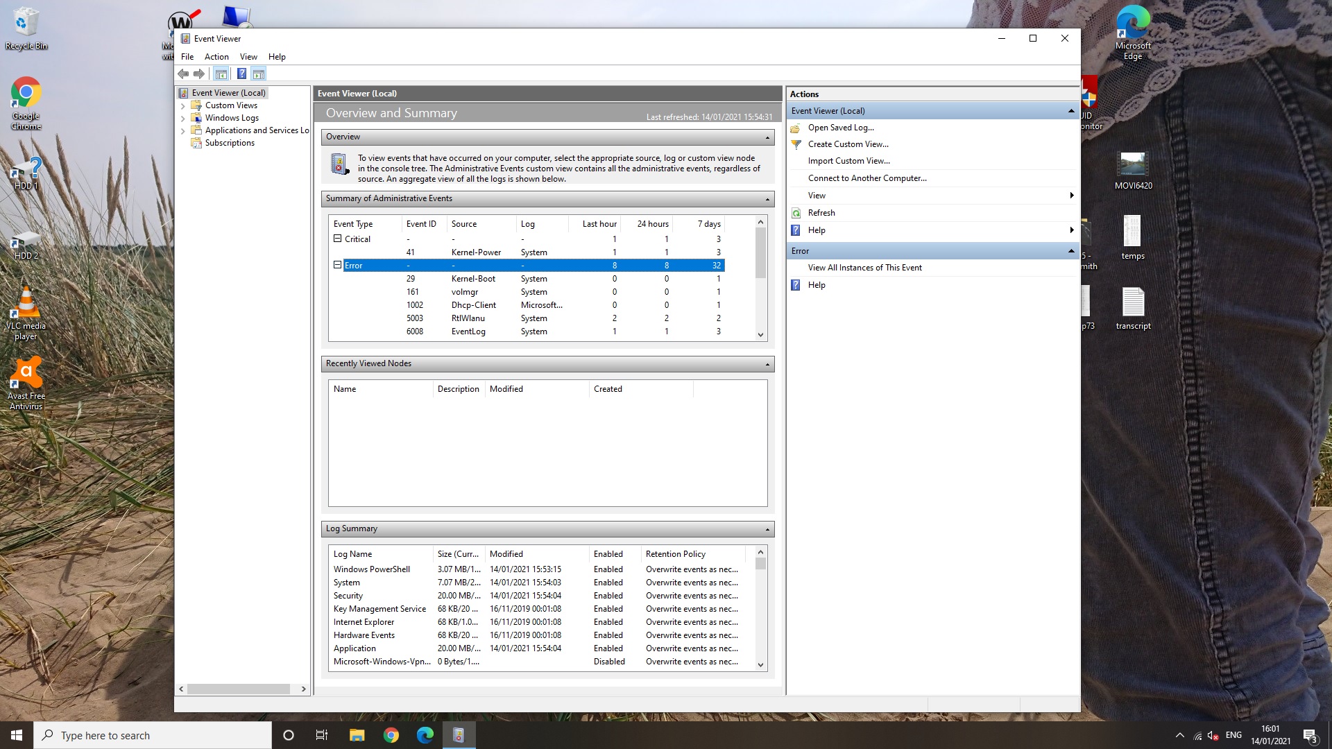

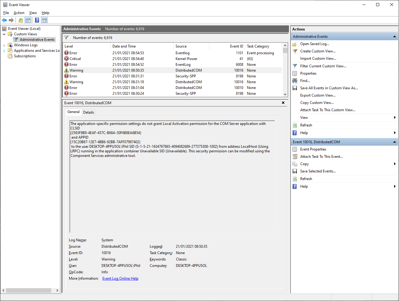

But this happened 4 mins approx before the crash - not at the time of crash from the log?DCOM event ID 10016 means that certain processes don't have permissions to the DCOM components that are mentioned in the event logs. To resolve this, kindly follow the steps below:
Important: The section, method, or task provided on the link above contains steps that tell you how to modify the registry. However, serious problems might occur if you modify the registry incorrectly. Therefore, make sure that you follow the steps carefully. For added protection, back up the registry before you modify it. Then, you can restore the registry if a problem occurs. For more information about how to back up and restore the registry, refer to the following Microsoft Knowledge Base article: How to back up and restore the registry in Windows.
1. From the Start menu, type regedit.exe in the search box, and then press Enter. If you are prompted for an administrator password or for confirmation, type the password or provide confirmation.
2. Go to HKEY_Classes_Root\CLSID\{6B3B8D23-FA8D-40B9-8DBD-B950333E2C52}.
Note: *CLSID* stand for the ID that appears in your event viewer error. In your case, it's {6B3B8D23-FA8D-40B9-8DBD-B950333E2C52}.
3. Right click on it then select Permissions.
4. Click on Advance and change the owner to Administrators. Once done, click the box that will appear below the owner line.
5. Apply full control.
6. Go to HKEY_LocalMachine\Software\Classes\AppID\{4839DDB7-58C2-48F5-8283-E1D1807D0D7D}.
Note: *AppID* is the ID that appears in your event viewer. In your case it's {4839DDB7-58C2-48F5-8283-E1D1807D0D7D}.
7. Right click on it then select Permission.
8. Click on Advance and then change the owner to Administrators group.
9. Click the box that will appear below the owner line.
10. Click on Apply and grant full control to the Administrators group.
11. Close all tabs and go to Administrative tools.
12. Open Component Services.
13. Click on Computer, select My Computer, and then click on DCOM.
14. Look for the corresponding service that appears on the error viewer [Immersive Shell].
15. Right click on it then click on Properties.
16. Click on the Security tab, and then click on Add User. Add Local Service then click on Apply.
17. Tick the Activate local box.
