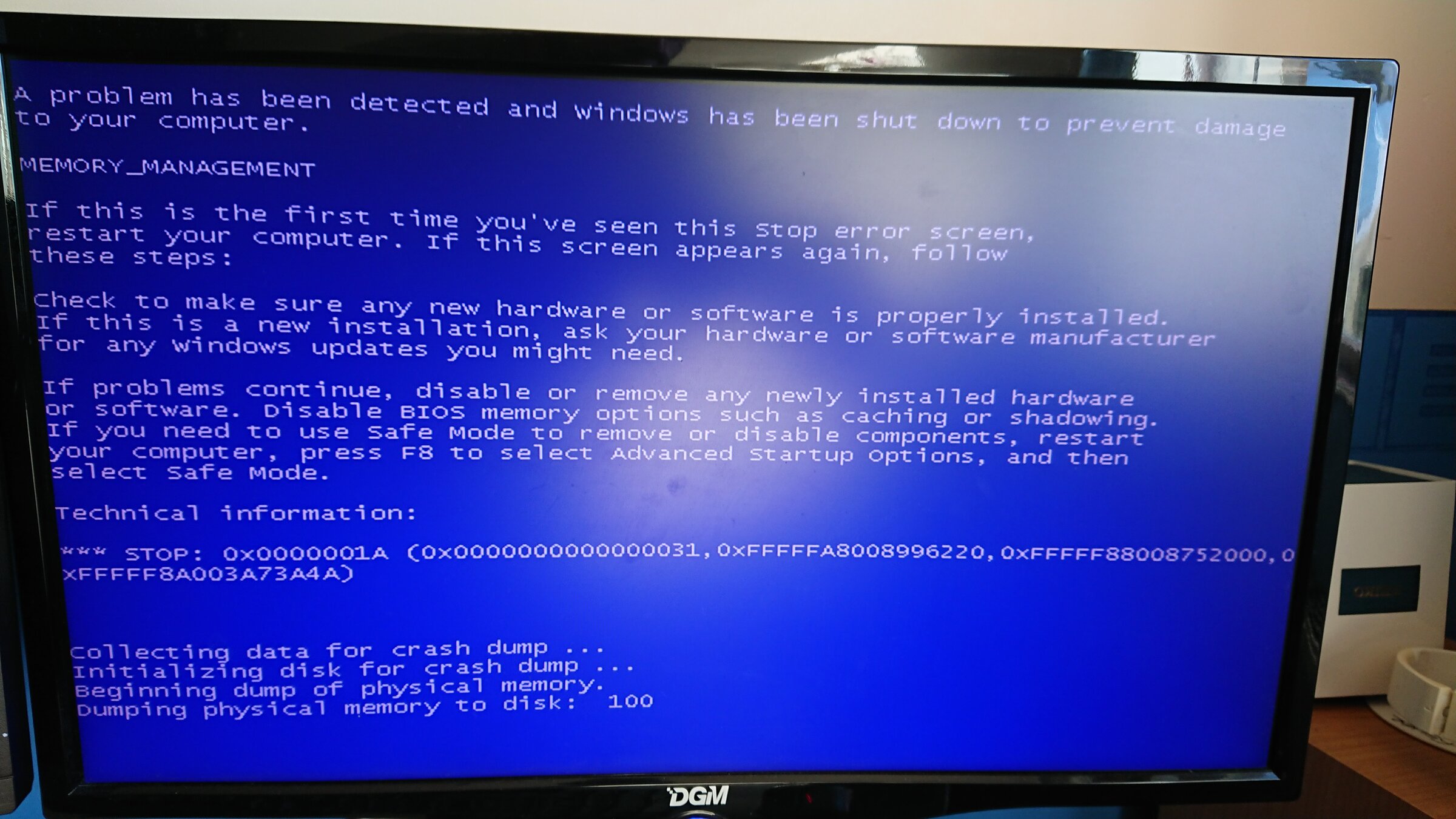

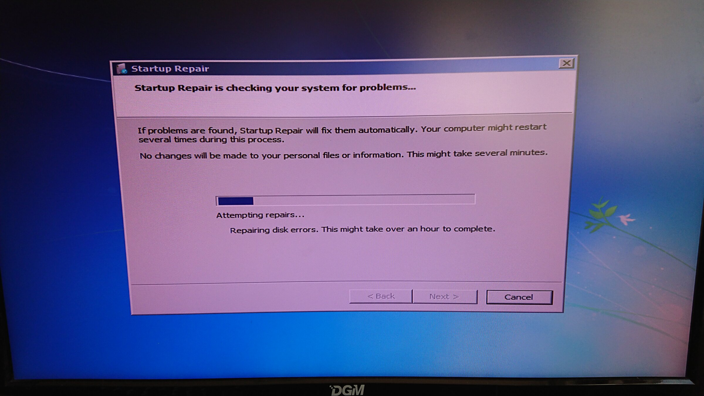

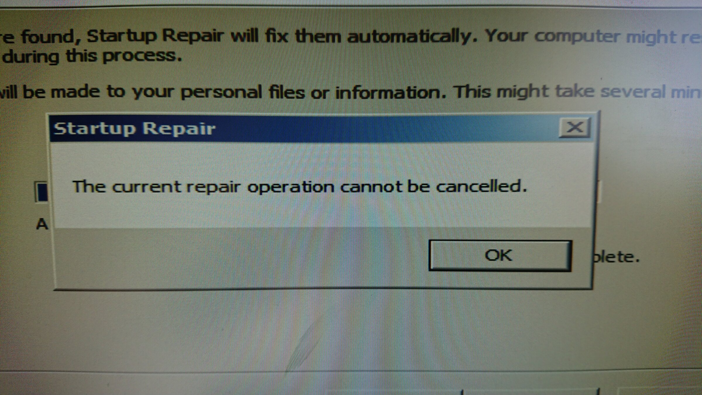

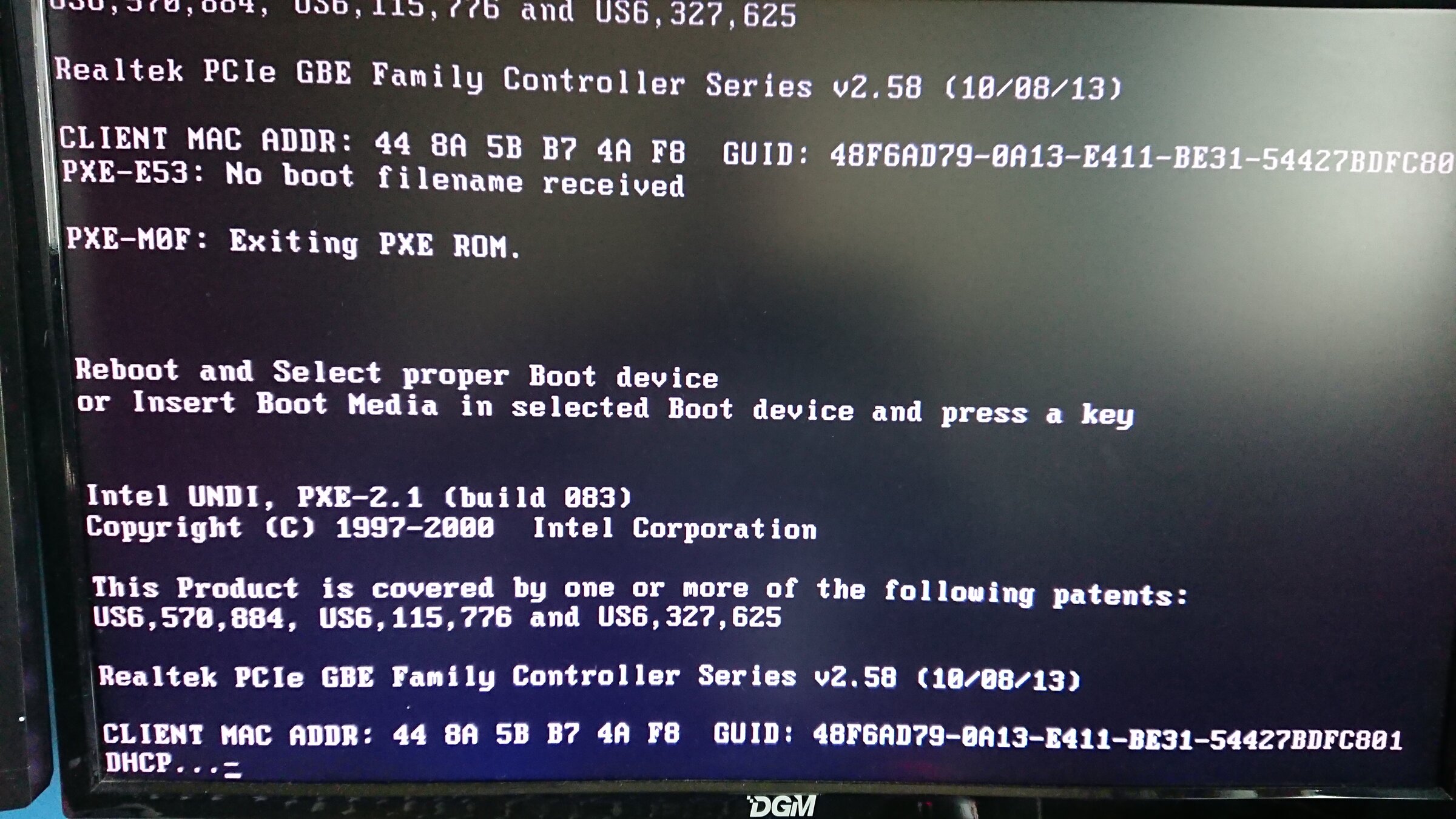

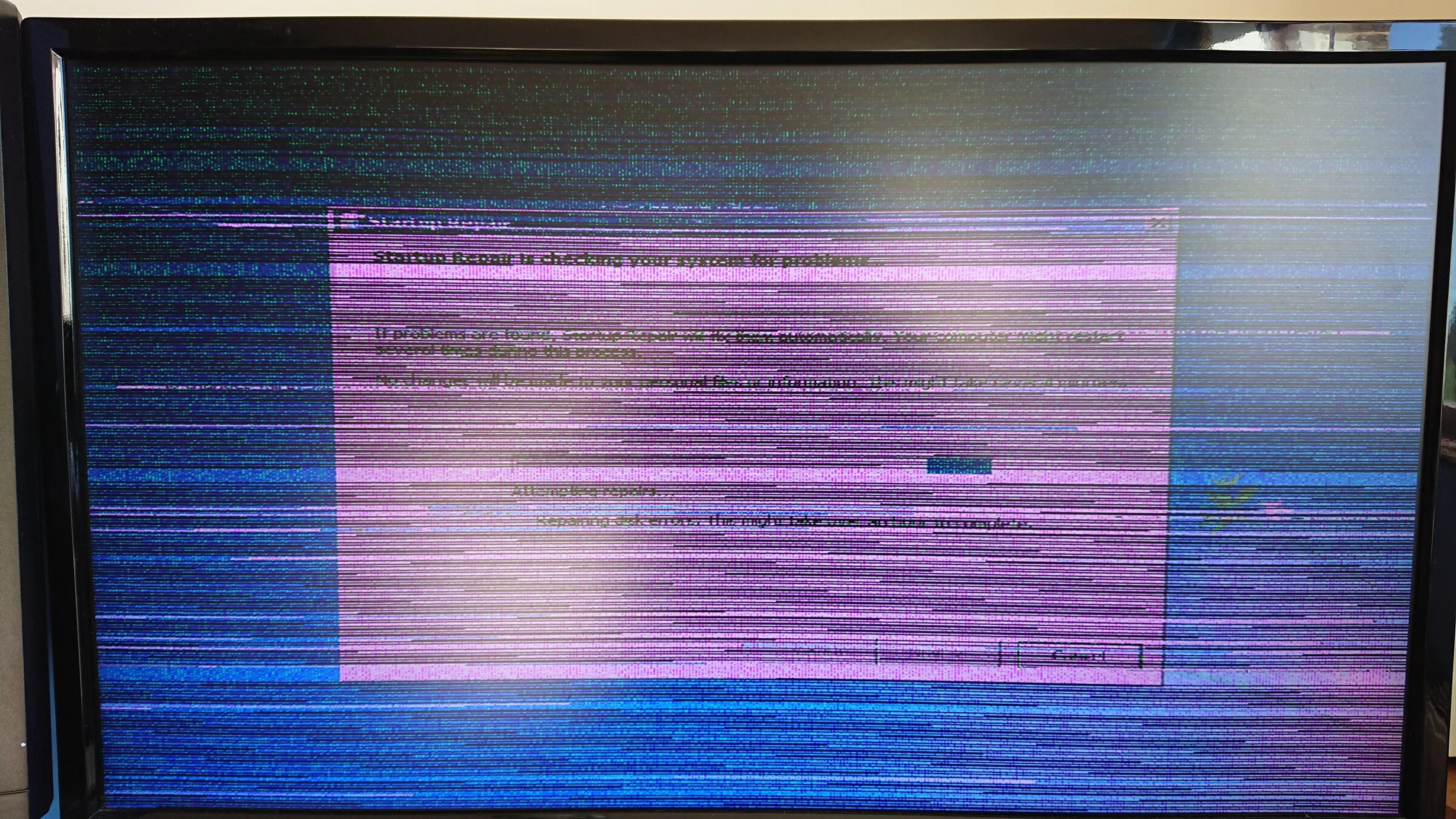

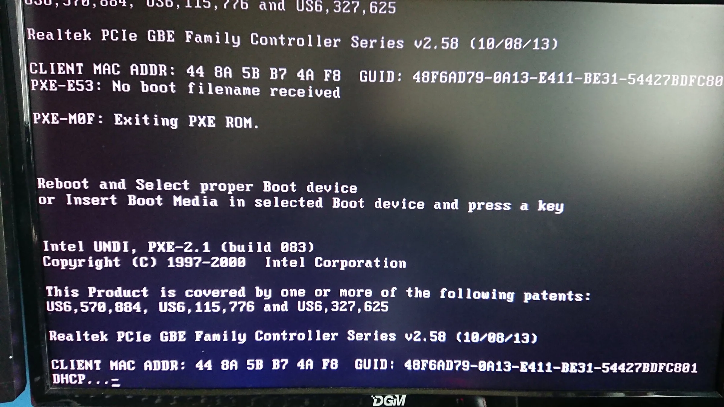

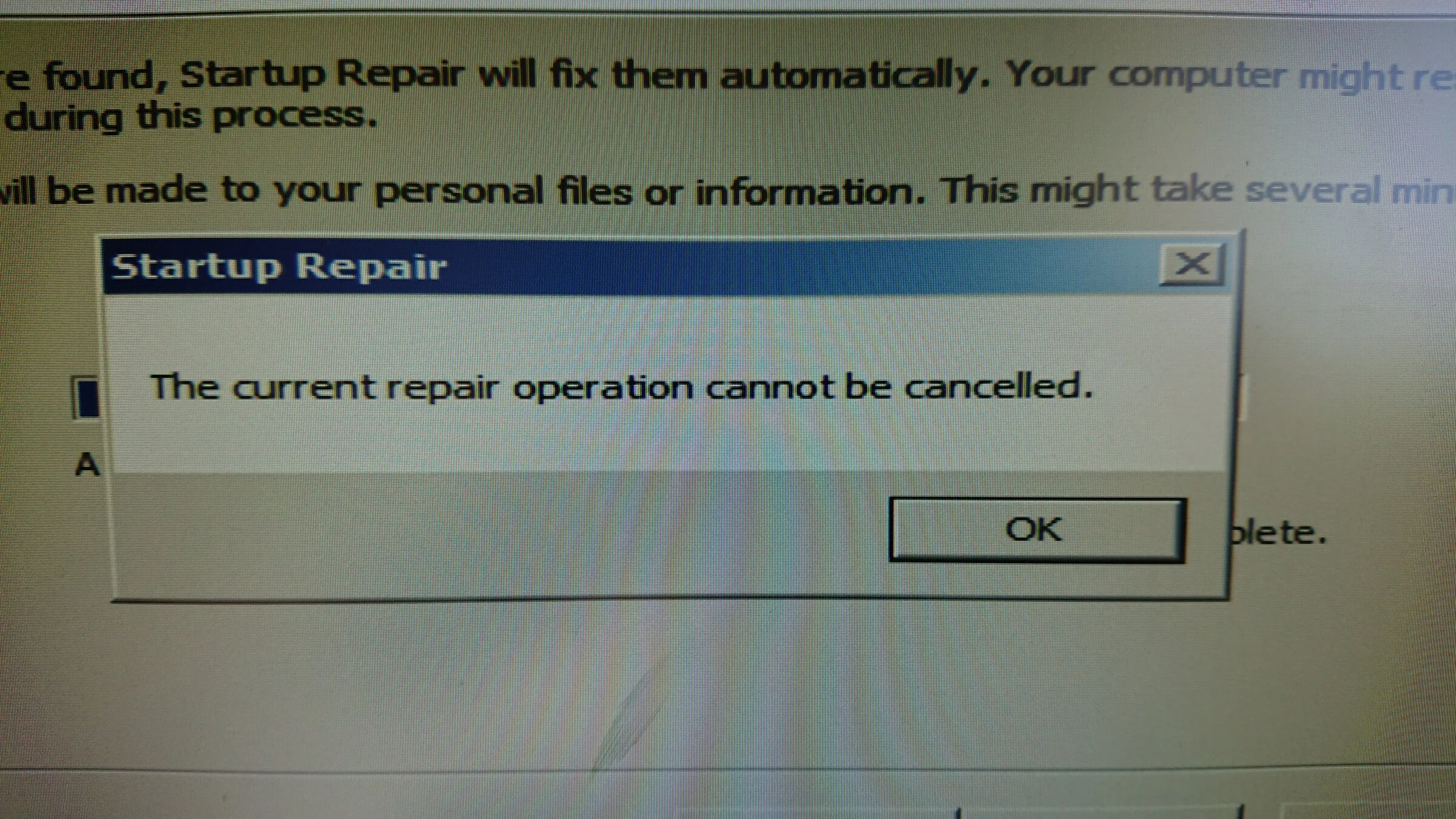

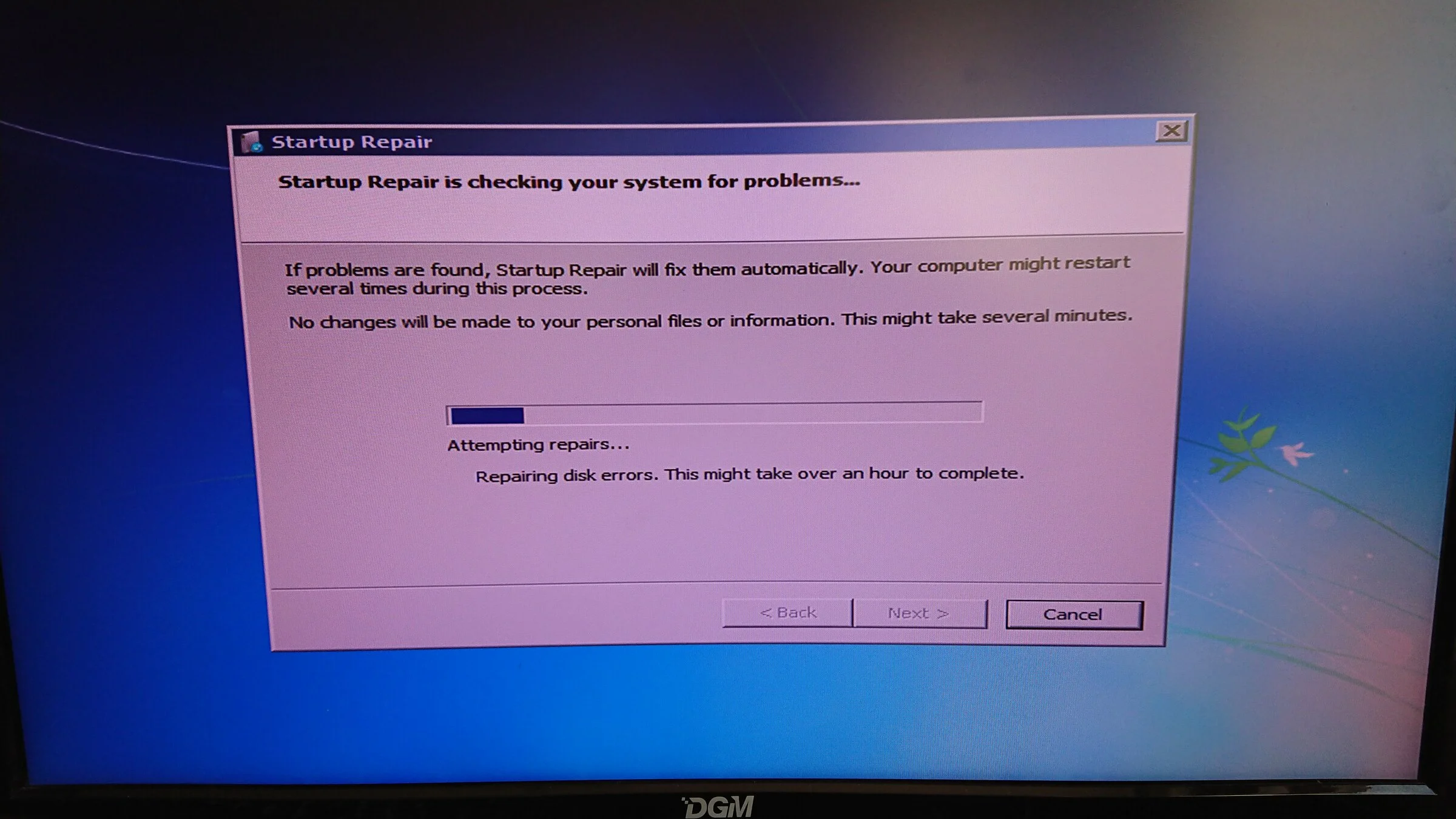

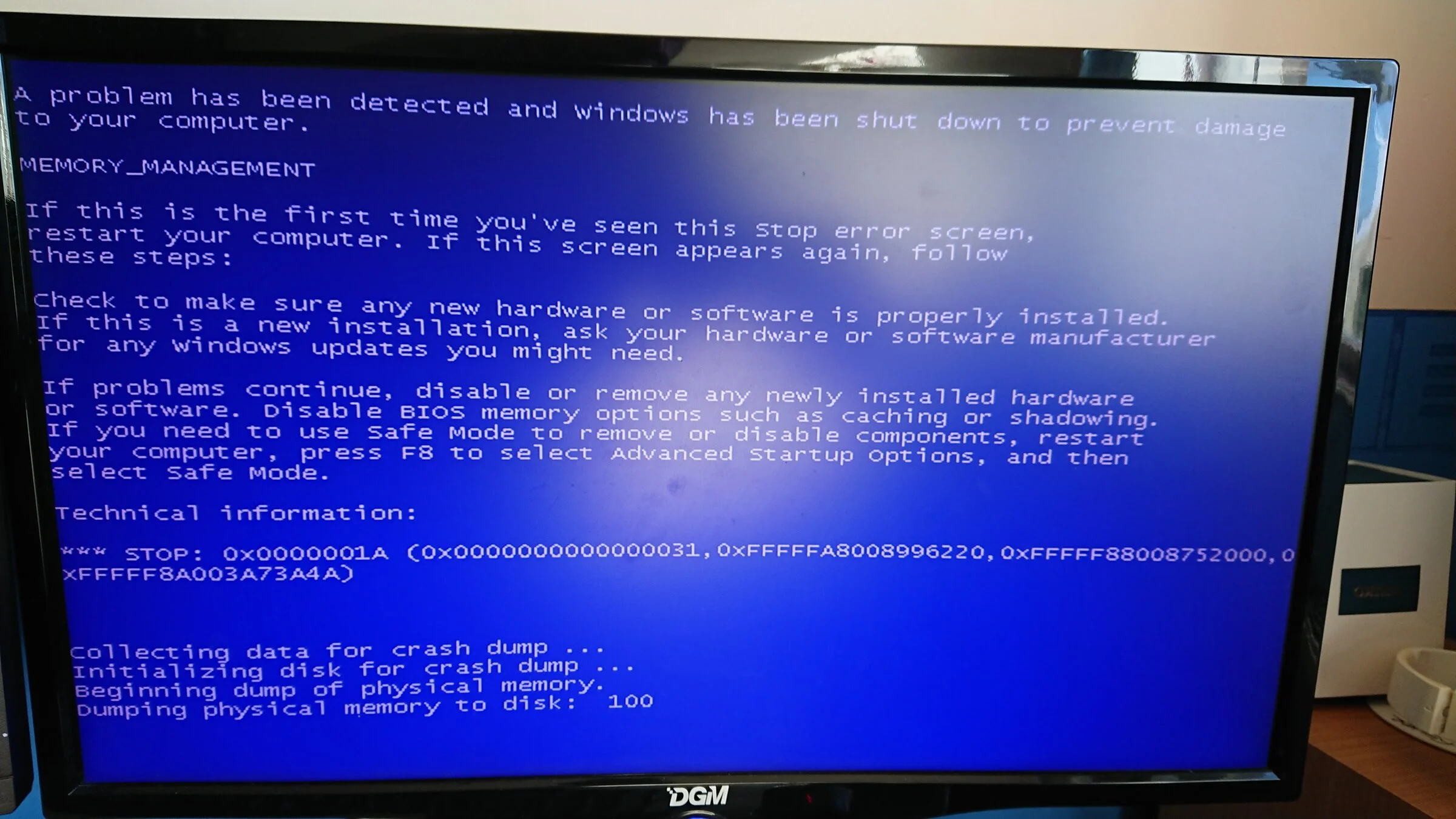

Had a "new" motherboard installed about 5 years back. It's been getting slightly slower recently and today went all blue screen of death. Restarting it only led to it trying to boot up/repair to no avail.
Took it to the local PC shop who said the hard drive is showing 98% and its shagged. He recommended throwing a SSD 120GB in and he will put Windows 10 on it for £140.00. He then checked the processor and said it is an i3 costarica dual core, so probably not worth fixing. He had a "rebuilt" tower with a quad core, 120gb ssd and 1tb normal drive he could let me have for £150 but theb I'd need a graphics card if I really wanted to run dual screens.
Really don't know what to do now.

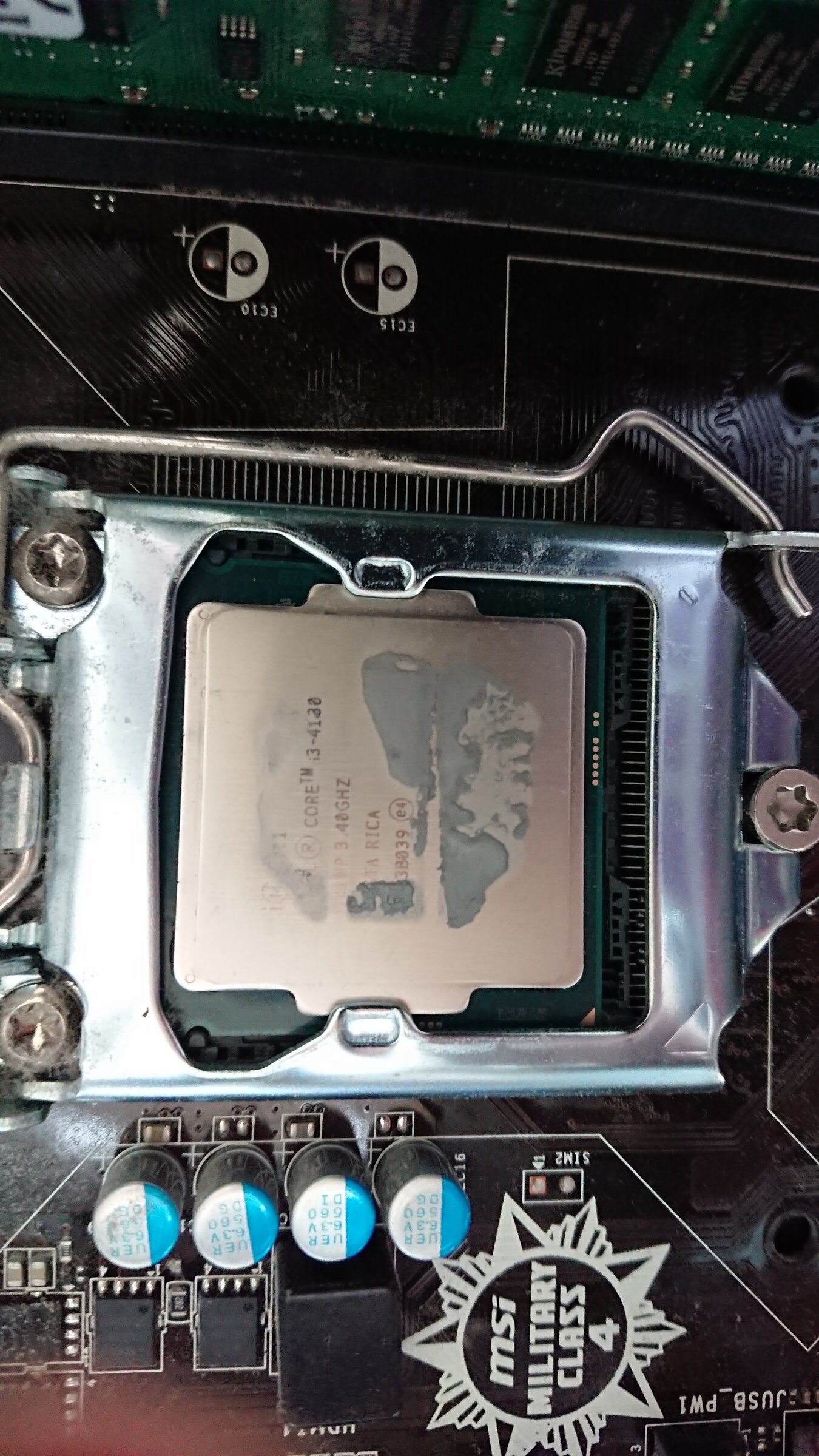

Update - Lad I know managed to slip me in an SSD at 240gb and put windows 10 on for me. All fixed for the princely sum of £50. Massive thanks to @Yorkshire Pudding for the offer, really appreciate it bud. When ripping it apart, I found out it's running an I3 dual core costarica CPU. I didn't bother upgrading that just yet, because it's not really getting used for anything hardcore. Although it is on my mind whether to change it out..... I should probably slap a bit more thermal paste on there too.

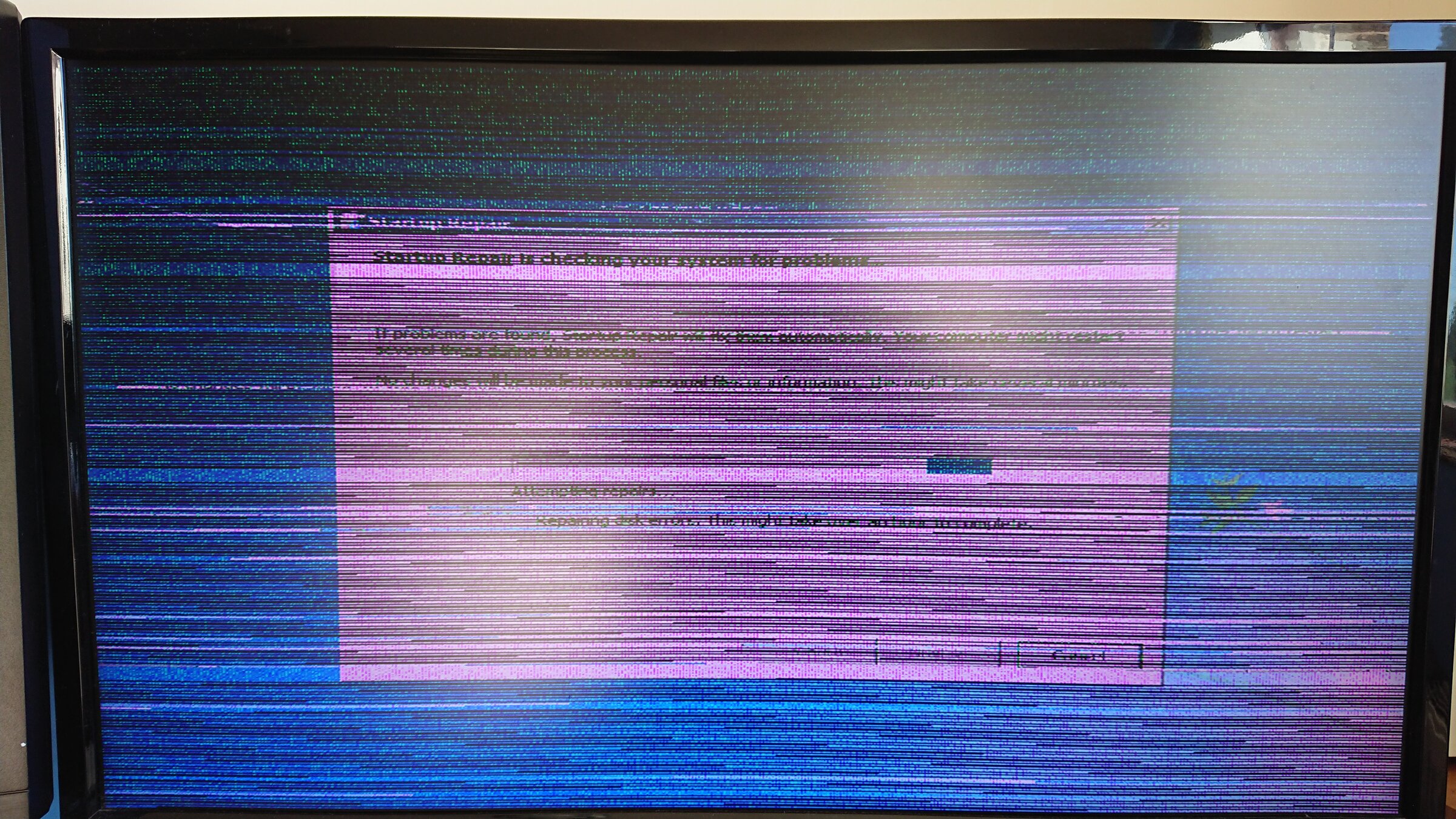

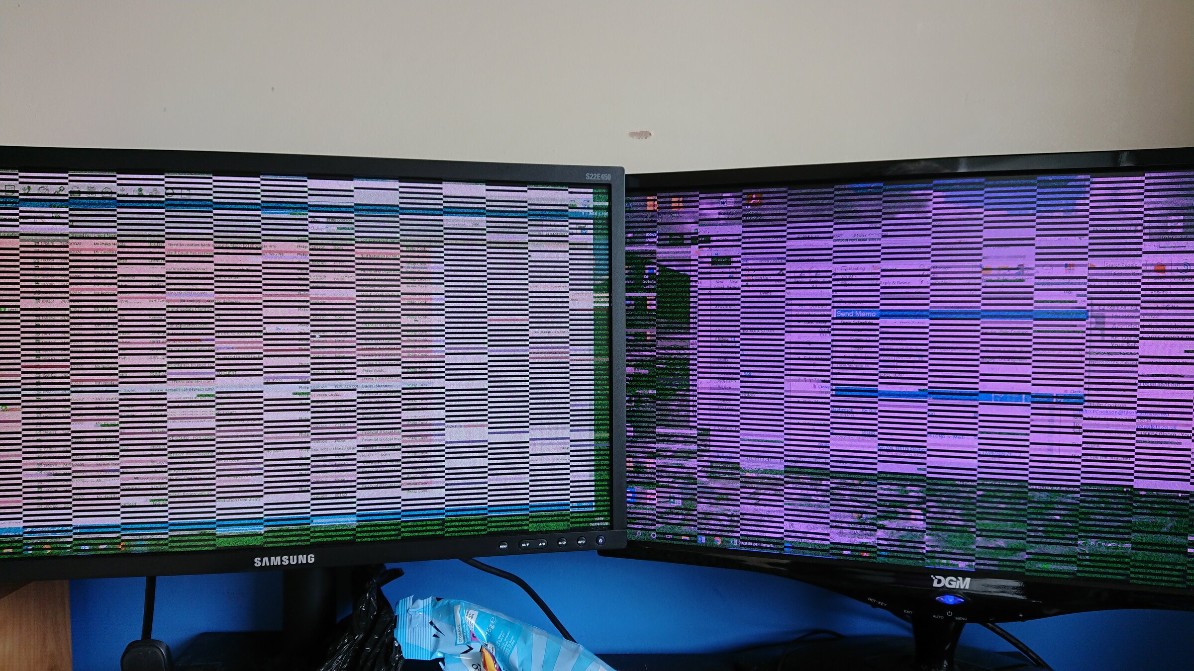

I don't know whether I will still need a graphics card if it starts doing that fuzzy screen s**t again. My monitors currently run DVI and VGA and both work fine, just sometimes it goes all weird, but I think I might be overloading it with youtube or something.
I've got a couple of 1GB cards, let me know what motherboard you've got and I'll see if it'll work when I'm back

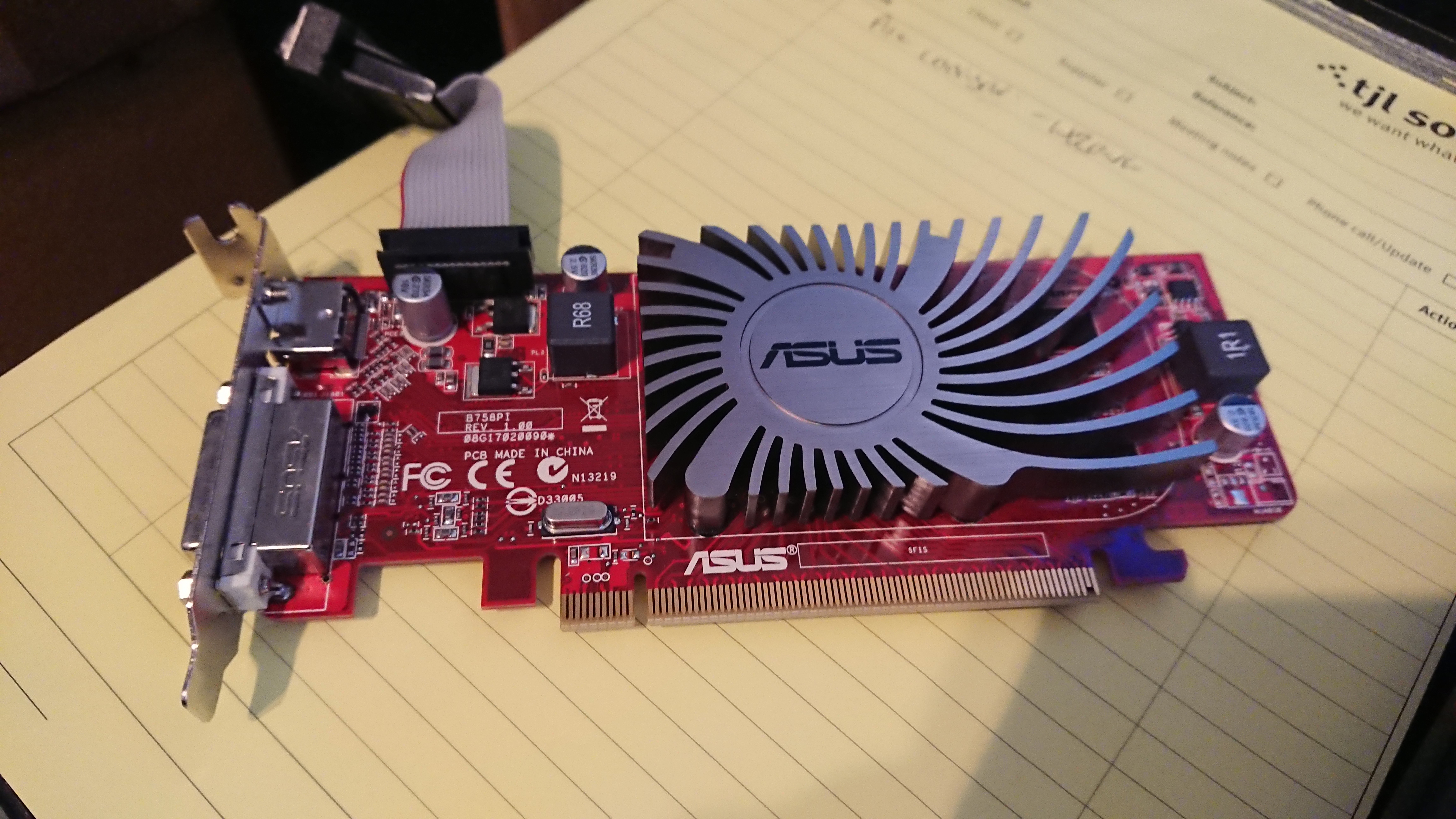

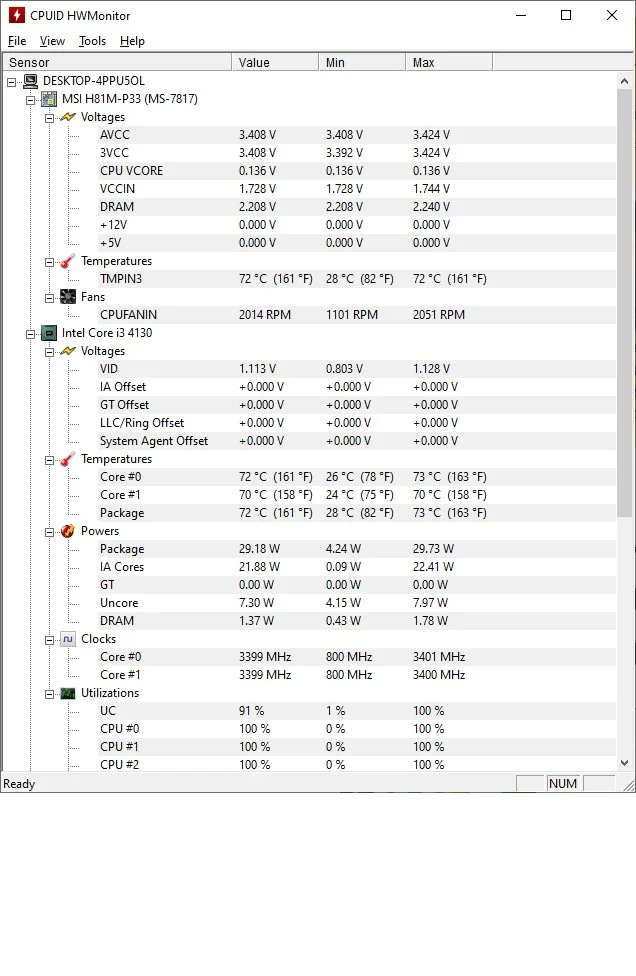

So, @Yorkshire Pudding kindly sent me over so some graphics cards. I've installed an Azus jobbie, and it seems to be working. But, it's just froze and did a clicky clicky clicky through the speakers. No fuzzy screens, but just jammed. I think the CPU is ballsed. Checked the temps and it's running around 64deg celcius normally, but when I whack youtube on and try to access my HD, it fires up to 77, and then cuts. So I think I need to upgrade that.
Again, can anyone recommend something I can literally swap out that isn't going to break the bank. The CPU has a fan on top of it already and ALL the fans running on the PC full chat

Soooooo, I took the heatsink off, cleaned off old paste as it was patchy as f**k. Put fresh paste on, put it all back together, and now it just trips out when I try to turn it on. The fans spin and within a second it just cuts out. Great.
As Yorkshire Pudding says - just reseat everything. Have to had the cpu out from its socket - you don't need lots of heatsink paste to be honest.
Seems I had forgotten that I unplugged the power cables for the CPU 😂 All back together now and working. Seems to be holding temps better on the processor too, so fingers crossed that's the glitch fixed, otherwise I'm likely to hoy it out of the window on the M62 and let an Amazon lorry smash it to bits.
