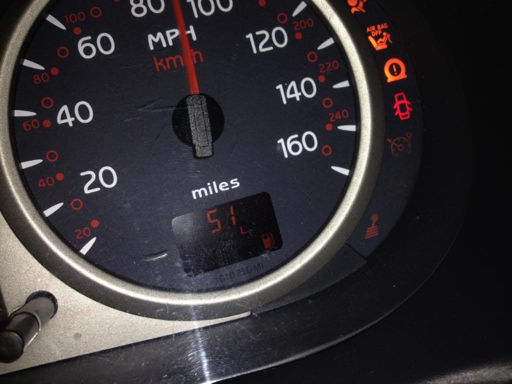

Ok thanks I did the reset thing and it beeped and gave me this screen? Is that right?

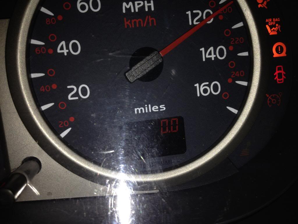

the screen I get for tank range is this and the dashes just flash. Does flashing signify a fault because the average mpg shows the same dashes before giving a reading but they don't flash?

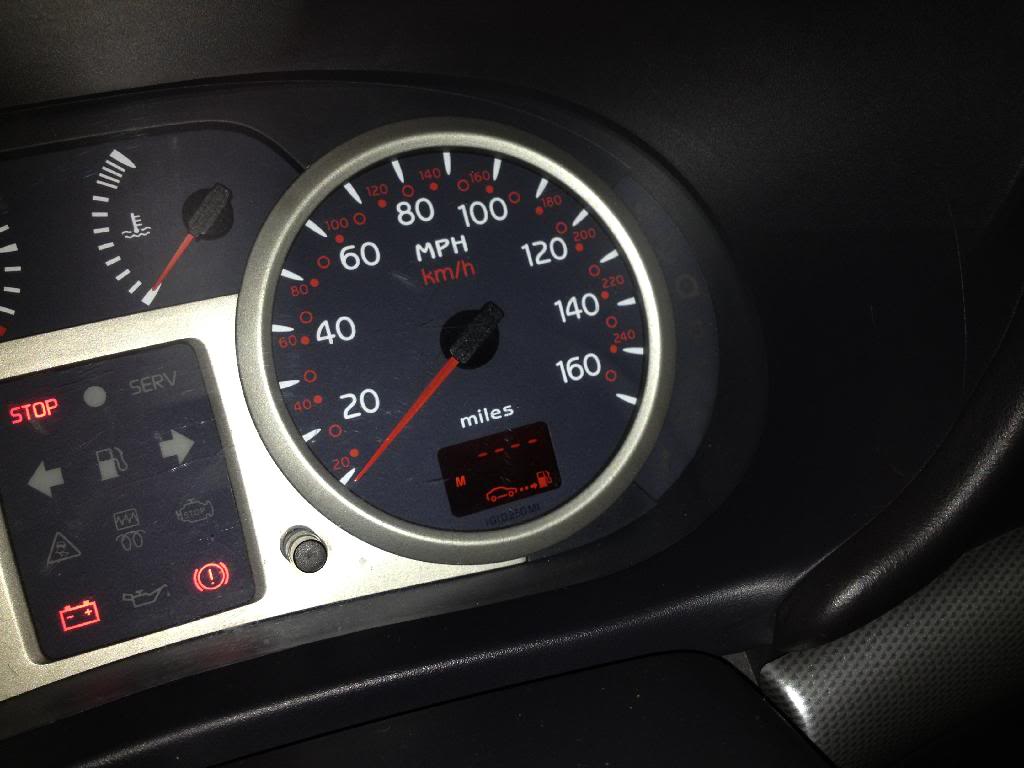

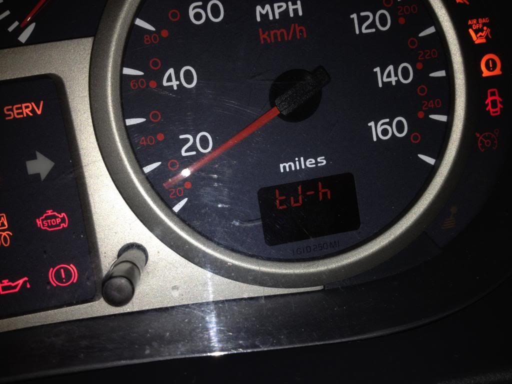

Just remembered I had this same issue. When you've got it like that first pic, press the end stalk button again until the display shows a few dashes with maybe one or two letters. It's a sort of diagnostic thing for the car, and there's a guide on here as to what the letters mean but it will probably be one relating to the fuel level sensor. Press the mileage reset button when this is up and it should go back to showing 4 dashes. Ignition off, and then once you start the car up again the miles to go screen should be working again. That's what worked on my car anyways
Injector fault
oil level sensor fault
and fuel tank sensor fault
full house for me lol

First pic is fuel level, second is fuel flow, third is the fault codes, although you probably already know that now if you've found out what the codes mean lol. I'd just go ahead and clear them, if they come back again then you worry :p
