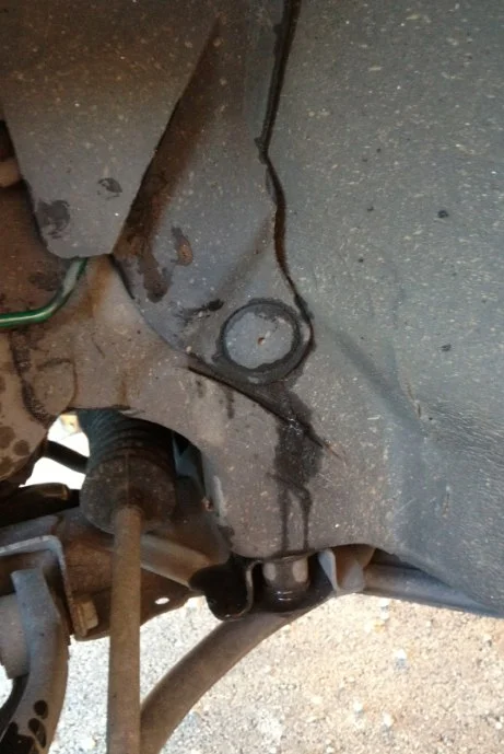

I noticed that my coolant level was below the minimum level yesterday when doing my brakes. The engine temp is normal at the moment. I also spotted this inside the passenger arch:
I was planning on topping up the coolant until I can get a garage to look at it but am not sure which type of coolant I should use. Reading around Renault Type D is the one? When I bought the car is had red/orange coolant.

Thats normal in the passenger arch iirc the drains from below the scuttle panel come out near there. unless the header tank or heater matrix hoses are split/leaking
I did think this could have been drainage from the scuttle panel. I'll have look and see if I can spot any splits or leaks.
