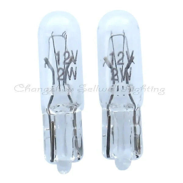

you can get them from halfords.... t5 capless wedge bulb is what you want. they look like this:
when i had to get them, there were 2 types of wattage. i think its the higher wattage you want, but dont quote me on that

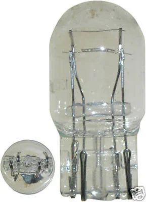

if it looks like this:
then that is wrong.
i think you need one of the above for the courtesy light near sunroof tho.
