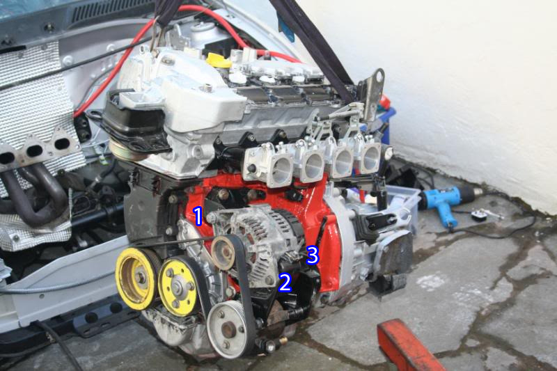

You can nip the aux belt up yourself, they do need to be a little tighter than other cars.

How easy is it to nip up the aux belt? I can't even see a tensioner on there. :smile:
adamlstr
Loosen 1 & 2 just slightly.
Tighten 3 to tension the belt.
Tighten 1 & 2 back up.
Loosen 3 just a little to take the tension off it.
Thanks for that I see now. :) The belt does seem pretty tight already so I will onlt just tweak it slightly. I don't want to overdo it. :)

Changes in geometry under power. Squishy rubber mounts that give a nice ride don't help. Hence why Ford and Renault started farting around with more complex front hubs. You'll get used to it or if it is really bad then investigate tired bushes. Wheel hop from a standing start when you give it the beans can be a sign of tired wishbone bushes. A lot of alternator belts seems to only need 5mm of deflection in the longest run these days which is really tight. I'd keep going to it stops squeaking or considering they are so cheap get another one and make sure the pulleys are clean as the old belt may have got a little shiney from slipping and getting a little hot. Had a 106 diesel that had that problem.
