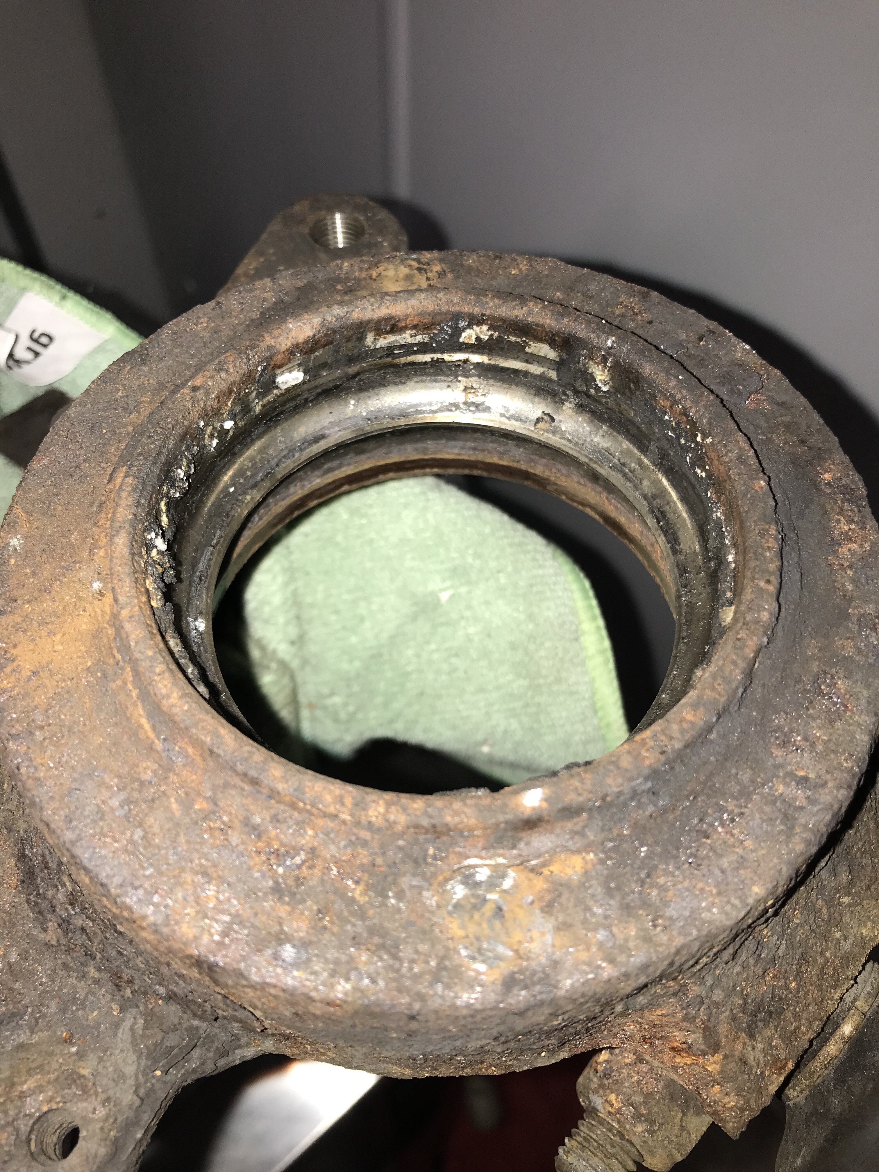

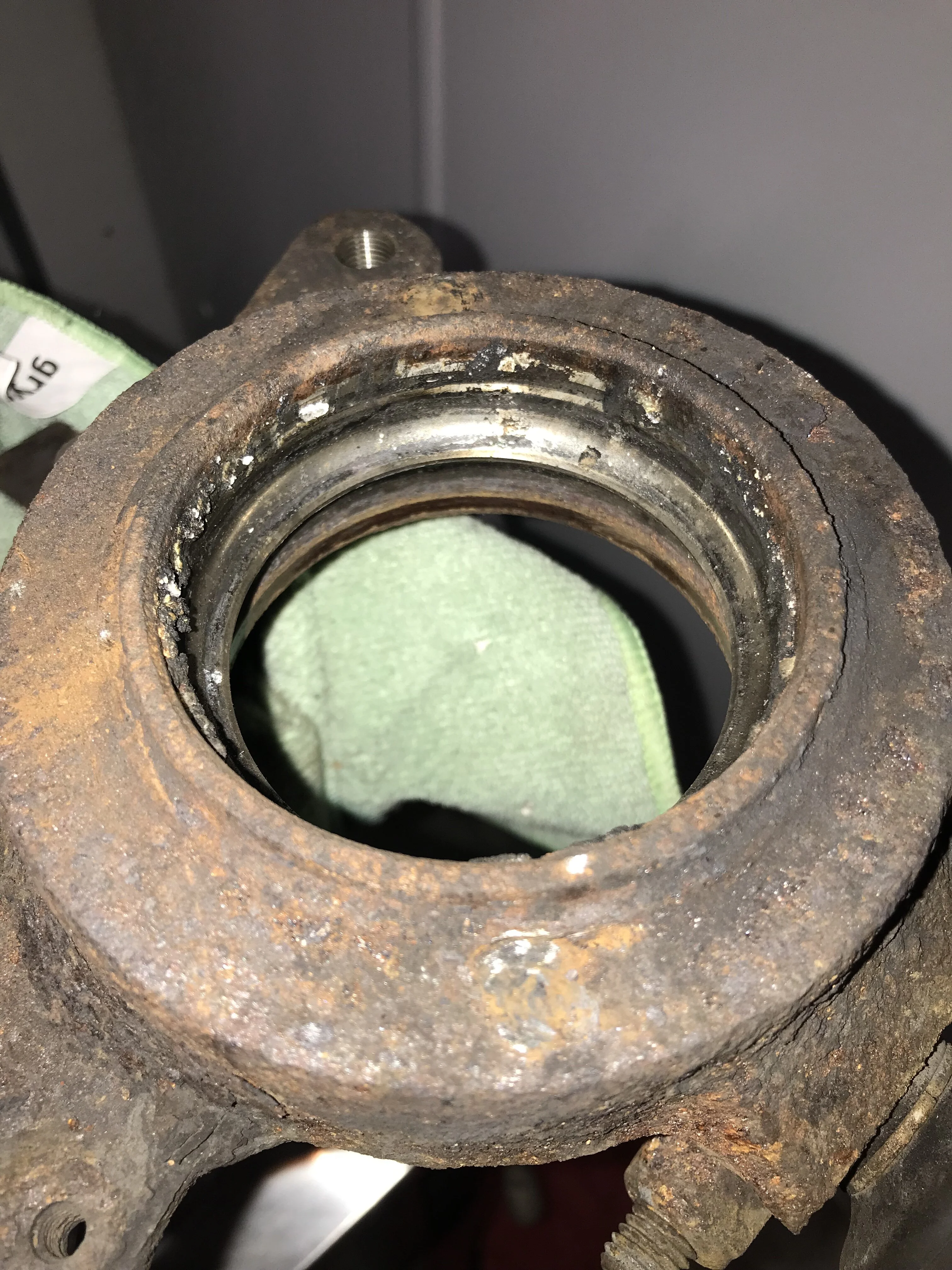

@Touring_Rob Remembered you had a problem with the hubs and deox c, as too much material was removed from the bearing surface.
Just wanted to check how long you dunked them in for with the bearings in place.
And what about the caliper mounting and suspension faces? Did you just paint them and sand them back after?
Hi mate,
First time round I left them in for a week (mistake). Second time round I left them in for 24hrs, initially the mix was nice and warm. No issues.
I did not cover any caliper mounting faces etc. and could see no visible issues second time round - although Deox-C will go for iron, it didn't seem to touch clean faces with no corrosion in the 24 Hr period so I wouldn't be too worried. The bearing faces are worth protecting either with grease or by leaving the bearings in place.

Hi mate,

Thanks! I was getting worried thinking I should just leave them in for 5 hours or so but clearly It will be alright!
Bearing outer race still in as are the clips. They are basically one with the upright. Im thinking the deox will help loosen things a bit with the clip so I dont have to make a mess with the angle grinder, then Ill paint them for new bearing and hub!
So I left them in for around 4 hours, then removed them, rinsed off and hit them with a wire wheel on a drill. If you can get all the rust scabs and loose shale off, then put them back into the deox you will get a much better result... first time round I just left them in for so long hoping all the rust would go, where as if you help it along mechanically you get the same result but with less time in the bucket.
I got nearly identical results with Citric acid btw, which is 1/10 of the price.

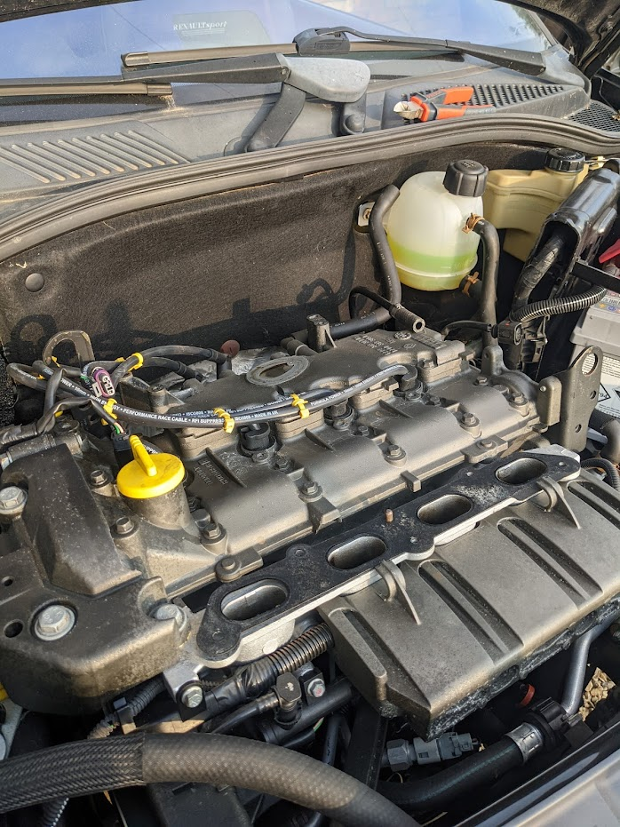

Inlet off
Summarises my overall mood at this point pretty well:

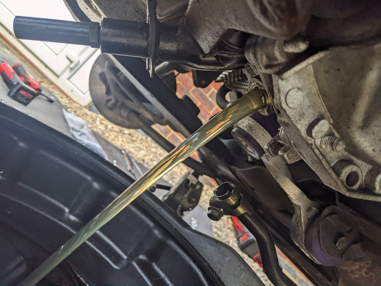

Box oil came out looking lovely which is actually very good news:
However with hand stuck in passenger tripod I can certainly feel some odd clicking.... hmmm.

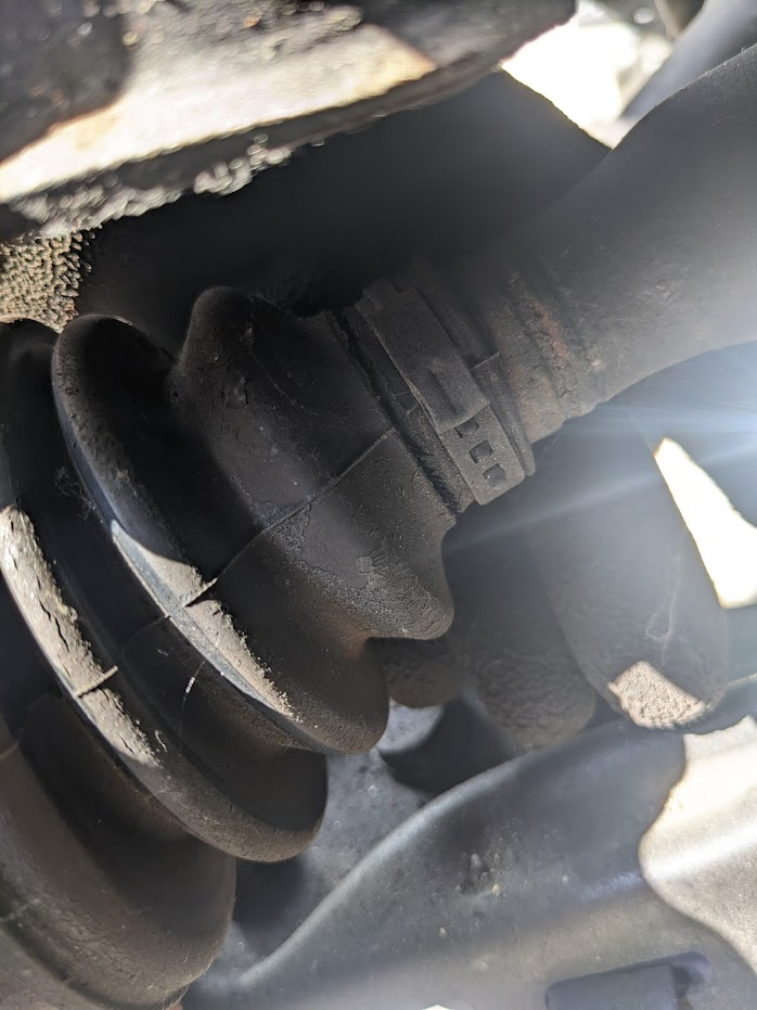

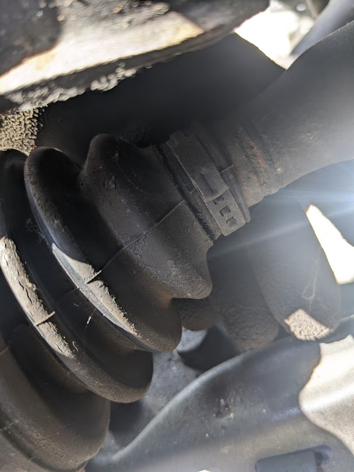

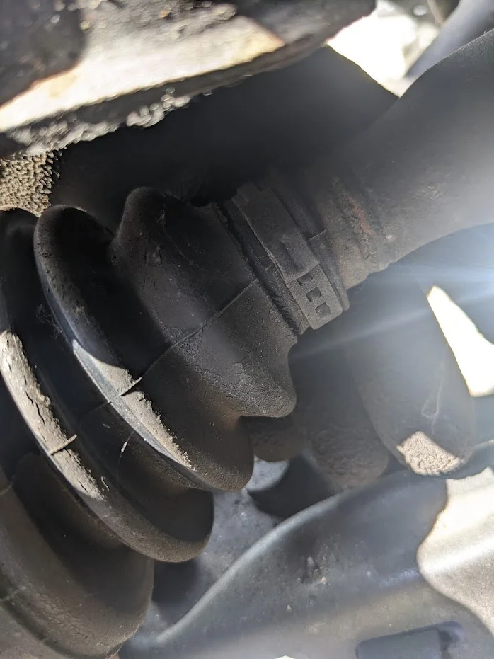

For the love of god, can someone explain why every CV boot I buy - even the expensive ones seem to be made of dog s**t?
New shaft, proper Renault one - done already, maybe a year old... 2000 miles max:

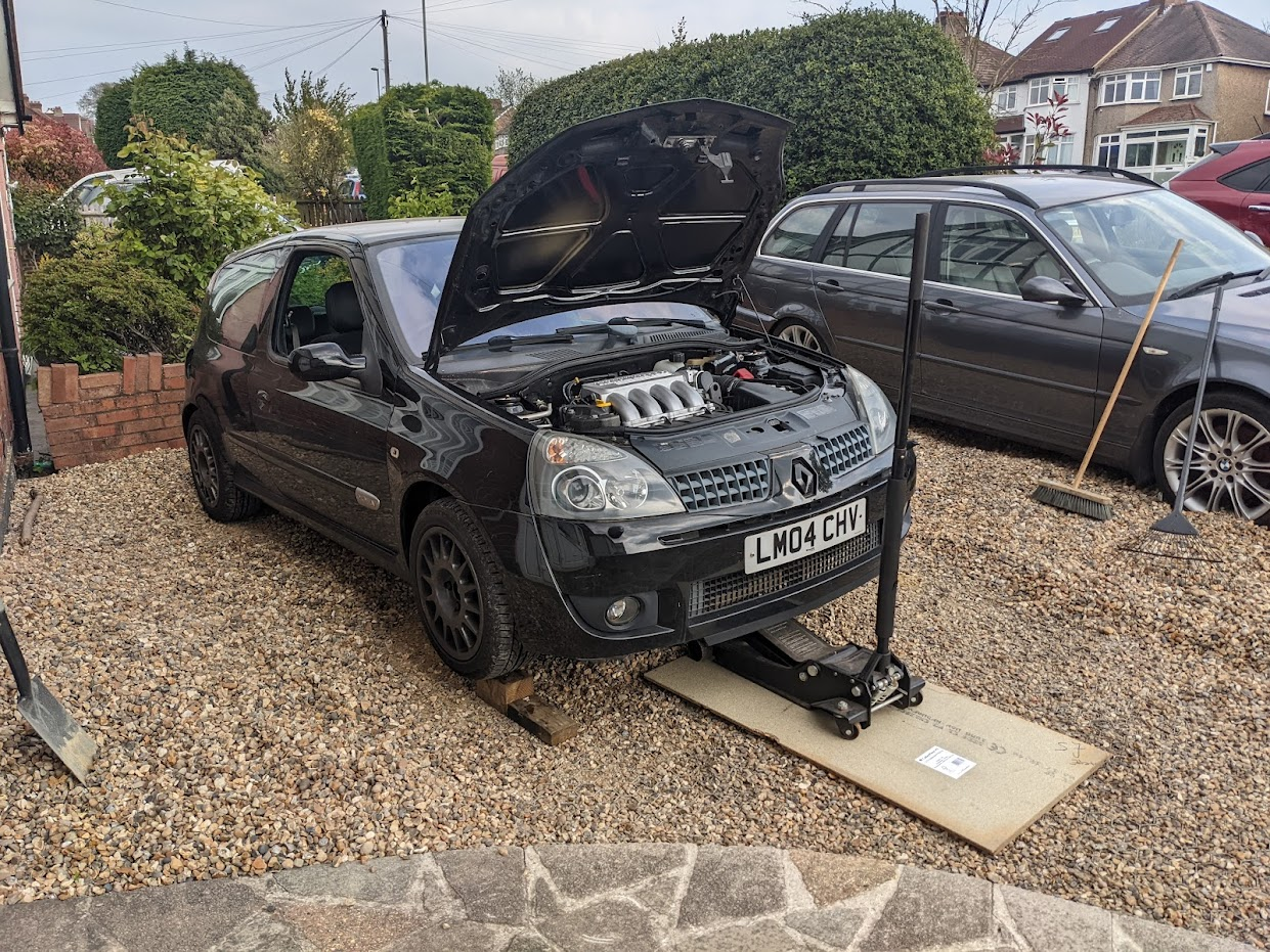

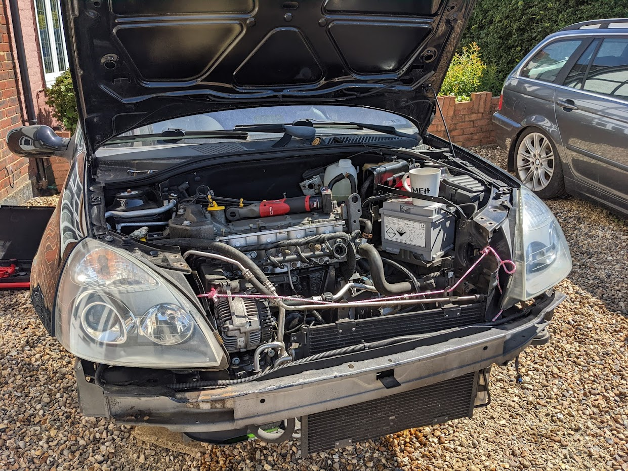

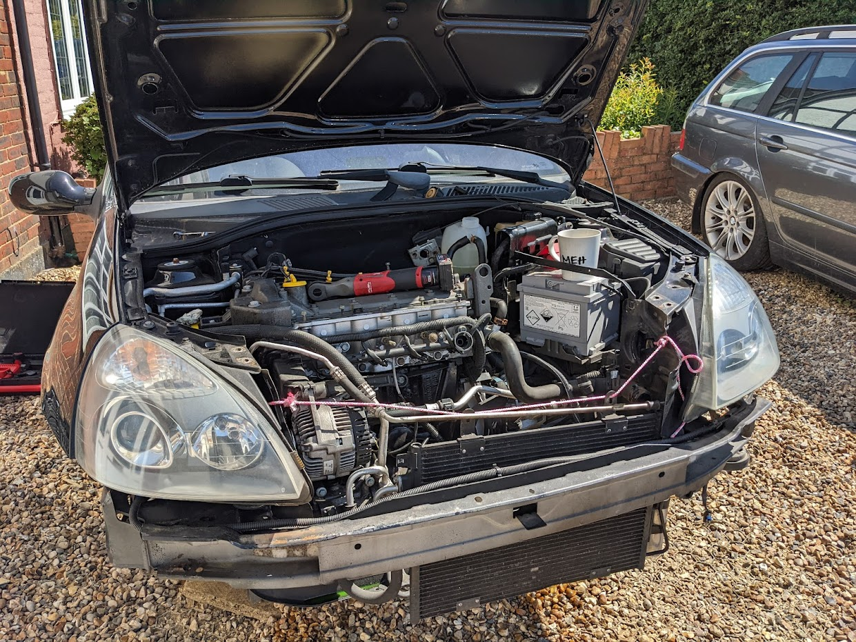

Seeing as how my sump seems to be leaking badly and I have an engine crane I've decided to just pull engine and box out from the top. This time round I'll likely reseal rocker cover gasket and change main crank shaft seal while I'm there as I can't be arsed to take the engine out again (ever) and doing belts with lump out it so much easier -although cam belt is no where near due I'll give it a new one and retime it all however water pump, dephaser etc are all still basically brand spankers.
Very slightly thinking of doing group N timing this time round but don't think I'll have the time to book in for a map.

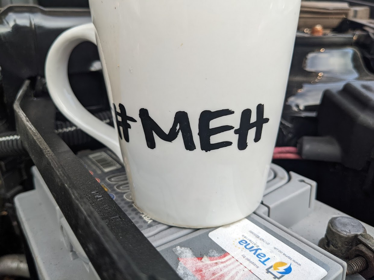

Got very bored doing it today and my dad came round to drink coffee and talk so engine didn't pop out as anticipated but its ready. All coolant pipes off, AC compressor is off and tied up, just need to drain steering fluid (as the lines loop over the box) and drain engine oil then I will be yanked out.
(same mug again, same feeling)

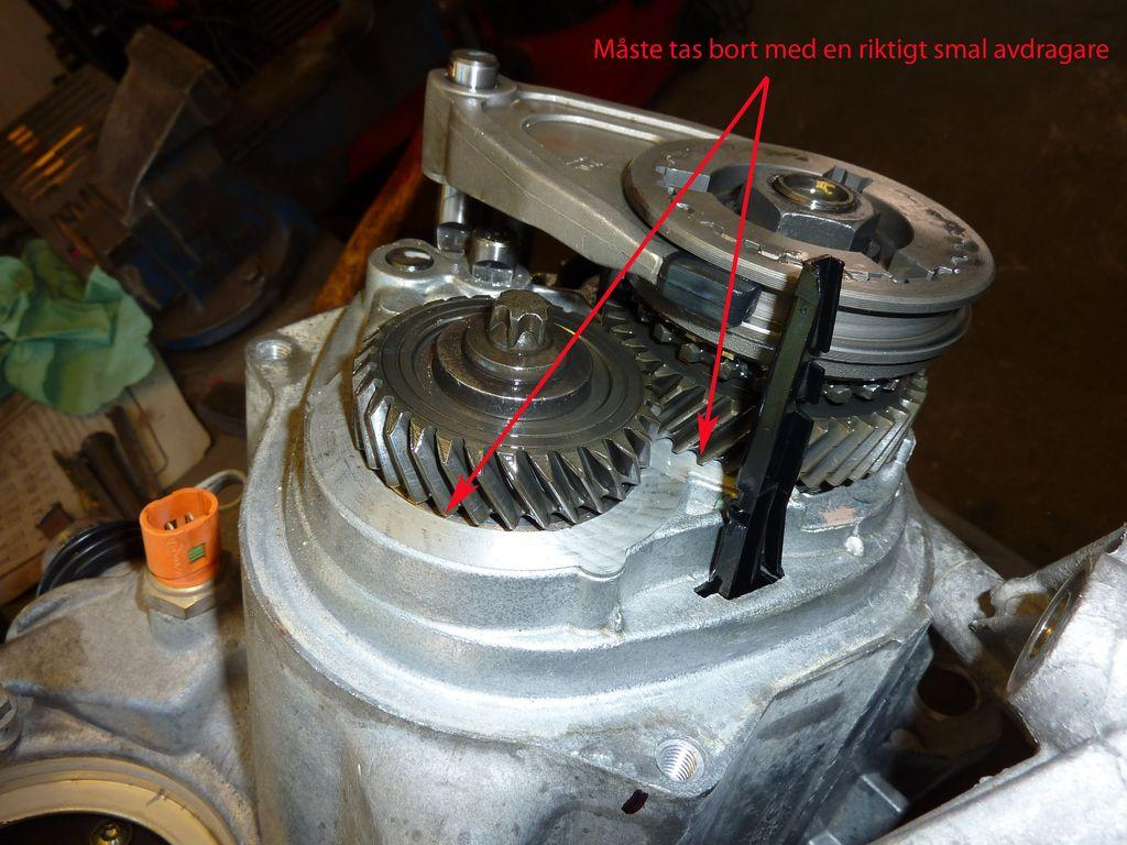

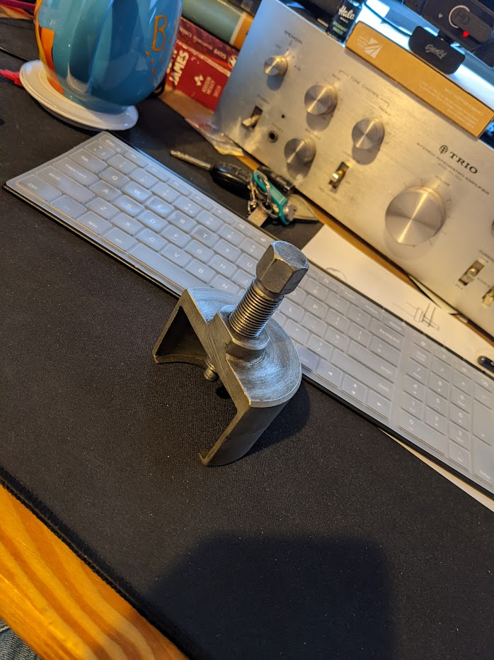

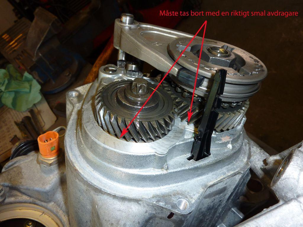

Super lucky to stumble across this on German eBay:

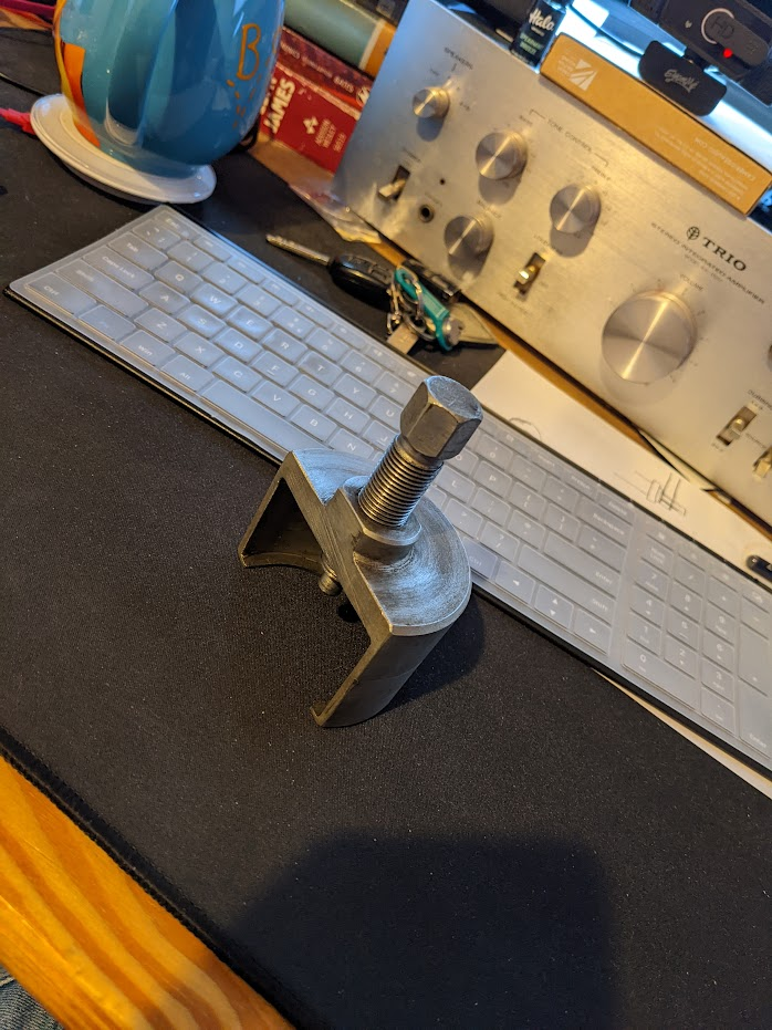

Its the Volvo special tool (some Volvos also used a JC5) for removing this nugget on the left:
I don't have the tool to remove the larger 5th gear however I am fairly confident a small puller will work. My dad has quite a collection so I'll be raiding that. I'm not really looking forward to it as I'll need to source at least one bearing and likely some shims - the others were changed (apparently) together the syncros and third gear when it was rebuilt by Agency Transmissions a while back - syncros still feel fine so I'm not expecting to have to change anything overly expensive but I guess we will see!!!
Need to dig out the JC5 rebuild manual I have downloaded (somewhere) when I last read it I believe it lists one bearing which must always be changed when the casing is split and also had part numbers for shims - hoping to not have to buy a complete shim set, if I'm lucky I won't need to re shim anything.

Seriously mate, buy the jr driveshaft boots and cut off the outside largest rib. Use a hose clamp front and back and you'll have zero issues!

I'm pretty certain you've told me about the JR boots before - I'll get it done!
