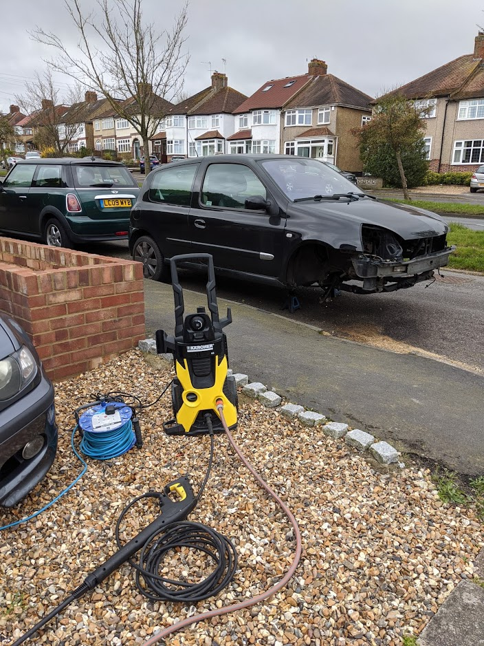

Pictures just to show general condition of car etc. Its feeling a little tired at 80k, its got a decent service history but has all been done economically by garages, like just changing one front shock absorber etc?!?!

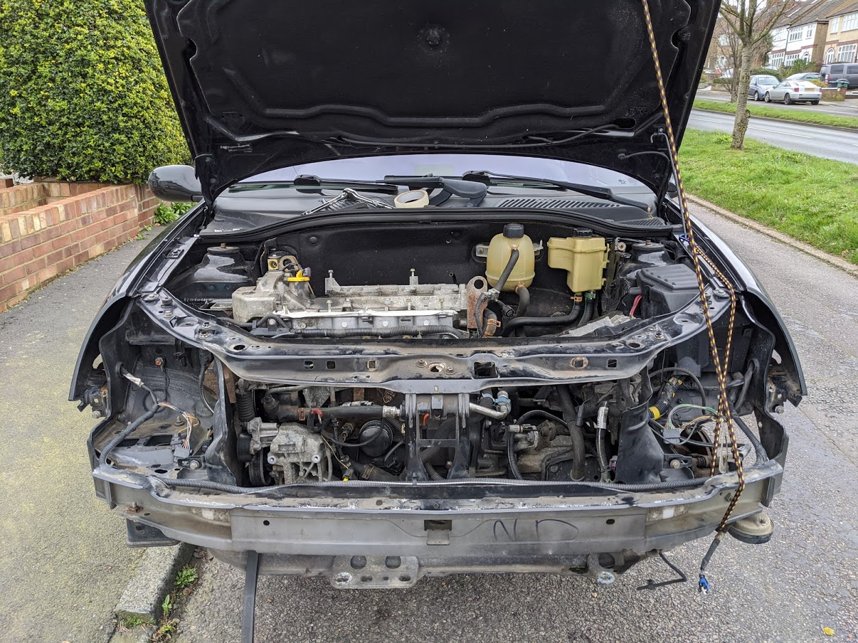

With the engine out it was somehow dragged down a rough drive and up a step into the back garden

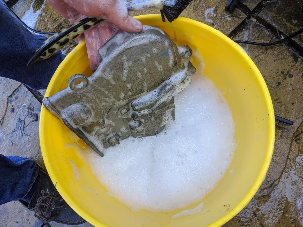

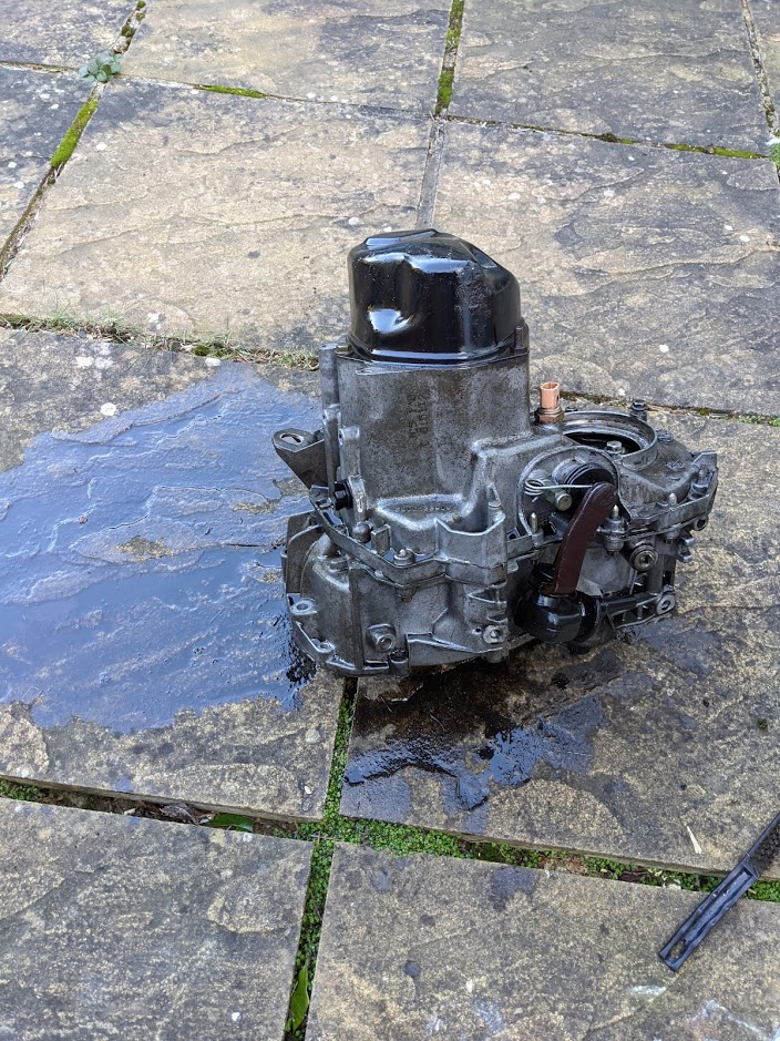

At this point I decided to get the box rebuilt by Agency Transmissions, no sense in replacing it with a crunching third. Wanting to make a good impression I gave it a good degrease and jet wash.... yes, that is box fluid, and yes she did shout a lot!

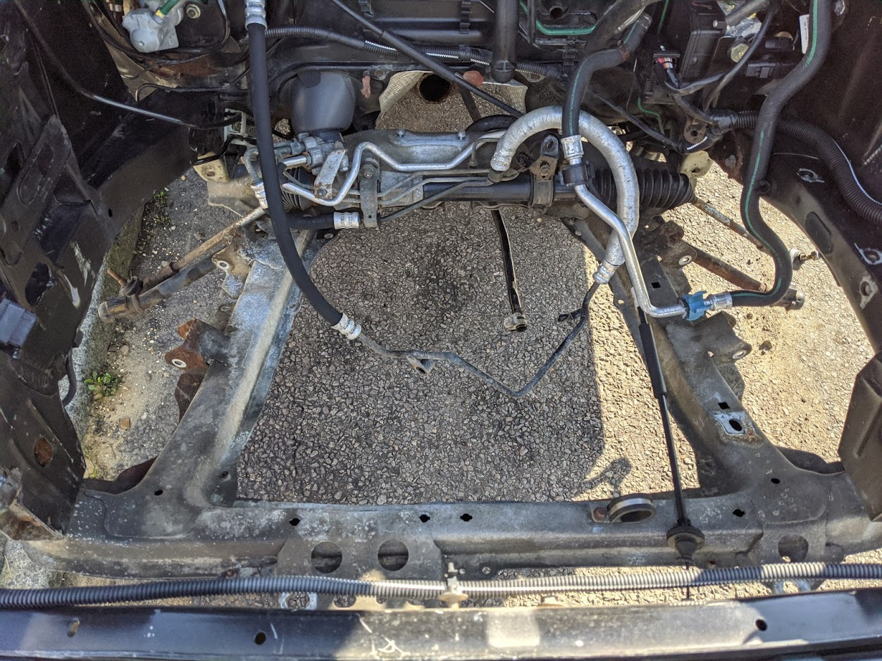

Being a terminal idiot I just kept removing parts, finding more dirt and removing more stuff. With all the bits removed bay was starting to look alright

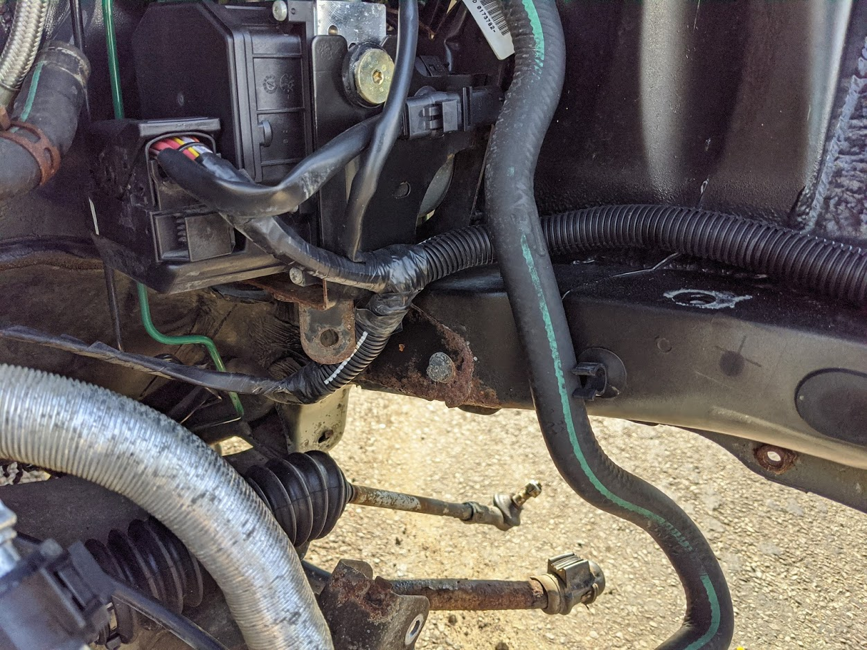

Found a few bits of crust hidden behind brackets etc,

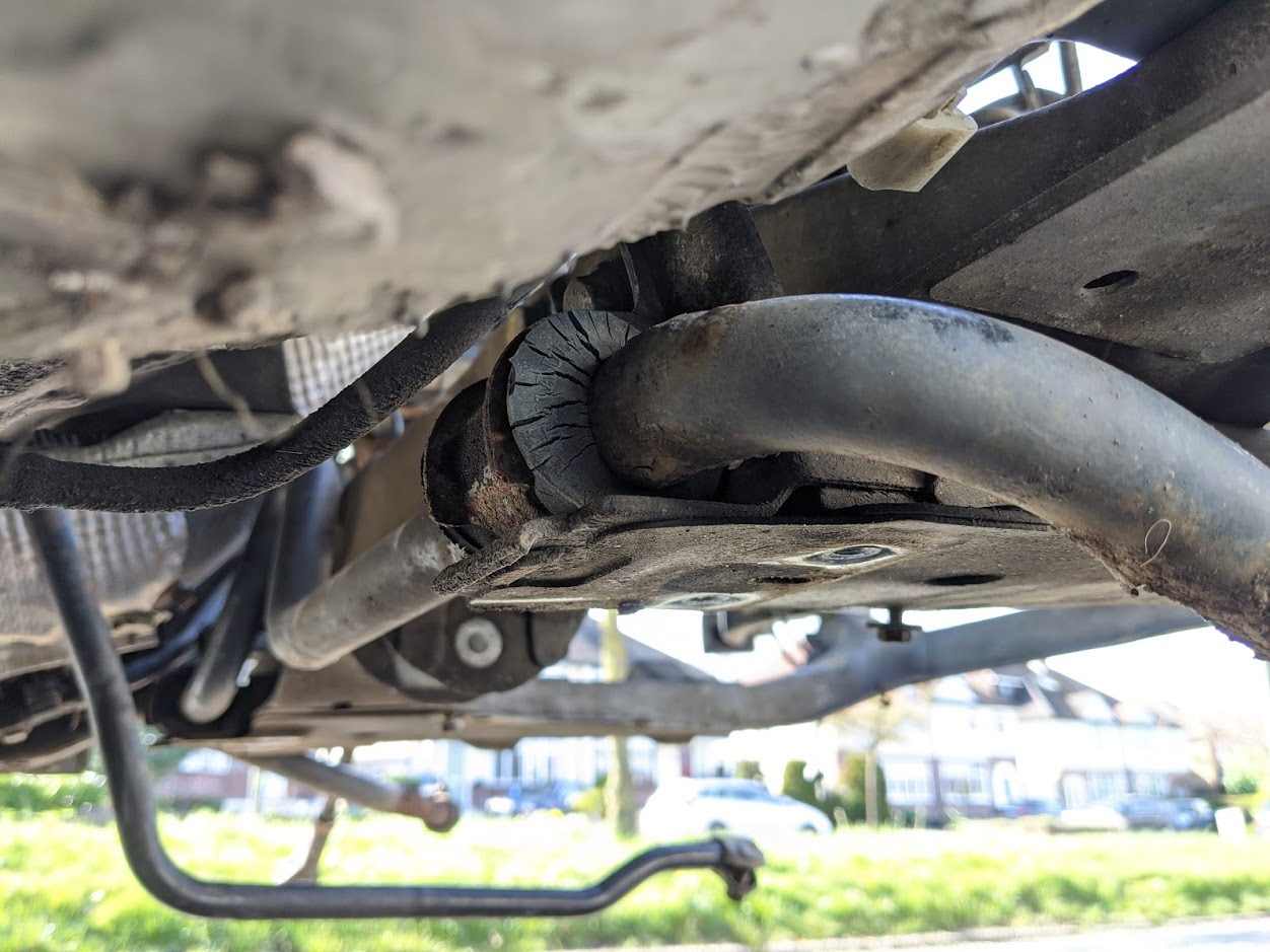

Bushes looking 'past their best'

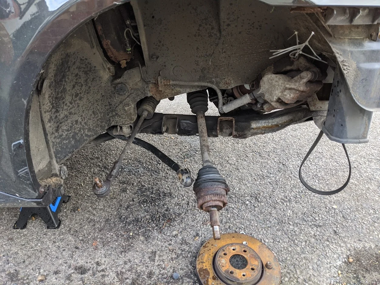

Inner/outer track rods
ARB brackets
Steering rack bushes and brackets
Powerflex ARB inner and outer bushed from Awesome GTI

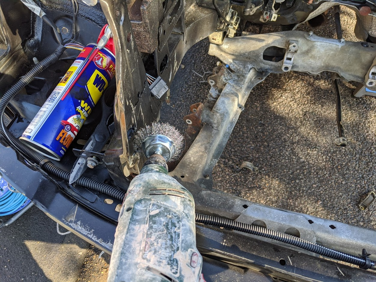

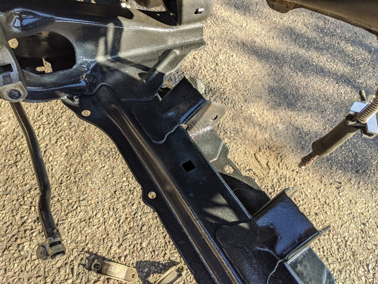

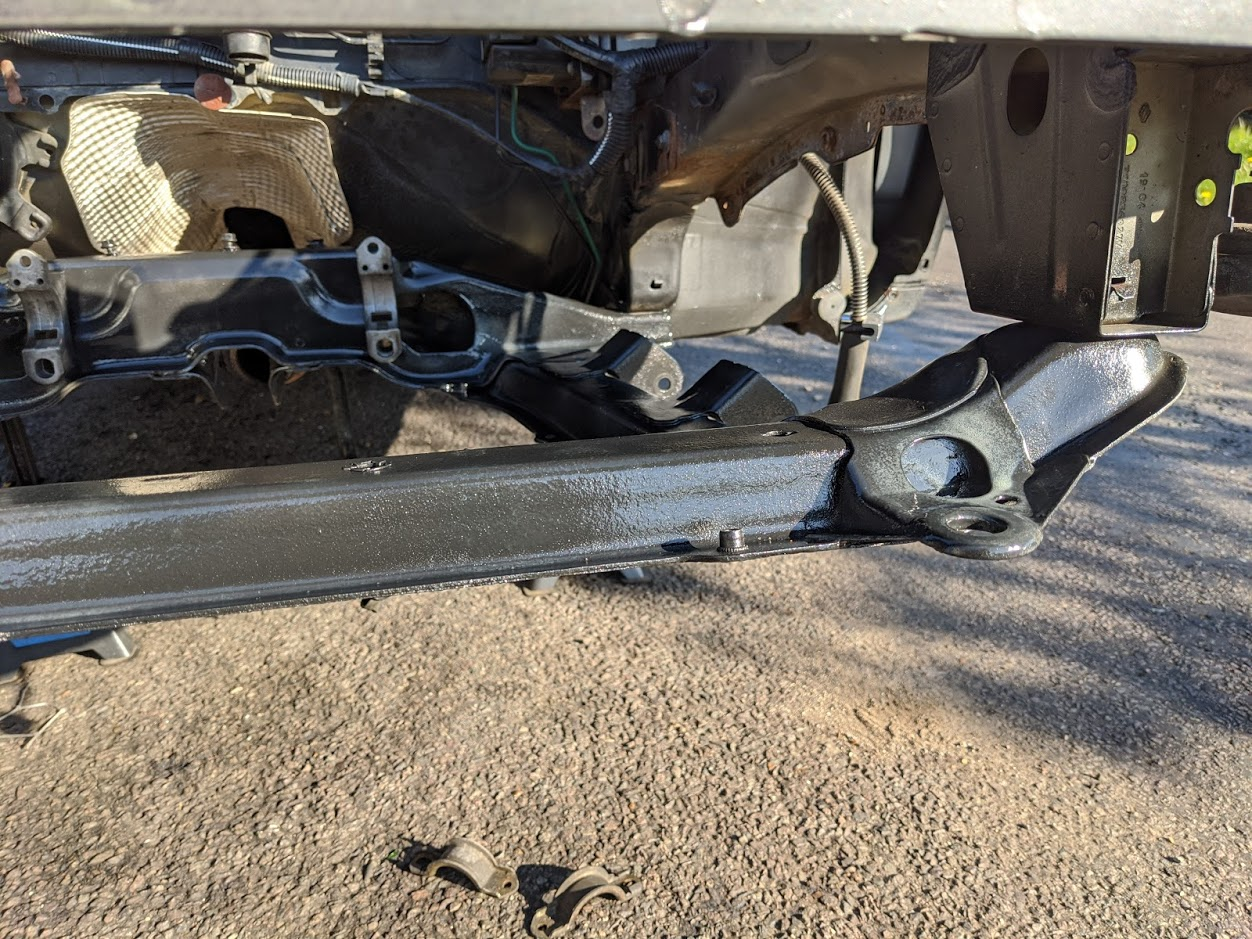

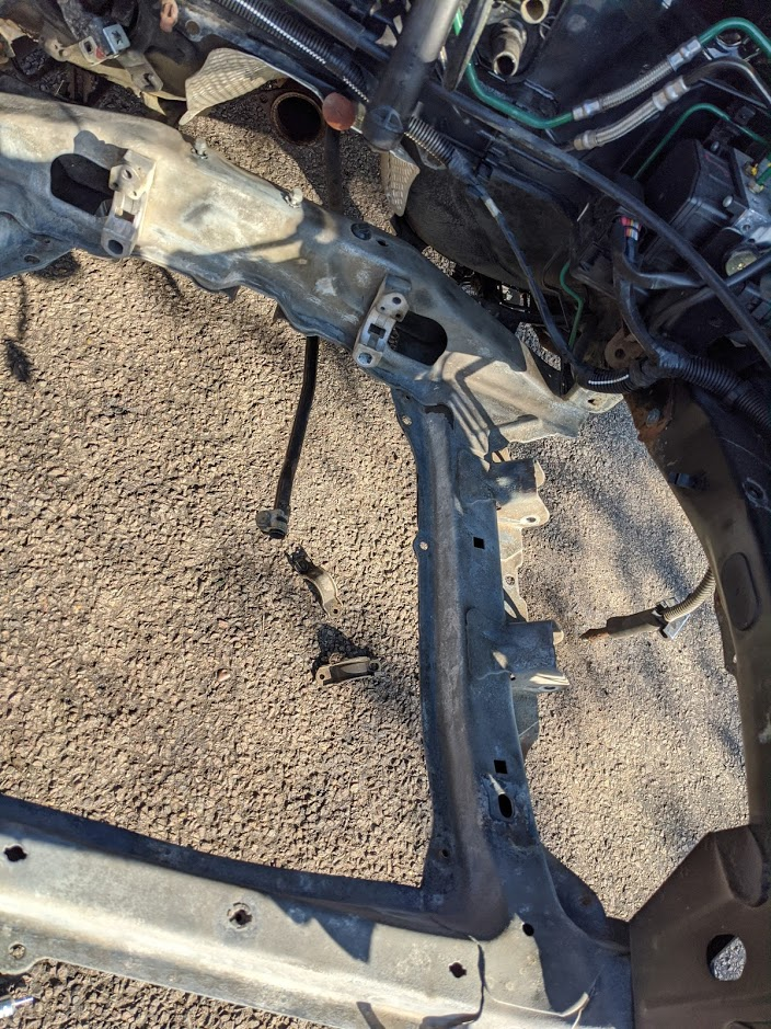

And made an order with FROST for some dinitrol and wire wheels. Time to set about the manky looking subframe and the scabby bits
After it had been wire brushed it got epoxy mastic 121 and then a coat of Dinitrol 447, came out looking alright. At this point I had pretty much decided that I wanted to get the car to a point where it would survive another 10-15 years with minimal maintenance only, figuring that I could sell it after some fun with a clean conscious. I've restored a few cars in the past and have always gone too far, I wanted this to be something presentable but not show worthy that I wouldn't feel bad about for driving in the rain etc.
Front ARB was wire brushed, painted/waxed. Fitted a set of Powerflex purples

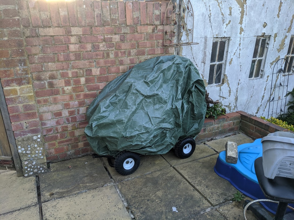

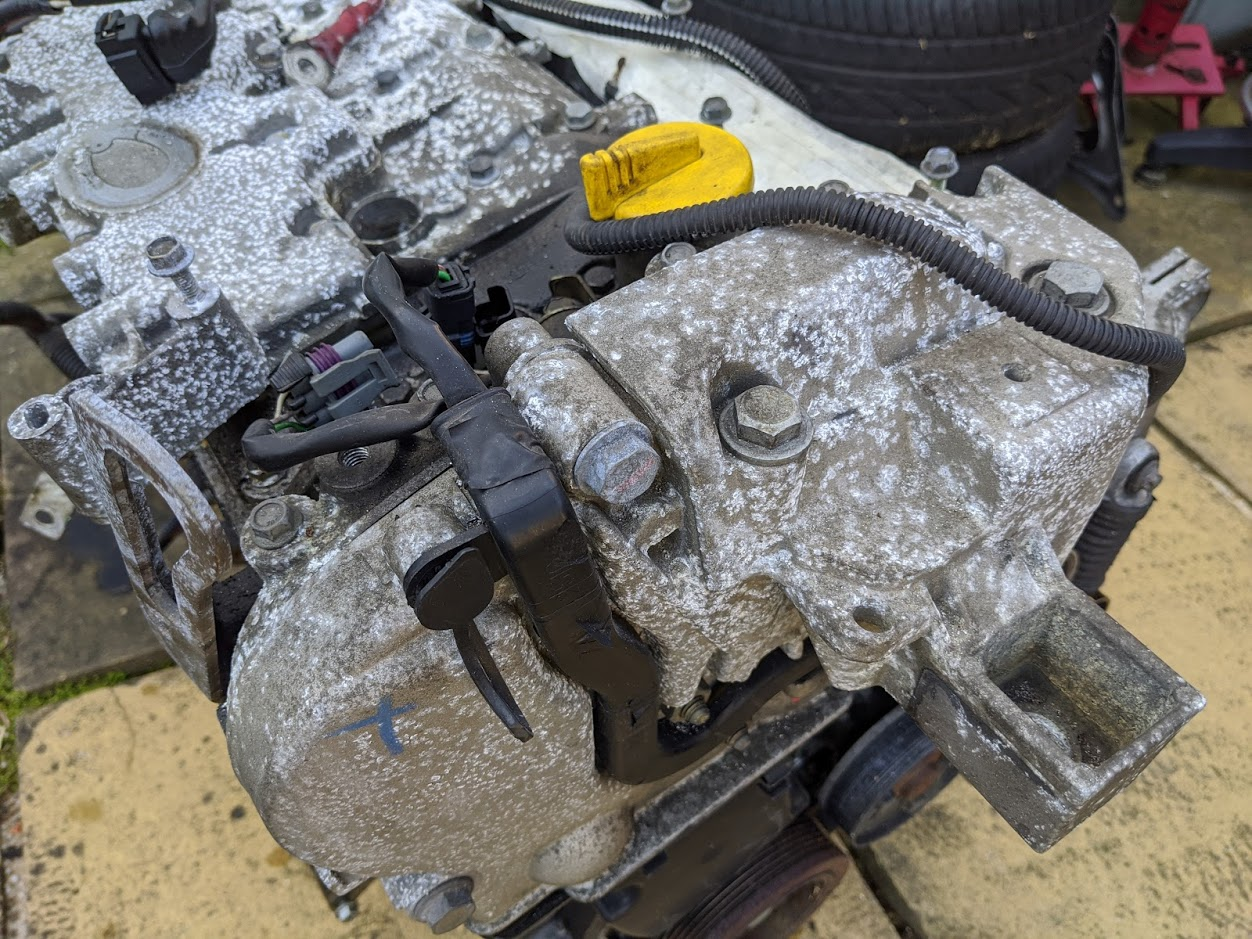

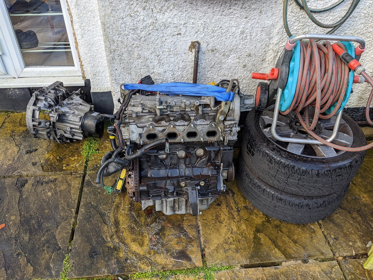

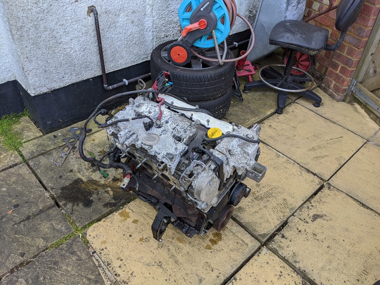

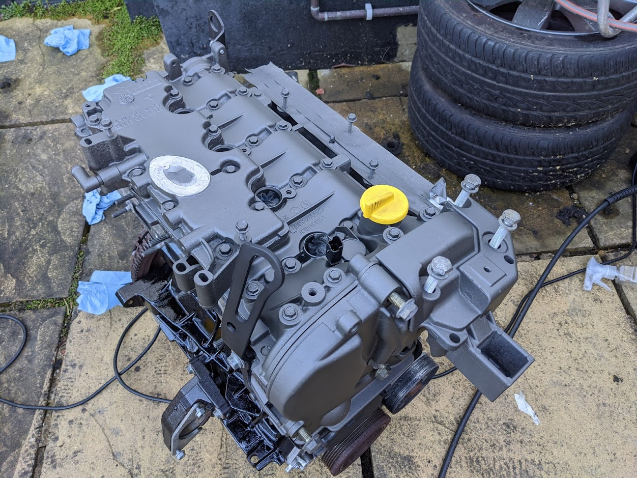

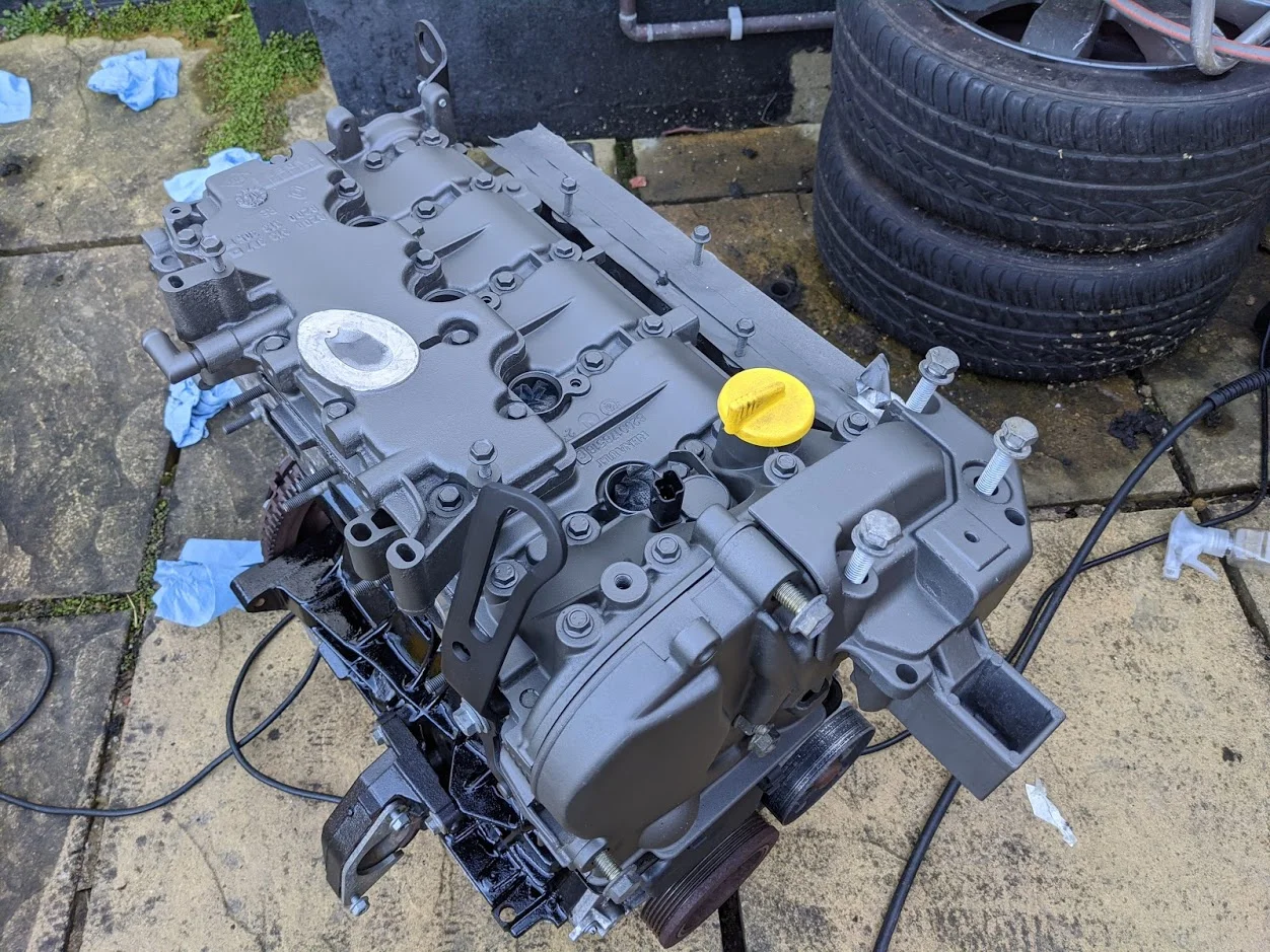

Still no gearbox..... Engine had been under a cover in the garden for a few week at this point and looked absolutely terrible

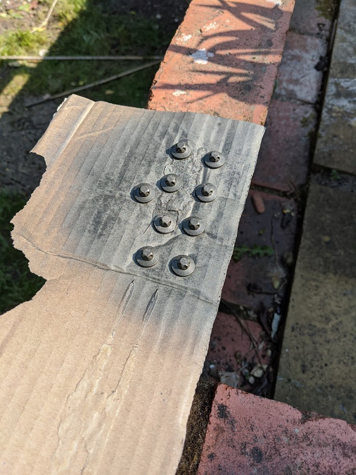

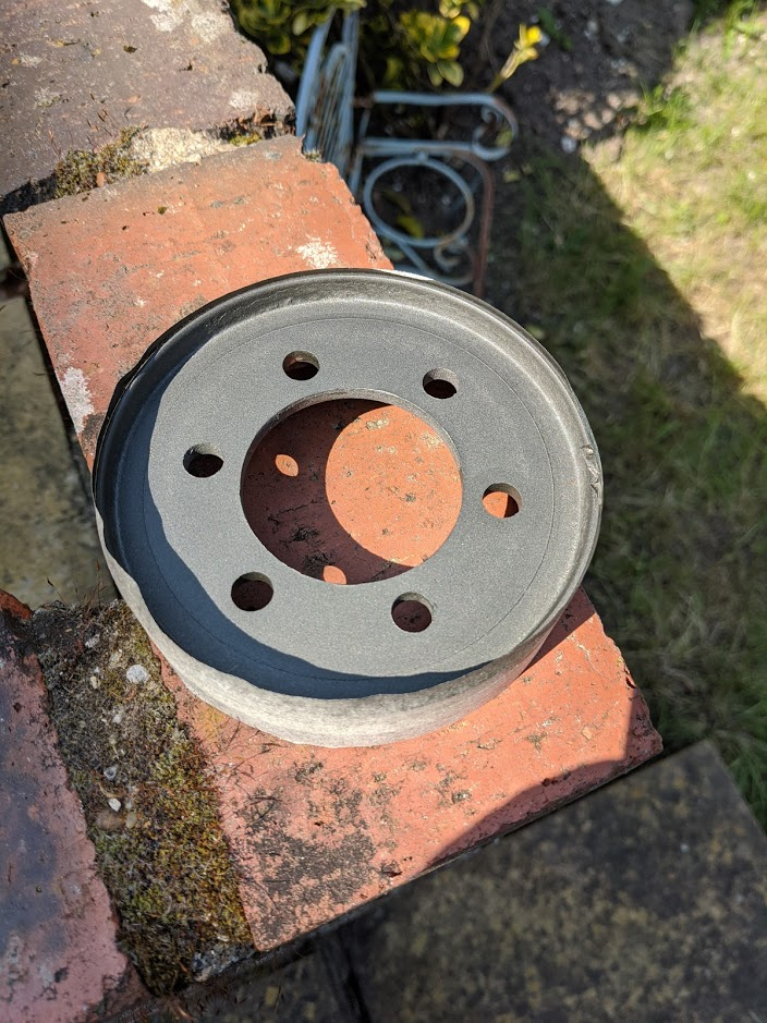

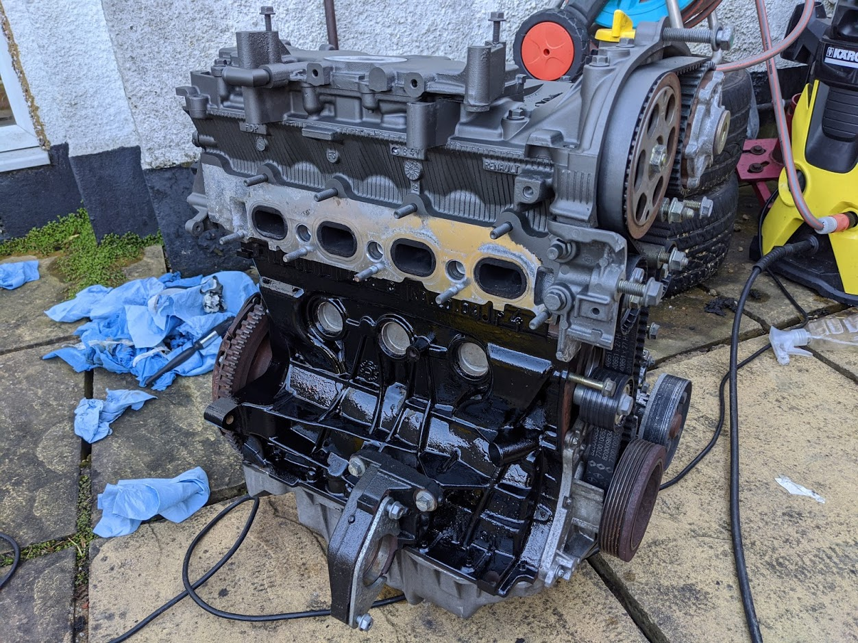

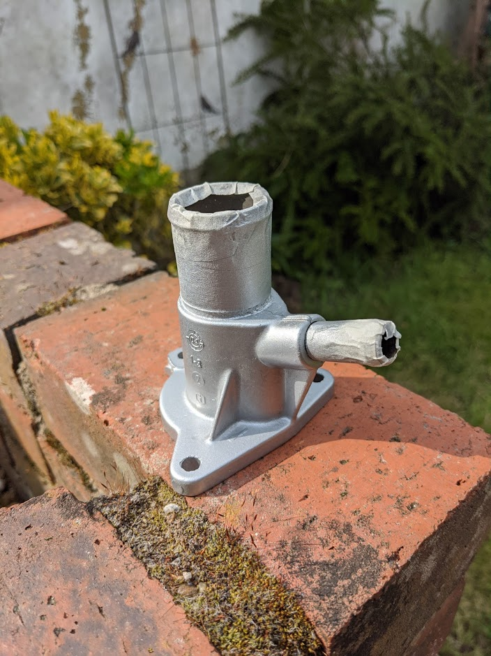

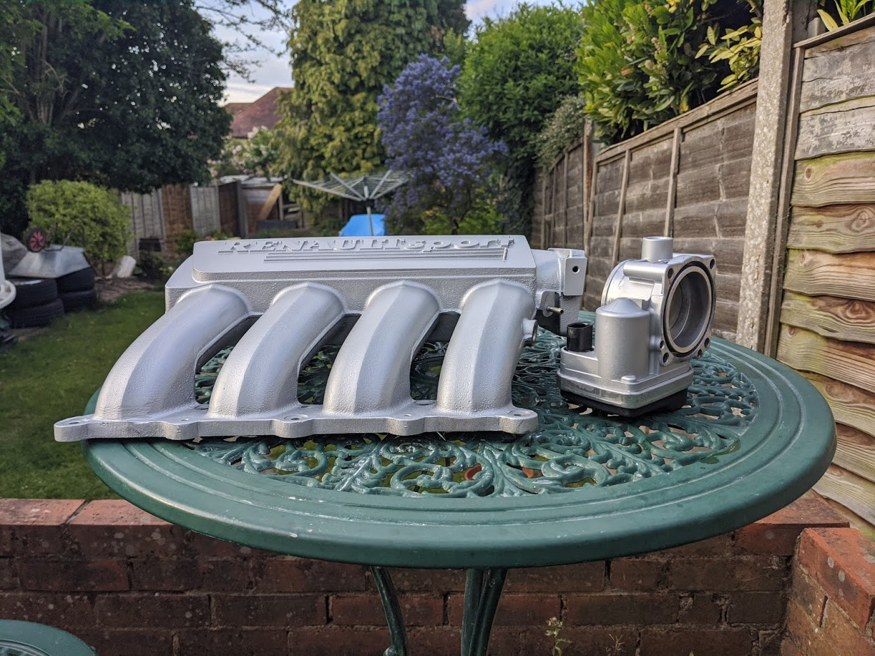

Standard stuff, degrease, jetwash, degrease, paint blah.

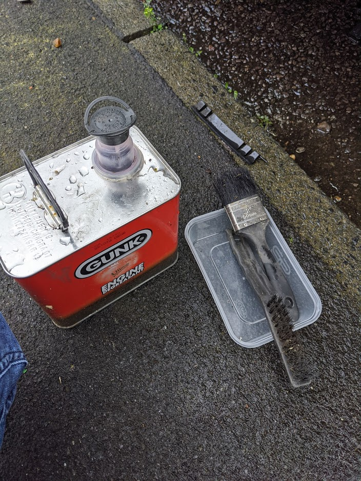

Used some of this which seemed to work fairly well, not sure I would buy it again:

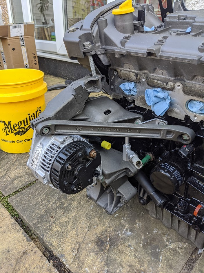

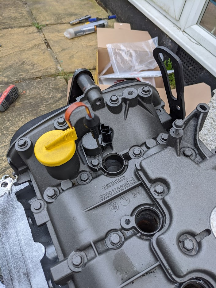

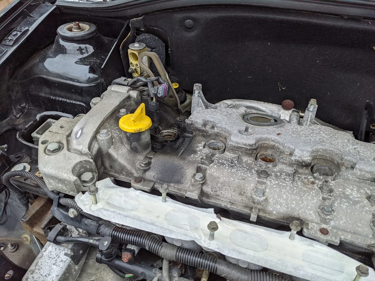

Stripped ancillaries off and removed covers etc for cleaning and paint.
Was starting to look much better at this point but still miles to go...

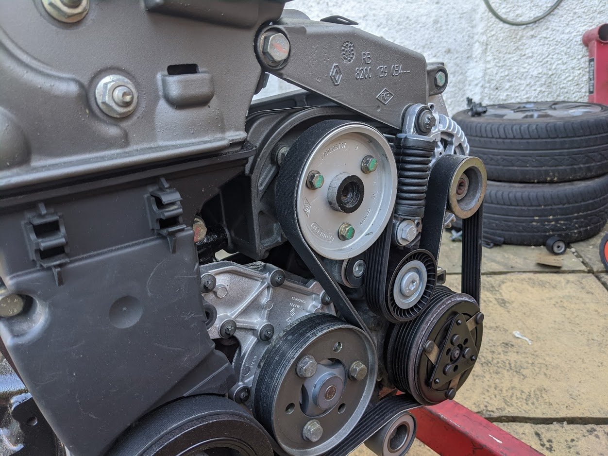

Cam belt kit with dephaser

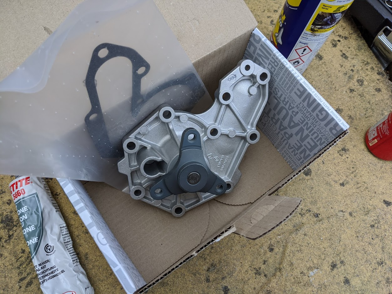

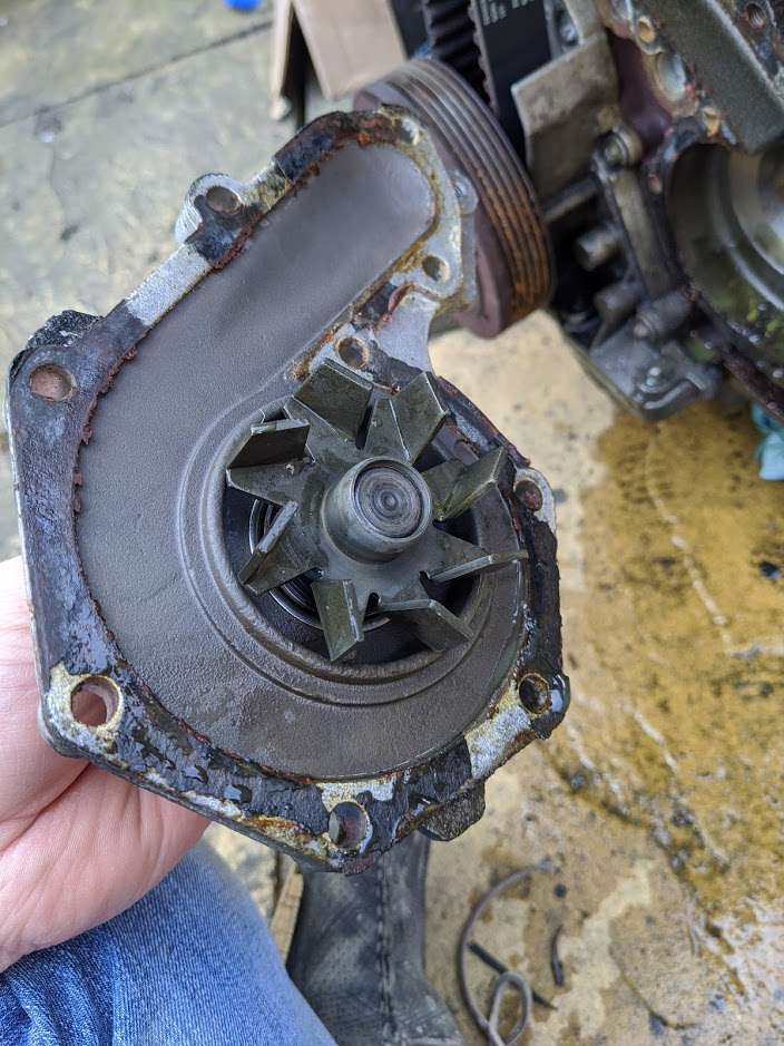

Aux belt kit with water pump

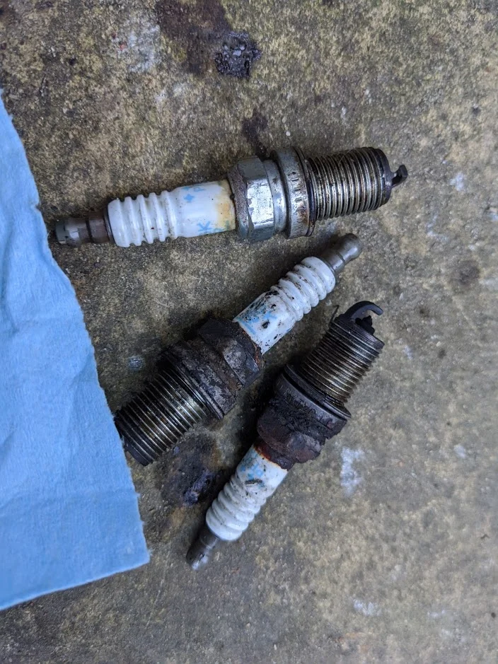

Plugs

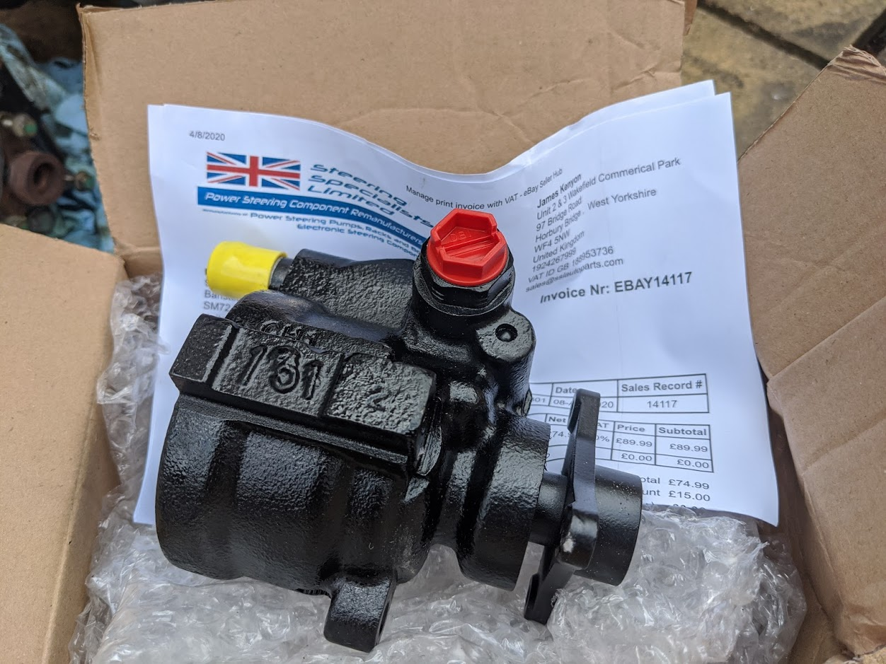

My power steering pump had always been moany so bought a refurbished one too.

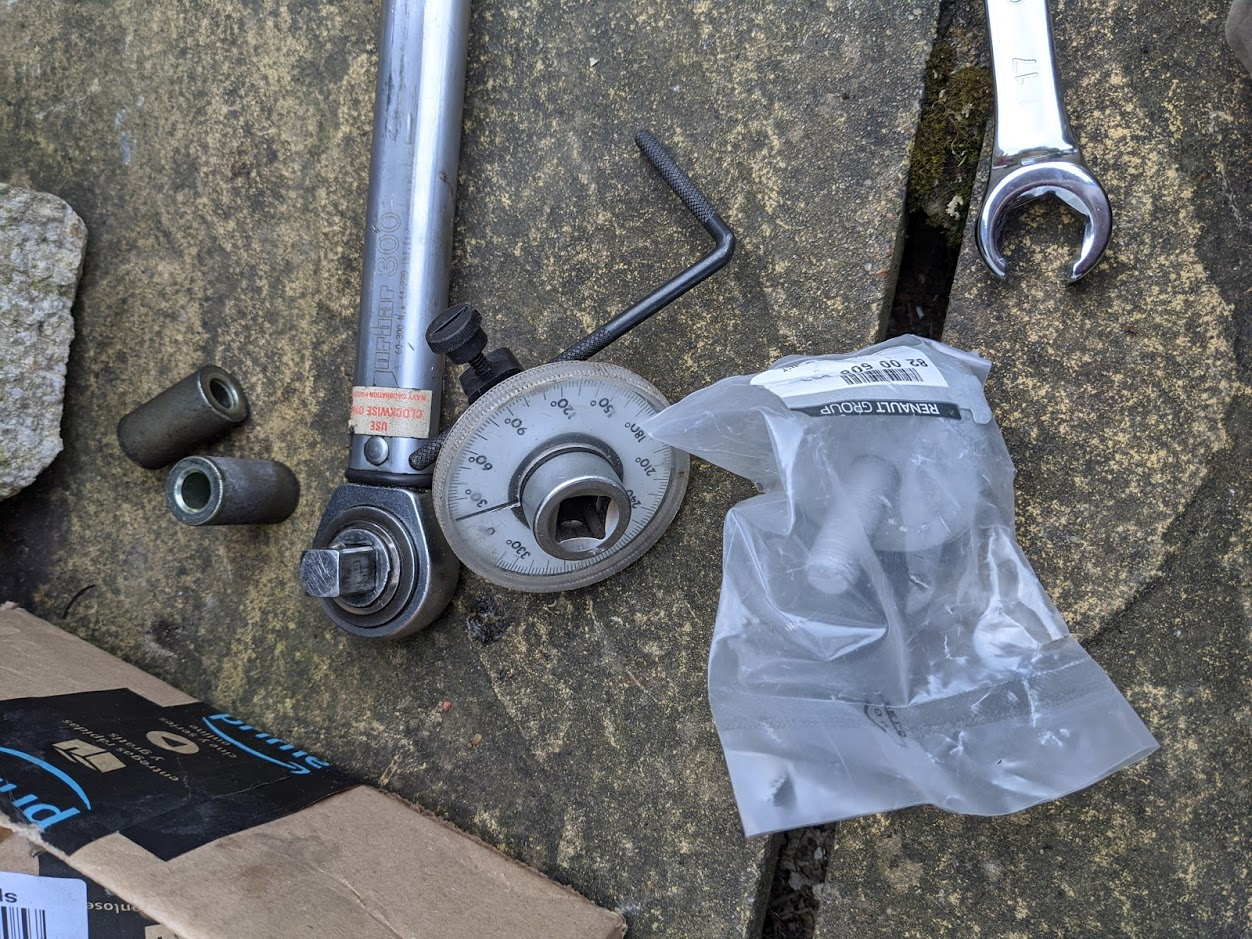

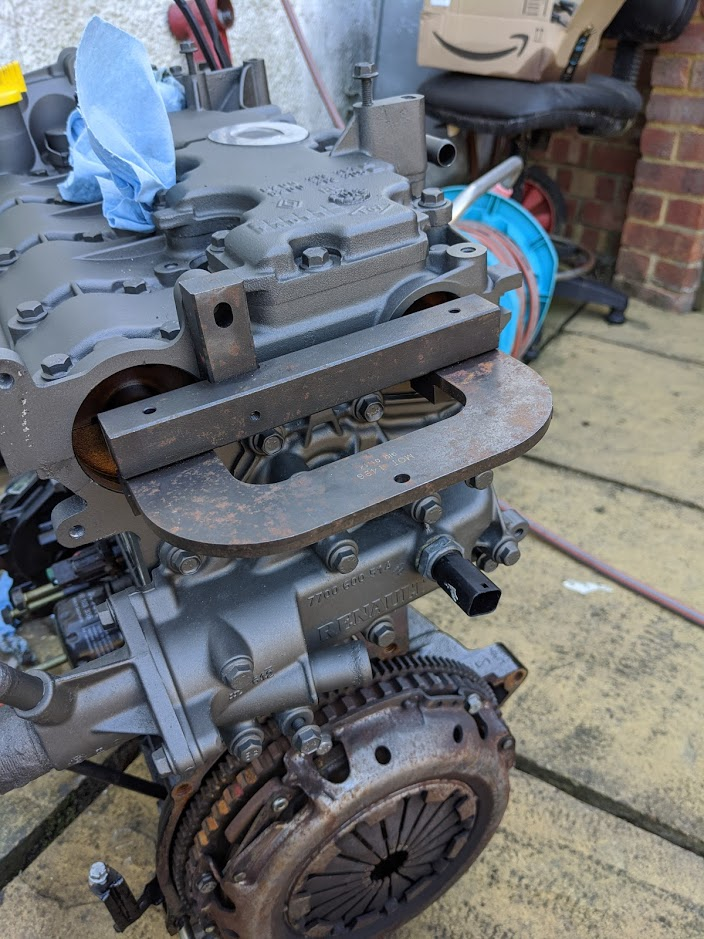

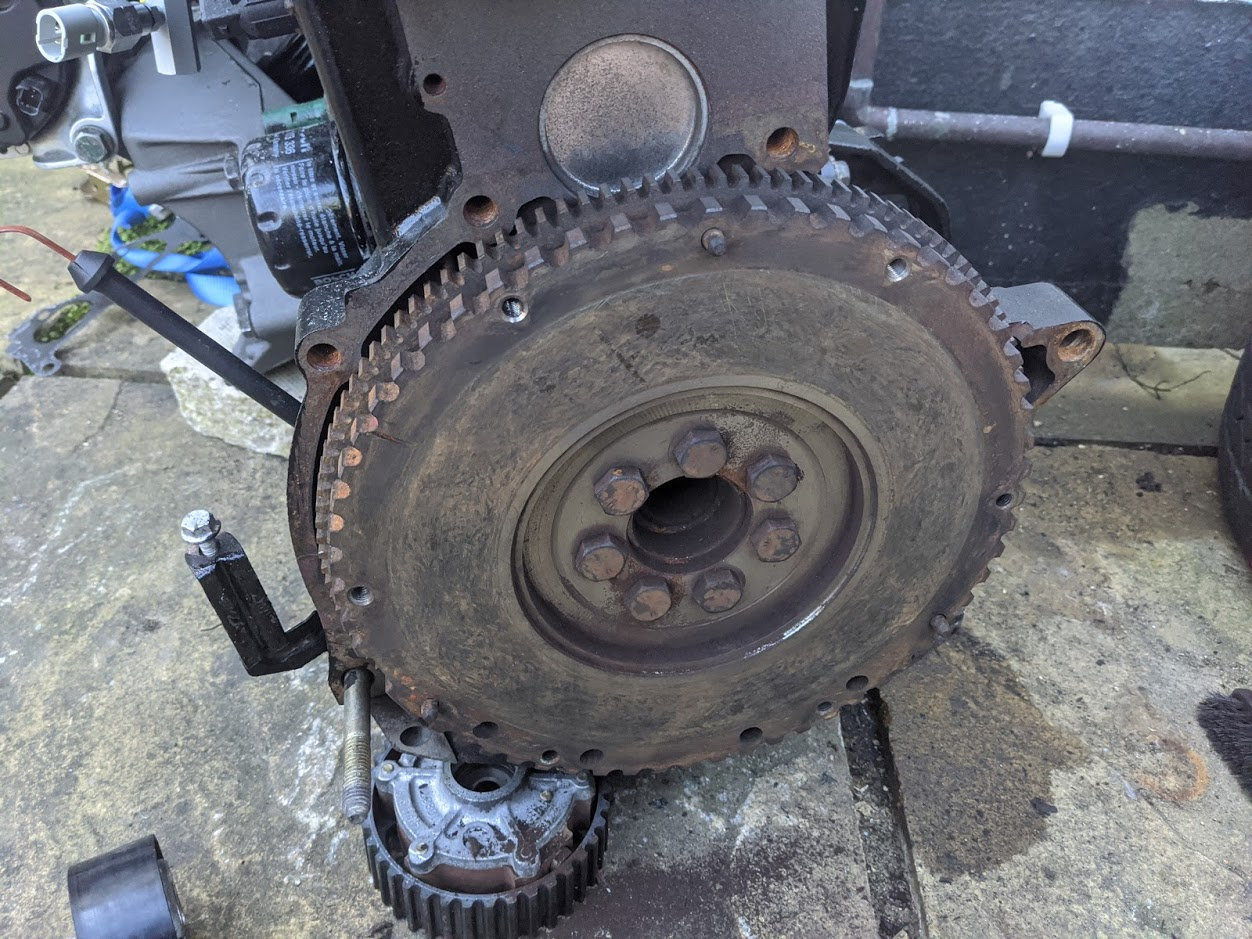

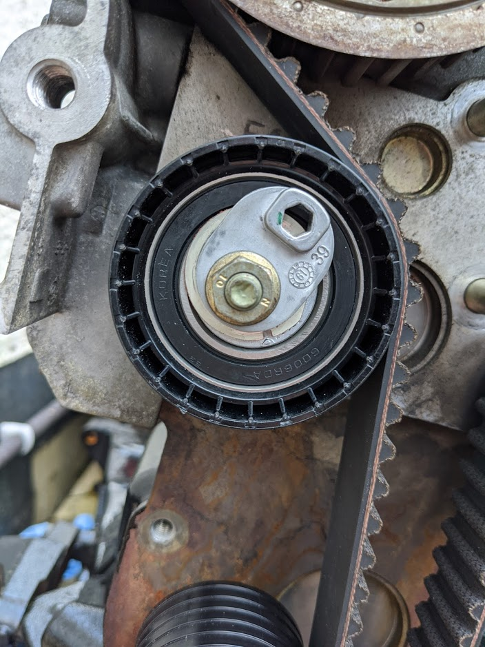

Also picked up a set of Renault timing tools ready to do belts

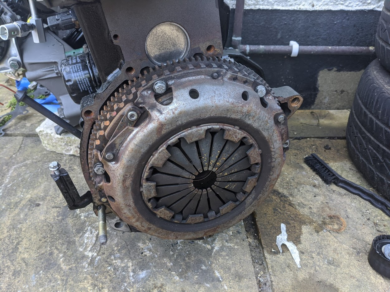

Pretty sure these had never been changed
Why am I here?
Sadly had to end there as I had forgotten to buy a few bits

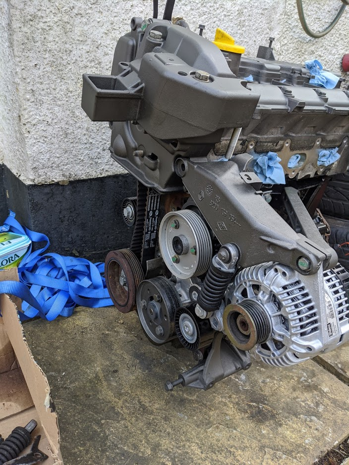

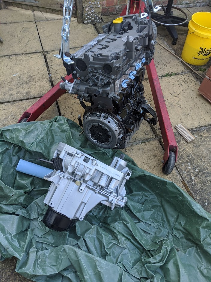

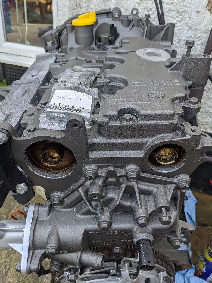

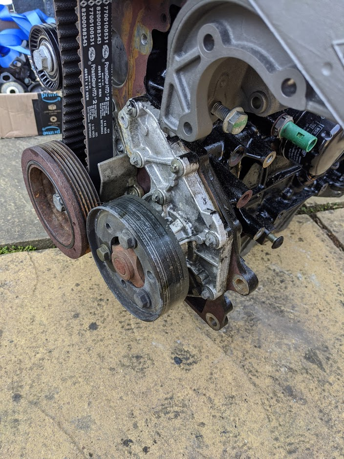

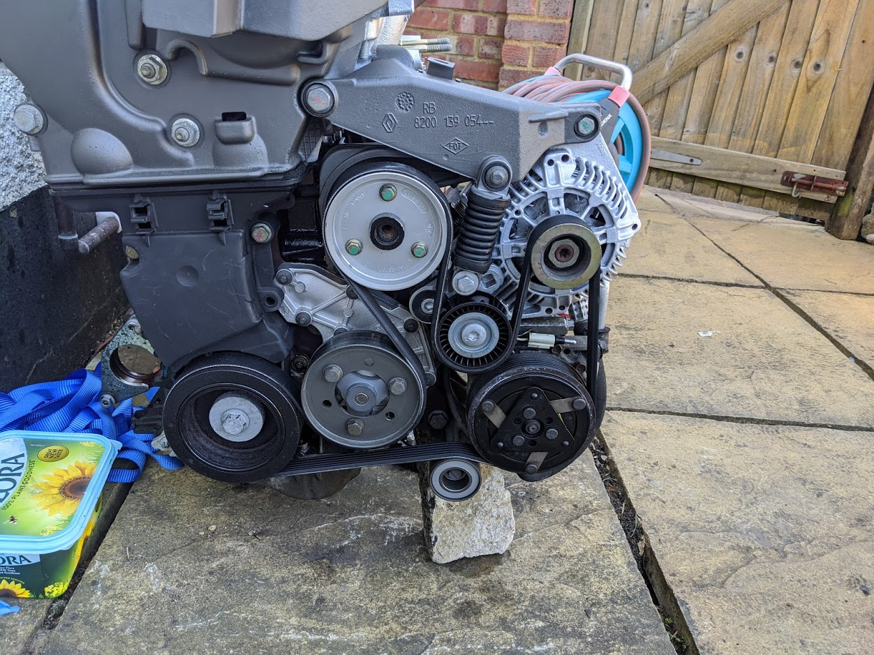

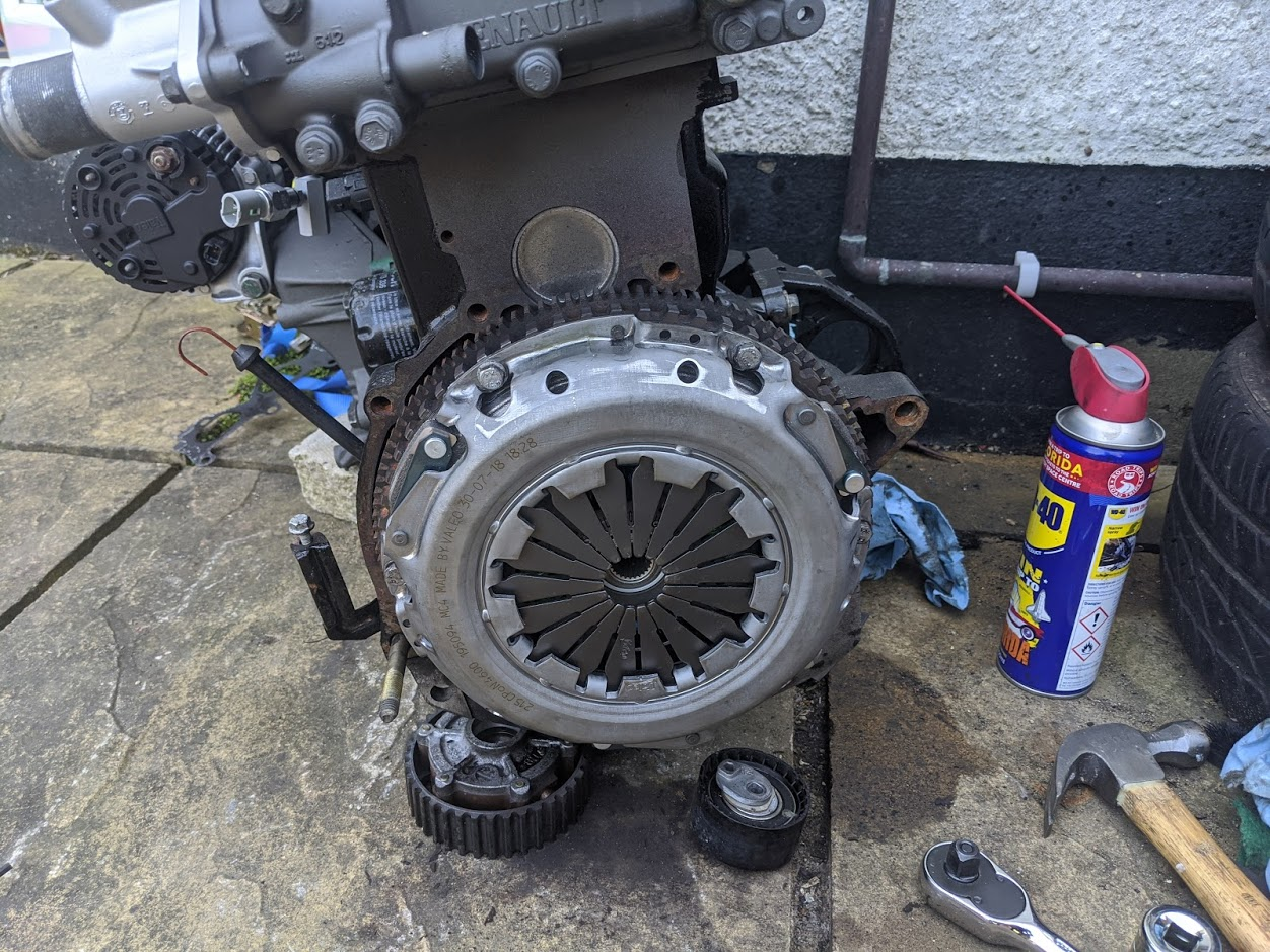

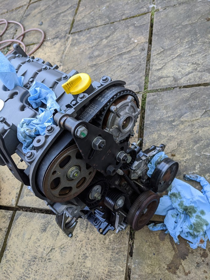

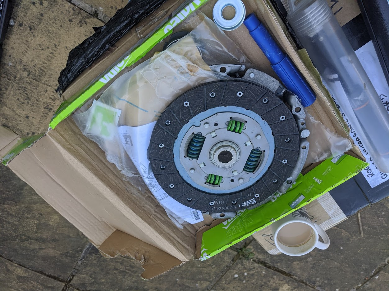

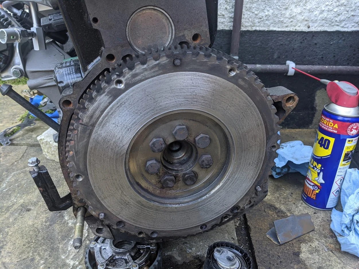

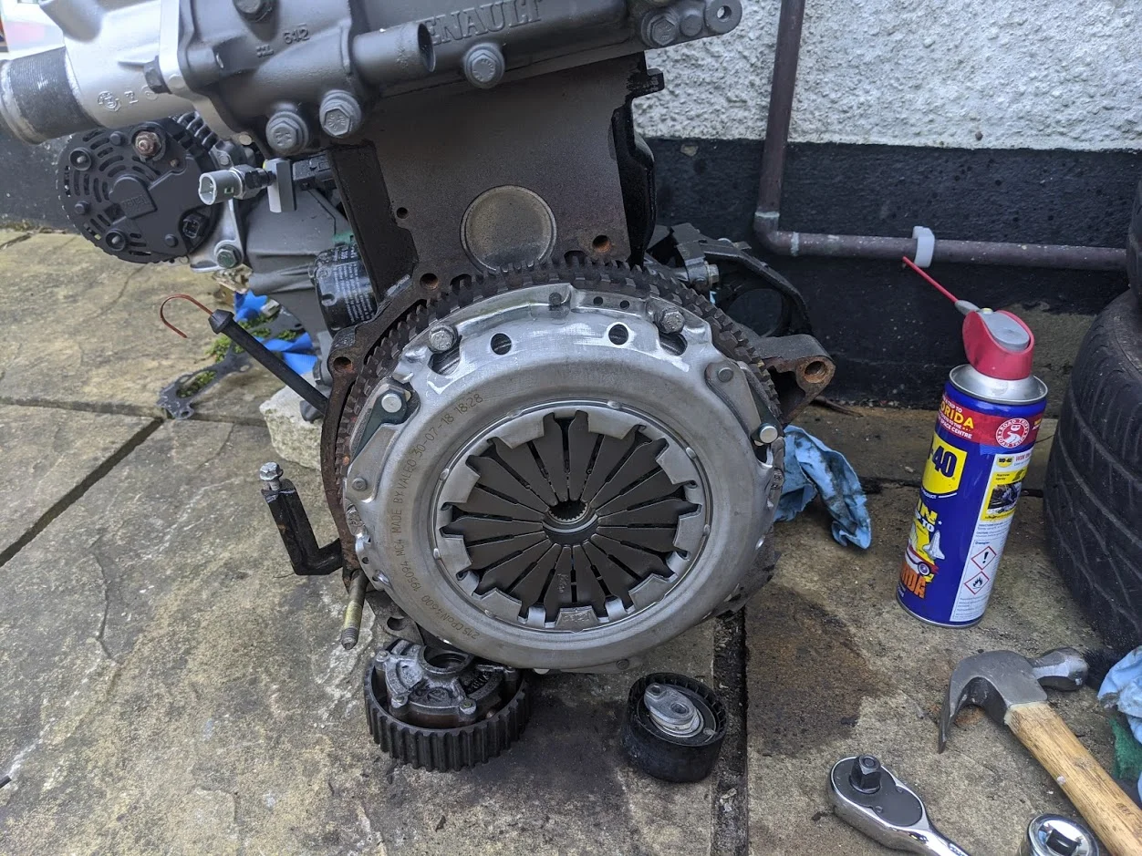

Belts sorted, time to deal with the clutch
Few more forgotten parts arrived

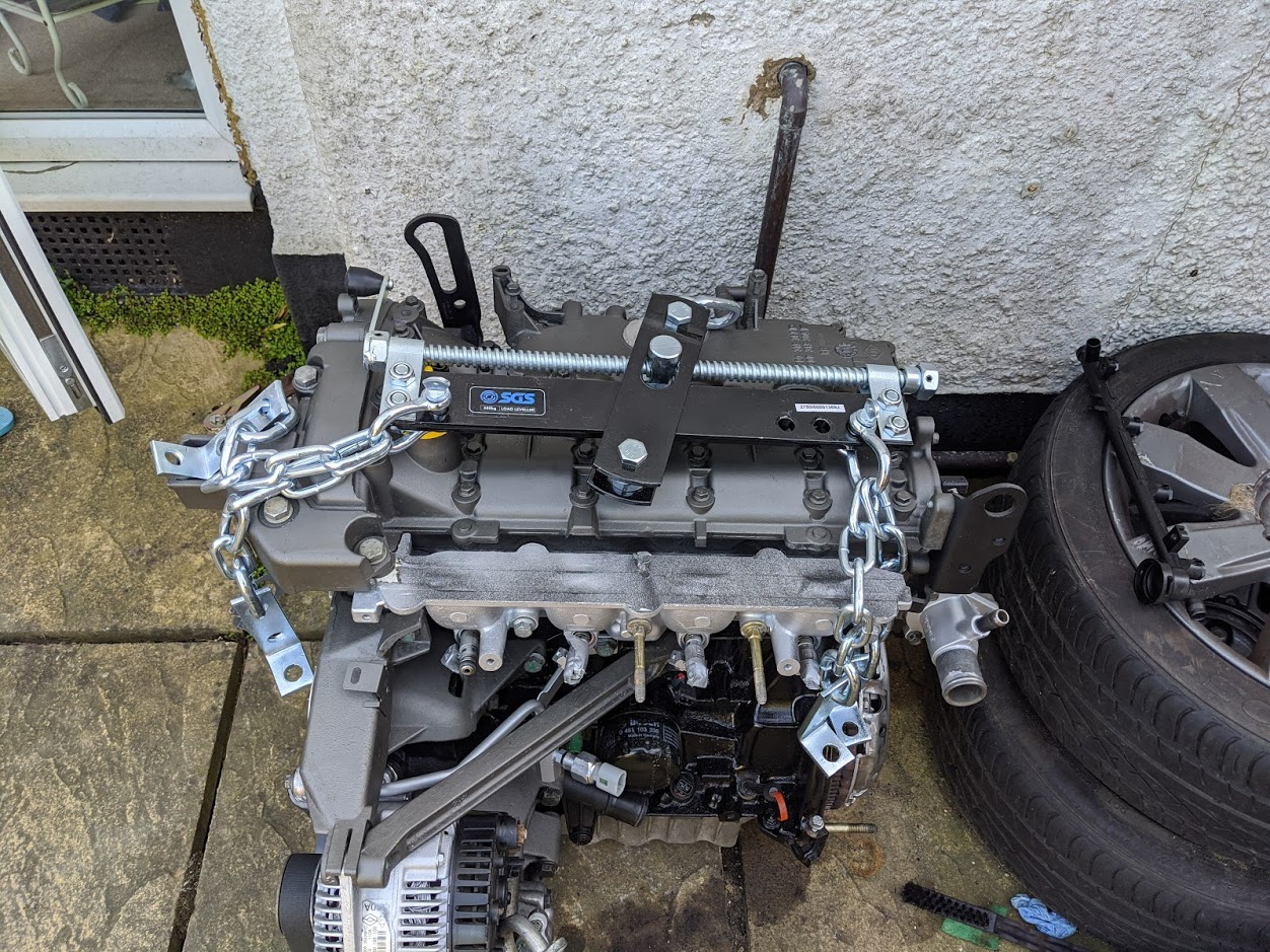

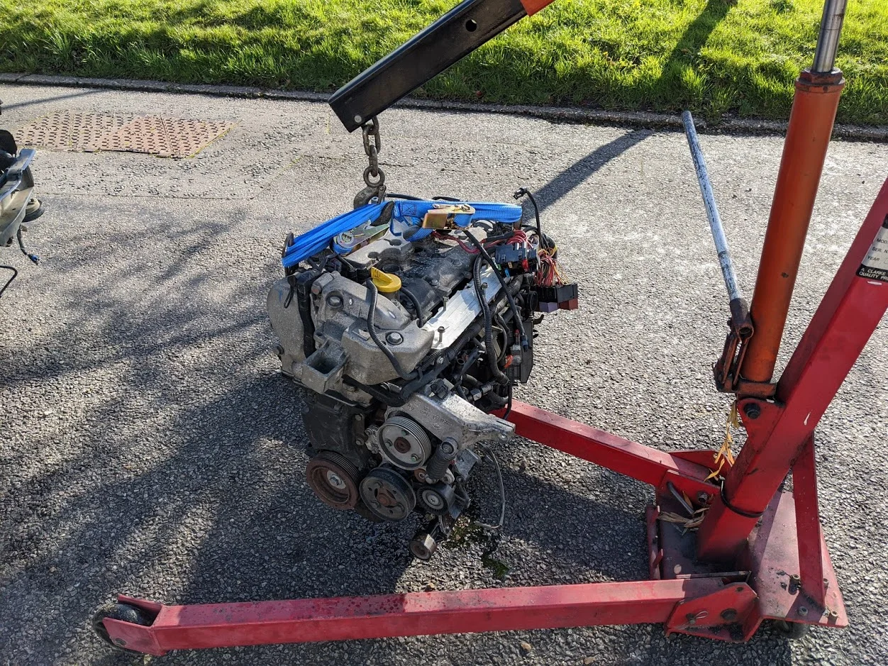

And a new engine crane block as getting the engine out through the top with box on without it was sketchty as f**k! I'm sure I've missed loads but this is the engine ready to go back in the car... just waiting for that box to arrive. Agency had missed 3 couriers so I was getting (and the neighbors) a bit tense!
Wow good job on that engine and doing the belts yourself.
Thanks mate, with the engine out and with the Renault tools it wasn't hard at all, however with the engine in the car I can understand why people pay to have it done! The aux belt is a bit of a dick to fit out of the car let alone in. Took a few goes to get it timed up properly as I've never done belts on one of these before - I've since had the engine running and can happily report that no valves have said hello to pistons (y)
Was a struggle to not remove sump and inspect bearings etc however I just knew that if I did that I would be into rebuilding the engine for no good reason.

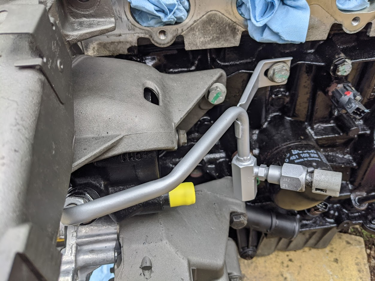

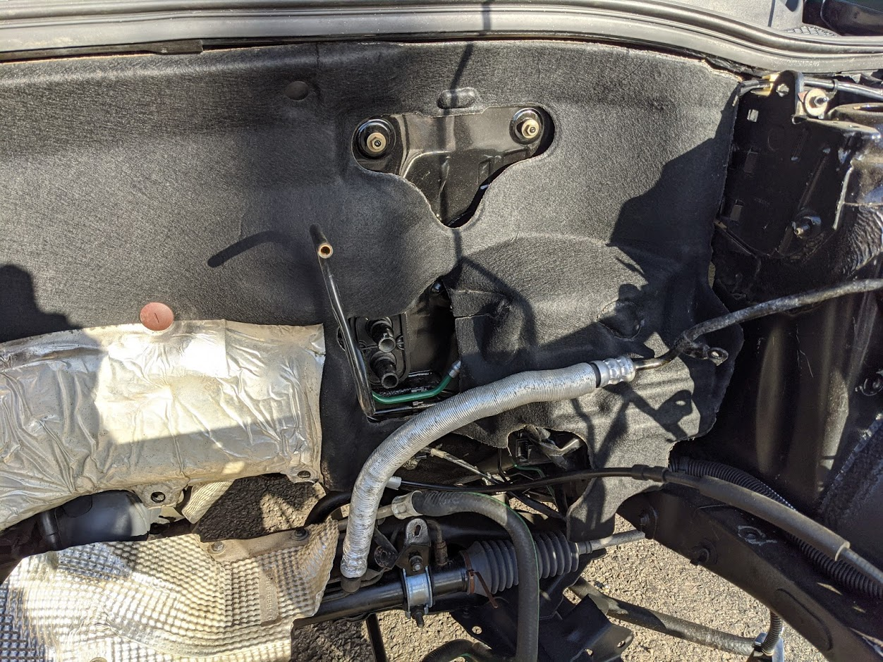

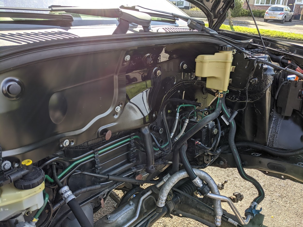

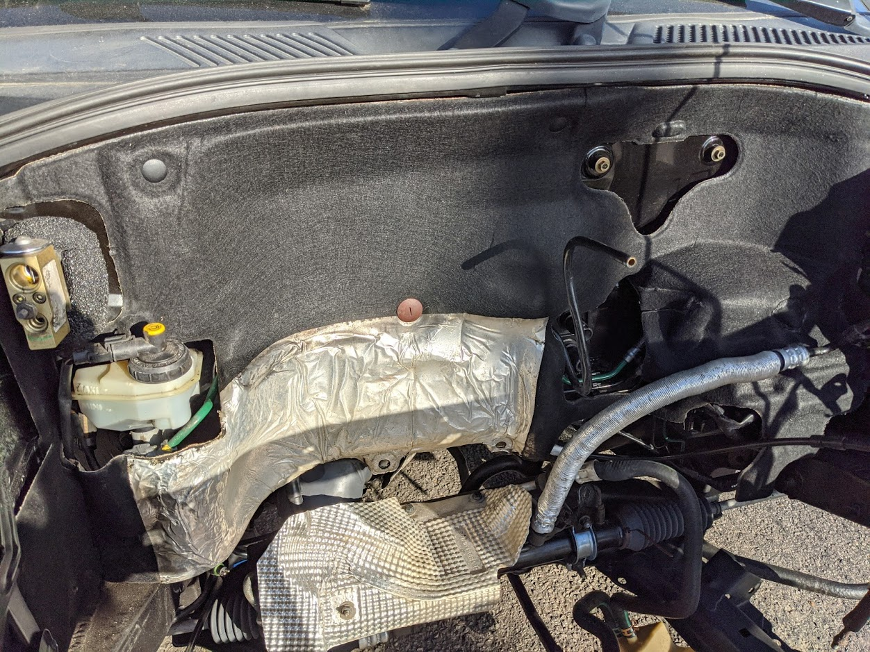

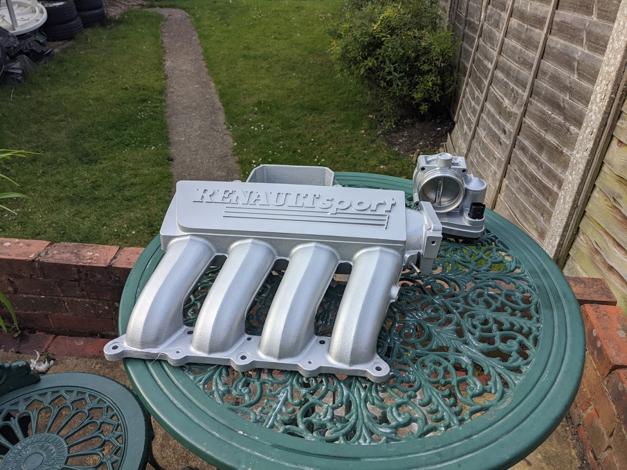

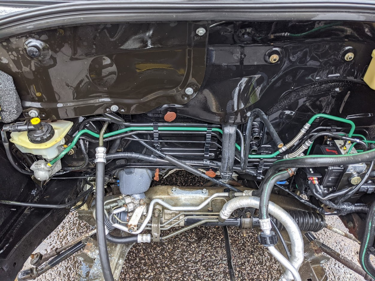

So, with the engine ready to go back in when ever the box arrives I started to put the bay back together, its not as clean as it was due to the wax/Dinitrol over spray however I plan to give it a decent clean when the engine is back in. Gave the bulkhead carpet a good washing, luckily it seems in good condition.
Although not pictured (bellend) any rusty looking scab (all turned out to be surface thank god) was ground back, treated with fe123 painted and then dinitroled using 447.

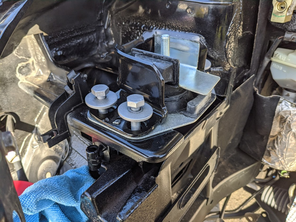

I've removed (for good) the acoustic valve and the carbon canister and fitted a new top engine mount

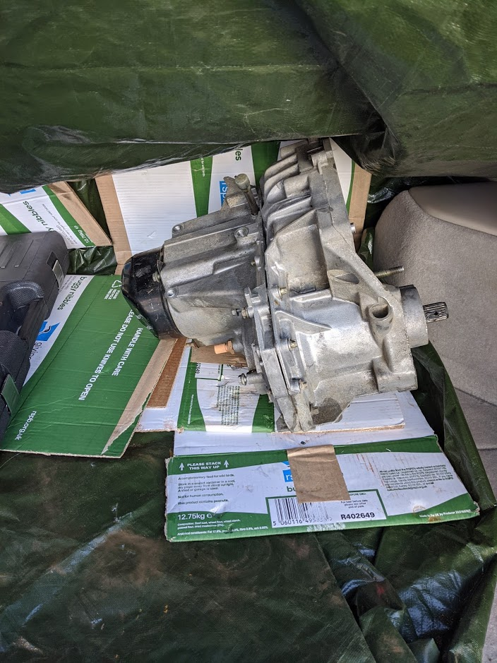

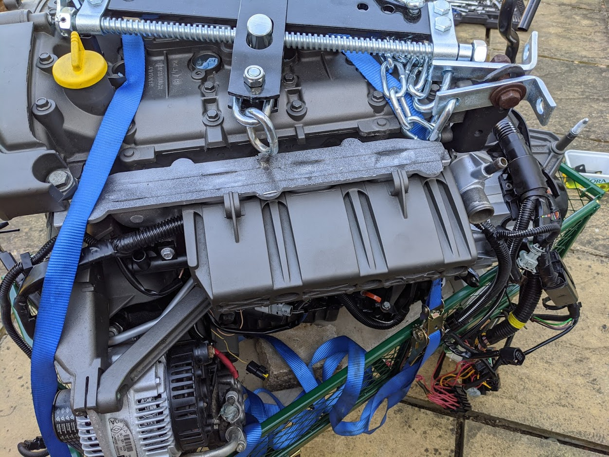

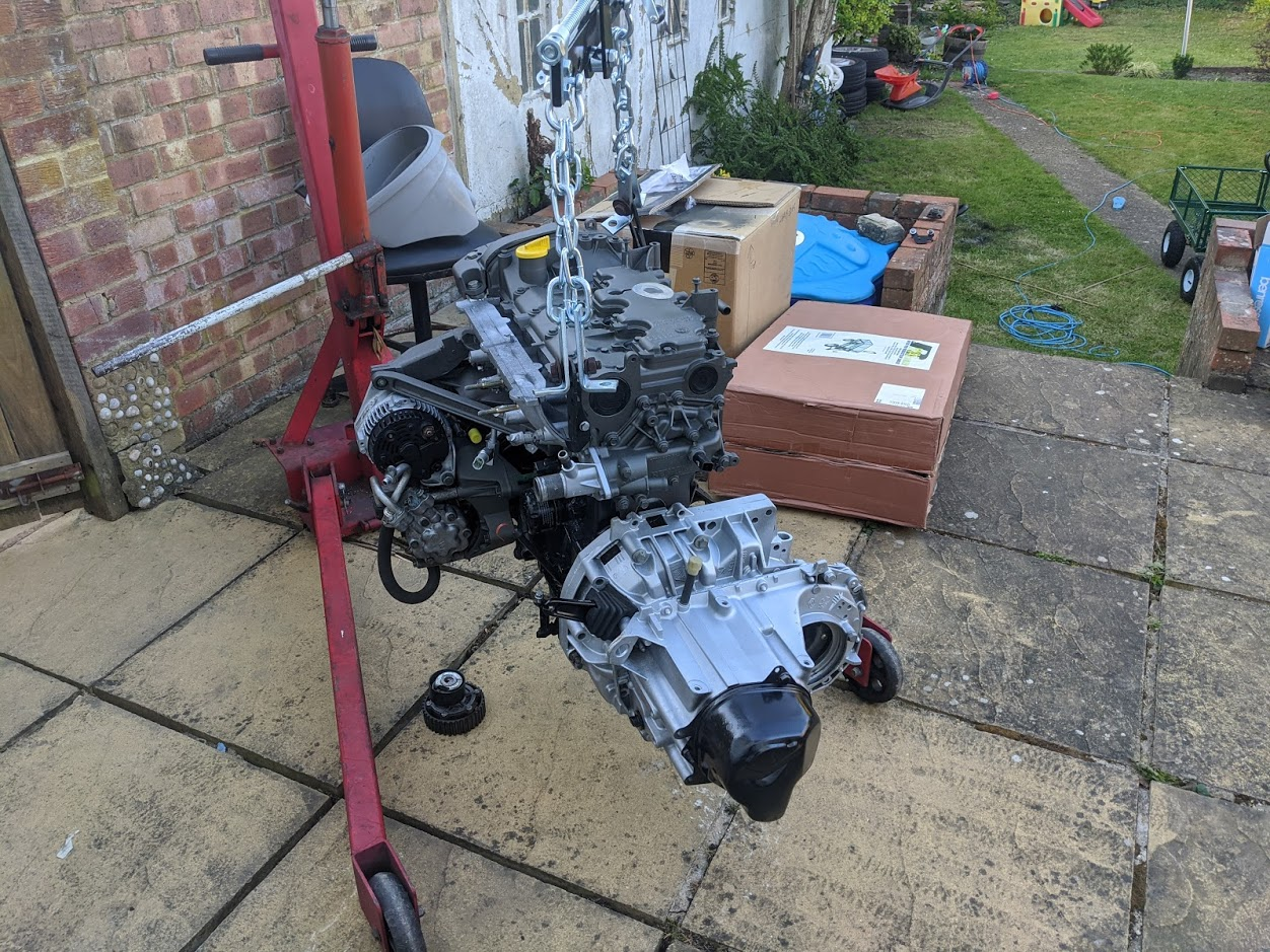

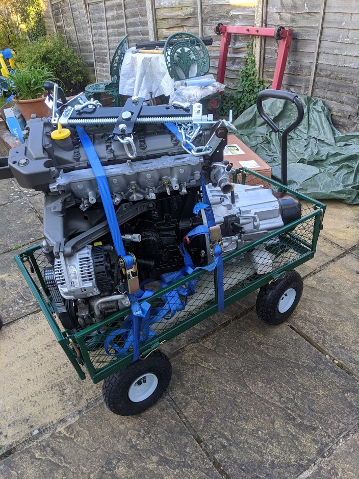

Then some magic happened... the gearbox arrived. So without pausing for pictures *that i can find, the box was cleaned up and painted

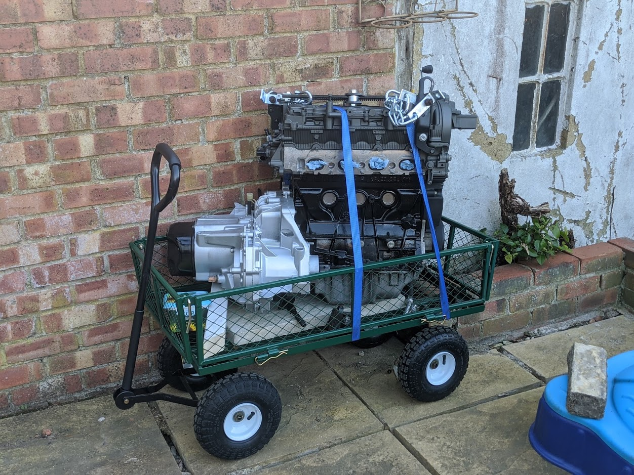

My drive is angled and I need to get the whole lot down a step and up the drive so after installing box to block I needed something that would let me do it alone, one man covid lock down style...
Unconvinced but will give it a go!

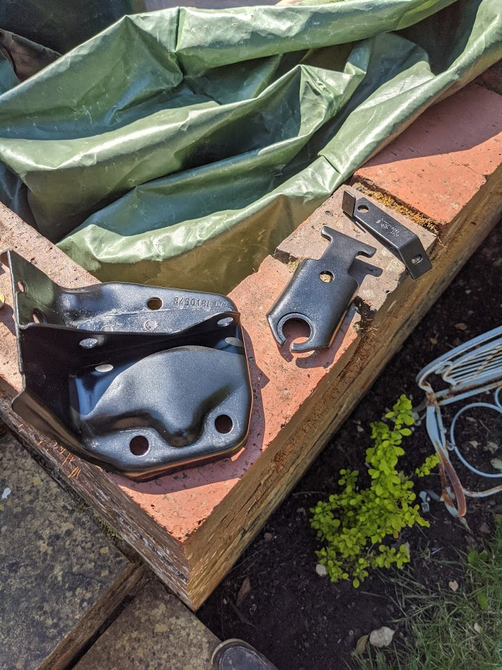

Time to sort a few brackets out before engine can go back in

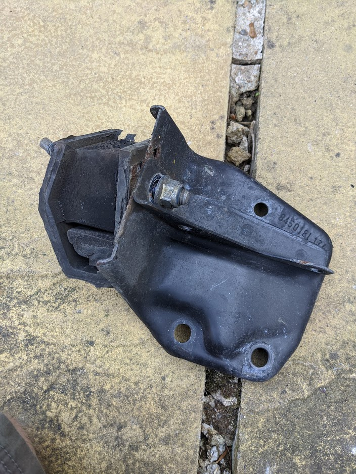

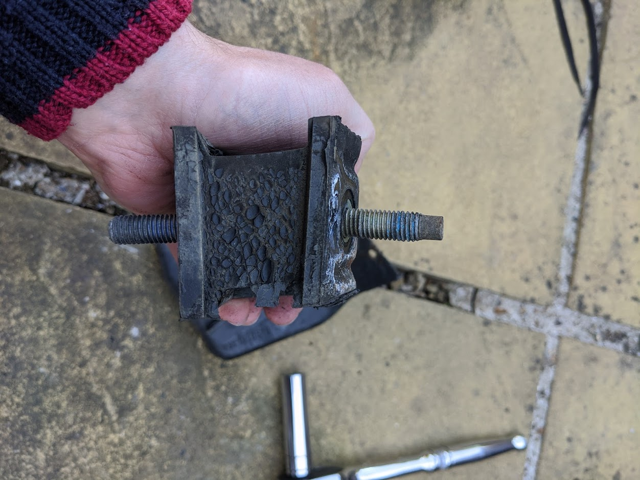

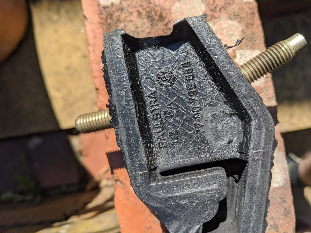

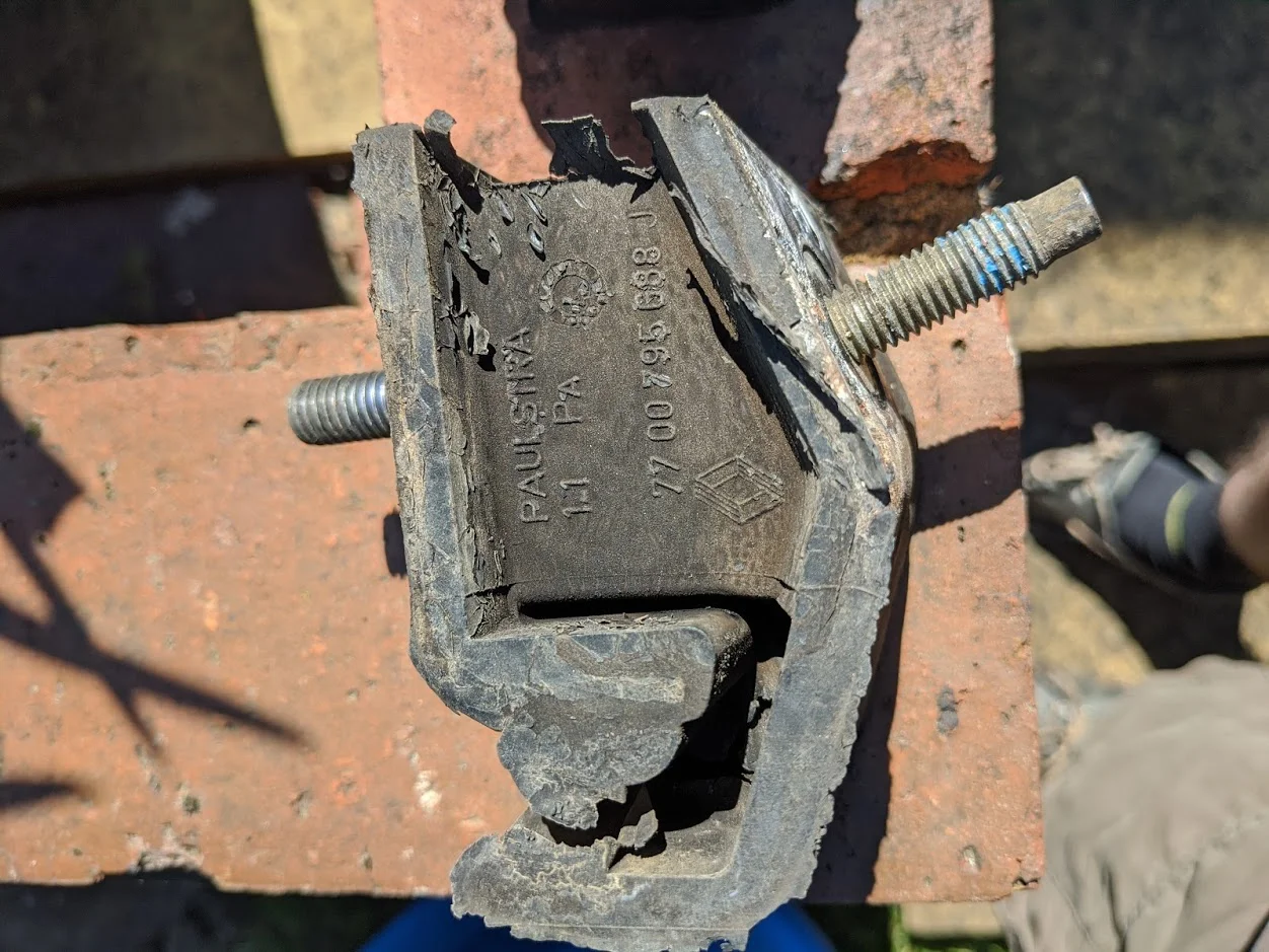

Lower mount was looking a bit past it
Old mount vs new mount... off ebay, I'm thinking this is the OEM part just with the Renault number ground off!

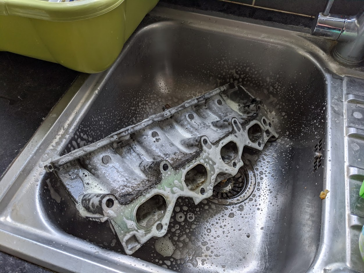

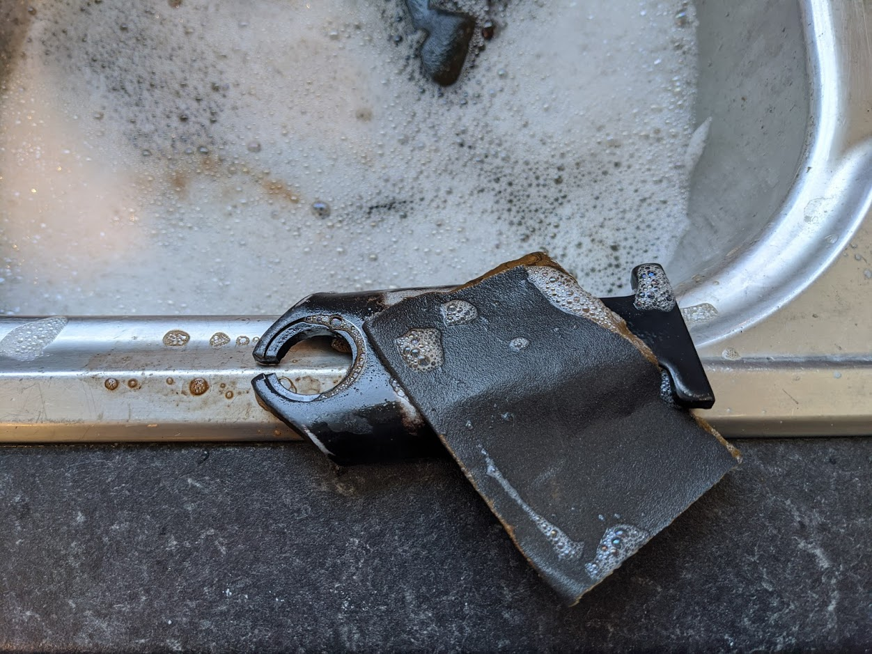

More sink work while she's out

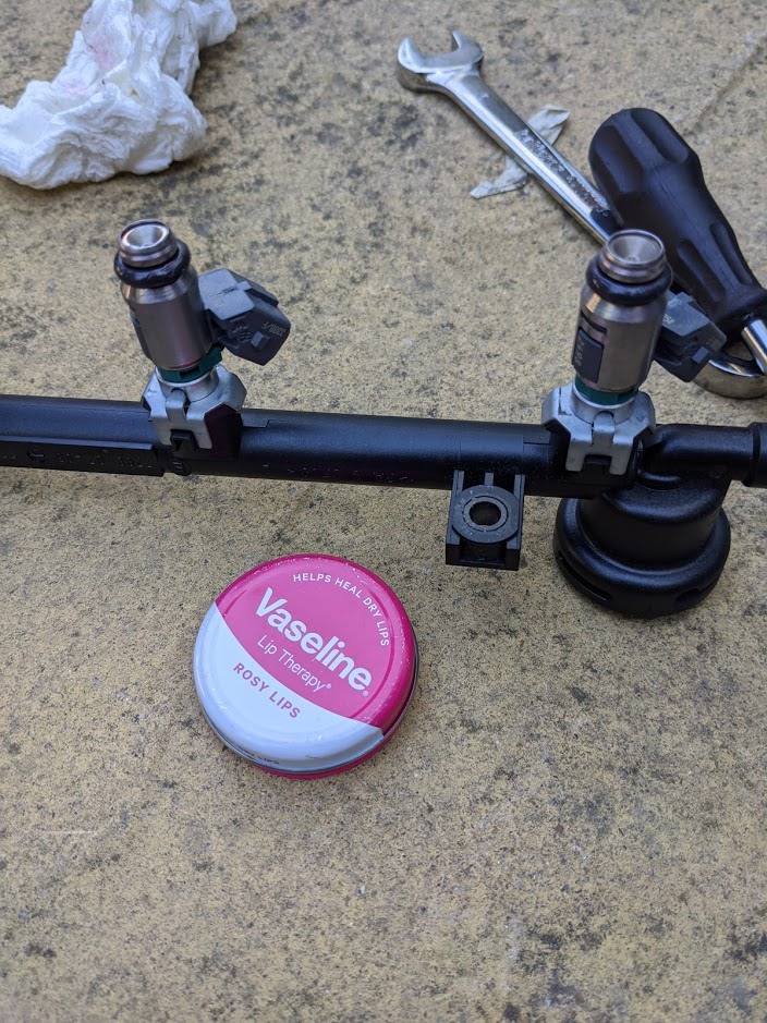

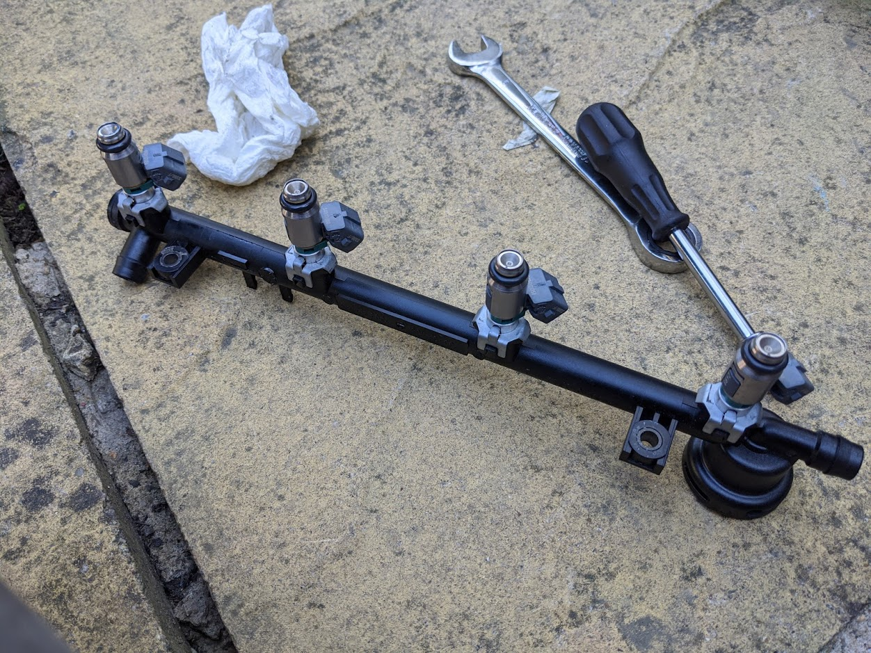

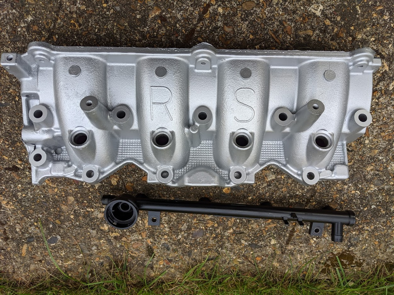

Just before I took too many bits off it I drove the car down to my local MOT place and got them to suck out all the A/C gas (such a planet saver), on the way back it started to stink of fuel/eggs and developed a very lumpy idle, one of the injectors had failed... Like it knew what I was going to do to it so just gave in.
Set of new genuine squirters arrived
Fitted up into cleaned rail
Couldn't find my anal lube or any silicon grease so this had to make do - seals look like viton so not worried about the flavor giving them grief

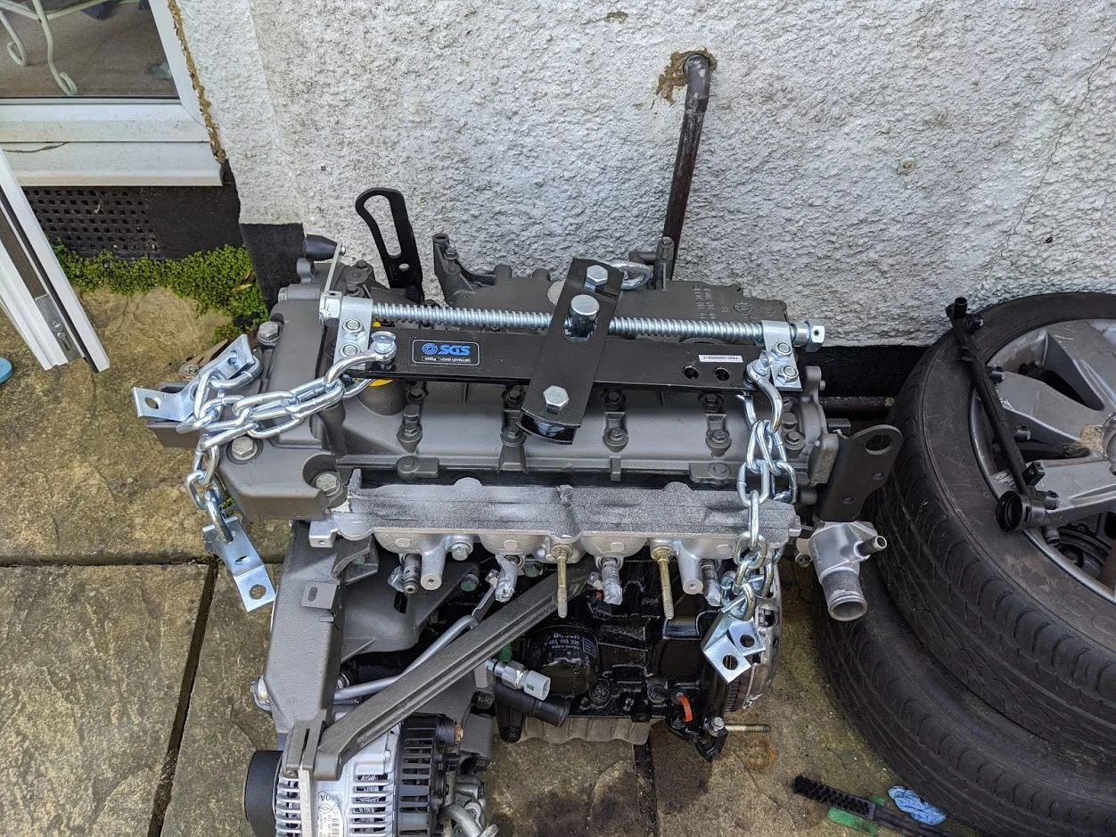

Then all back on the engine while sitting in its shopping trolley
