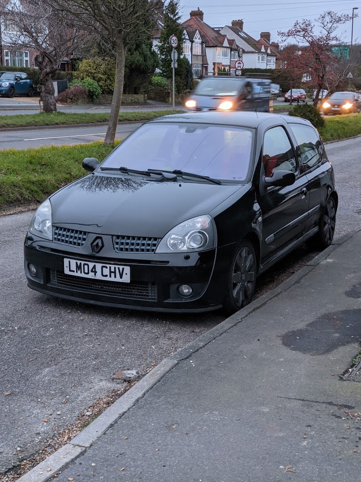

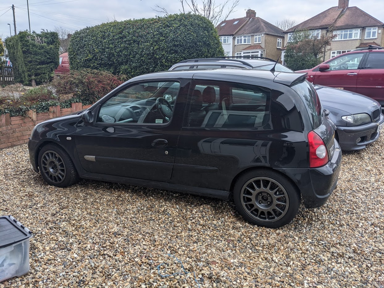

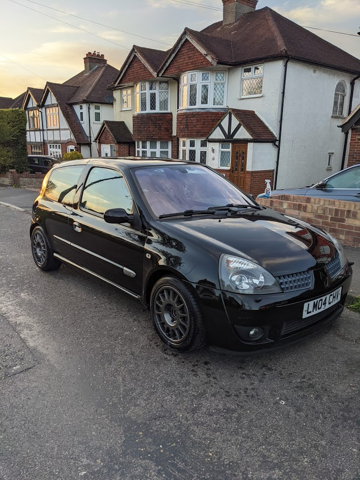

Had to head into the office yesterday evening so took the Clio. Suspension has settled a fair bit now.
Despite completely guessing at the toe and camber it drove really well, 40 miles in total of mixed driving. By the time I got home it sounds like a heat shield has worked its way loose a touch so will need to get under and have a look. Desperately need to fit arch liners but now obviously will need to scrub everything before they get fitted, drove home at midnight ish and they had gritted a few of the larger roads :mad:
Very angry with myself that I didn't take the opportunity to install a few small mods such as a lighter flywheel and longer 5th. I think once this round of lockdown is through Grp N timing and a remap are in order.
Wonder if a longer 5th can be installed with box in car?
Anyway, before leaving needs a good wash! I will satin black the grill when its not so miserable outside and have a good number of parking dents to fix.

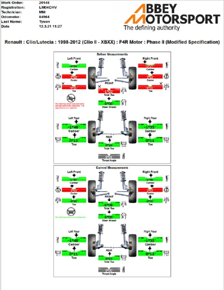

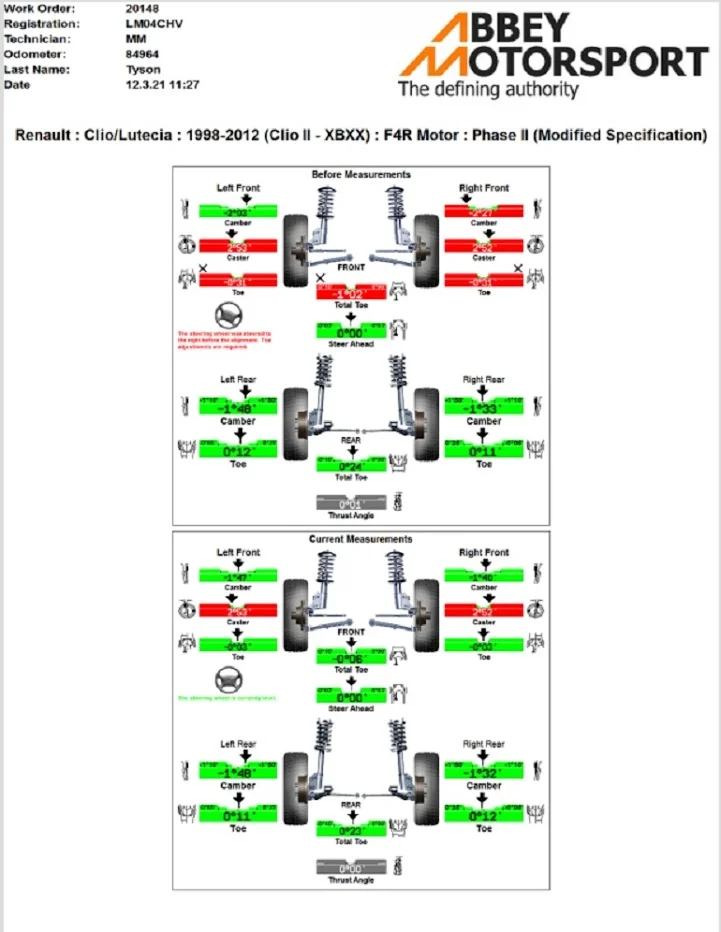

First up I have been avoiding fitting my new wheels with good tyres on because the tracking was unknown - I've been running the same budget tyres with ancient PS3 rears on the car since purchase but neither seemed to dead after nearly 15k.
A quick google for local companies with a hunter machine showed Abbey Motorsport as being one of the nearest.
Cool place and nice people. Tracking wasn't too badly out, asked for 5mins toe out and 1.75deg of camber but the printer was broken - a few days later and it seems I didn't quite get the camber I was after
Car drives well with new alignment - very stable however I lost the lovely turn in that loads of toe out gives, equally the car is much less twitchy at speed now.
I will get the car to a mates who has nice camber gauges once we are free, suspect 1.75deg neg and 10mins toe out at the front would be a decent compromise for what is supposed to be a fun road car.

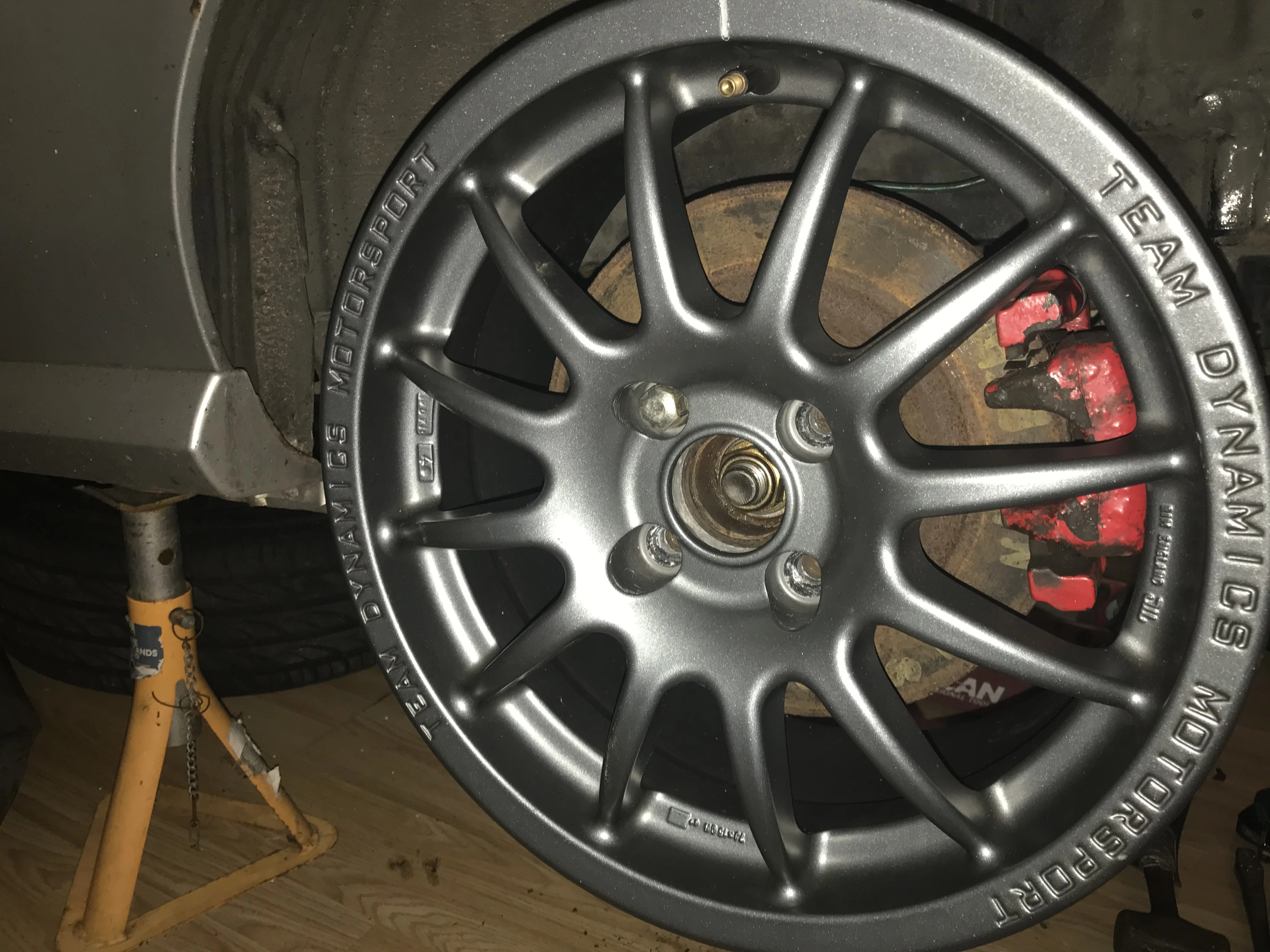

With the tacking done I had no excuses left.

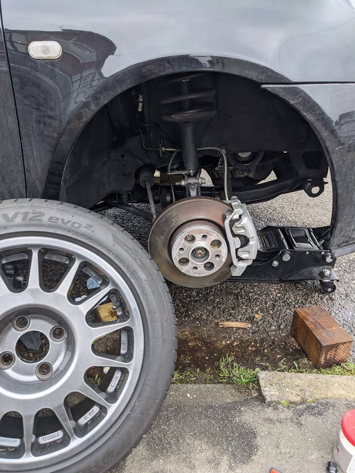

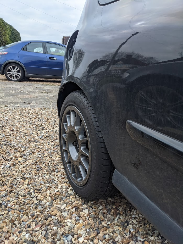

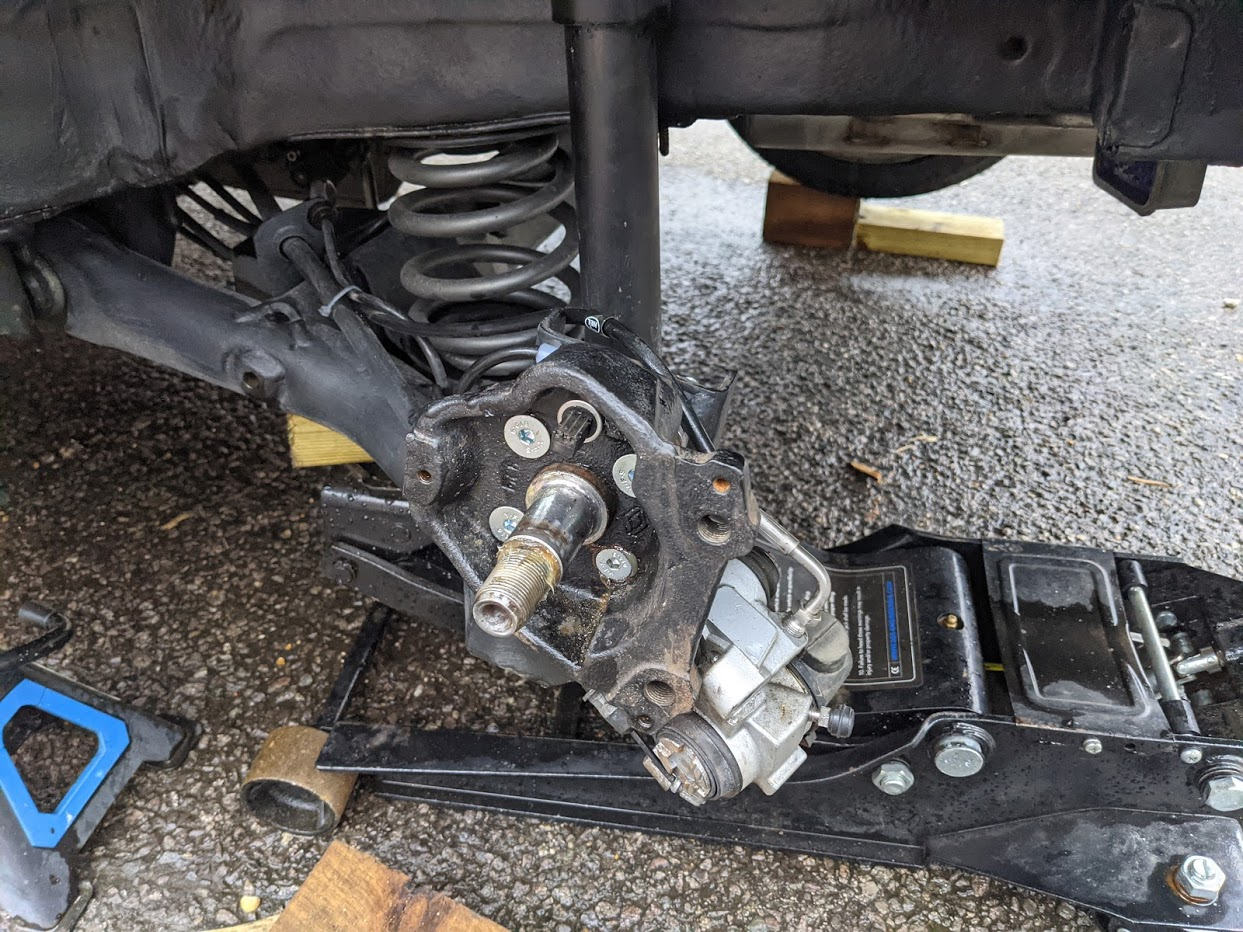

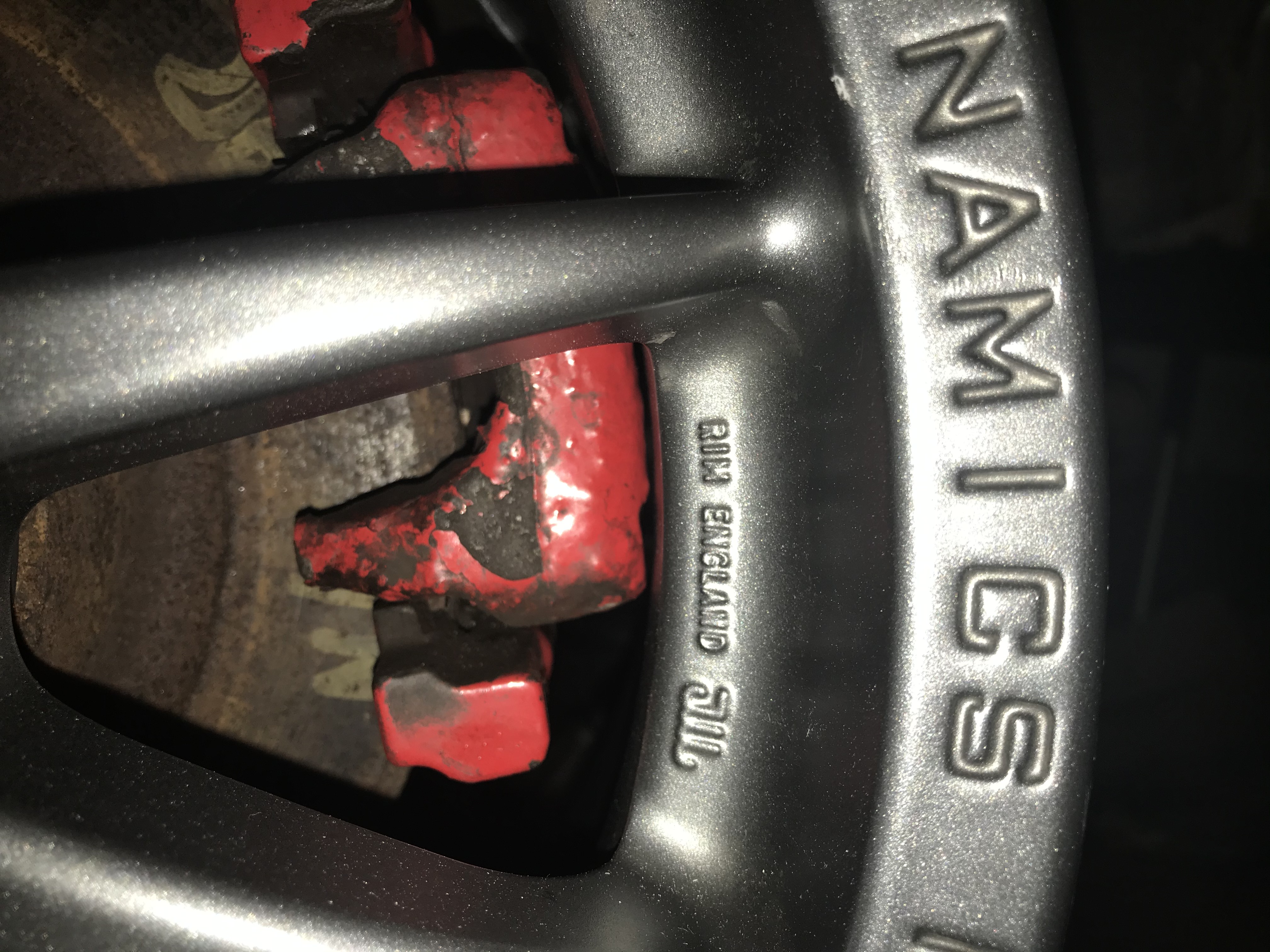

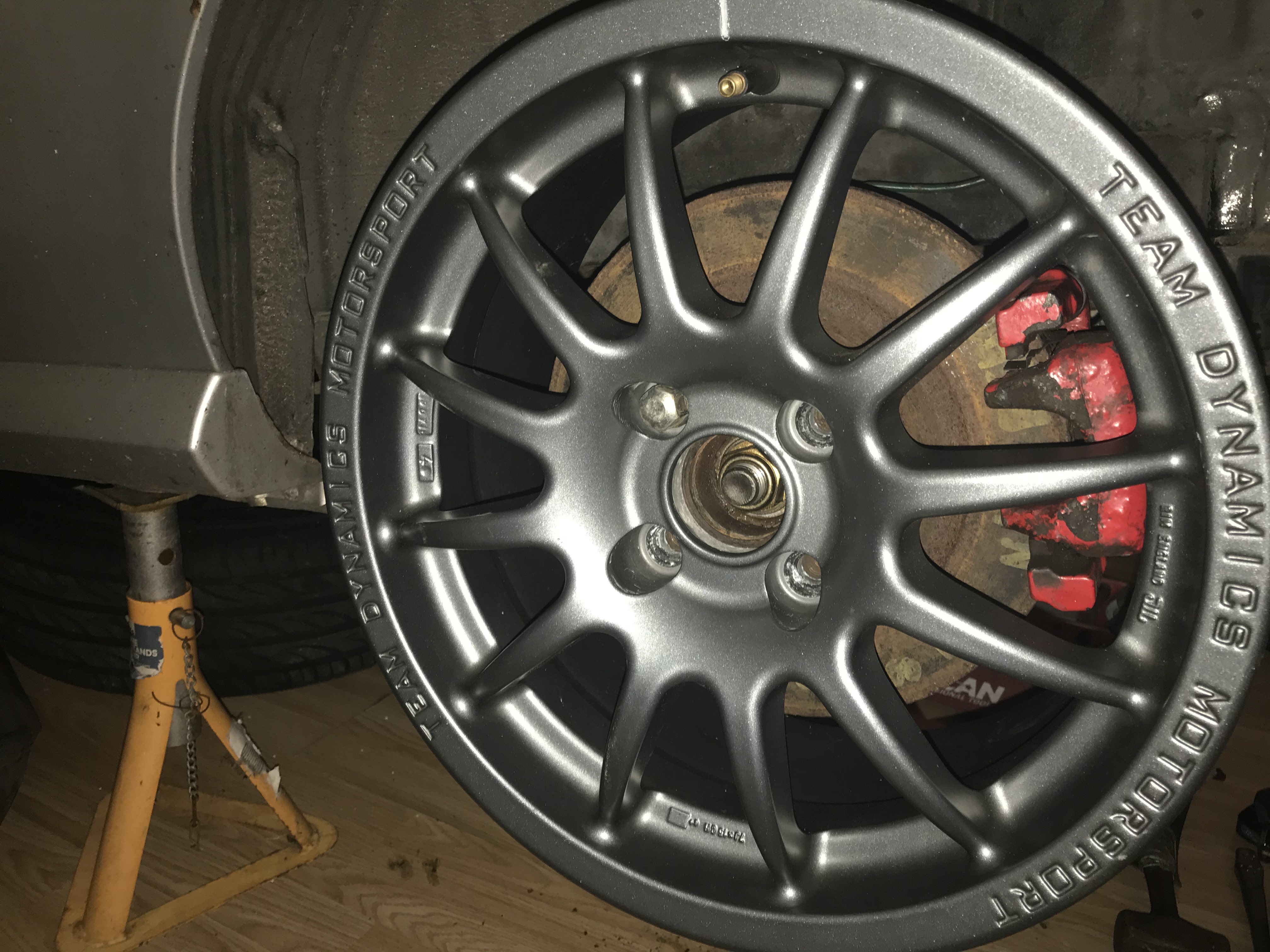

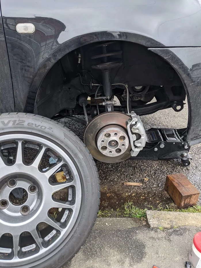

@Yorkshire Pudding had kindly sold me a set of bargain PMS front wheel spacers as the 2118's I have are ET43. So I bought longer wheel bolts (wish I had just bought the studs!) and a rear spacer set from PMS.
While I was at it I gave each wheel arch a quick scrub with TFR to remove wintery salt muck, earlier work seems to be holding up well. Front spacers went on pretty quickly

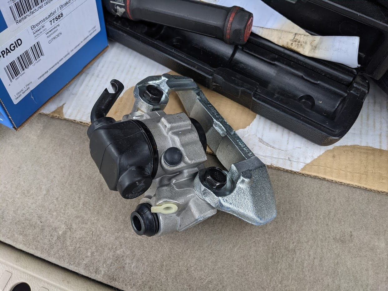

I fitted cheap rear pads because I wasn't happy with the Chinese knock off calipers I had bought a year earlier in a panic, last week one of the pads broke up spitting the friction material, pad backing plate and spring retainers all over the road. Because I need the car this coming week I had little choice but to suck it up and buy a pair of new rear calipers from ECP, I already had some red stuff rear pads waiting and made sense while fitting rear spacer kit as it would all be off anyhow
These were coated with dinitrol high temp clear before installing - lets see how it holds up

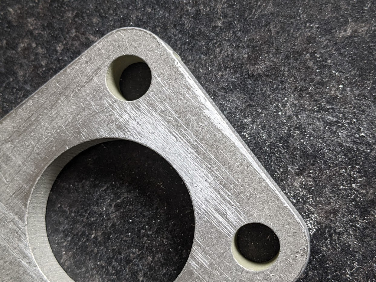

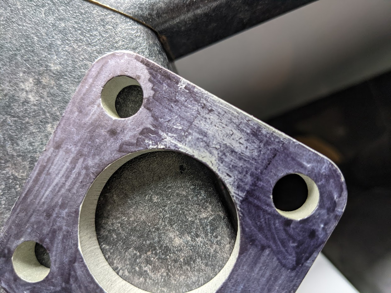

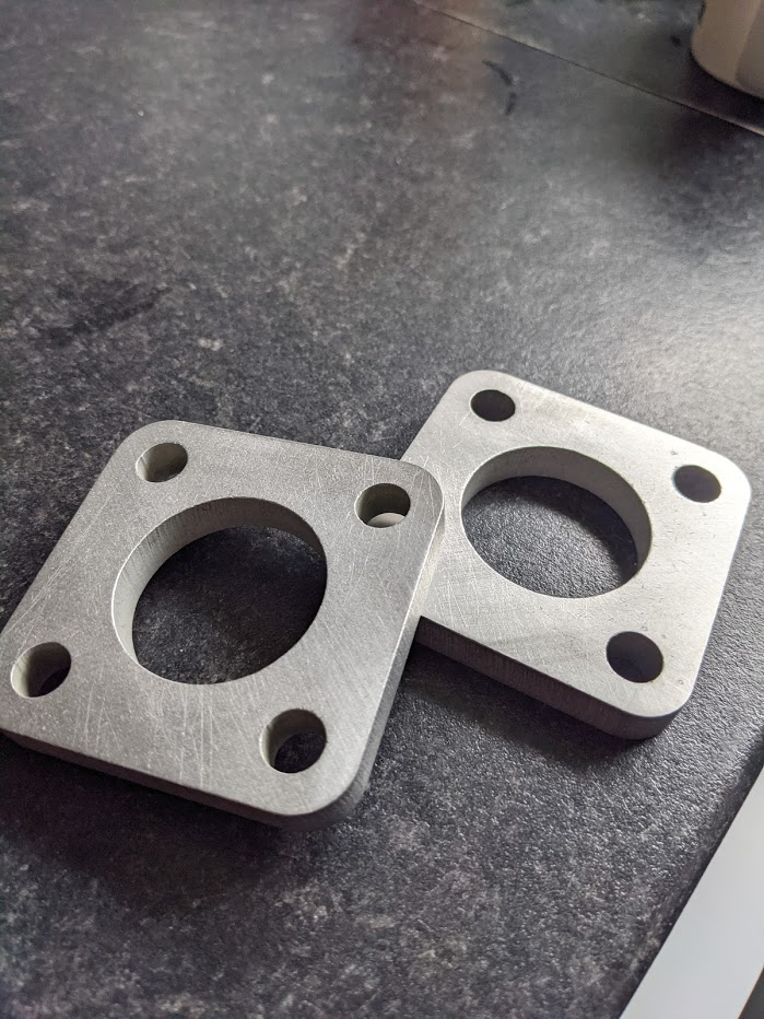

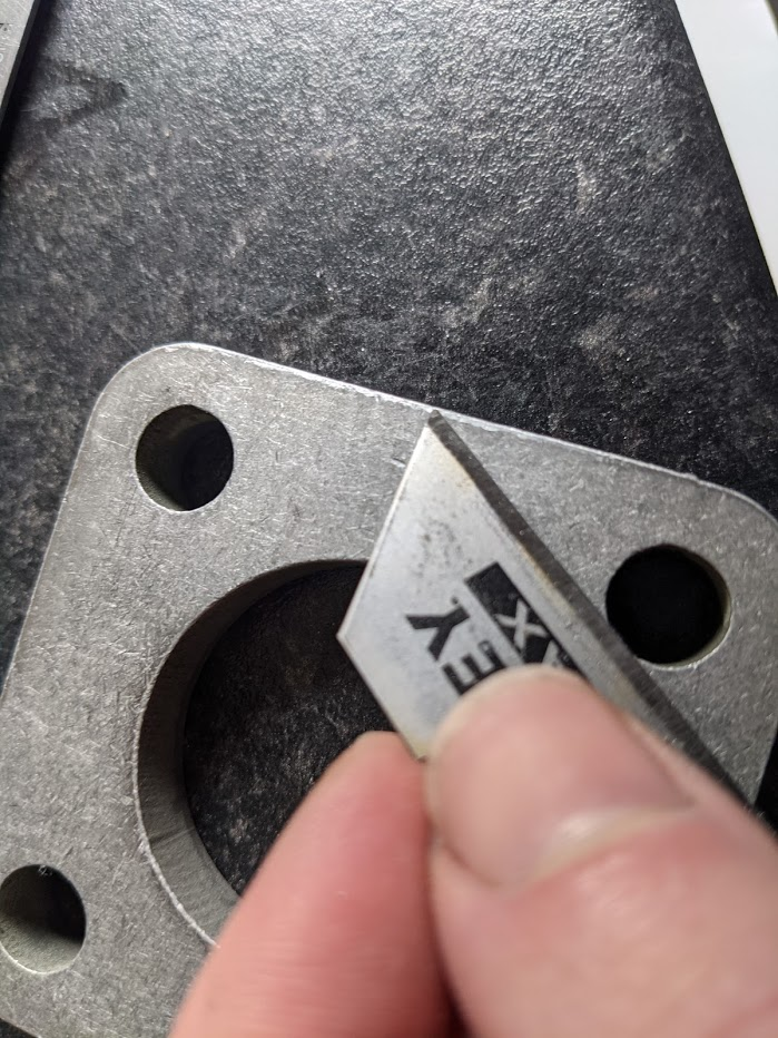

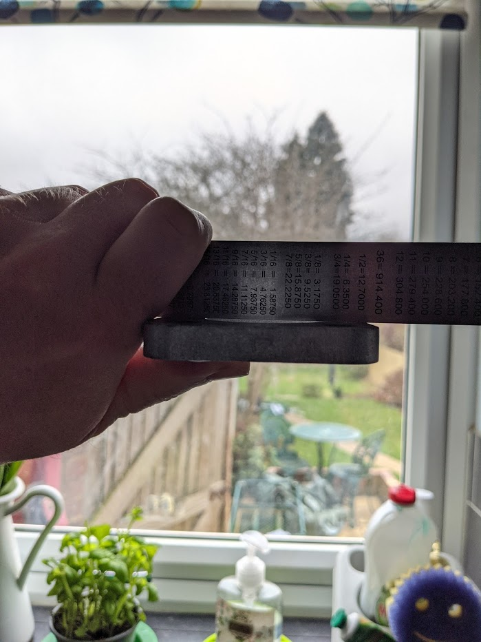

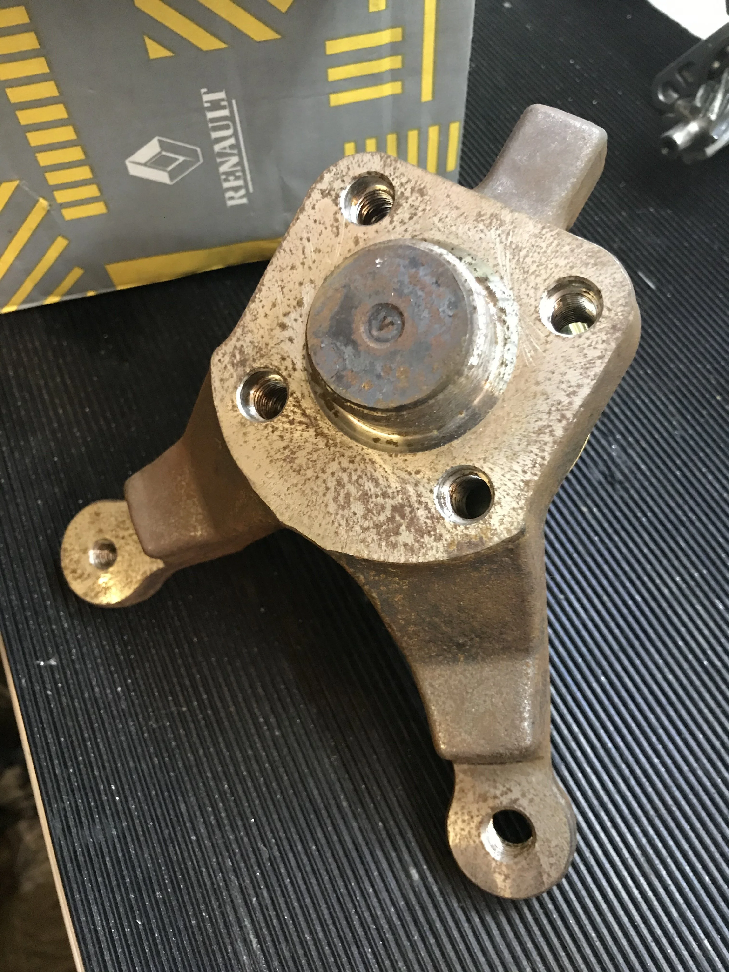

Now - I know PMS are the boys but I'm a bit meh about the rear spacer kit and front longer bolt kit. The longer bolts have a 17mm head while OEM Renault are 19mm so not I have to use two different sockets to do anything with wheels (should have just bought the stud kit) but more importantly the rear spacers were a long way from being flat

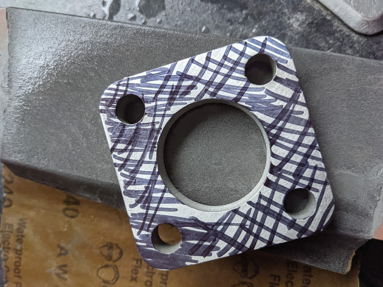

Some marker and a quick scrape shows what I mean
High spots like that aren't great and may well be a possible reason some people have had failures like @ZachB - if the hub rocks about the bolts will fatigue and break as his seemed to have done.

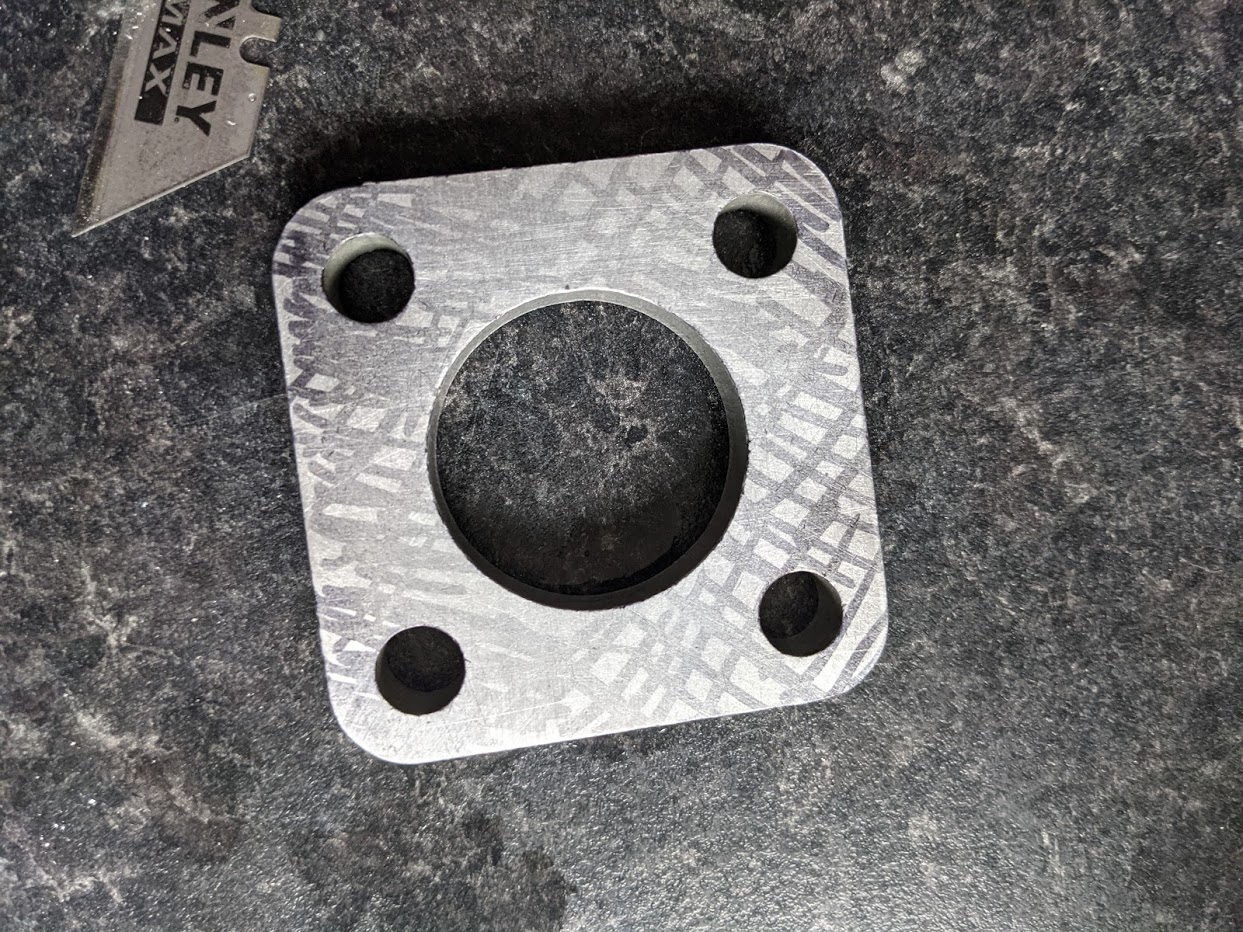

45mins of 240 grit on a new and pretty flat grinding stone

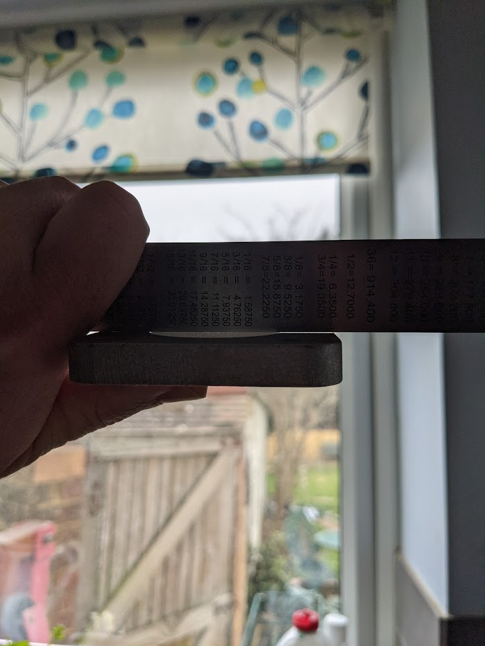

Worth a quick check for anyone fitting these, a new Stanley blade is pretty straight and will quickly highlight any high spots

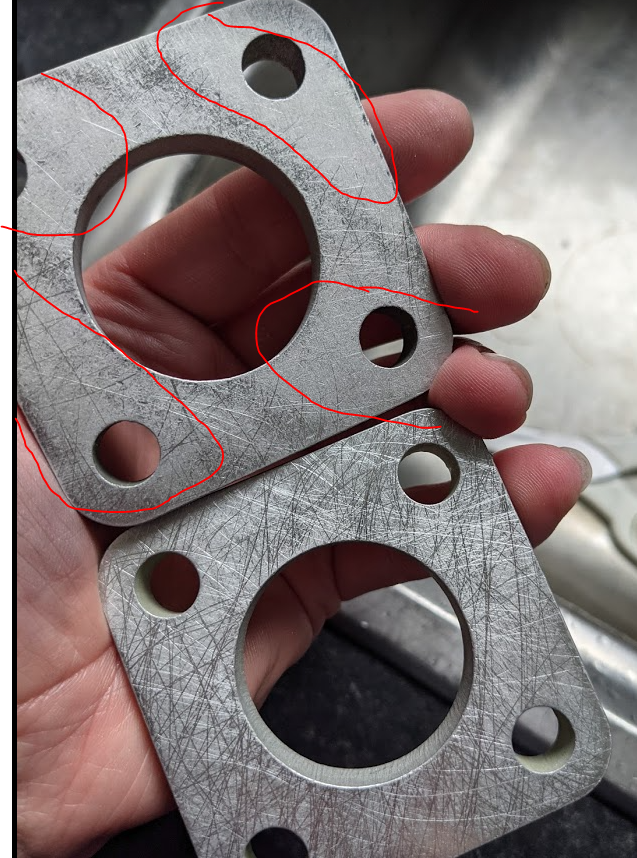

Once you have them flat rubbing them together will again highlight problem areas
The red circled areas are low - this is much better than they were
Flob

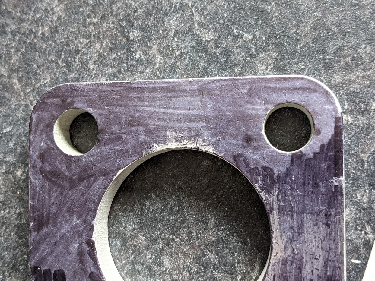

I did 4 rubs on 240 grit and rotated by 45deg, you can get things fairly flat by doing that carefully to within 20-40 microns or so if your careful beyond that you need to be really careful and have very good surface
This is how they ended up, not bad, you can still see a slightly low corner but I don't think that will be an issue, more importantly I didn't want any small high spots for the spacer to rock on.
Ready to fit
Terrible shot with spacer installed - just before refitting disk and new calipers
Renault brake bleeding life

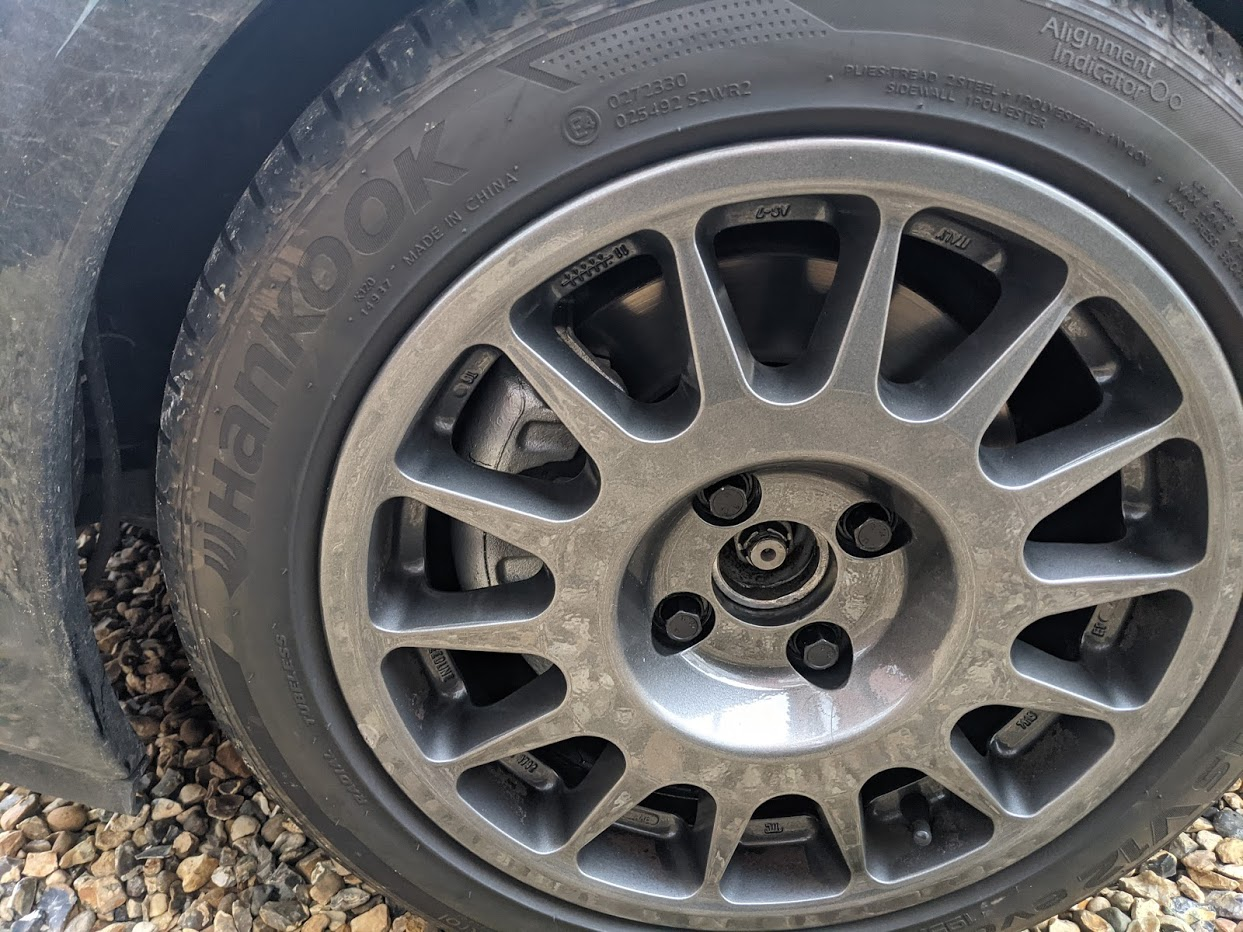

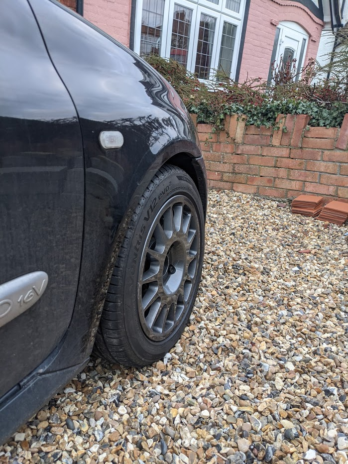

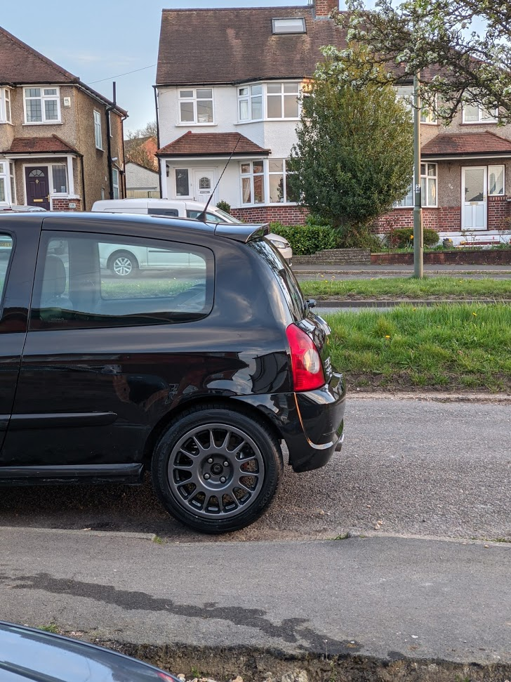

New wheels on and I'm happy
Keen to see how these Hankook V12's cope with warmer weather and some abuse - I am expecting to swap to something else at somepoint but these are an immense upgrade over what came off! The Eastwood silver paint is holding up well too, I've had the front brakes very hot several times and they are still silvery (after a wash)

Re alignment, thats more toe in than standard settings and you have more camber so you will definitely lose some turn in, read up on how camber effects tyre forces, the more neg camber the more the wheels will want to travel inwards, which is why you need more toe out.
Flob
I think its close to standard camber no? Think standard toe is between 5 and 10mins out front. Mine 100% needs more!
Suspension setup is something i desperately need to read up on. My thoughts were that I could do with more negative camber with 15" wheels as the tyres walls will move more?
I thought it was less than 1? Getting figures around 0.5 on search. Although 'the search' isnt exactly reliable lol.

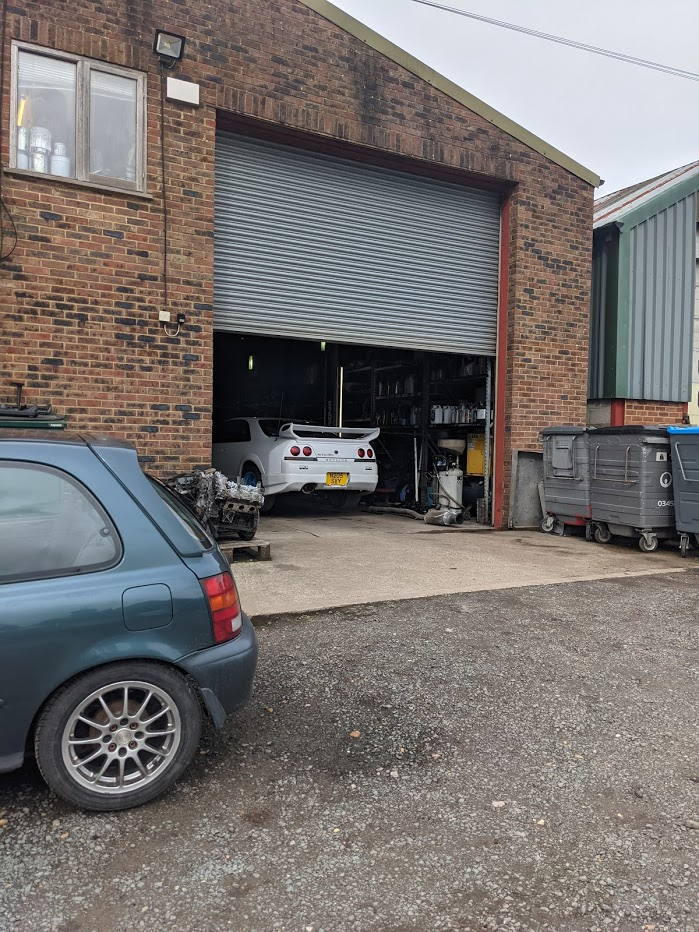

Sent the pics off to PMS and had a call back a few hours late - lovely bunch.
Nick has taken various spacers from different models and carefully looked at them all using their surface plate + a light (1000% better than me using a steel ruler), looks like mine were unusually bad however all of the others he has looked at are flat to within a thou (which is just fine for this app).
I think its quite telling that he instantly inspected what they had to hand, they obviously care deeply about quality and thats a fantastic thing. Other companies would have likely just ignored the email.
I would still encourage people to check spacers etc. for flatness before installing no matter where they have come from - but as said it looks to me like mine one a freak and others purchased and manufactured by PMS should be fine.

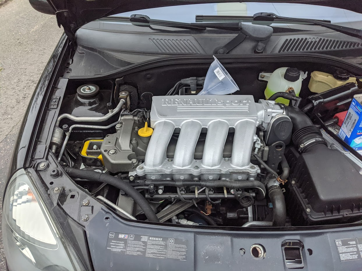

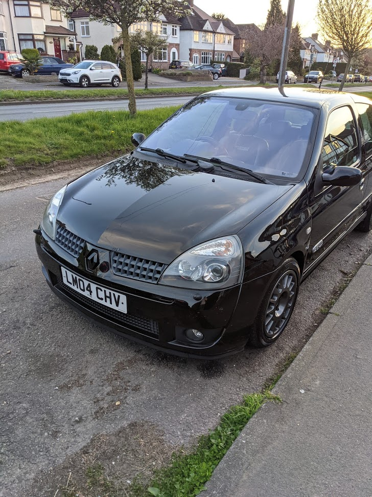

Not much to report other than one of the exhaust mounts slipping out of the bracket and a vac blacking plug popping off the inlet leaving the car idling at 4000 rpm all the way through traffic over Kew bridge last week - No one seemed to care just saw it was an old Renault and carried on.

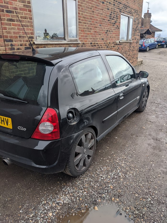

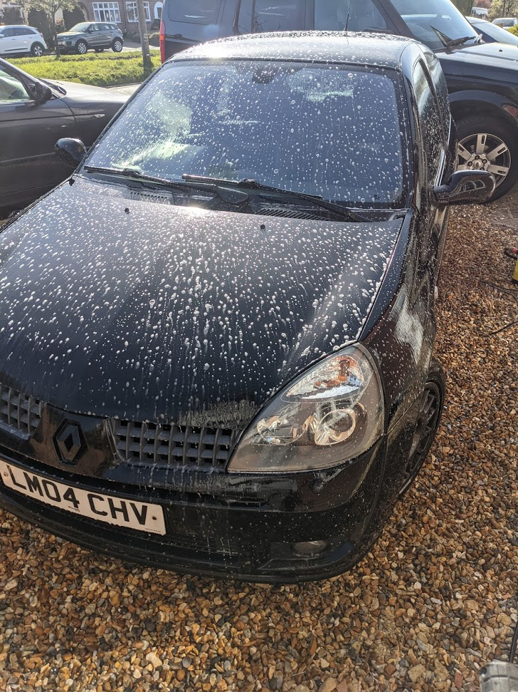

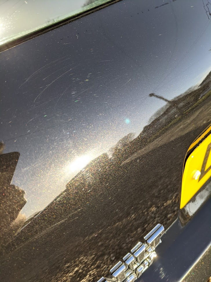

After a year of no washes it was time however to get the sponge out. Just a quick one as I need to do a fair bit of work on the body before calling it good. Also tested out some Bilt Hamber auto wheel cleaner which was ace, well recommended!
Ended up coating the car with TFR, then iron X before snow foam followed by bucket with soap - I can't be bothered to do any waxing etc as the car needs a few parking dents sorting followed by a good machine polish however I would like to ceramic coat it once all thats done as I'm not a regular car cleaner!
Should be much better after a good mopping, this is the general finish at the moment which isn't as bad as some cars I've seen but a long way off decent!

Luckily it was a silicon blanking plug which fell off, I've removed the carbon canister so this is the manifold take off from that - it was a decent fit but perhaps a little missfire popped it off. Temporary hose with bolt in the end is the current fix.
Most annoying bit other than the drive in traffic was the adaptions obviously changed so the car was annoying to start for a few days - all back to normal now though.

Just loop the vac round from front to back of engine (acoustic to carbon canister)
