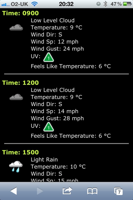

Havent looked at the weather yet and porbably wont do until Thursday as its so mixed at the moment. To be honest i used to pray for decent weather but have learnt that wet days can also offer lots of fun still. Sun/dry would still be preffered though.

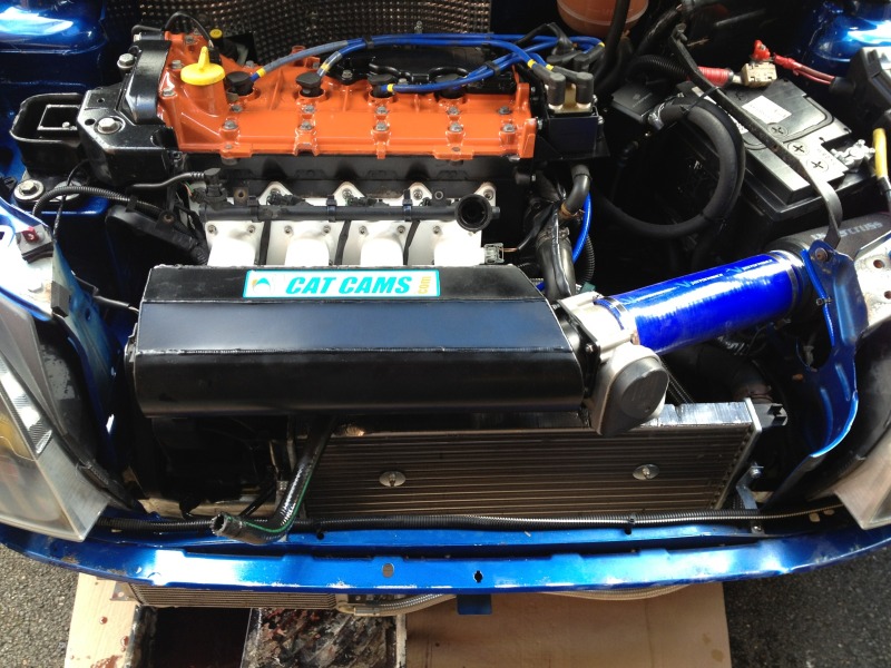

Our oil cooler had a very very minor leak. Think i have only ever seen it produce one mark on the drive so i just tightened the offending union by 1/4 turn to see if that improves it. Fingers crossed.

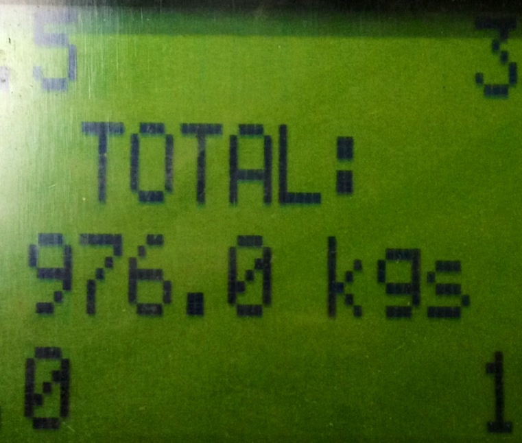

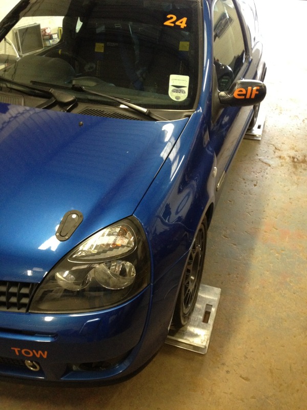

Today I visited BTM Performance so Fred could corner weigh the car. Previously Mike and I had just levelled the car (side to side) by eye and it turned out the weighting wasnt that far out. I think the front was about 25 kgs out and the rear was 12kg out. Fred tweaked the coilovers so its now pretty much spot on. We decided to set it up for a driver and passenger combo as the car never really goes out on track without someone in the passenger seat. Again, good service by Fred and also interesting to see how adjusting each corner can affect the weight on each/different wheels.
With half a tank of fuel the car weighs in at...
....Which isnt too bad. I actually had 3 litres of oil in the boot so i will ammend the figure to 975kgs :)

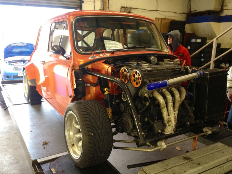

I then went to Jefferries Tyres in Bromsgrove to have the tracking aligned. It was quite a bit out after we removed the lower ball joints when removing/fitting the engine. I had it set to 10 minutes toe out on either side. Before the Clio was allowed on the Hunter maching I had to wait for another track car to be finished. Bit tasty:
Naturally, I got speaking to the owner. It's mainly used for hillclimbs and the odd trackday. Apparently, he recently annoyed some Ariel Atom's at Mallory Park by over taking them :) Funnily enough it had been corner weighted yesterday - 475kgs!! The red-top Vauxhall lump has been built by the team who prep the Cheverolet BTCC cars? I imagine the power/weight figure is pretty impressive.

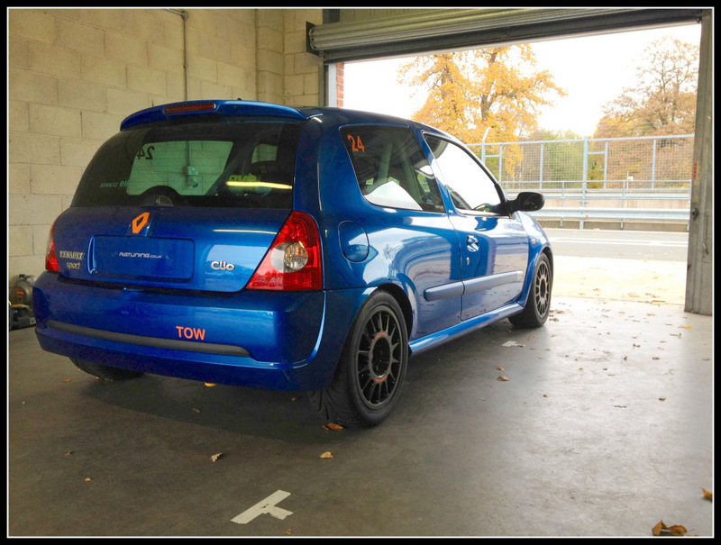

After 12 months of no track action Mike and I attended Oulton Park on an Open Pit day held by Circuit Days
Upon our arrival the paddock looked rather busy but sometimes trailers and support cars exaggerate the number of attendees/cars out on track. The briefing room also looked full and as it turned out the track at times did feel over crowded. The weather forecast was a dry morning with showers following in the afternoon and Mike and I had pre-booked a garage to share with sbridgey so we could work on the car (if needed).

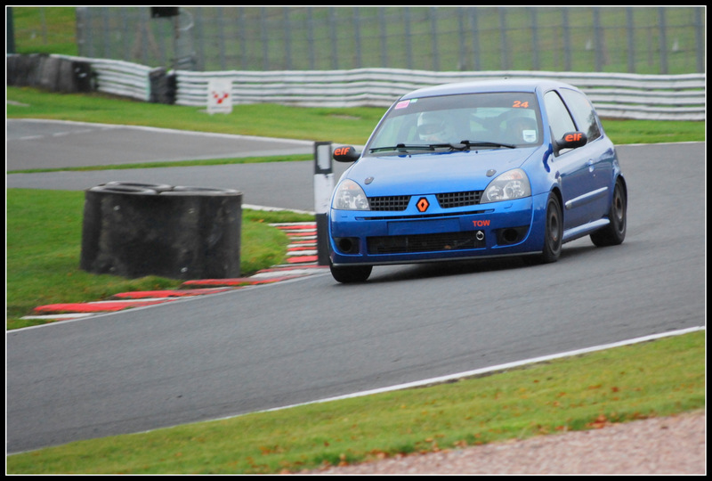

After the initial sighting laps we quickly went out on track. I must admit i didnt really enjoy the first two sessions. The track was really busy and i felt pretty rusty behind the wheel. Its amazing how alien it can feel after only 12 months away from it. During one of these session we were out with Stephen and I can only describe the conditions as an accident waiting to happen. A few too many cars but also the quality of some of the driving was particularly bad. It all came to a head when an escort (rally rep) span if front of me entering druids. It became apparent that the driver was deliberalty provoking slides at most corners and after another near miss Mike and I (and Stephen) decided enough was a enough and headed back to the pits. Hardly the best start to the day.....
On top of this the car has developed a whine from the gearbox. To be honest we had heard this before the track day but it was quite faint during normal road driving. However, on track the noise was much louder. It actually sounds good (in a straight cut 'box kind of way) but as its a standard unit it obviously means something is wrong. I dont pretend to know too much about gearboxes but i think it must be a diff bearing as its seems to be worse during cornering (where wheel speeds are different). You can hear it on the video. Depsite the sound it kept going for the rest of the day without worsening.
Before lunch Mike and I both had some really good sessions. The track was much less cluttered and we managed to string a few good laps together - we were now much happier :) The car pulled really well and handled nicely. The entire lap could be taken in 3rd and 4th gears and even pulled pretty well up the hill after Foulstons chicane despite being in 3rd and slightly under 5k rpm.
Just before lunch break the girls arrived and they grabbed a couple of passenger rides. I only managed to bag one onboard video and unfortunatley it was the one when i took my wife out in the passenger seat :) She hasn't been out on track for 4 years so you will have to excuse the laughter and general chat coming from the left hand seat:
I think in total we each got about 5-6 sessions in the car and both really enjoyed it. It was nice just to get back out on track and despite the poor start to the day it did improve. We tried improving our speeds through some of the corners and ended up taking druids in 4th instead of 3rd; that seems to work quite well. We still have a lot to improve on though! Even rain during the later part of the day didnt ruin it but instead offered us another chance to practice circuit driving in slippery conditions.
