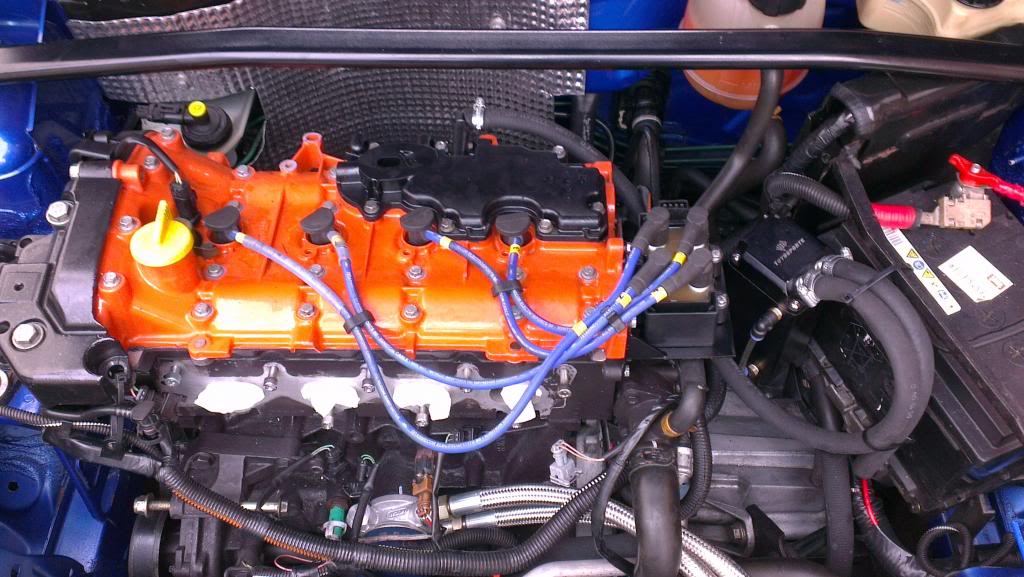

[FONT=&amp]After a few quotes we decided to go with West Renault for the alternator and[/FONT] Megane spark plugs. Nick had previously had major issues fitting the bottom cap screws to the manifold so I purchased an extension bar to make the job a lot easier. The end result was 30 minutes to remove and replace the parts, I'm glad this wasn't my 182 having the work done lol.
I cut down a spare breather plate, welded the hole, cut down the oval breather pipe, and then had the whole lot dipped and powder coated :) This now meant that the pure motorsport strut brace could fit without and fouling on the coil pack, and looked much more tidy. The coil pack was moved next to the cam seal on the right hand side, I had this fabricated and powder coated. Due to the new location of the coil pack the wires looked a bit odd with their length, We have since moved them around but I havent got an updated picture for that.

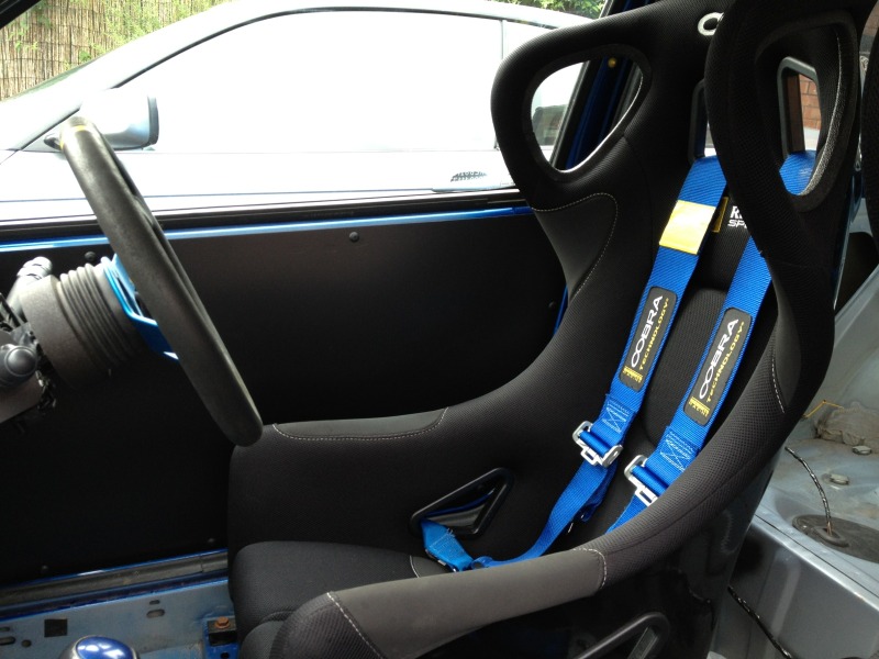

Update #24 - Door cards

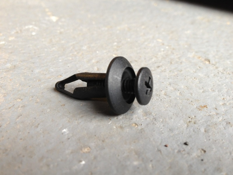

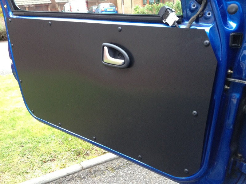

Last week i ordered a few bits and pieces off eBay in preparation to make some door cards this weekend. Seeing a few of the race cars the other weekend at Oulton Park confirmed that foam board is an ideal lightweight material perfect for this application. I ordered 2 sheets from here.
I also ordered 25 of these scrivets:
from here. Seemed perfect for £5.95 delivered
First off, i removed any existing fastners from both doors which would get in the way of the new cards. I then thought long and hard about where to relocate the electric window switches to. Initially i wanted to re-route the loom so the double driver side switches could be housed somewhere in the centre console. After assessing the situation i thought this might be better left to another day as its not a 5 minute job :(

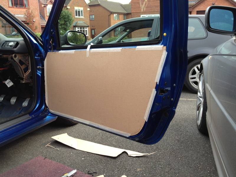

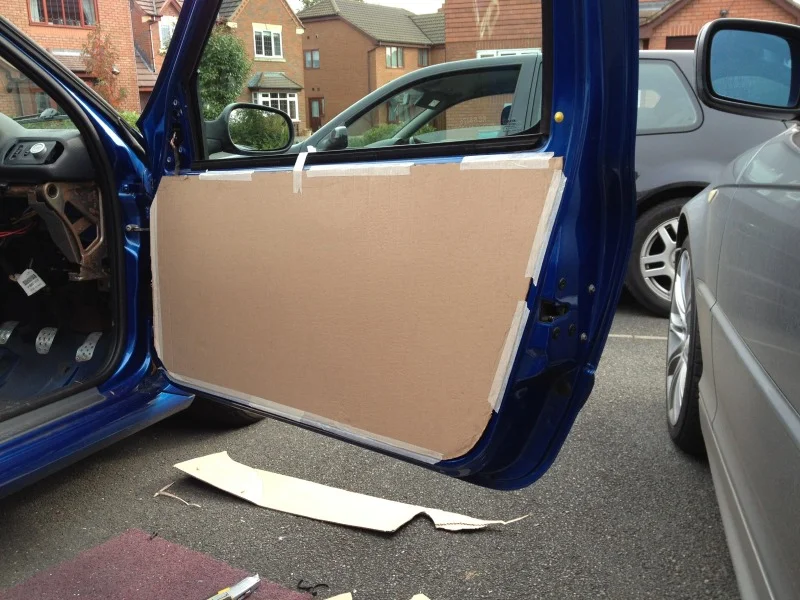

On to making a cardboard template:
Then transferred the pattern to the foam sheets. This stuff it quick and easy to cut with a new stanley blade. I then taped the new cards to the door and drilled 6.5mm holes through both the card and door. All that remained was then to push in the scrivets and fasten the door handles.
The addition of the cards really makes an improvement to the look of the interior. Pretty good value at £25! In time, i need to add some loops of material to act as door pulls and work out what to do with the electric window switches. Currently they are just hanging out the top of the door cards. I could cut a rectangle in each card to locate the switches, but in the future we may sack off the electric windows and get some polycarbonate replacements.

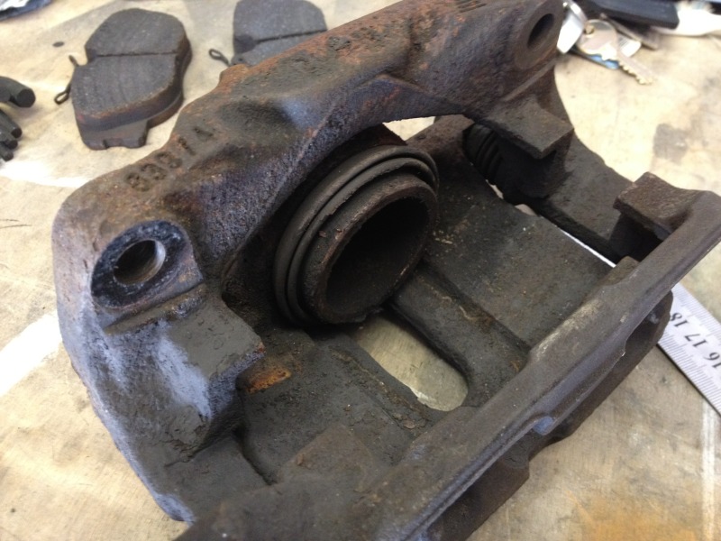

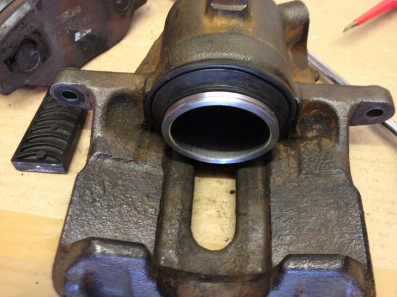

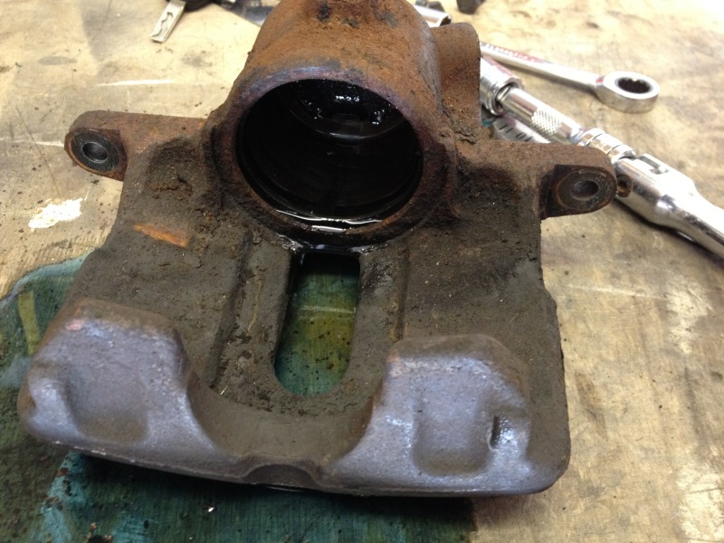

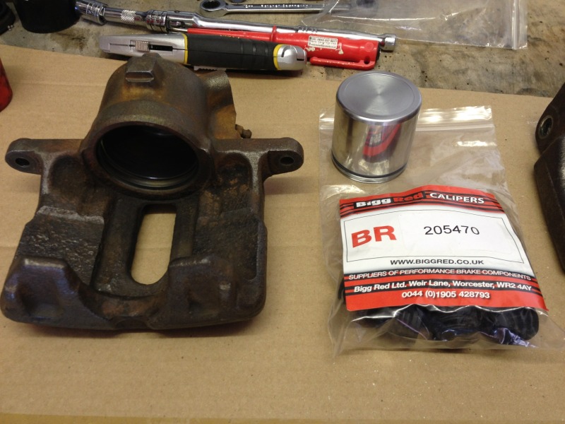

Update# 25 - Brake caliper overhall

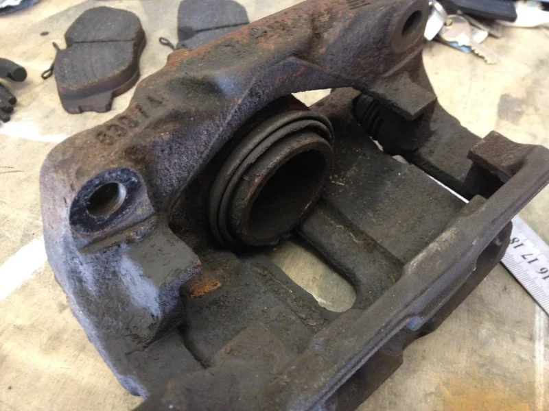

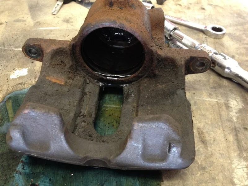

In preparation to our track day at Oulton Park this coming Friday Mike and i today tackled an issue we have had for a while with the front brakes. The car pulls to the left under braking and the passenger side wheel always get covered in more brake dust than the drivers side. Appears we have a lazy/sticking osf caliper. Earlier in the week i placed an order with Big Red brakes, located in Worcester. I cannot fault the service i received from them as the person i dealt with lives very local to me so offered to drop the seal kit and piston to my house the same night!
Today Mike and I removed the caliper:
Removed the piston by blowing air in to the brake hose hole using a track pump. Glad we kept the pads in as the piston fires out once free!!
Cleaned everything (caliper, carrier, sliders...) and got the new parts ready:
and reassembled:
Put it back on the car and took it for a quick drive. Car now pulls up perfectly straight. Result!
