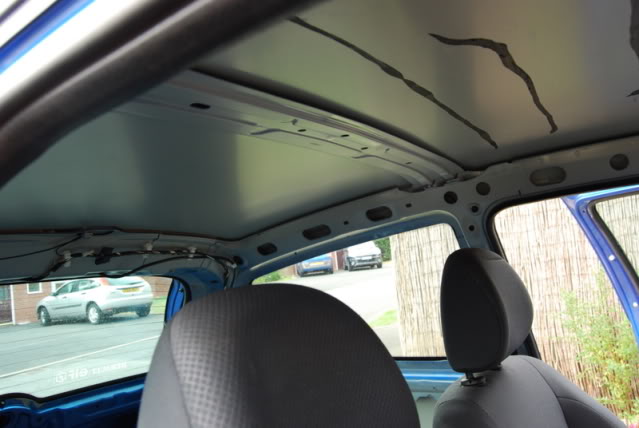

Sorry to highjack the thread a bit it, but does anyone know if it’s safe to remove the bar across the inside of the roof left once having removed the lining. I’m not sure if it’s structural or just there to hold the interior light etc.
  RB 182
The only place the light is secured will be the front top brace. You would be a silly man to remove it! It's all pressed/formed steel to give the car strenght and keep it regid.
  220 Trophy
Thanks. I didn’t say I was going to, was only asking if it’s safe to do so. I could've sworn there was a light, or alarm sensor or something there before I removed everything, therefore wondered if it was purely there just to hold the light, or whatever it was.

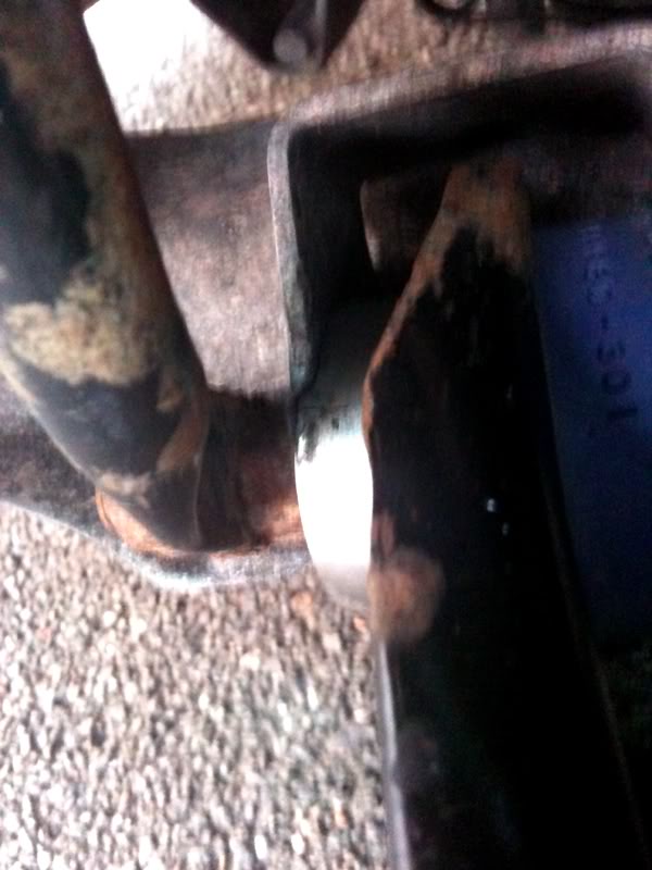

Last Wednesday (I think) I decided to have a go at levelling the car as the rear suspension sat lower to the one side. Looking at the rear cups it was obvious that the osr was wound up a good 5-10mm further than the nsr. After doing some research in to corner weighting I found an old thread that suggested the rear spring platforms should be roughly set the same and the osf should be set 7-10mm higher than the nsf to accommodate the extra weight of the engine and fuel tank etc. We could have paid for the car to be corner weighted but as GAZ coilovers receive mixed reviews we thought we might as well get it in the right ball park ourselves and see what it feels like on track before spending the money. It was whilst looking at the osf that I spotted something I really didn’t want to see:
Excuse the rubbish picture but it was taken with my phone moments after the discovery and I was already fearing the worst. Those of you that aren’t familiar with what goes on behind the wheels of the Clio are looking at what happens when someone doesn’t know you should really tack weld a Powerflex sleeve to the wishbone. In this case, our steel insert decided to dine out at the local `Subframe` diner L
A quick call to Mike led to another quick call to Fred@BTM. We then hot-footed it up to Fred’s for a brief inspection and an even quicker conclusion that it was “F**KED”. To be honest, I think I knew that bit was comingL
We left the car with Fred and explained that we had booked a track day at Oulton Park the following week. Fred would do what he could and see if it could be fixed in time. The following day we received a call that subframe really did need to be replaced. We could either source a second hand one or buy new from Renault. In the end we decided to get a new one. The expensive option but you never know what you get when you buy second-hand – at the end of the day I am sure we could have potentially bought a bent 2
[SUP]nd[/SUP] hand one and it only become apparent when fitting etc. Even though it was an expensive fix, I’m really really glad I spotted this before we drove the car with a little bit of anger on track. At least with a brand new frame we know that the wishbone wont detach itself from the subframe – something you don’t want to happen whilst tipping the car in to a corner at 90+MPH!

Fred ordered a new subframe direct from Renault. Luckily, Renault UK had one in the Country and delivery was due Monday/Tuesday this week. We now had a chance that the car could be repaired in time J but only if Fred pulled his finger out and performed some afterhours fitting. The subframe turned up on Tuesday to BTM but Fred spotted that Renault, in their wisdom, chose to deliver the wrong part! A quick phone call and they shipped the correct part to BTM later in the afternoon. Fred worked through the night and finished the car around 4:30AM and we picked it up at 6:00AM on the way to Oulton Park. Talk about cutting it fine!

Here is a crap picture of our new shiny subframe in situ:
A couple of other little things were spotted whilst it was on the ramp but thankfully these are pretty minor and be rectified in the near future.
