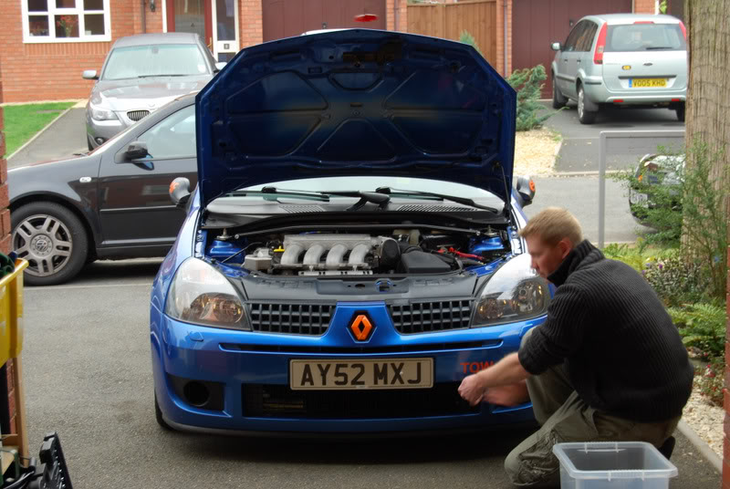

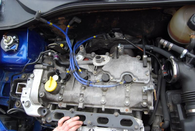

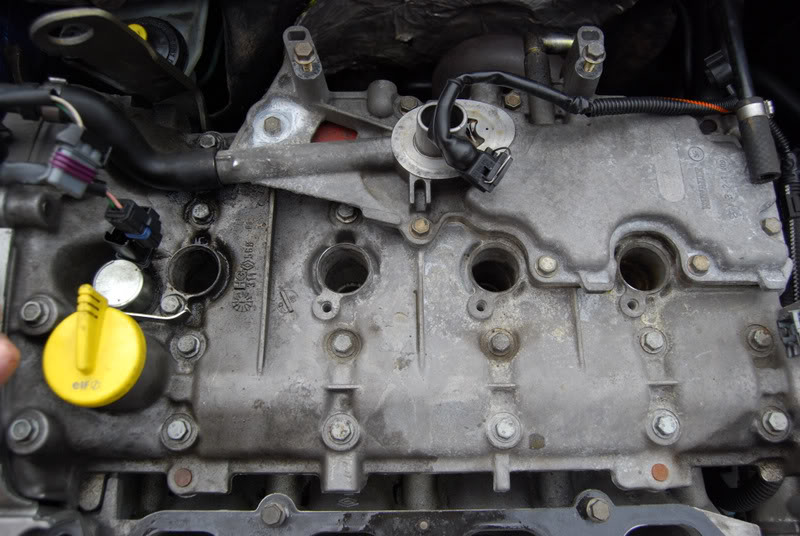

Sunday morning saw Mike and I start our joint effort in removing the engine:eek:. I let Mike remove the first piece, the towing-eye:
I then had a go at cracking-off the hub nuts. I thought I would have a go at these first of all just incase I couldn't budge them much further down the line. Drivers side was OK but I managed to break a 1/2" extention piece out of an old budget toolset whilst trying to loosen the passenger side. Luckily my Halfords advanced set coped much better and i looesed the nut by 1/2 a turn.
We then started to remove the bumper and and the passenger side 10mm nut started to spin without coming out. Felt like it was starting to fight us already:dapprove:. After this bolt the rest came off quickly:

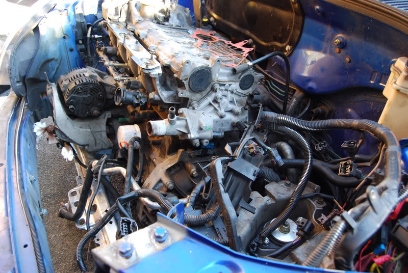

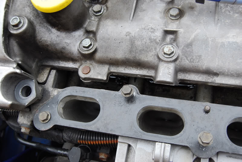

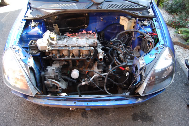

We then started to remove all the other engine bay bits'n'bobs which took a while. Too be honest I didnt quite realise how much wiring and associated sensors there are to unplug! Speaking of plugs, when we removed HT lead #4 the plug recess contained quite a lot of oil. The rocker cover surrounding this area appeared quite dry so i wonder if the oil pushed past the plug? Also, there was some oil resting between the inlet manifold and head for this cylinder:
All but one exhaust manifold nut came off OK. One would not budge but would rather round-off rather than move! Thank god it was one of the upper-bolts. We tried everything but in the end resorted to dremeling the nut. Even then the stud came out with the nut still attached :mad:
Everything is pretty much disconnected so we tried to drain the gearbox oil before moving on to removing the driveshafts. Blast! Didnt realise the gearbox sump needs an 8mm square sump tool! I drove to the local Halfords but typically they were out of stock of this part - arrrrgh!! Still, the reason i left the gearbox and shafts until the end was so we good move the car around and back in to the garage if we ran out of time - which in the end is what happened as Mike and I both had other commitments later in the afteroon.
So, not too much left to do before we wheel out the hoist for the fun and games. The dog-bone mount (and gear selector rod) has been disconnected so I think its just the two upper mounts, drive-shafts and any wiring that's still connected or in the way. It's a bit hard to see where the wiring harness goes under the exhaust manifold. Here is out is stands at the moment (BTW-the breather plate was removed to give better access to the stuck manifold nut):
Fingers crossed we will have it out next Saturday.
Thanks for looking,
Nick (and Mike)

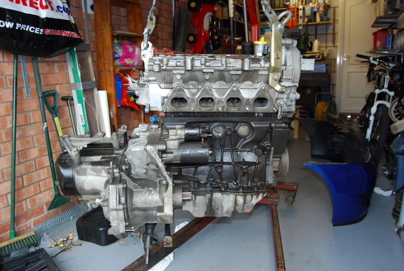

Update 12a - Engine Out, phase II

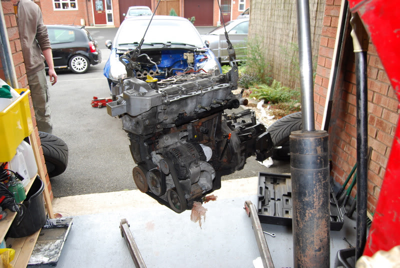

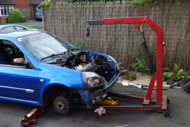

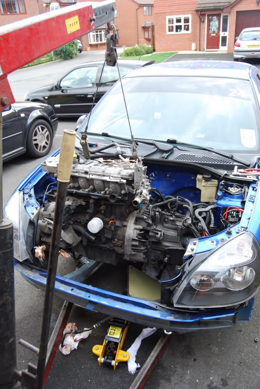

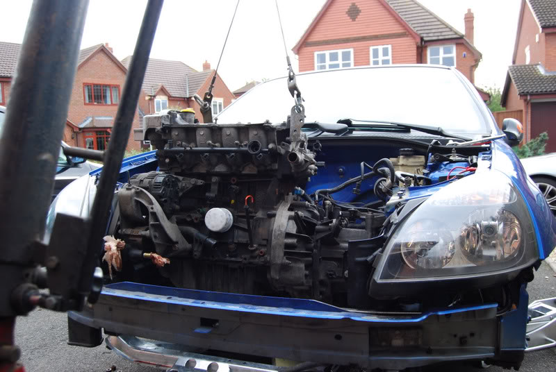

Yesterday Mike and I pushed the car out of my gagrage for the 2nd stint at removing the engine. It's a good job we dont own a garage as I think we may have exceeded the book time a little with this removal. Hey ho, it's our first time at doing this anyway and would rather take it easy, photograph connections and fixing etc than rush it.
I bought an 8mm sump tool in the week so started by draining the gearbox fluid. I hate seeing oil come out that we changed less than 500 miles ago :( After that we got the car in the right position on the drive so when we needed to lift the engine out the hoist could be pulled back enough to clear the garage door. Then the driveshafts were removed (a lot easier than I was expecting), engine and gearbox mounts loosened off and finally the hoist wheeled in to position.
A fair bit of jiggling around later and the lot was starting to come free.
The tightest bit of the lift is getting the engine and box through the chassis legs - once past these it was quick and easy. I then lowered the hoist a little and wheeled it back inside the garage at which point Mike and I were quite relieved and pleased with ourselves. A picture was taken.
The exhaust side of the block was really oily (probably from when the oil breather hose popped off) and also had some grease from a previously broken CV boot. Looking at the exhaust ports it looks like #4 cylinder was burning slightly different than the rest.

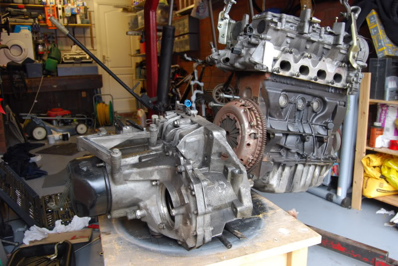

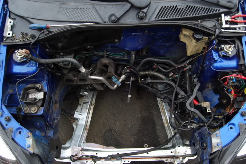

It was then a matter of spliting the gearbox and starter motor from the engine which didnt take too long at all.

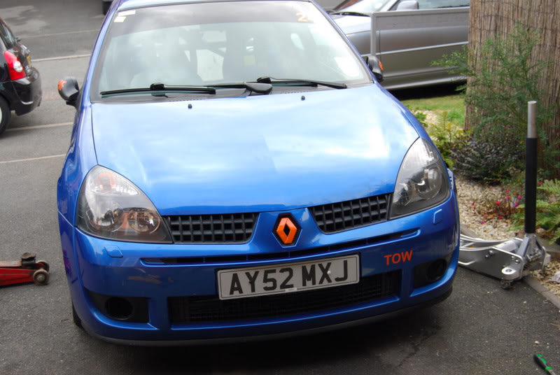

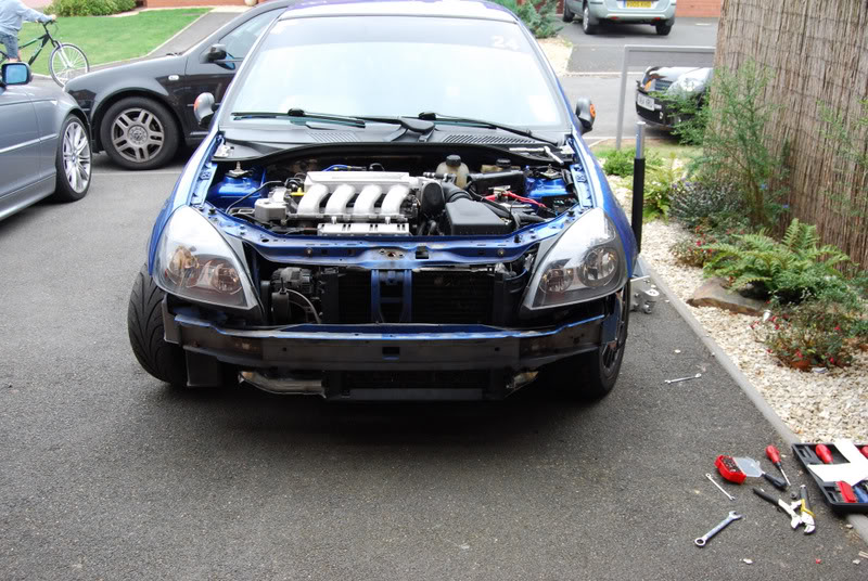

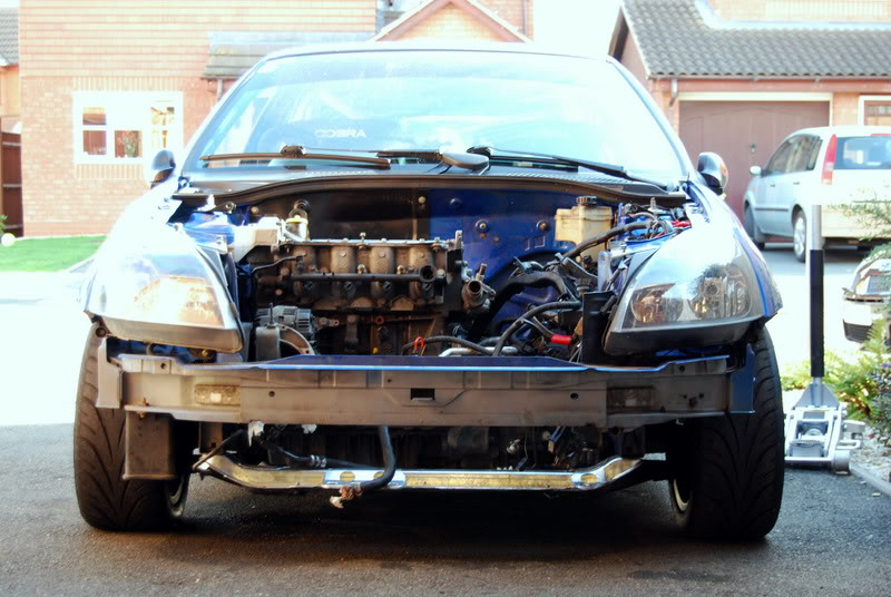

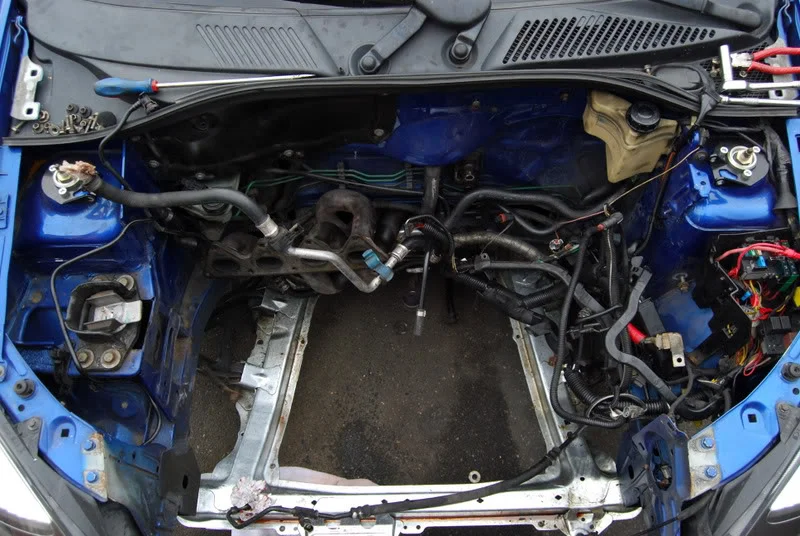

We then had a big hole in the front of the car..
..so we put the driveshafts back in and connected the lower ball joints to the wishbones - wheels back on, bumper and bonnet placed in situ and pushed it back in the garage. Almost looks like we never started...
So, I think all that remains now is for us to remove the lower inlet manifold before the engine goes off to BTM for an inspection. It's after this point (and Freds findings) that we will decide what course of action to take with regards to getting this car back on track.

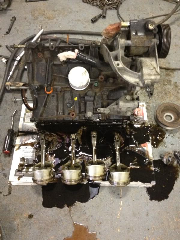

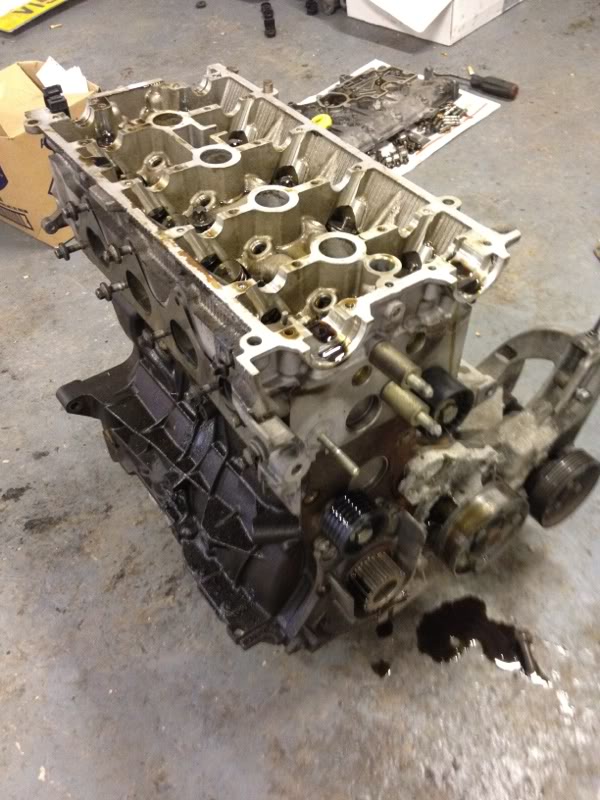

I delivered the engine to BTM Performance complete with a little bit of blood from my mates hand, which he cut when we lifted it into the boot of the Golf (Oops). I would say not much more than 30 minutes after my arrival Fred had the majority of the engine stripped down! This was rather unexpected as I thought I would just drop it off, leave and get a phone call whenever Fred had some news. This was great as I was was eager to see what had gone wrong and also see what an F4R was like inside :)
First issue we saw was that the cambelt had next to no tension in it! Not good but lucky that the belt was still in the right place I suppose. The rocker cover came off and the cams look fine and the head is OK too, which is really good news as I will explain a little later. Head off next and the top of the pistons look OK but most of the bores have some markings. Sump off, after one troublesome bolt refused to undo, and the crank feels tight (as in not free to spin). Big ends off and the bearings of all 4 rods are knackered with heavy scoring to each - that produced the knocking sound in the video earlier in the thread! The main bearings looked OK but even with the rods disconnected the crank was so tight you couldn't turn it with your hands! Then as Fred inspected piston number 4 something fell on the floor - part of the piston no less (next to the oil ring land - if I understand correct?). It all hints towards oil pressure failure - maybe a broken pump or a crank pulley that had turned on the crank.

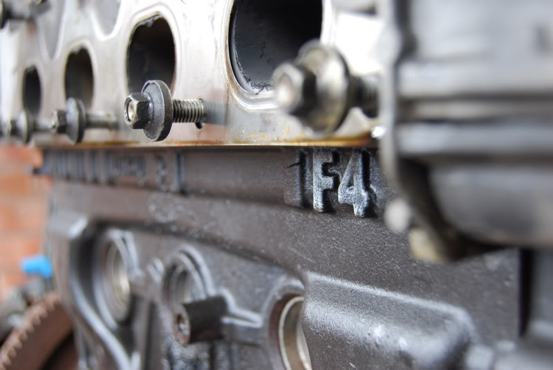

Some pictures during the process-

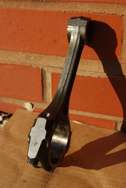

Evidence of prior rebuild(blueprint and balance according to receipts) - numbered rods:

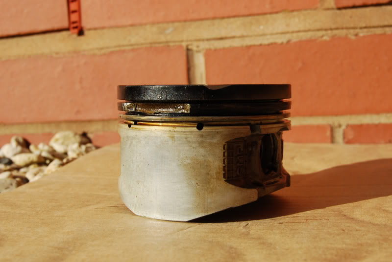

Photo of failed piston - spot the missing piece:
Far from ideal then! So plan of action is to scrap the bottom end and start over. After the pistons were removed the block had bad marks in it and the crank, although relatively unmarked, is a bit of a risk with it not spinning freely. Fred is going to rebuild a known good bottom end - Hone block, new rings, bearings, seals, squirters etc. This will then be mated to our exising cylinder head, new cambelt of course and new clutch as its daft not to replace it at the same time. This wont be ready for somewhile as Mike and I are in no rush and have no intention to track the car until the new year. There is the option to put forged rods and hi-comp pistons in it, but that all boils down to cost - Mike and I will have to make a decision on that one.

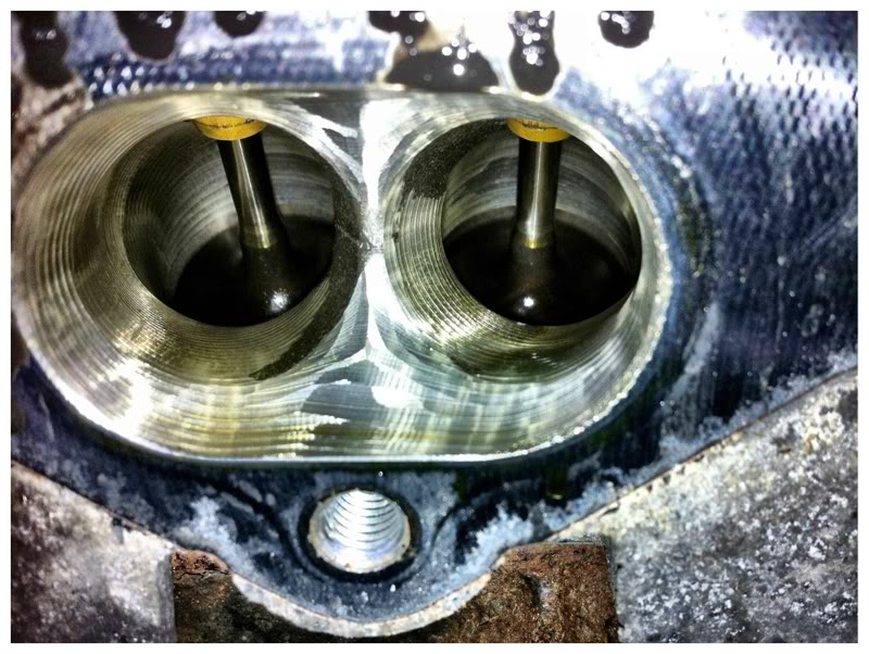

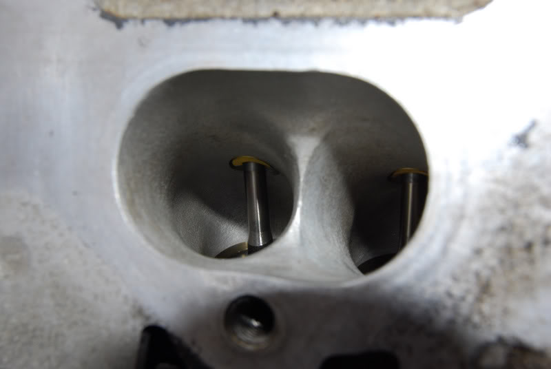

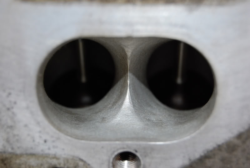

There was some good news though! A previous owner had documented that the head had had some work carried out on it. When I removed the lower inlet I was half expecting to see standard ports as you can never really know what you have until you see it etc. I was please to find that the ports have seen some work :)

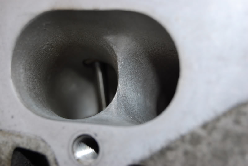

Picture of standard 1*2, CNC finished, head - picture pinched from Cup_Phils project:
Our head - no machine marks present:
Looks like it was a half decent, valves out job, too - note cut back valve guides:
Maybe this is why the engine (prior to failure) felt strong!?

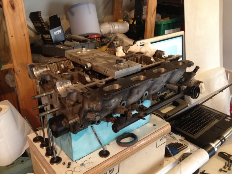

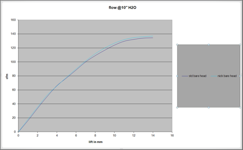

Yesterday we visited Andy's place and spent a few hours trying out all sorts of things on his flow bench. In the past I have read a little bit about porting cylinder heads and how the flow can be measured on a bench but I have never physically done anything so the chance to see what goes on was of interest. We took along the cylinder head, lower inlet manifold and uppler plenum to measure.
The head, by itself, was measured first - we would gradually add the lower and upper inlets during the tests. Andy had a quick look at the inlet ports and thought that they generally had been polished but not really been altered in shape by any great margin. 2 inlet valve springs were swapped out for lighter units, to aid our ability in applying varying levels of valve lift. The valves themselves were standard two pieces jobs with no work done to the valves themselves. Also the cylinder head chambers were standard.

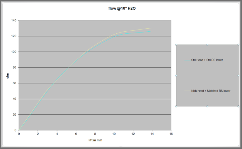

As it turned out Andy's initial thoughts were correct. Our head does flow more than a standard CNC finished head, but nothing too spectacular. Below is a graph comparing a standard head against ours. The x-axis represents valve lift - for reference a standard 172 inlet cam provides 10.8mm of max. lift:
Even though the improvement isnt massive as with everything - every little helps:). If you saw what a Guy Croft head can produce on this bench there is loads left to be done on ours!

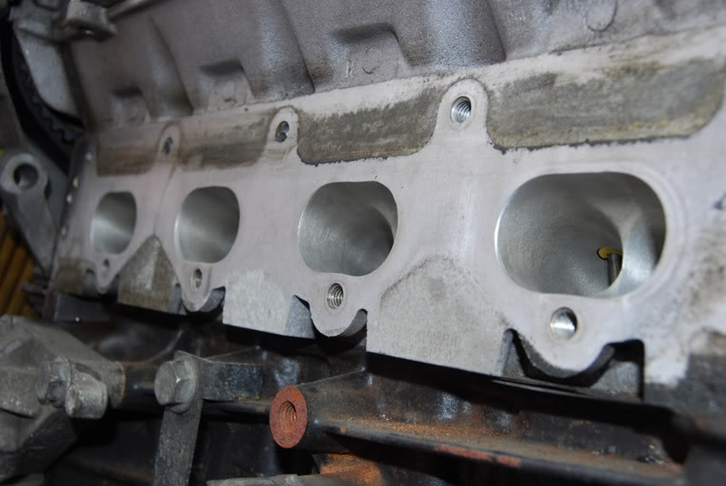

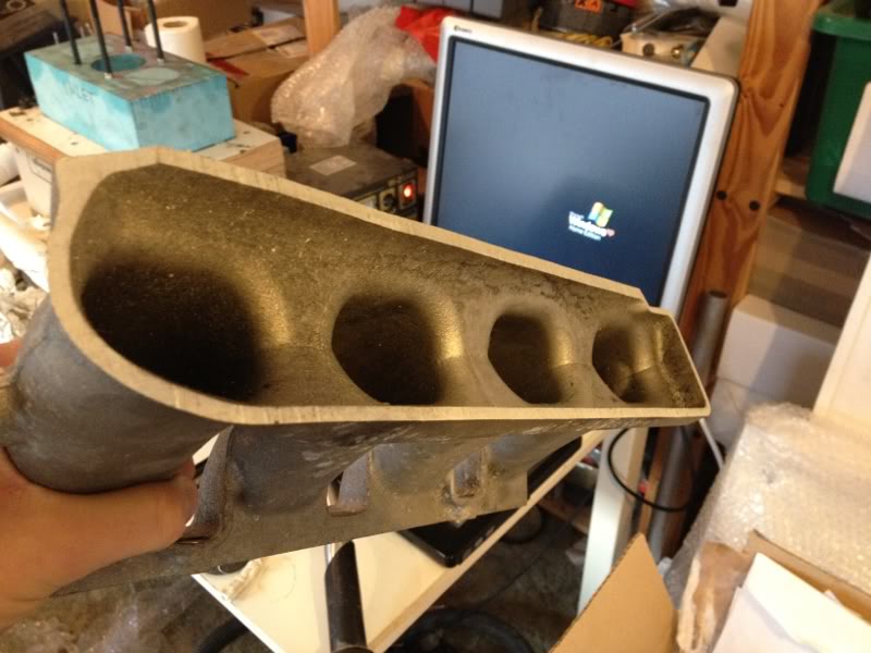

Next up was the head combined with the matched RS lower inlet. Andy assesed the lower inlet and thought the matching looked very well done. Its funny, the upper face that bolts to the upper plenum hasnt had too much done, it's all in the lower half; where the inlet matches to the head ports. I would say that the work has been done from the injector boss downwards.
Pic of the head and lower RS on the bench:
Results comparing std head and std RS lower V our head and matched RS lower:
Its hard to see but our matched lower RS inlet is only affecting the CFM (Cubic Feet/Minute) results by 3 CFM between 6 and 10mm of valve lift - thats pretty good!
