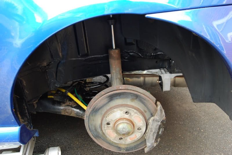

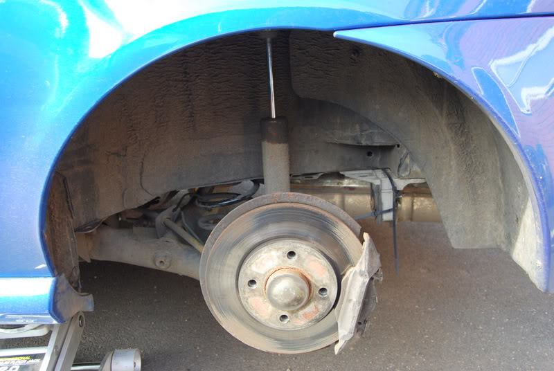

We started at the back of the car and as the arches have yet to be cleaned during our ownership we thought now would be the perfect opportunity - as both wheels were off at the same time.
Crud and a few zip ties to be found here :dapprove:

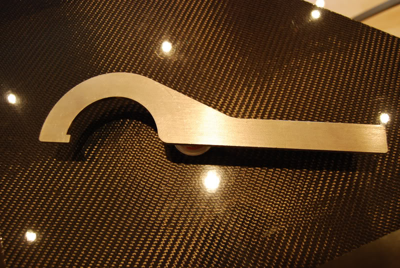

Much better after a pressure wash, degrease, and squirt of WD40 over the spring platform and rebound adjusters :approve:

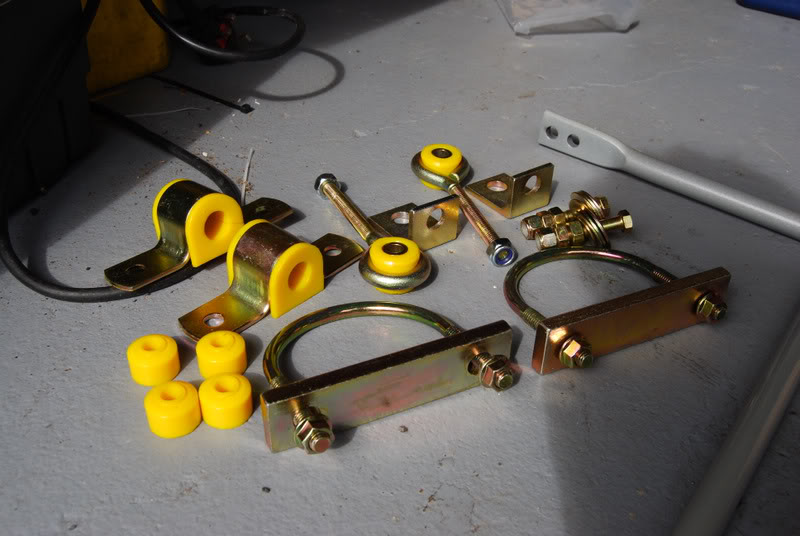

Which leads nicely on to why the back off the car is in the air to start with. A package containing this little lot had been delivered:

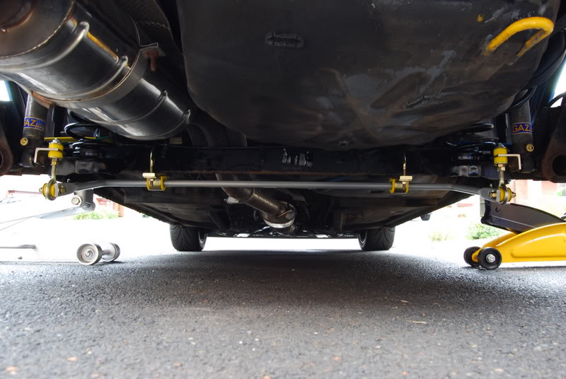

Whiteline adjustable ARB - This really didn't take that long to fit between us. We decided to go sensible and fit it on the soft setting to begin with as I have read (and hoped) that these can make quite a difference the cars handling. Picture of it installed:
As the back was still in the air we ran new Superblue Racing brake fluid to the rear of the car. In addition we raised the rear ride height a fraction, probably between 5+10mm, to try and reduce understeer. Our car, compared with other track orientated Clio, has always looks rather low at the back and flat front/back. Trophies by comparison have quite a bit of rake. Adjustment of the ride height as been made easier now as Mike cut a new C-spanner for us (would love to have a laser or water cutter at home):

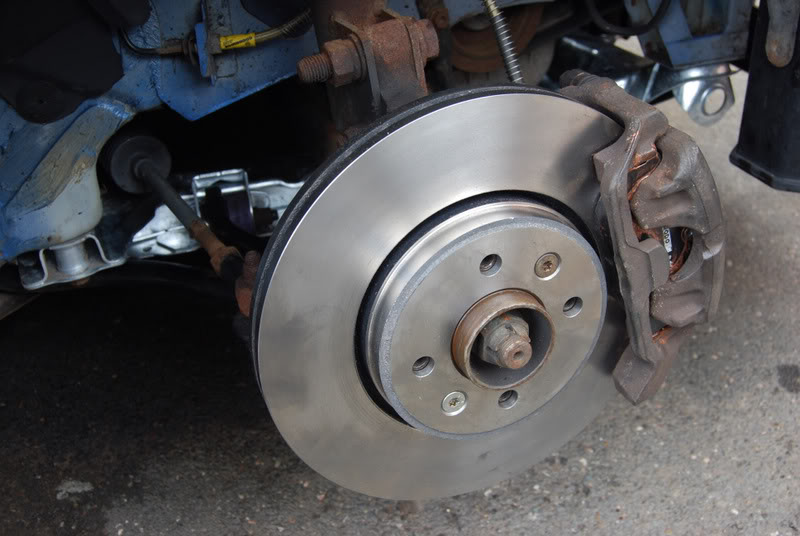

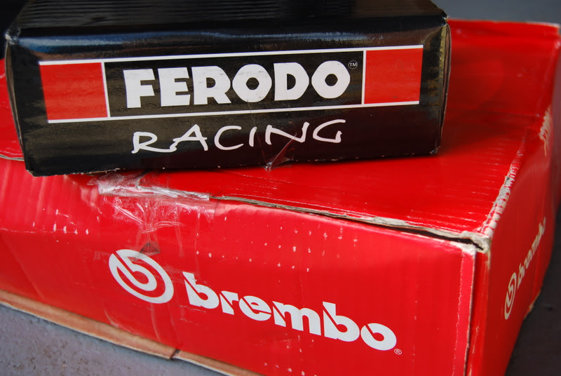

We then moved to the front for a bit more simple maintenance. Our pads had taken a beating at Oulton and had reached the end of ther life. We decided to removed the Brembo Max Grooved discs and revert back to a tried and tested disk - Brembo HC (plain). Our pad of choice this time was Ferodo DS3000:
Fitting was simple and both sides were complete in no time
I noted whilst fitting the discs that they didnt have the dot wear indicator on the braking surface. I don't know why this is as I am sure I have seen others with them. A quick look at the packaging reveals Brembo - Clio Group N discs? No idea what relevance this has - anyone who can offer more info please do so.

Are brembos Group - N discs their version of standard stuff? I.E not the High Carbon jobbies! I'm sure i had heard that quite a while ago. Your pads may eat through those discs! Maybe a phone call to brembo may be your best bet!
Rollox! Will look into it - thanks for the heads up. Brakes feel immense at the moment though although wheels covered in dust after 30 miles is laughable:)

Regarding the grease. I always thought you needed that on the contact points to stop squealing etc?
Dry assembly on clios so no need plus if it gets on your disk you'll no about ;)

Part number for the high carbon discs = 09.8137.24 should have the HC box ticked on the box.
Thank you for taking the time to post this info. I will check the box later but think I know where this is going already.

I've emailed John Harris @ Demon Tweeks and will follow up tomorrow morning. They will last a track day or two im sure, just not what I ordered :( I would have though "Group N" would be a good spec anyway?
  BMW 330ci sp/ 172Cup
Had a quick look at the box when I got back home this evening and found the following:
HC is ticked on the box so one can only presume we have the correct discs:) I think the lack of wear dot and me picking up on the more obvious "group N" ref on the sticker put doubt in my mind.

did you remove the pad carrier shims and clearance the pad back plate so the pad is free to move? Or did you just whack em in?
(or did i grind the pads for you? i forget) I did tell Ingham
No shims and filed the pads so nice bit of room to move. Plus a bit of copper grease on the contact points:)

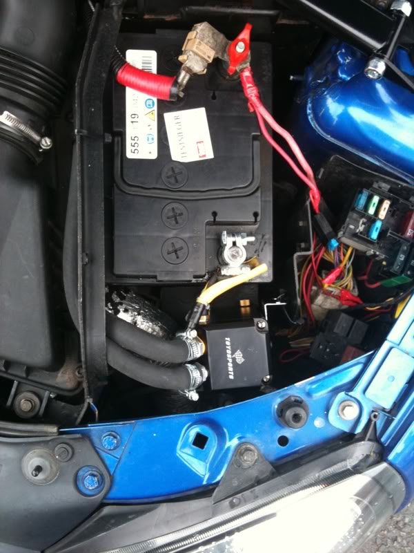

Not long come in from fitting our latest purchase. Something from Pure Motorpsort- it's quite nice!

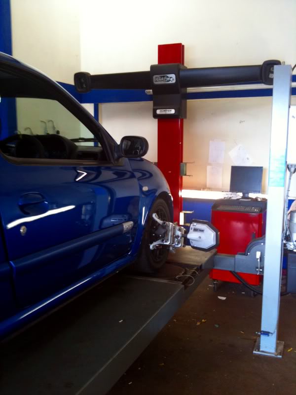

We had booked a trackday for Friday (just gone) at Donington Park. In preparation for this we decided to have the tracking checked and corrected. We knew it was out since the new front subframe had been installed but now was the time to sort it out. The car pulled to one side and that was bound to affect handling and more importantly wear our tyres out quicker than need be. As time was tight, on my luch break, I called in at Jefferries tyres in Bromsgrove for them to perform the initial check and correction work. I have used this place for many years as their tyre prices are very good, although I have never used their recently introduced alignment service.
On the ramps being set-up on the Hunter machine:
I explained that I believed the tracking to be out and also that I wanted the toe-out set to a non-standard setting of -10` (recommendation from the boys@BTM).

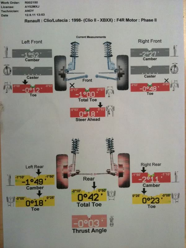

Here is how it stood to begin with:
Note the toe out of -48' on the drivers side! - that might explain the pull. Also the camber was out. We would like to run 2.5degrees -ve camber at the front but didnt bother with the adjustment (and associated cost) just yet as we still had to settle the ride height and fit something at the front which might also affect the camber (more later). I knew the toe would also be affected when adjusting the camber at a later date but thought it still worthwhile getting it right for the time being.

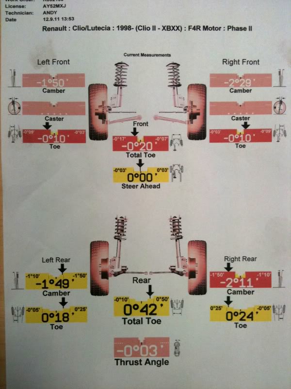

After the tracking was complete:
The test drive on the way home confirmed that it was worthwhile. The steering wheel now sat straight and I'm sure there was more weight around the dead-ahead/middle of the steering. Also the steering didnt tug as much when going over bumpy/excessivley cambered roads etc.

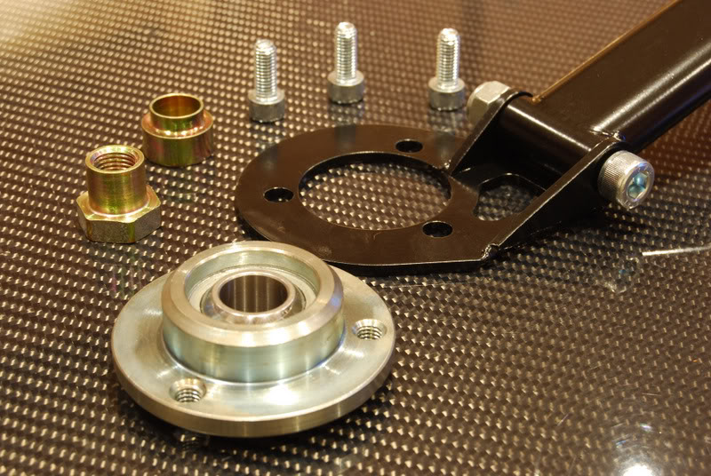

Typically, the next day we made a decision to order the next upgrade part in an attempt to fit it prior to Donington. Mike had put his name down in the Pure-Motorsport top-mount/strut-brace group buy quite some time ago. Recently the group buy had the required 5 names down to full fill the order. Despite this people dropped out and it seemed like this was going to drag out for ages. In the end we decided to order ours anyway and lose out on the potential discount upfront. PM dispatched the goods the same day and they were delivered the following day (Wednesday).
Mike promptly came around to mine and we started the installation asap. I figured that if we started at 6PM sharp that would give us just over 1.5hrs to get the topmounts and brace fitted - just before dark. We ran into a problem straight away! The existing nut on both of the old top mounts were unbelievably tight. As we have GAZ adjustable coilovers we dont have an allen fixing to hold/stop the strut from spinnig but a 10mm flat. 10mm spanners are pretty small and dont offer enough leverage to stop the strut turning. Ideally an air-gun could be used here. At this point I tried almost everything I could get my hands on in my garage to hold the strut - nothing fitted properly and we didn't want to round the edges off etc. Only one thing for it then - a big old No.1 vice clamped to the strut - LOL. Crude, but it did the job brilliantly. Shame it took over 1hr to reach this point! The rest of it came out OK but we found out that we dont have camber correction bolts - doh! Will get these ordered from BTM soon.
Installation was simple enough although it does pay to take your time when marking/drilling the holes for the 3 x M8 bolts that clamp the brace to the new top-mounts through the turrets. We ended up finishing the job in the dark working by a floodlight and florecent inspection lamp.

Pure Motorposrt solid front top mounts and strut brace

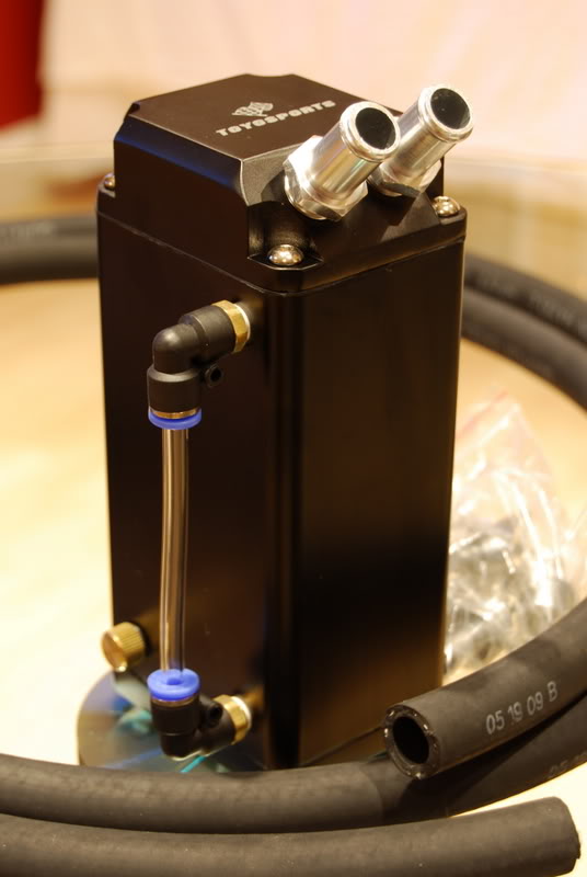

We have now decided to run a catch tank to remove the chance of oil (and vapour) entering the inlet again. This turned up today (not bad for £25 delivered):

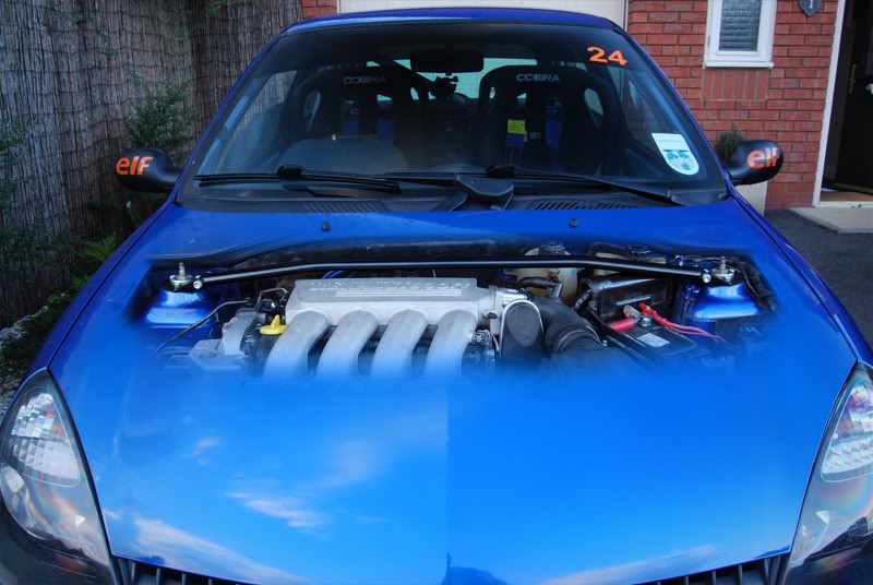

Here is a picture that I forgot to upload previously of the strut brace in place:
Our plan now is to just run it and see what happens. We hope that it was a freak event and not bigger problems lurking within - only time, and another track day, will tell.

Following on from our previous oil breather woes at Donnington Park I fitted the oil catch tank, locating it in front of the battery.

Good progress mate...just so you know the Brembo discs you have there part number 09.8137.24 is just the normal Brembo HC disc part number.
