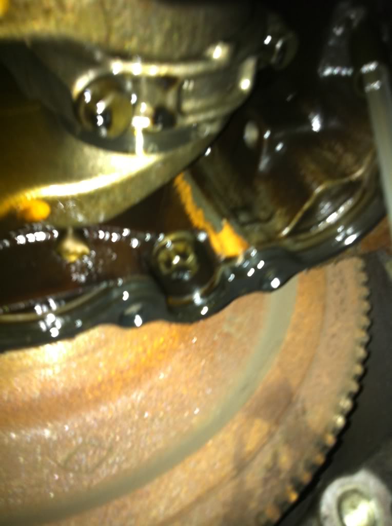

Filling it wouldnt be much of a problem though Jonny so it'd stop any leaks I think i'll probably build it all back up and fill that little bit with some sealant to make it level.
The car made good power and never been much of an issue so I'd have been non the wiser had I not changed the cams
The whole rocker seal was leaking because there were very few non oil stained parts around the block.
  Evo 5 RS
I reckon that's gonna cause a leak again, eventually..but I doubt it'll cause too much of a problem where it is? I'd get it machined personally though mate, if you can whilst it's apart :/

It looks a bit deep for skimming no? Sealant should work i'd imagine. god knows how that's happened though :S

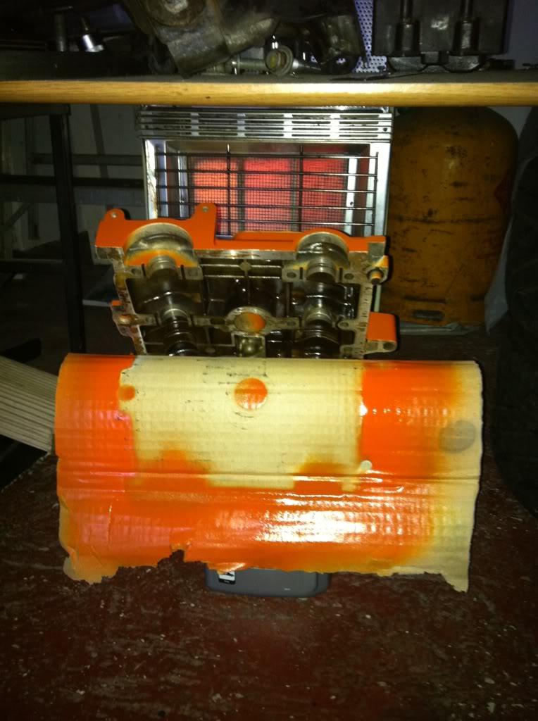

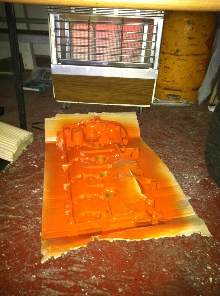

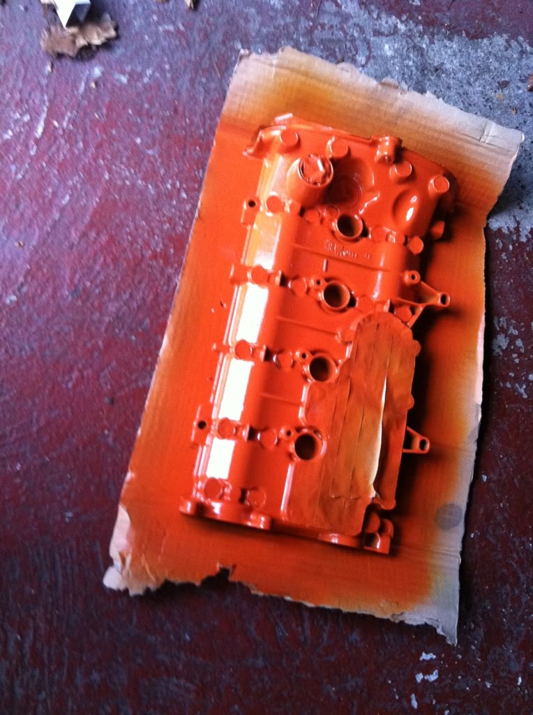

While that was going on the rocker was re-painted to make it look nice again and the oil leak from before had started to crack the last finish so prepped, painted and into my makeshift oven to bake. I probably could have stuck it in the real oven but the other half would have kicked my ass if she found out

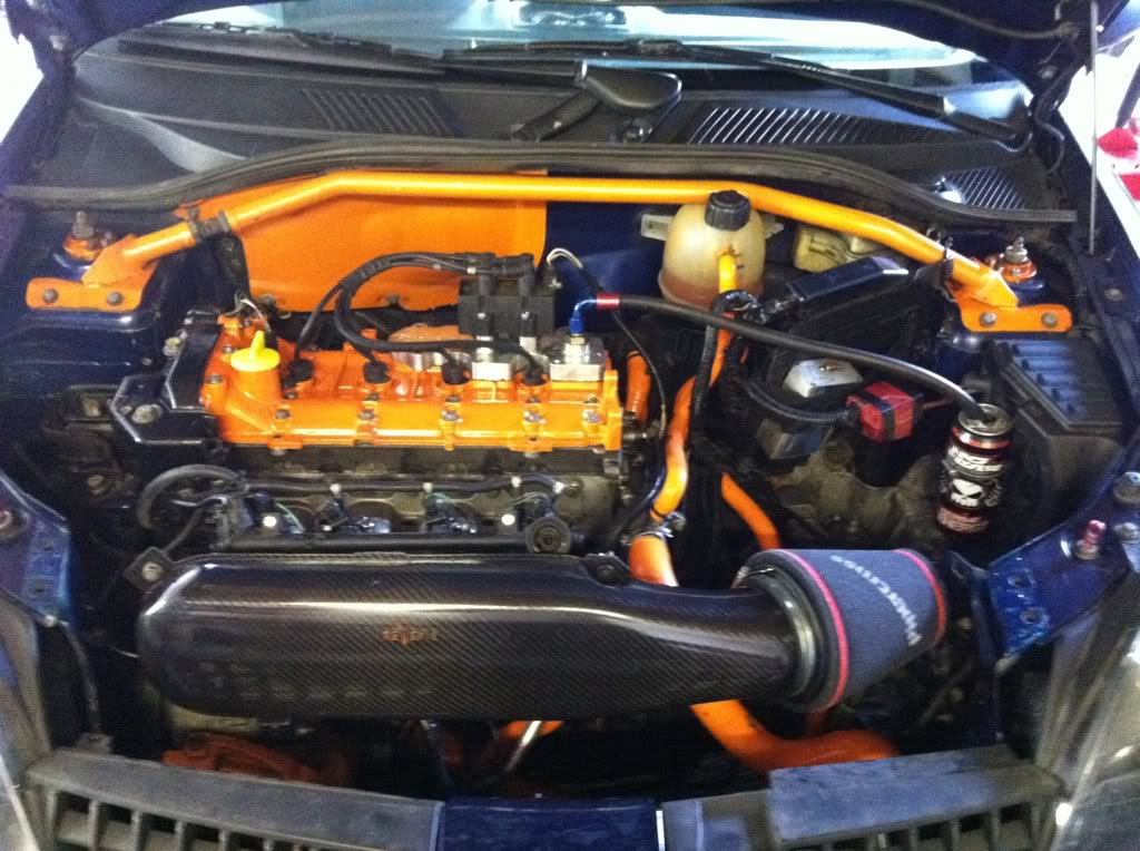

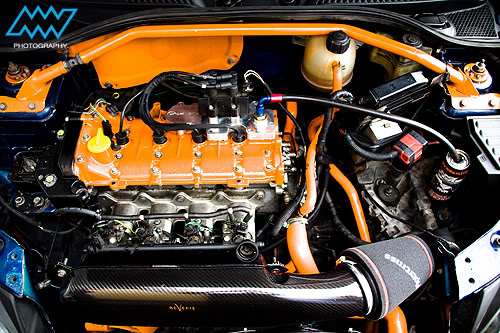

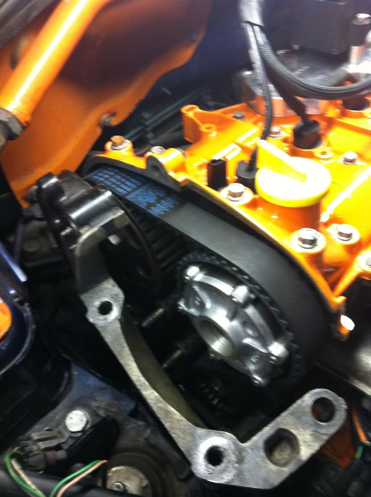

Back together it goes with the new cams, new dephaser pulley, belts, tensioner and pulleys. Replaced the dephaser solenoid I managed to break trying to remove the last one and a fresh set of plugs before it goes to get the cams mapped.

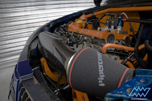

Got hold of a pipercross filter, 100mm diameter x 150mm x 200mm from tweeks rated to 340bhp so should flow enough air I hope. Great service from them and thanks for John for sorting out next day delivery and a great price. Engine bay needs a clean and the car is due for a proper cleaning session over the next couple of days for a show on Monday. Hopefully someone there will take some nice shots.
While the bodies were off I painted the backplate from white to black to match and not look as grubby, and replaced the coil springs on the butterflies with ones that were slightly stiffer. Pedal felt a tad soft before and now its excellent and the revs come back to idle very quick now. I think the previous ones weren't closing them properly and causing a bit of a higher idle sometimes
It'll be getting mapped on Tuesday so I'll let everyone know what the figures come out like. :)
There'll be some cold air feeds coming from the fogs to the vicinity of the new filter when I get the next chance to find some decent tubing.

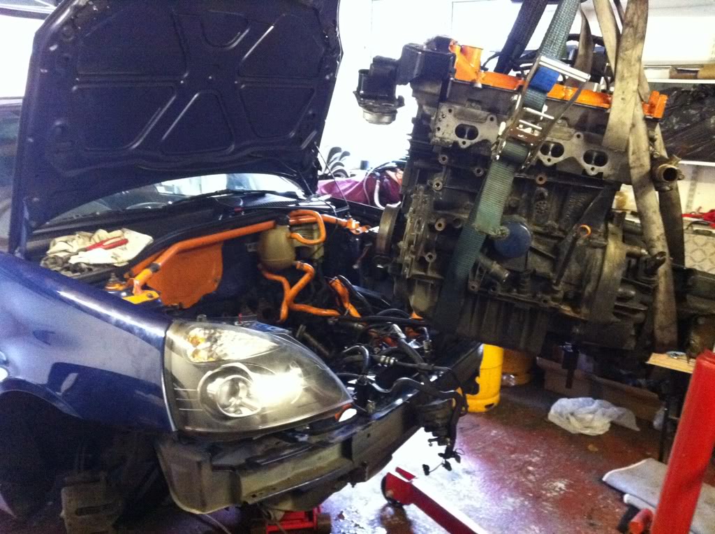

Ok so got my hands on a crane and set to work earlier on
Its getting easier each time but I really need to do something with all of this. Maybe Chrispy would come visit ;)

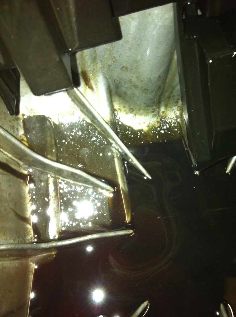

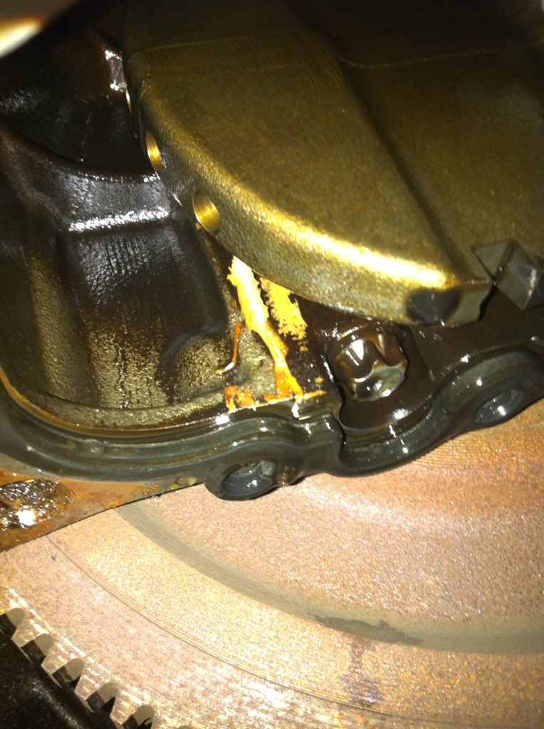

Cracked off the sump to be greeted with this :(

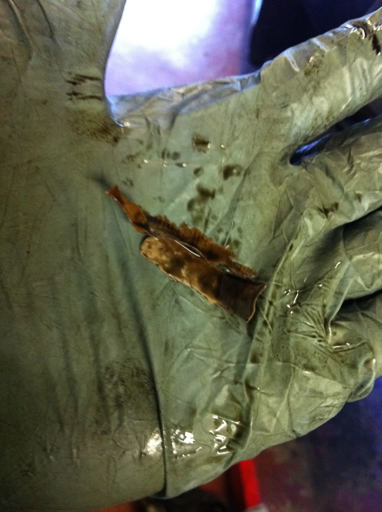

Lots of nice swarf, so theres definitely things needing replaced. Poked about a bit further and this little fucker was stuck in the outer edges of the gauze. There was still plenty of room for oil to be sucked through so I can't see this as being the issue that caused but still.
It had a consistency like an elastic band and I thought to myself how in the hell did I do that. Stripped off the pump and guard and couldnt see much but just by accident I noticed this on the side of the block, no idea what it is or what its for
but on the other side theres a bit missing that matches the exact piece I pulled out of the pump
Whatever it is it definitely could have caused serious damage, it was pretty loose and could have dropped into the oil at any stage.
So plan is to replace the bottom end for a quick fix and rebuild this block at my leisure, maybe something high compression for when the car goes completely track/race only

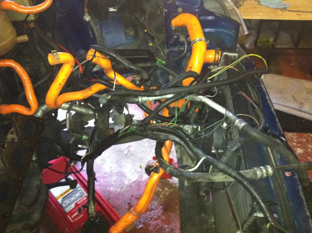

I would say bin all the engine bay rubbish and start again!
Such a shame the big end has gone. Strange piece of silicon or something!
Now the engine is out you can degrease the engine bay and make it look nice and tidy :)

Weird that the sealant would have been used from the factory, this one has never been cracked open but ah well.
