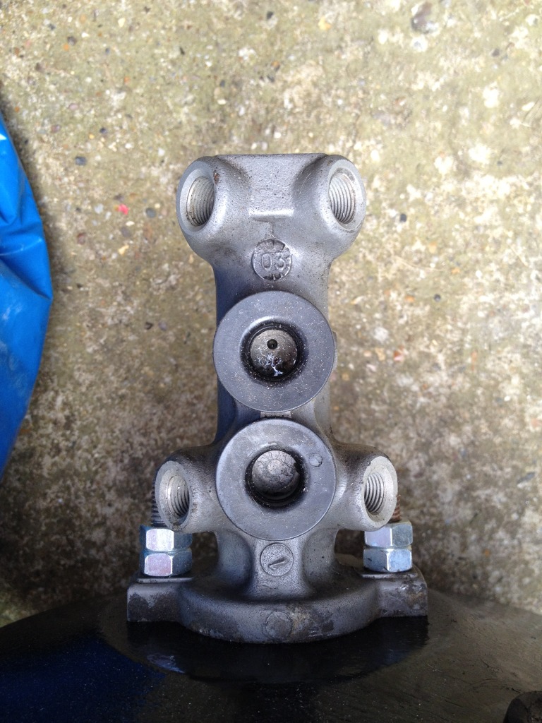

Hi all need some help please
The CUP Master Cylinder what port goes to which brake. Help would be greatly appreciated!
Thanks in advance.

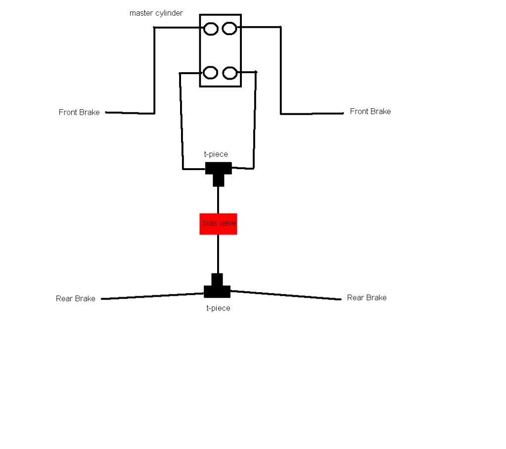

Running the two forward ports to the fronts, blanked one rear port & running the other rear port through a bias valve, onto a T piece then back through the floor pan to the rear mount bracket on mine.
Scrapped the cup bias adjuster-was badly corroded & seemed useless compared to an adjustable bias valve.
p@blo
  Clio/A3
Is your bias valve a 2 in 2 out squeak? If not, could you not just blank a port & get rid of the first T piece? :)
  DCI100 / 211hp MK1
I think mine is a 1 in 1 out.
I was thinking about doing that but i would want to use both so that the fluid pressure is even if that makes sense, plus i already have the correct amount of unions and t-pieces already
  DCI100 / 211hp MK1

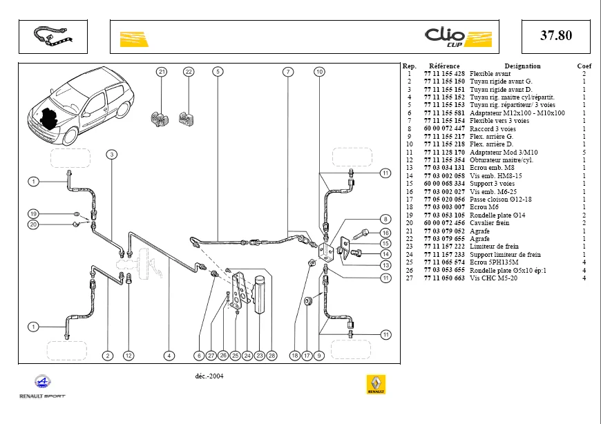

Hmmm if that is how the cups run them i might do it that way!
Thanks a lot mate.
  DCI100 / 211hp MK1
Anyone know where you can get an m10 blocker for one of the port as i take it a bolt wont do as it wont have the necessary angle to seat against the port properly
