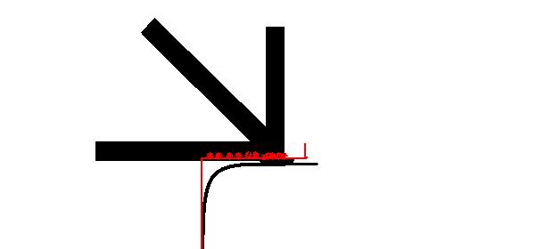

The backstay feet of my cage have been welded to the body without any additional reinforcement and i am not sure how to get around it? Its going to be difficult to cut out, i am wondering if i can weld a spreader plate over the top of the foot plate, and then weld the backstay tubes to the spreader a few mm further up?

Shocking picture but! that is a rough drawing of the rear arch with the cage welded to it - what i wondered if i could do would be the additions in red( the red sprays and weld) and obviously fill in the gap betweek the plate and the weld
A lot of people put spreader plates on the bottom. There's absolutely no room with some of the cages to put spreader plates on the top of the arch. My cage actually bent the arch when fitting so I put spreader plates on the underside

Thats an option - just a t**t to weld upside down! what did you use to plate it? 3mm?
I think it was something around 3mm yeah.
