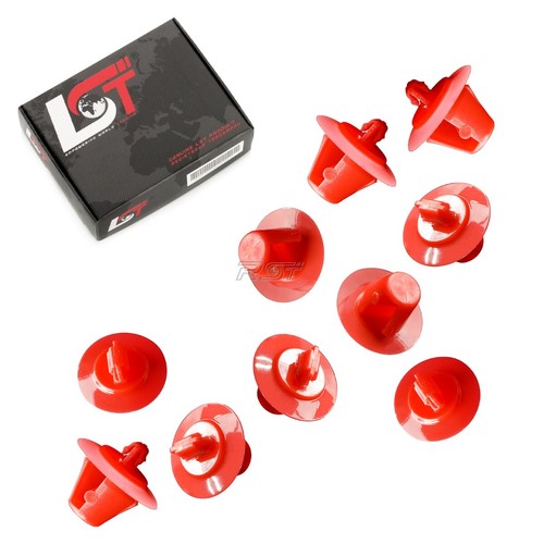

Scratching my head as the wires and washer pipe were not stopping it from sitting flat. Only thing different to the standard spoiler was the red clips are broken on the cup spoiler (still flat surface) and there are 2 foam pads either side.

There should be locating clips for the spoiler it maybe out of line an that's why it's not lining up

I swapped the spoiler on my old cup years and remember that having broken clips, but will see if I can replace the old broken clips.

When I fitted my cup spoiler the one red clip broke but I think they just said alignment, no foam pads on mine either which means the holes in the boot lid are exposed. Hopefully this doesnt mean I will get water ingress

I had clips from the 3 other spoilers I have (dont ask!).... but they did seem bonded/glued into the cup spoiler so couldn't get the broken bits out

Measure the clip at the base of end that fits in spoiler and drill.
