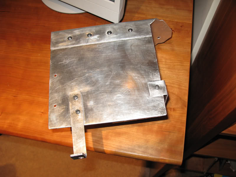

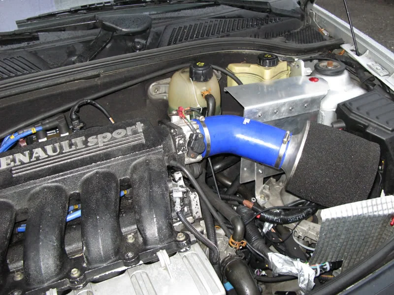

After 2 years of sticking and zip tieing my ECUs, standard and standalone, to various bits of bodywork I thought it was about time I attempted to make a bracket to mount them on.
I bought some sheets of aluminium and gave it a go. NOTE I have never done anything like this before so it may not be that aesthetically pleasing but it feels prttey solid which is the main thing!

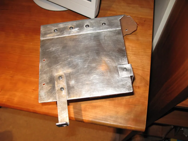

The bracket

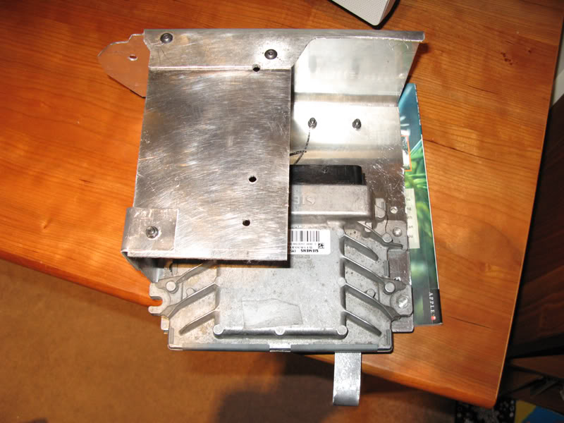

The siemens ECU will bolt to one side

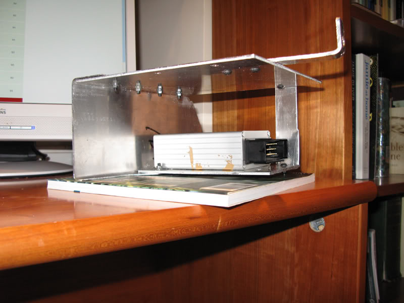

The OMEX to the other. This still needs some thought because the OMEX is a box with no mounting points

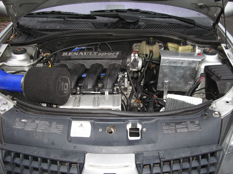

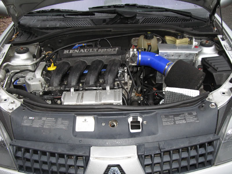

Installed in the car
With the air filter. This is a bit tight and I may have to shorten the 45deg bend on the airfilter pipe to stop it rubbing
Tidy job fella, well done! Gotta find a way of securing ours soon and thats inspired me to get on with it.
Good Idea, As you've said its not massively pleasing on the eye but as long as its functional thats the main thing
Paint it gloss black that would look better imo. good bit of diy though Mark !

Not bad at all mate! Glad it's running all right now. Did OMEX sort it out eventually?
I need of those filters aswell! Did you buy it seperate or was it a part of the package?
I just spent the rest of the afternoon trying to get the fucker to fit with the ECUs and cables connected. I have only just finished it! During the test drive it didnt rattle or fall off so fingers crossed.

The filter is from Merlin motorsport.

Looks good to me! relocating my battery soon, so may need to move the ecu! i will have to have a go!!
As long as it doesn't fall off or cut throught the wires it's sound. Gives an amount of protection for the OMEX aswell.....

The main problem, which they originally said was a misfire, looks like throttle position feedback fault. On a light throttle driveing at a constant speed you can see the AFR dip rich and then flick back to normal. When the ECU gets bad data back from throttle position sensor it defaults to full throttle. This makes sense but what is causing it is another question and you cant see it when you monitor the ECU.
Have you tried a new TPS? Sounds like a sack ache fella, rather you than me! The wiring looks very ghetto going to it aswell, being crimped......
No.
The wiring is ghetto throughout ;).
The new ECU defiantely sorted it out though. I took mine off and put there loan one on and it ran perfectly and did up until christmas when it started to do the AFR swing slightly for a couple of days.
I took the ECU off and reinstalled and it has worked fine for the last couple of weeks. I was thinking maybe the connection between the plug and ECU. When you refit it makes a good connection which works loose over time. I am fucked if I know though at least my car has been on the road whilst still trying to diagnose it otherwise I would have torched it by now.
