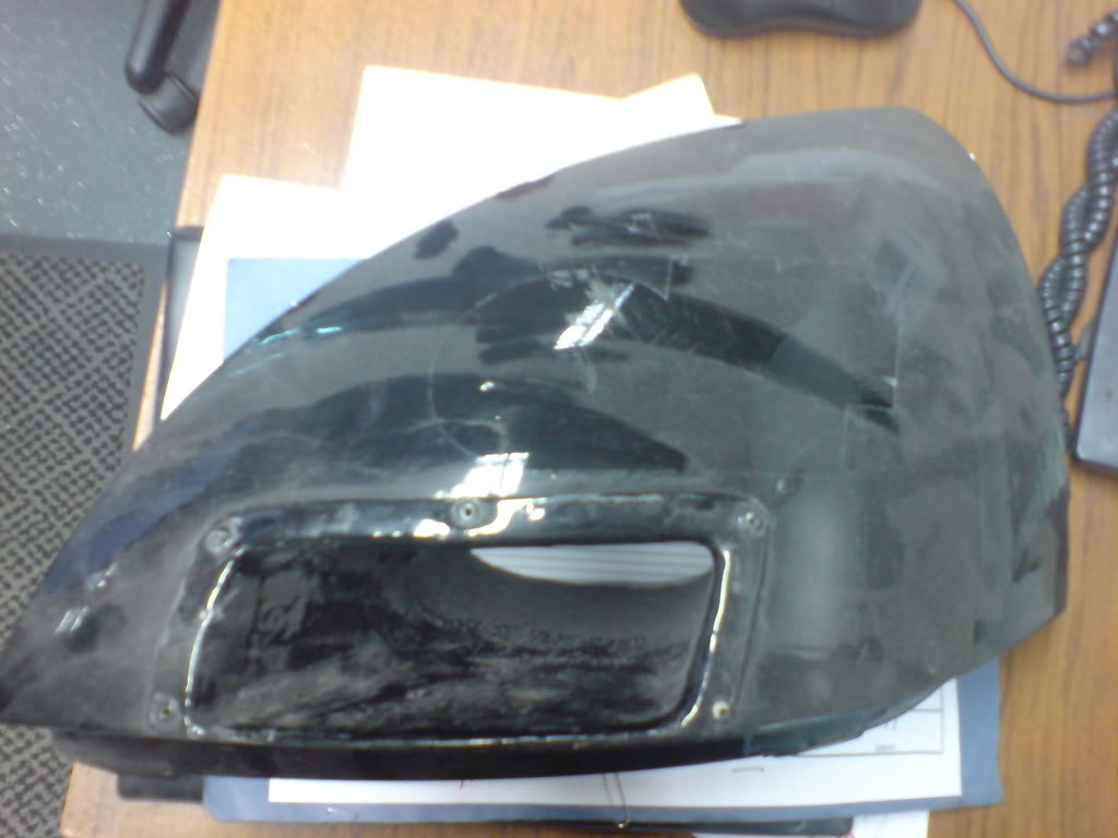

heres one i made for my race car

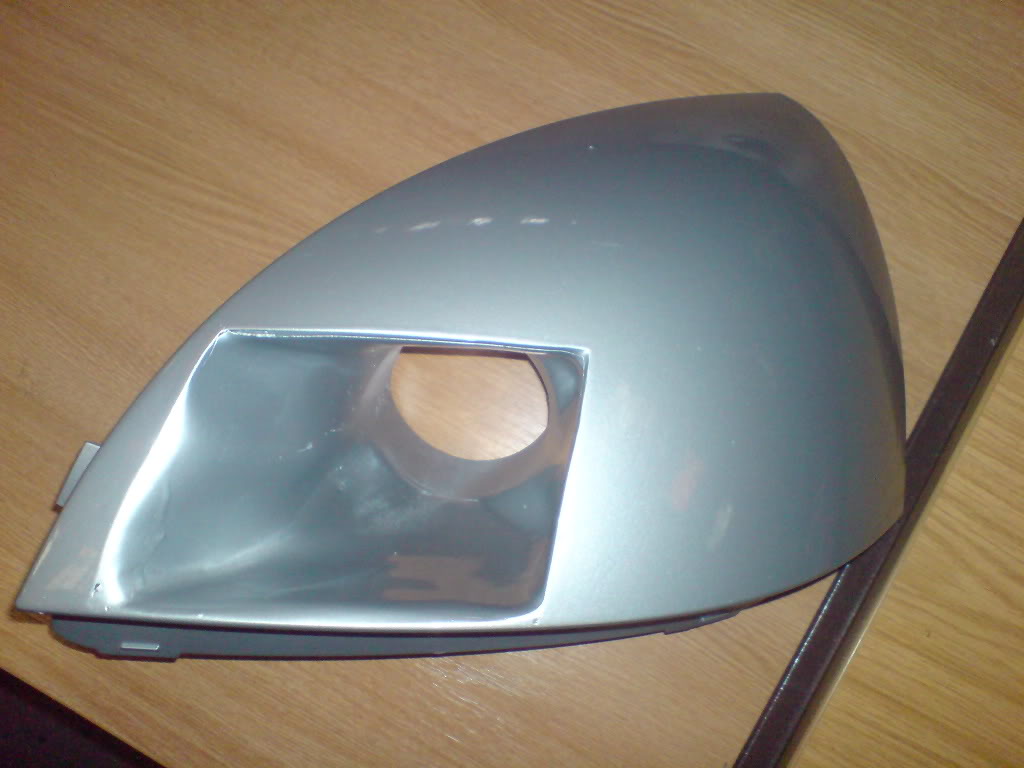

and heres another one that waiting to get sprayed up.

i used a dremel or a hack saw blade the plastic is fine for cutting out.
the top one i used two of the cup racer ducts cut the ends of them and stuck em together to make one big one then alot of fibreglass and filler to make it look half decent. and the bottom one is just a normal cupracer duct like the pic at the top.
i made the big one intially but then thought if i want to run in the ex clio cup champiojship ive gotta have one of the smaller ones so i went and nabbed one from work.
