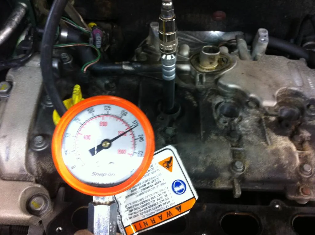

Due to my 172 having a lumpy idle and i need the belts doing and seems its £100 more for a specialist to do it then me, To make sure i didn't waste my money by getting the belts done then needing to take the head off and after seeing a few posts i decided to do a compression test after work
cylinder 1 180psi cylinder 2 175psi cylinder 3 130psi cylinder 4 175 psi :mad:
going to do a leak down test 2moro if i can get hold of the tool which is the most common fault valves or piston.
The chap who did a compression test on my engine he was buying sprayed it with wd40. Is number three a common one, what was the spark plug like??
Ok weird one can't of had the tool screwed in properly. As last night redone the compression test and got 180 psi on cylinder 3. I didn't put oil in the bore or anything just a straight test
