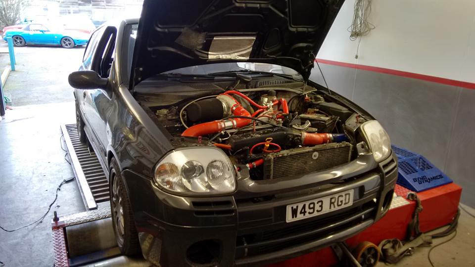

Erm, yeh. It was running 32psi when I took it out last night (forgot to select the boost control port on the ecu DOH!) at which point it was going what ever direction it wanted (using 2 lanes of the dual carriageway) and I was along for the ride. But that was with the tracking out etc so it was going to be playful lol.

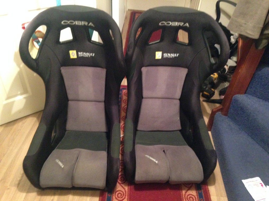

Cobra evolutions with Renaultsport embroided

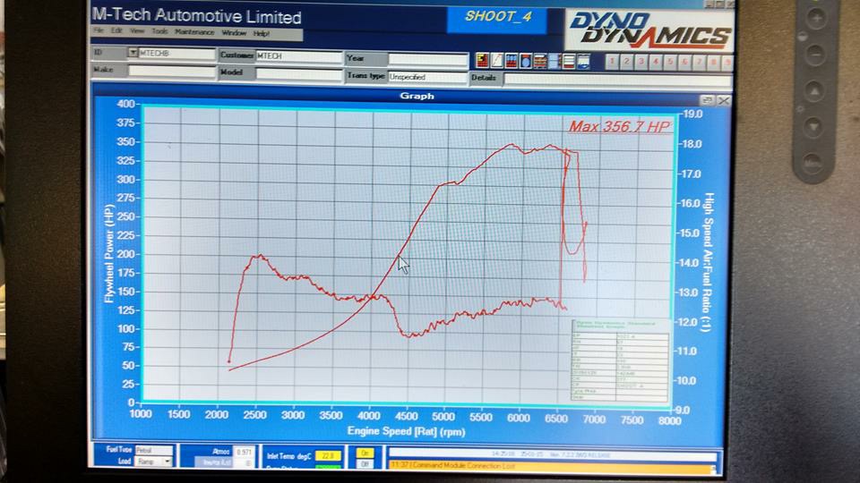

Fancy features mapped in like boost by gear control, closed loop boost control, launch control. Mapped by SJM Automotive.

Why have I not seen this and what actual f**k. Look at that turbo.

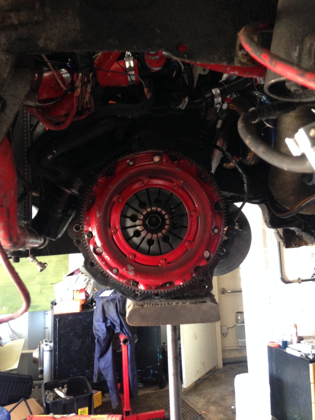

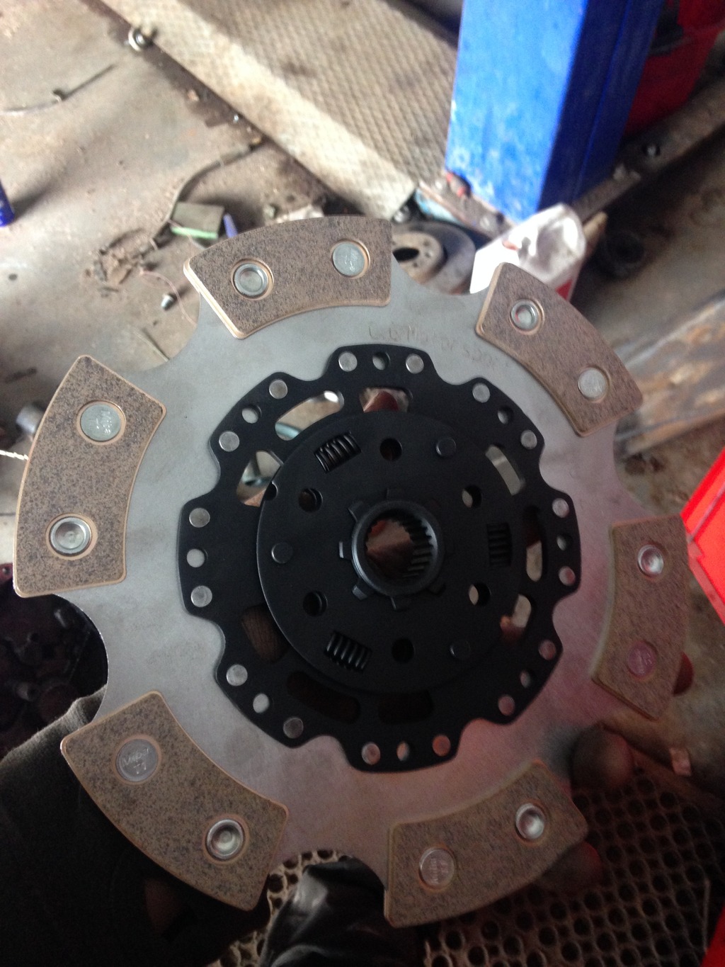

It has highlighted a few issues, that I hadn't found on road use, mainly the clutch line needs rethinking as its getting hot and slipping the clutch, 360bhp is taking its toll on 140k old rings/stem seals so it's starting to smoke a little. And it needs a swirl pot, as under hard Cornering it was starving itself of fuel if under 2/3 of a tank.

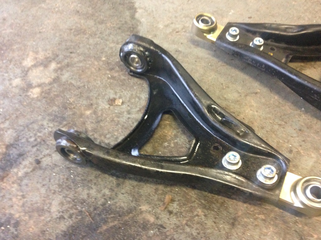

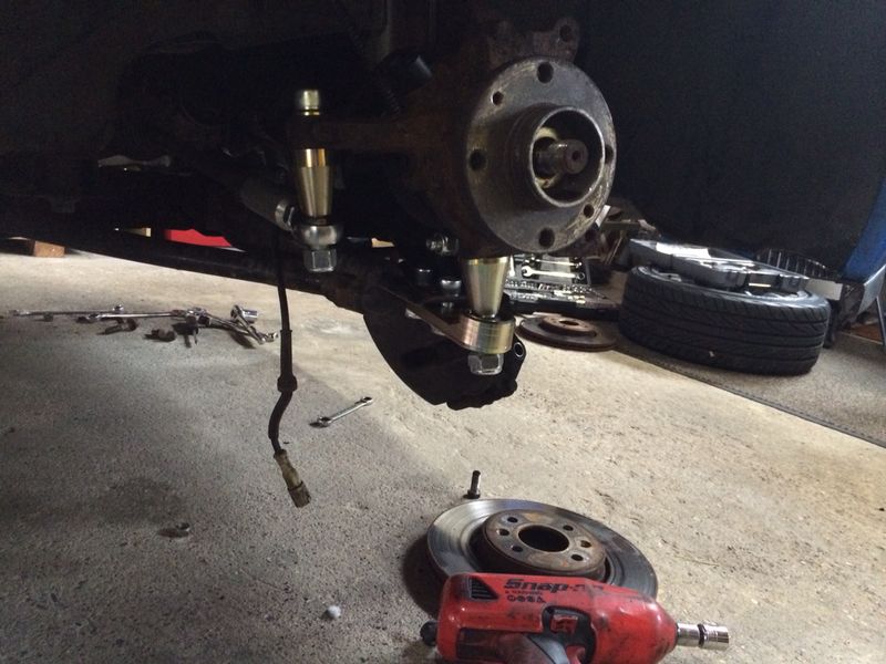

So Roll centre kit fitted (didn't grab a pic so here's a library pic)

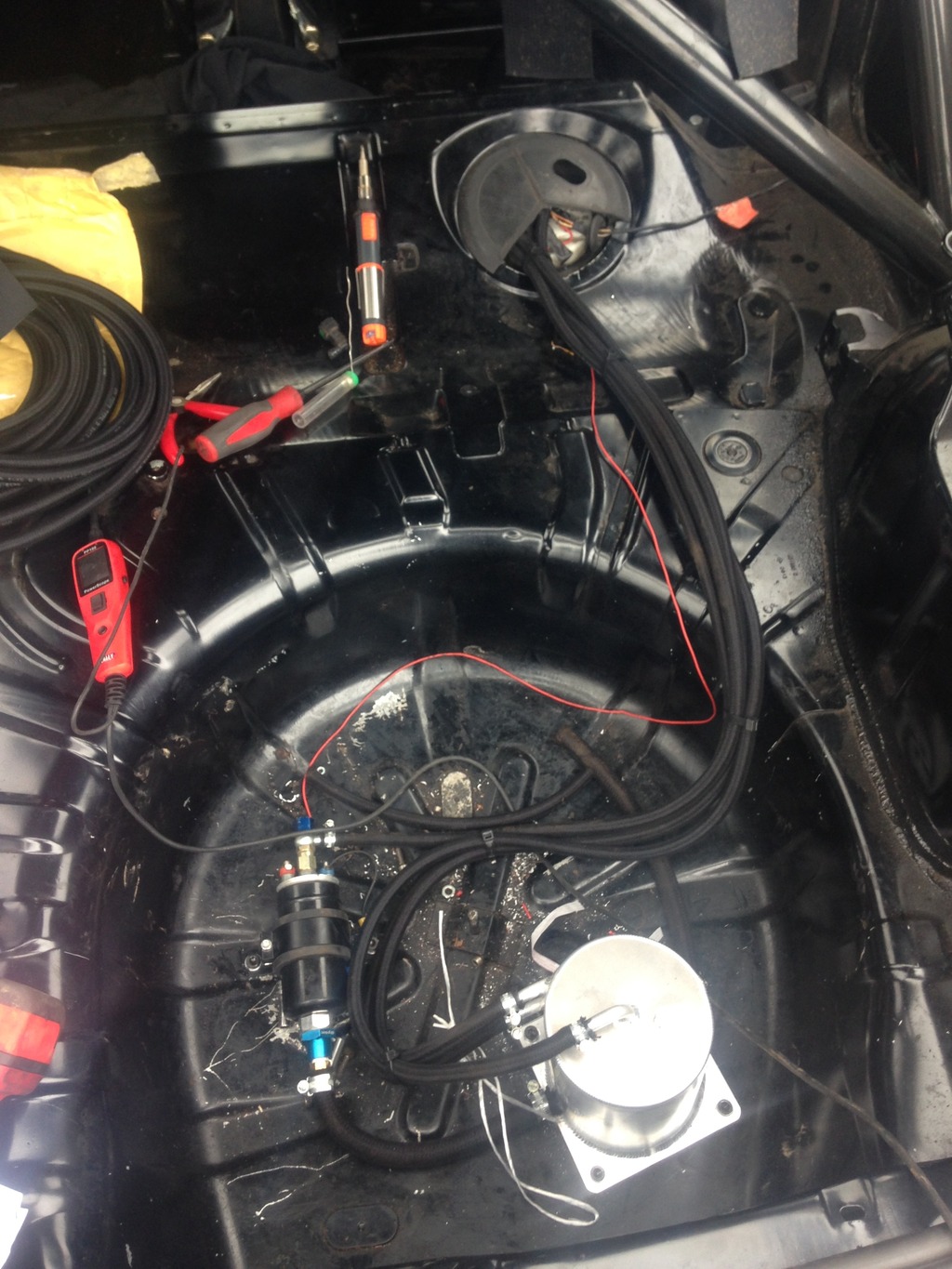

I was also having issues with fuel surge, on long right handers if below half a tank. So dug out my old fuel setup from the shed. And I had a spare hour so chucked it in (the red wire was just a mock up to confirm it all worked!)
