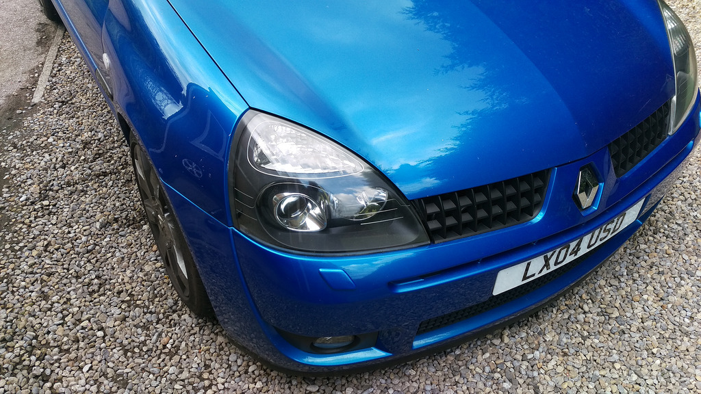

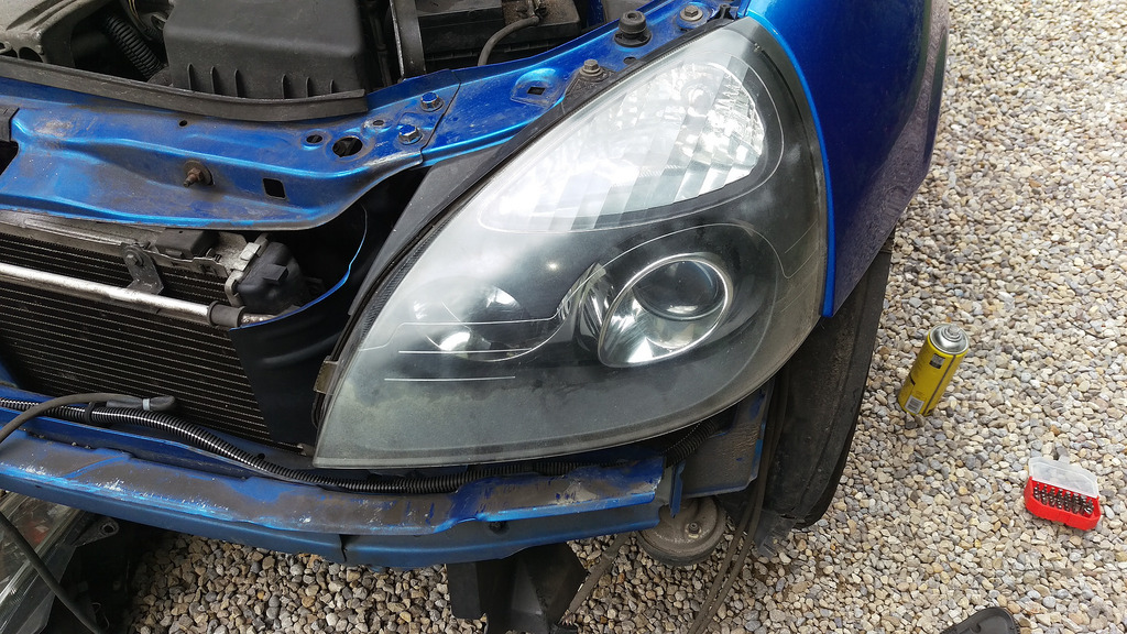

My headlamps have always annoyed me, mainly because one of them won't adjust and the other adjuster has always been broken so one headlight has always pointed down and the other pointing up so i've never really had the true "xenon experience" so I thought i'd look out for some 172 headlights as I love the black inserts @incy-spider knows my feels
This is what they turned up like. SO FADEDDDDDDDDDDDDDD
IMAG0090 by dann2707, on Flickr
So I sanded them back. I'm going to do the thing that EVERYONE does on here, if you look at some other threads where people have restored their headlights they always say something along the lines of "They're not perfect, but they're much better than before" hahah exactly the same this time
Anyway this was before, grey insert doesn't really go too well I think
IMAG0019 by dann2707, on Flickr
After!
IMAG0100 by dann2707, on Flickr

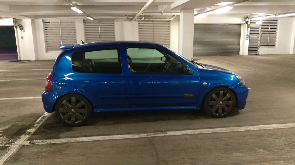

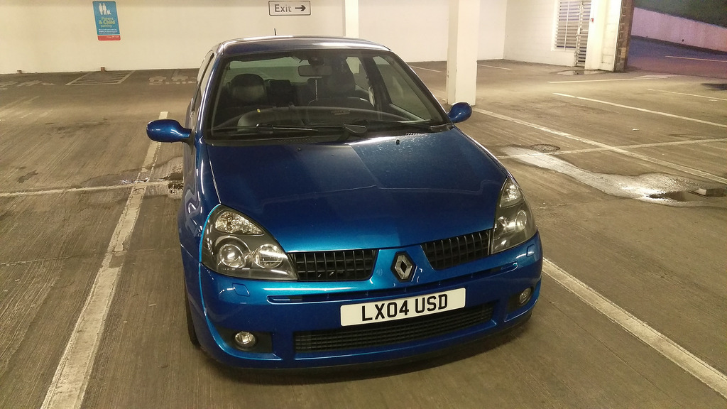

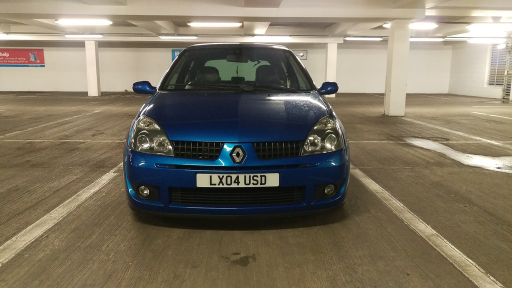

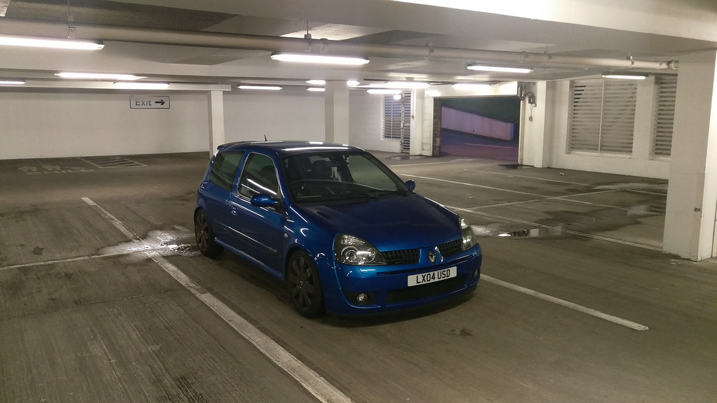

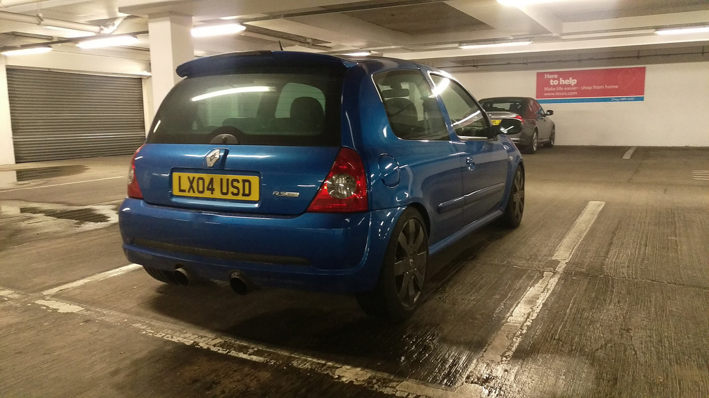

I've just been to tescos just now and thought i'd go in the underground car park for some cliché shots
IMAG0115 by dann2707, on Flickr
IMAG0114 by dann2707, on Flickr
IMAG0112 by dann2707, on Flickr
IMAG0110 by dann2707, on Flickr
IMAG0109 by dann2707, on Flickr
IMAG0105 by dann2707, on Flickr
IMAG0104 by dann2707, on Flickr
IMAG0103 by dann2707, on Flickr

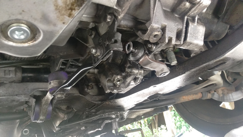

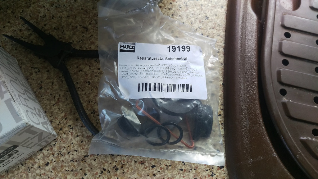

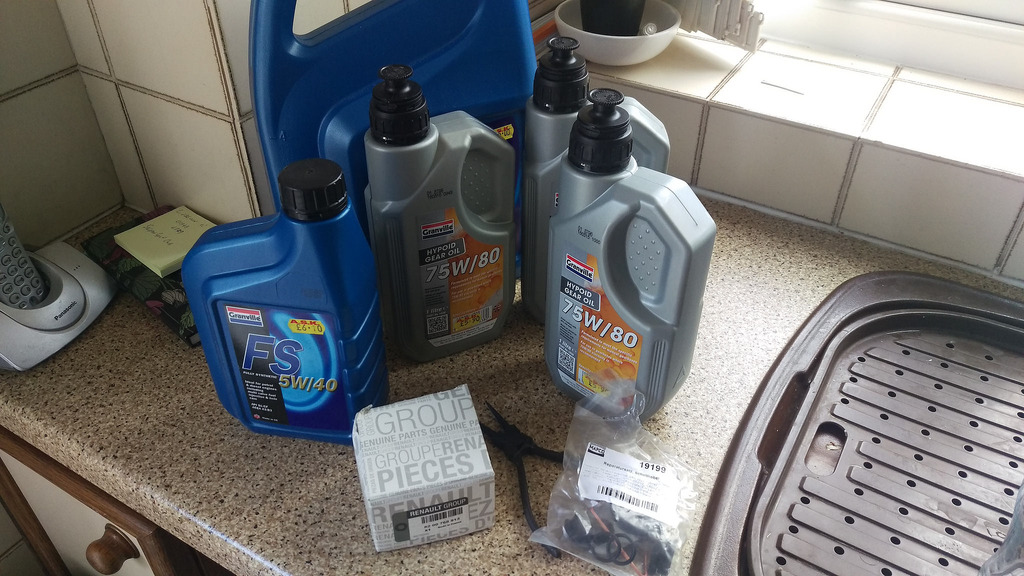

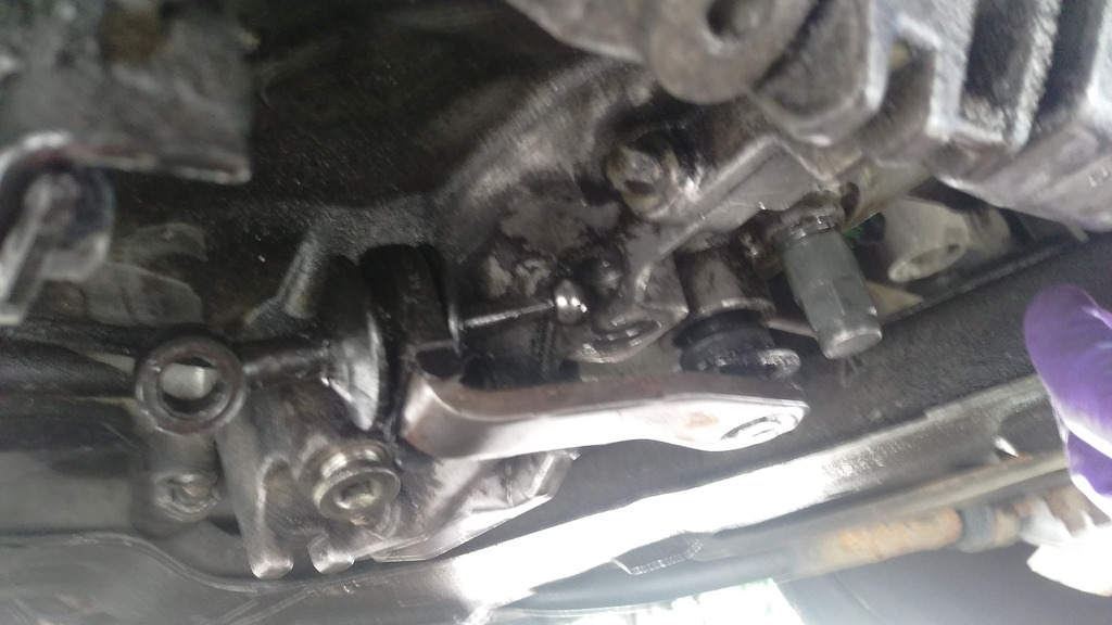

After changing the gearbox oil a few weeks ago, it started to leak. Well it has always leaked throughout my ownership from the gearbox selector seal. So I bought a kit from @mgd which arrived stupidly quickly, cheers again man.
IMAG0134 by dann2707, on Flickr

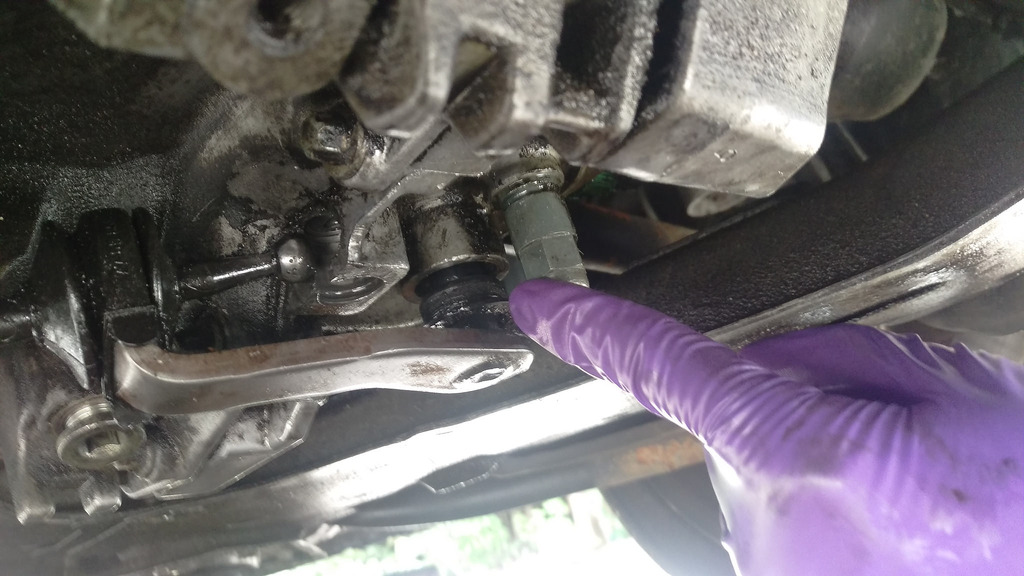

I then started fitting it today, it wasn't a pain really. I expected it to be much worse but after watching the youtube video guide it made things really clear. The main bit I struggled with was fitting the new seal and o-rings. As it's a split design it doesn't evenly go into the gearbox, you really have to make sure you're putting equal pressure on it whilst pushing it on. It's a f**king tight fit when it goes in and I was a little worried I was going to snap it and be left without both seals. All sorted though in the end :D
Just a pic to show the seal you're replacing, you have to cut that fucker off and when I say fucker I genuinely mean an absolute b*****d. It's not just plastic it's metal too
IMAG0138 by dann2707, on Flickr
This is it dropped down ready to be cut
IMAG0139 by dann2707, on Flickr
All on and cleaned
IMAG0137 by dann2707, on Flickr

Ive got a mapco kit to fit, thanks for the info. Any tips for pusing the seal in?

In terms of fitting, just one large open ended spanner ontop of the plastic tool you get in the pack and equally put force into it. It's scary though as you're putting a lot of pressure on it. Good luck though, let me know how you get on.

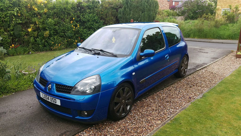

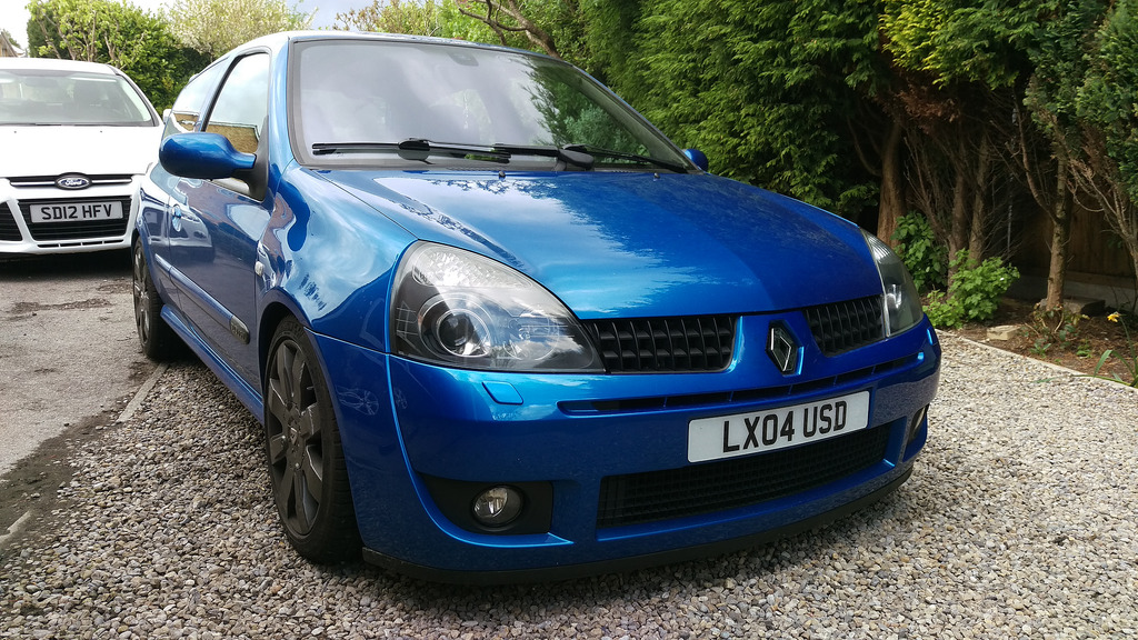

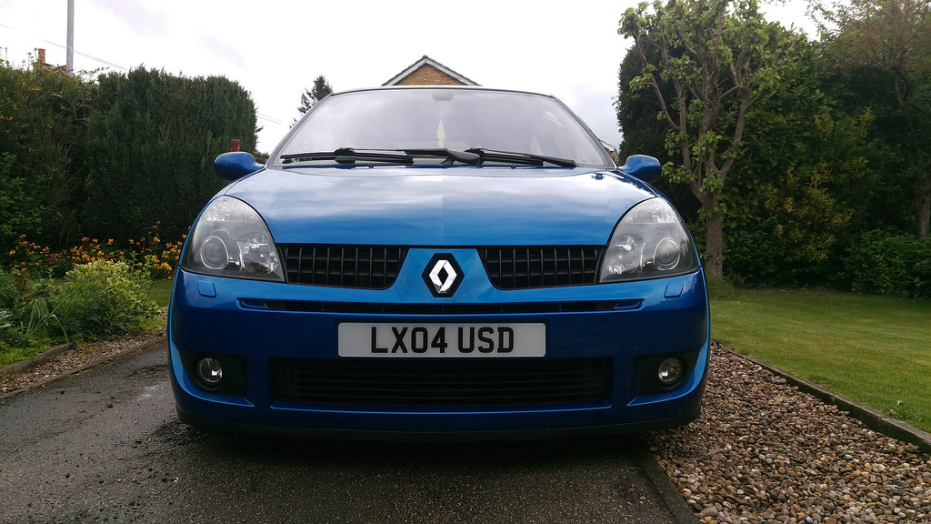

Cleaned the car today so obligatory driveway pics!
IMAG0150 by dann2707, on Flickr
IMAG0153 by dann2707, on Flickr
IMAG0149 by dann2707, on Flickr
WANT 15" WHEELS
IMAG0148 by dann2707, on Flickr
IMAG0142 by dann2707, on Flickr
IMAG0144 by dann2707, on Flickr
IMAG0157 by dann2707, on Flickr
