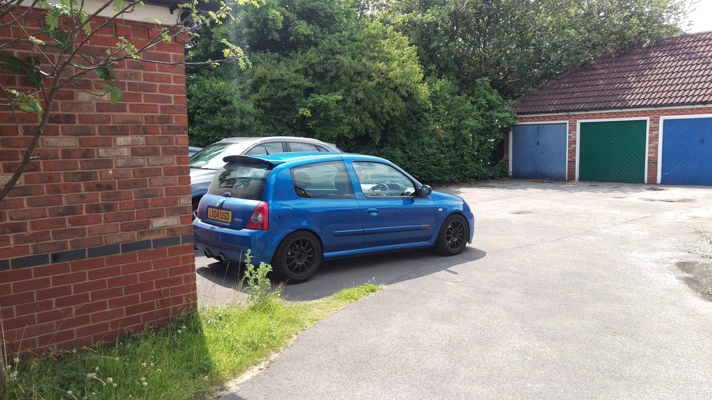

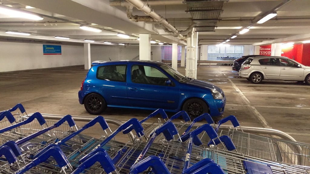

Random car park pic!
IMAG0485 by dann2707, on Flickr
  Clio 182

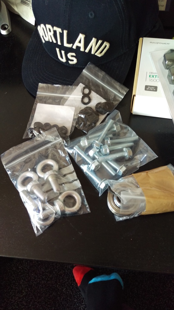

Got my clubsports coming end of next week too @dann2707! what Bolts have you got there? assuming they're all for harnesses and bolting seats down, you've also got a set of the VBD seat mounts haven't you? I'll be checking here when you fit to see what you've done! :p

Got my clubsports coming end of next week too @dann2707! what Bolts have you got there? assuming they're all for harnesses and bolting seats down, you've also got a set of the VBD seat mounts haven't you? I'll be checking here when you fit to see what you've done! :tongueout:
They are these mate, m8 bolts
http://www.ebay.co.uk/itm/371153044...49&var=640307066078&ssPageName=STRK:MEBIDX:IT
Hope that link works, if it doesn't let me know i'll sort it out for you. Massive thanks to @bashracing for sorting me out with those links as I was pestering him a lot for what I need haha but I want to be all sorted for when they arrive :D knowing my luck they won't leave them and i'll have to collect them from a sorting office or some b****cks. I sure do yeah! Can't wait to get them all fitted.

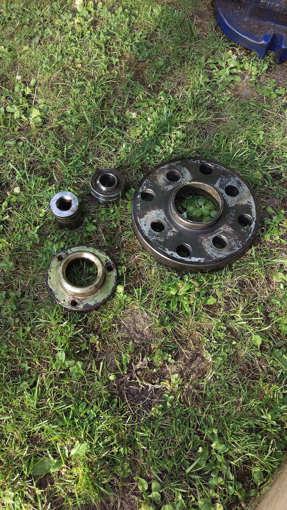

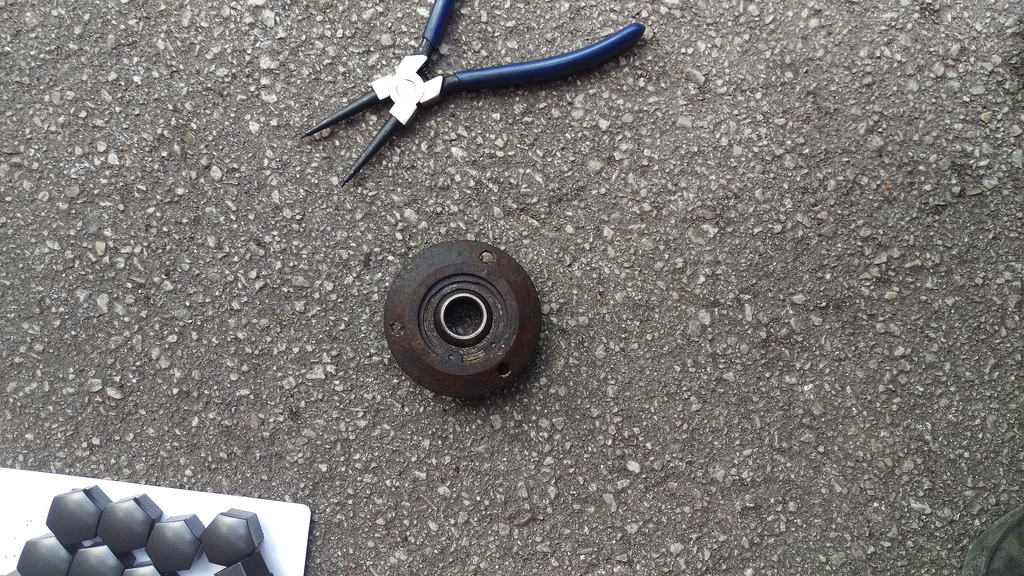

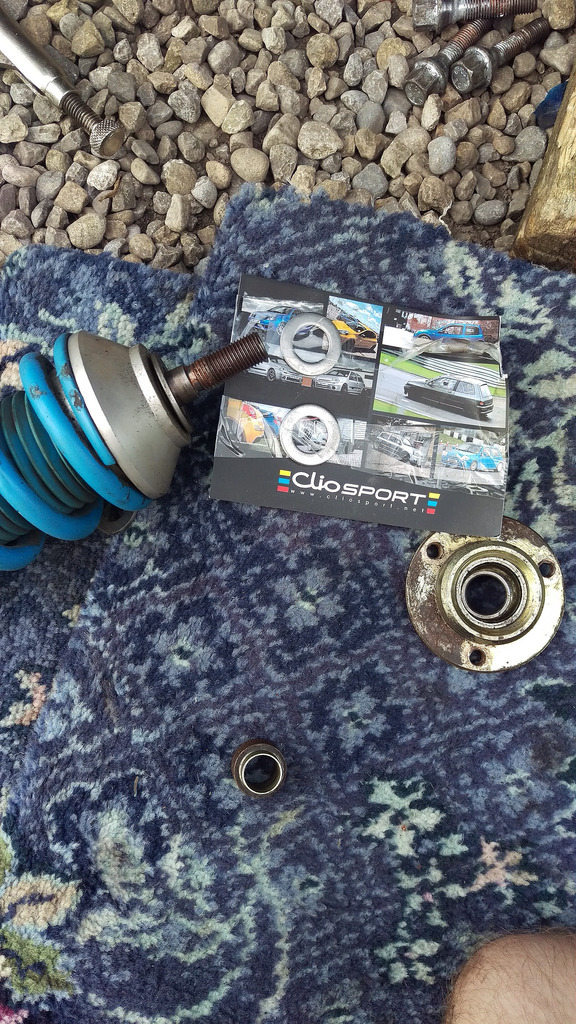

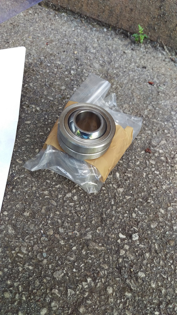

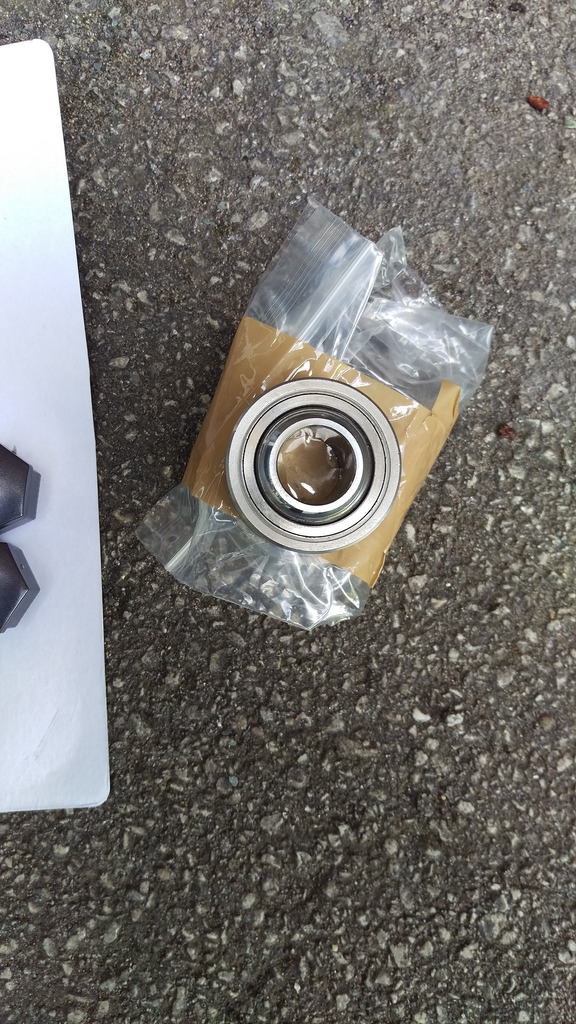

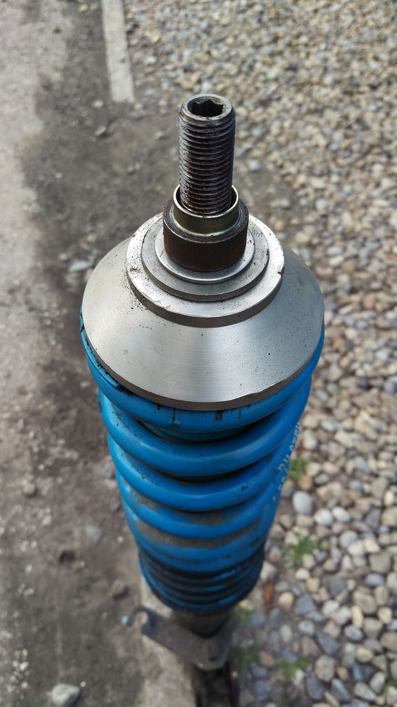

Tonight I changed my top mount bearings to pre-loaded ones. @incy-spider how are you finding these compared to standard? haven't been for a drive yet.
IMAG0510 by dann2707, on Flickr
IMAG0509 by dann2707, on Flickr
They're looking a little worse for wear
IMAG0511 by dann2707, on Flickr
I used my wheel spacer to press the old bearing out (as I didn't have any spare bearing outer races) making damn sure it didn't warp, it didn't and the bearing came out really easily
IMAG0512 by dann2707, on Flickr
Also a massive thank you to @N4TH4N for sending me these washers, I really appreciate it mate :)
IMAG0514 by dann2707, on Flickr
They helped with this bit
IMAG0515 by dann2707, on Flickr
Cheers guys :)

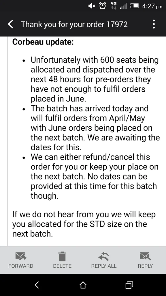

I got an email today saying this... I was absolutely fuming at work. Everyone was asking me what was up like a family member was ill or something.. Nope just car part related sadness
I ordered them on guess what date?
The 1st of June... Hahaha the guy emailed me saying I was 2 orders off receiving mine this month which didn't help my sadness at all. So I tried eBay helplessly and found some in stock elsewhere after ringing some girl up! I couldn't believe my luck she was like yup in stock right here they'll be out tomorrow for delivery Thursday.
However they're the xl version but after jumping in @bashracing last week I think I preferred it! I'm just glad they're actually on their way after being messed around so many times before.
