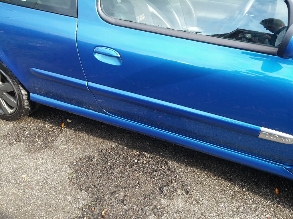

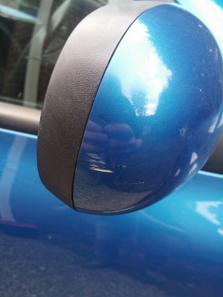

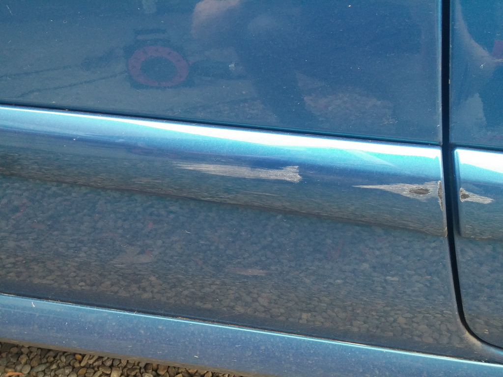

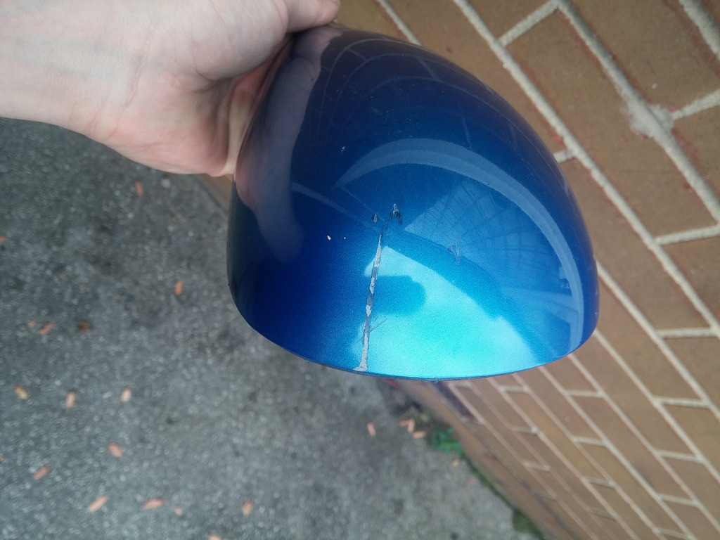

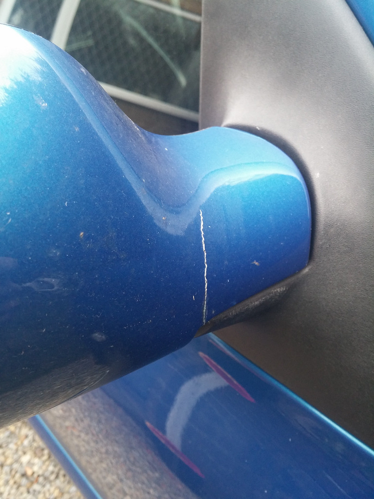

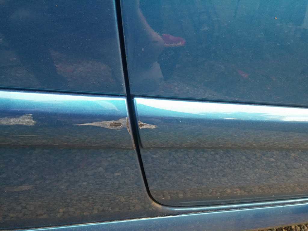

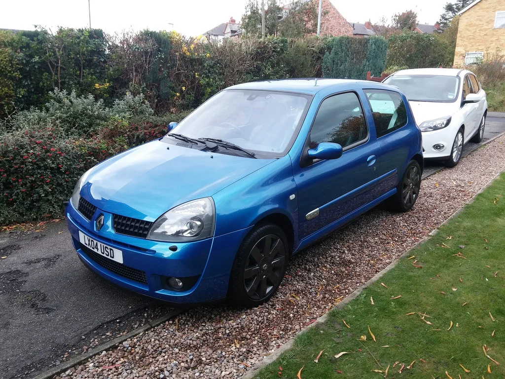

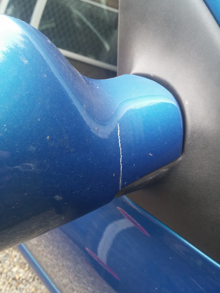

Bit of an update. From the very first day of owning the car I noticed a few imperfections with the paintwork that have constantly niggled at me. These being:
• both wing mirrors have scuffing on the edges from where the previous owner looks to have tried to fit down a spot they can't make. Along with the offside wing mirror having a crack in it and the nearside having specs in the paint
• offside trims have one scuff on them each as shown!

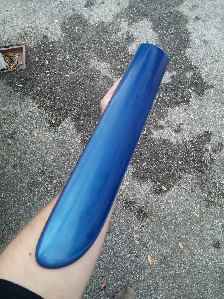

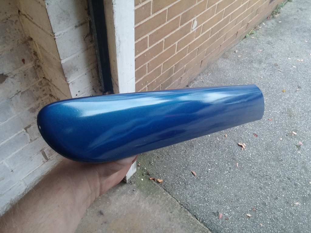

So I ordered some wing mirrors and side trims and started to spray them up over a week.
The final finish on them wasn't too great but I knew that i'd be able to get them looking fairly decent with some 2000 wet and dry, the machine polisher and some megs #205 cutting compound. Just a finishing polish as not much cutting would be required!
This was after spraying
20141026_103757 by dann2707, on Flickr
20141026_103812 by dann2707, on Flickr

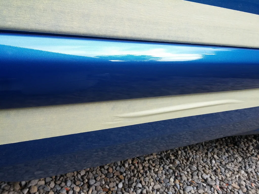

I then started flatting them back with the P2000

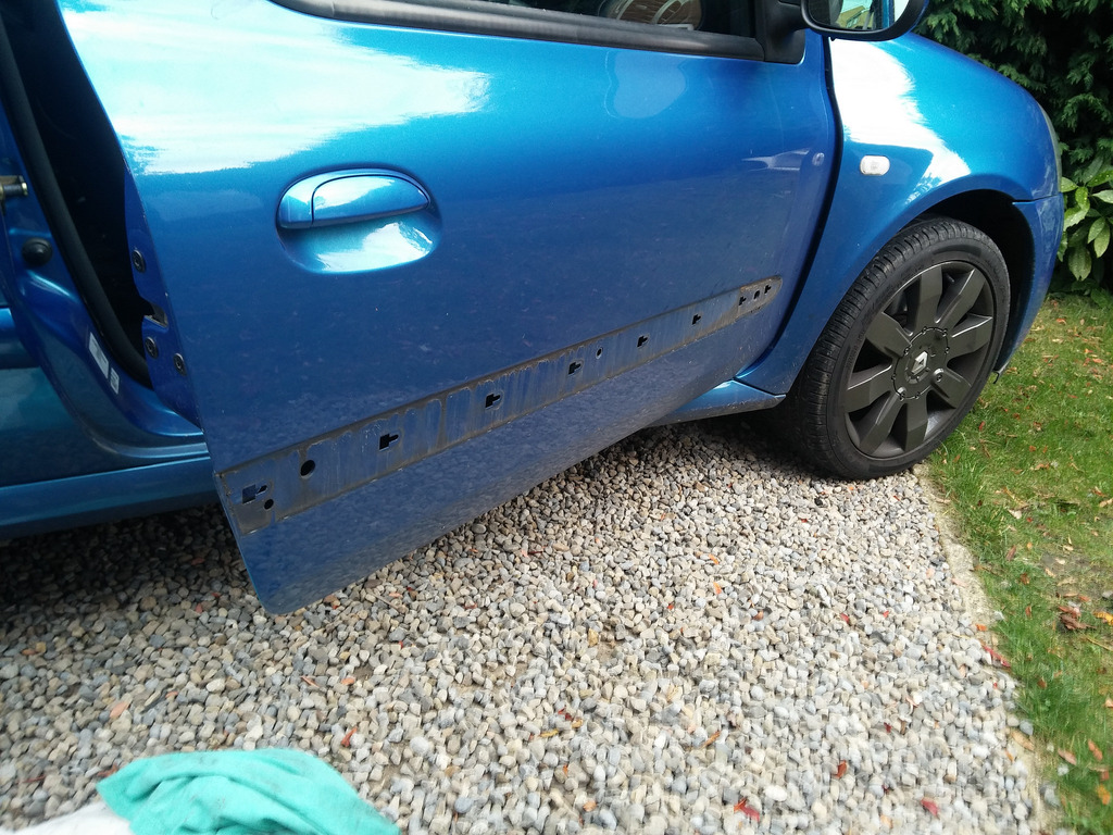

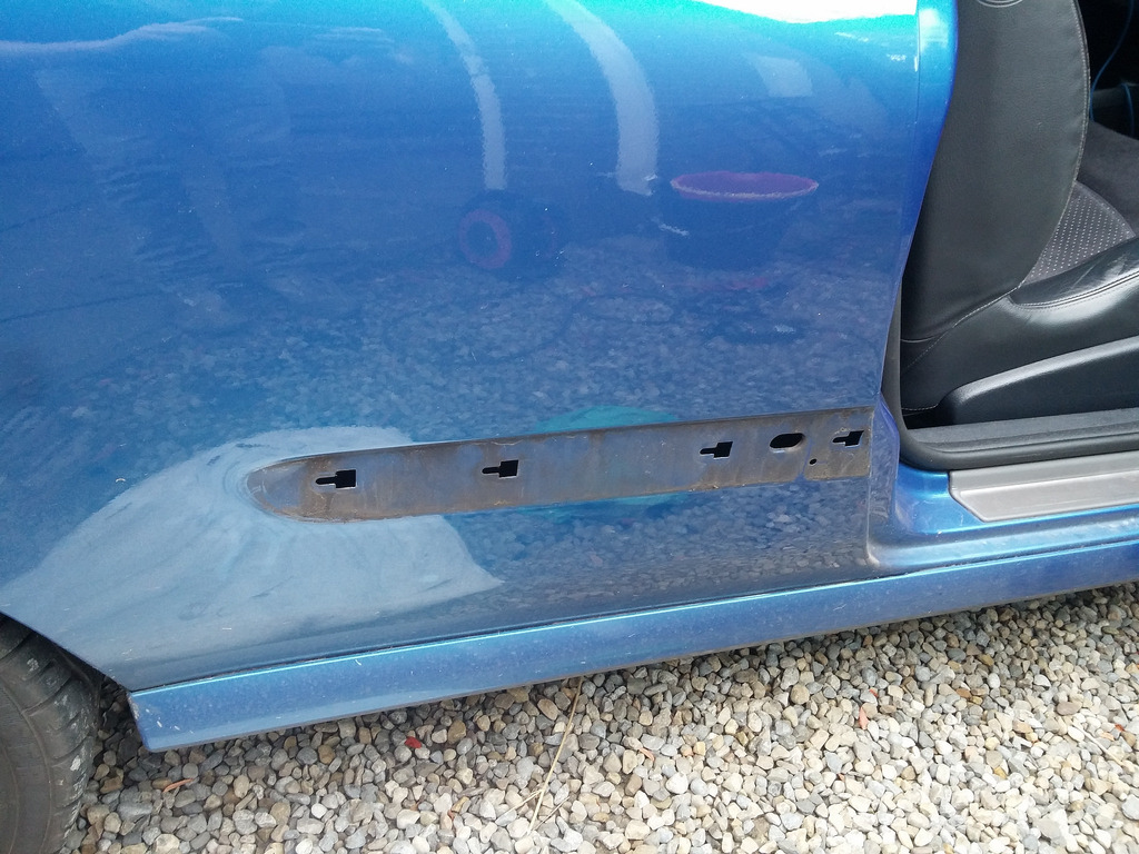

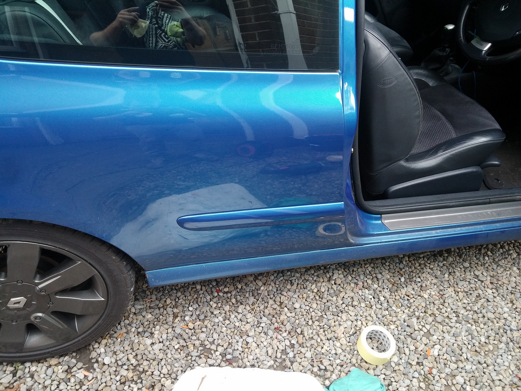

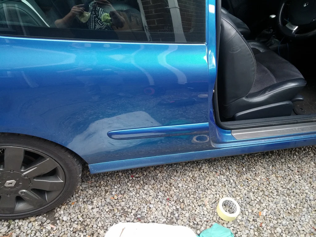

And removed the old trim off and cleaned behind it (after this pic)
20141026_110503 by dann2707, on Flickr

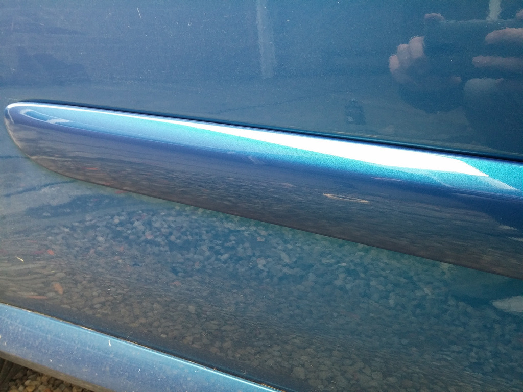

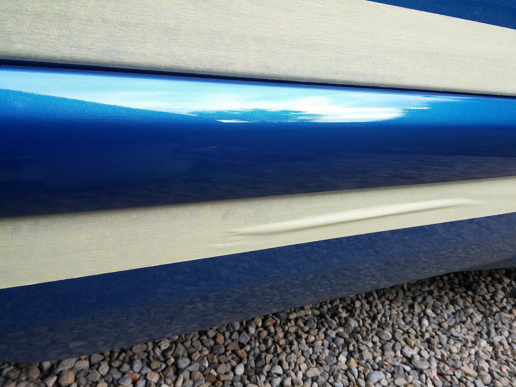

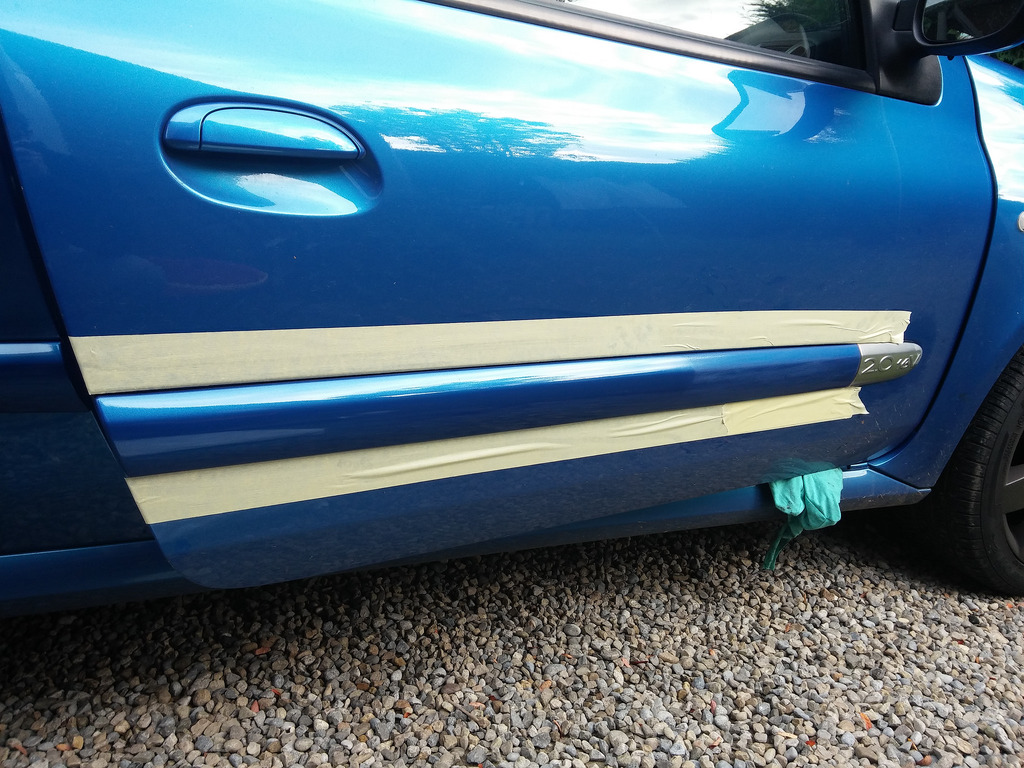

I then put the new trim on and polished it
20141026_111101 by dann2707, on Flickr
Much better
20141026_111130 by dann2707, on Flickr

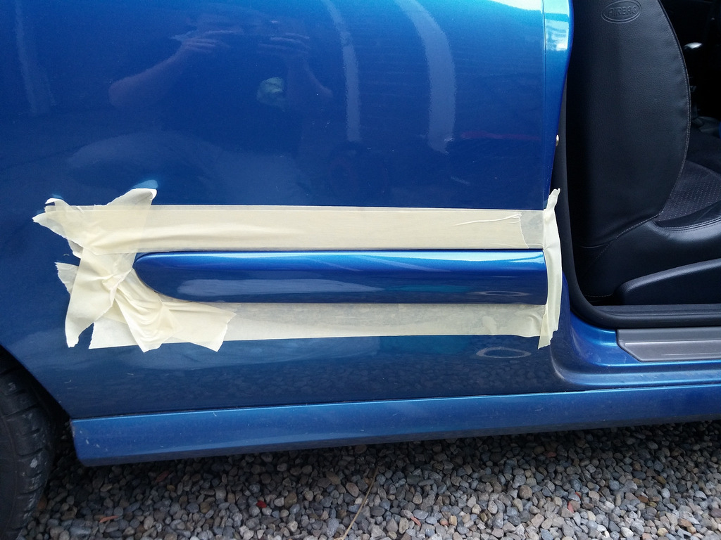

Same for the front
20141026_112057 by dann2707, on Flickr
This shows a 75/25 shot of it being polished and just flatted back. Difference is unreal
20141026_113547 by dann2707, on Flickr

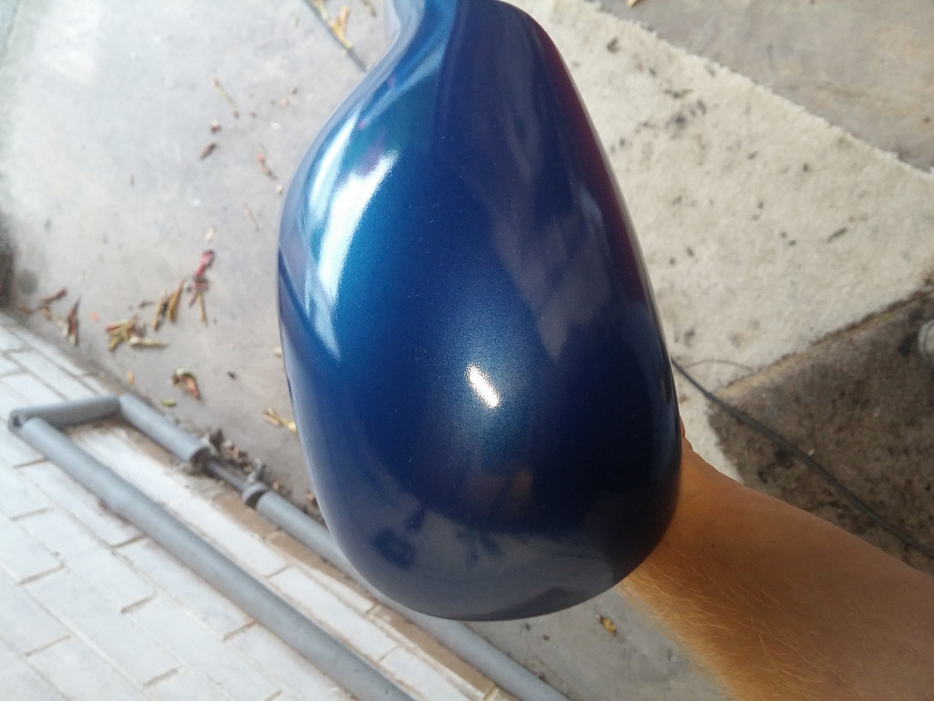

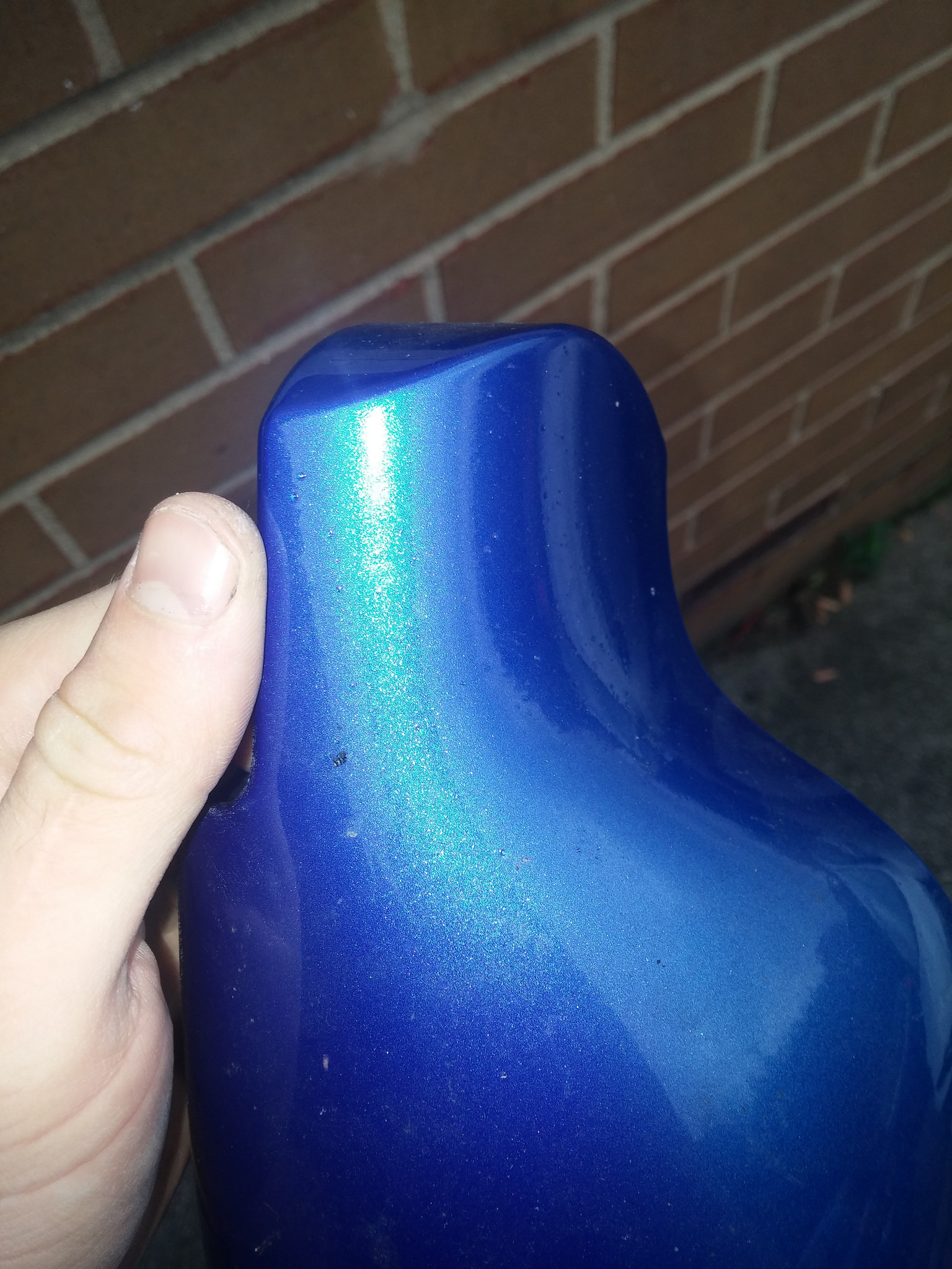

Close up after the polishing, so happy to say it was just done with rattle cans :smiley:
20141026_113600 by dann2707, on Flickr
20141026_113610 by dann2707, on Flickr

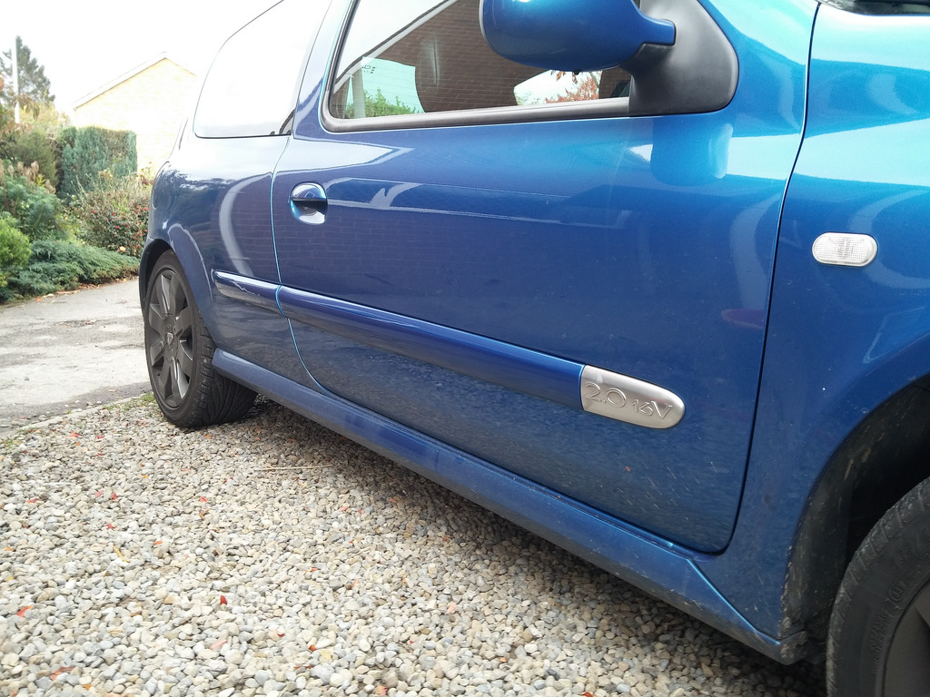

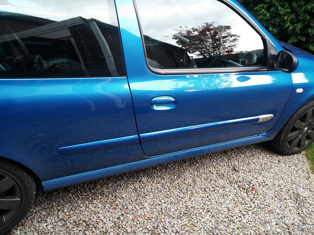

Both trims now on and polished
20141026_114321 by dann2707, on Flickr
20141026_114328 by dann2707, on Flickr

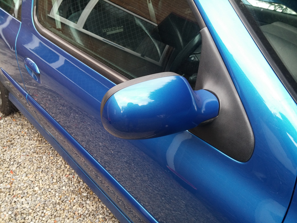

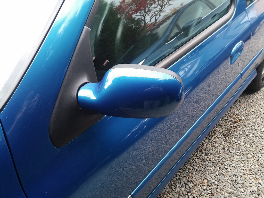

Wing mirror caps also on too. Same process as the side trims
20141026_114338 by dann2707, on Flickr
20141026_114353 by dann2707, on Flickr

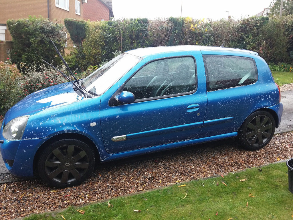

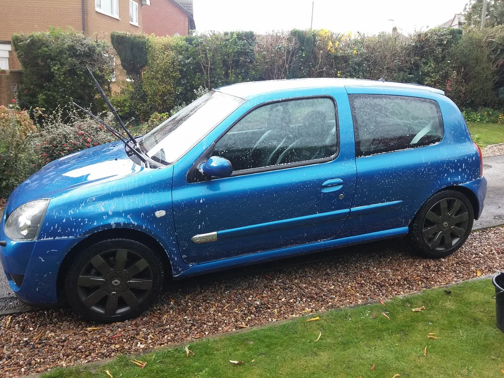

I then gave her a wash :smile:
20141026_121044 by dann2707, on Flickr
No more scratched trim! Gave it two coats of collinite #915

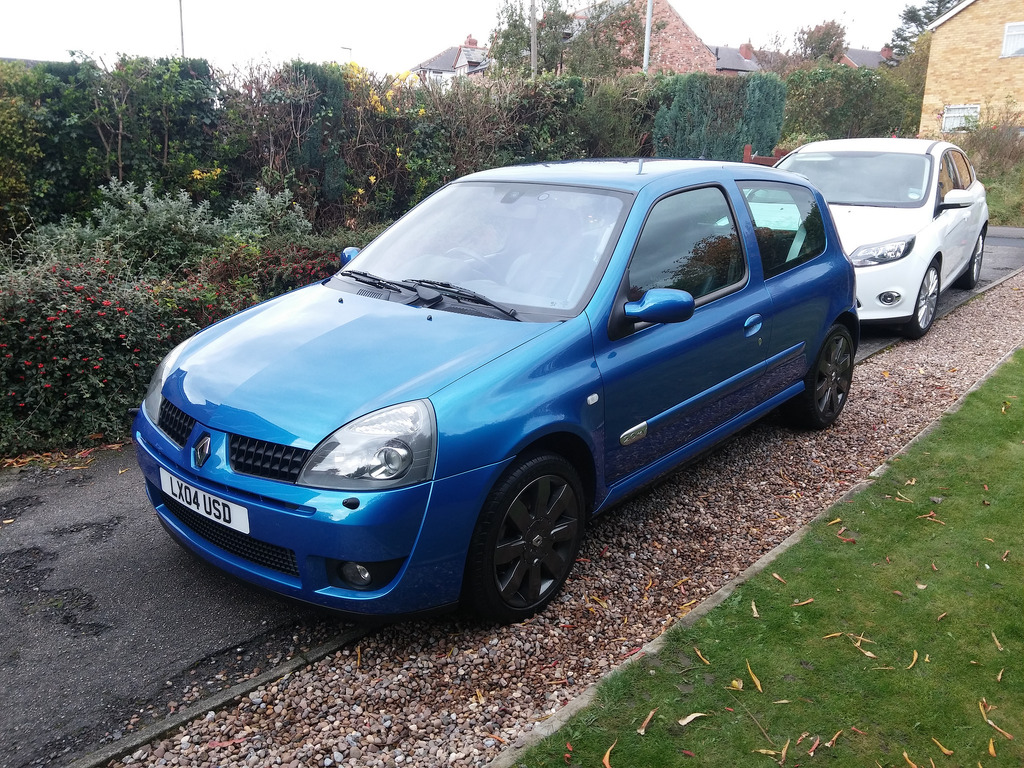

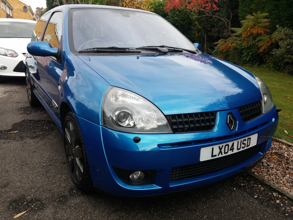

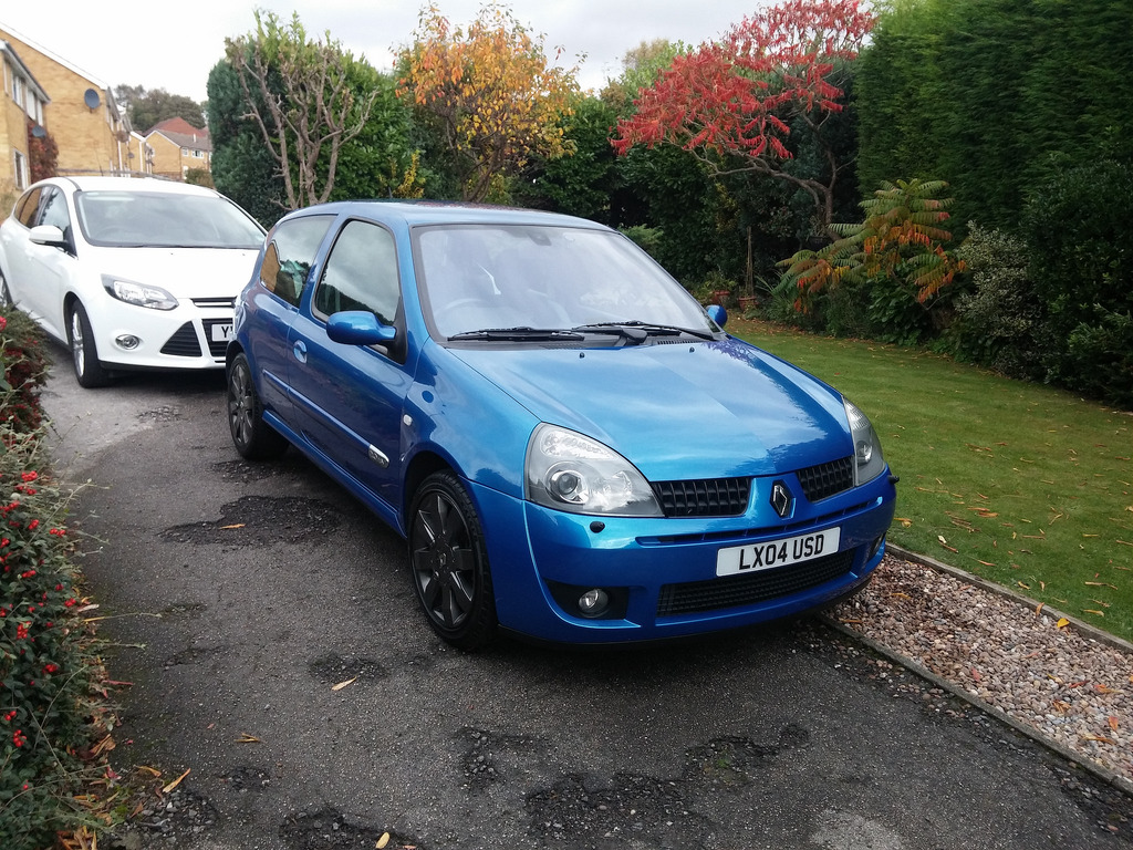

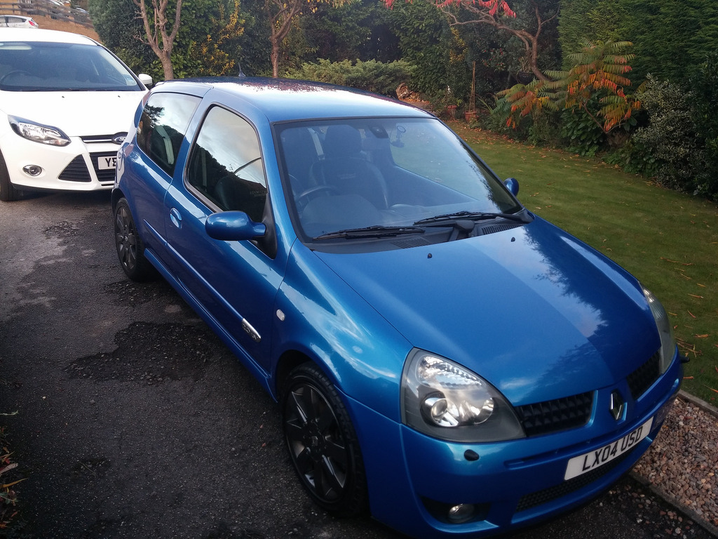

I then dressed the plastics and the tyres and took a few more pics
20141026_133219 by dann2707, on Flickr
20141026_133224 by dann2707, on Flickr
20141026_133233 by dann2707, on Flickr

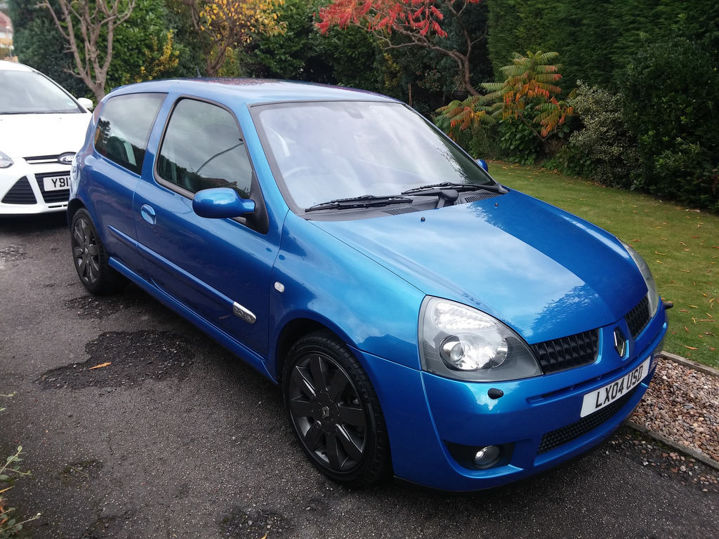

So high at the front ughh
20141026_133240 by dann2707, on Flickr

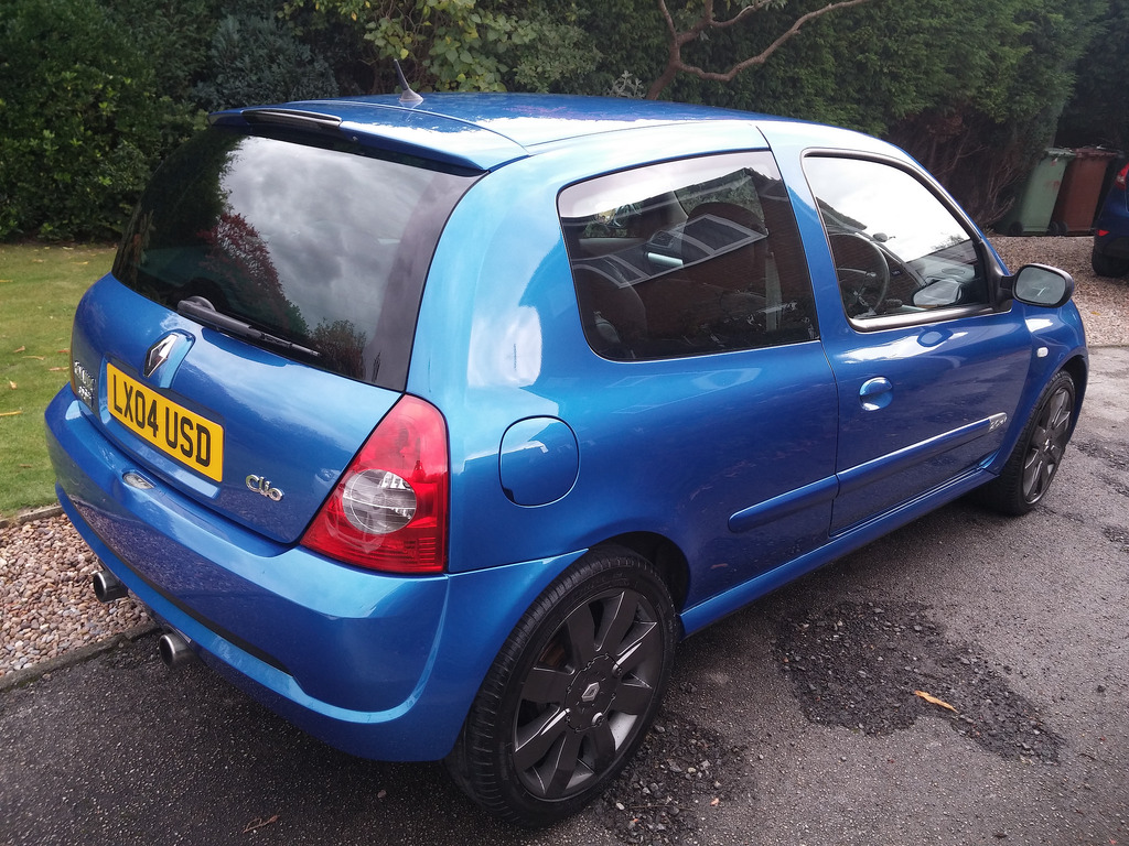

20141026_133305(1) by dann2707, on Flickr
My favourite picture I think
20141026_133328 by dann2707, on Flickr

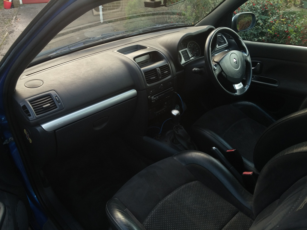

Then gave the interior a clean seeing as though I hadn't done it for a few weeks
20141026_150029 by dann2707, on Flickr
  RB Clio 182
Just all purpose cleaner from Tesco's mate! I do have some leather conditioner but couldn't be bothered to use it :astonished::astonished:

Im thinking about doing my wing mirror caps as theres a small crack in the paint in one of them and a few tiny chips.

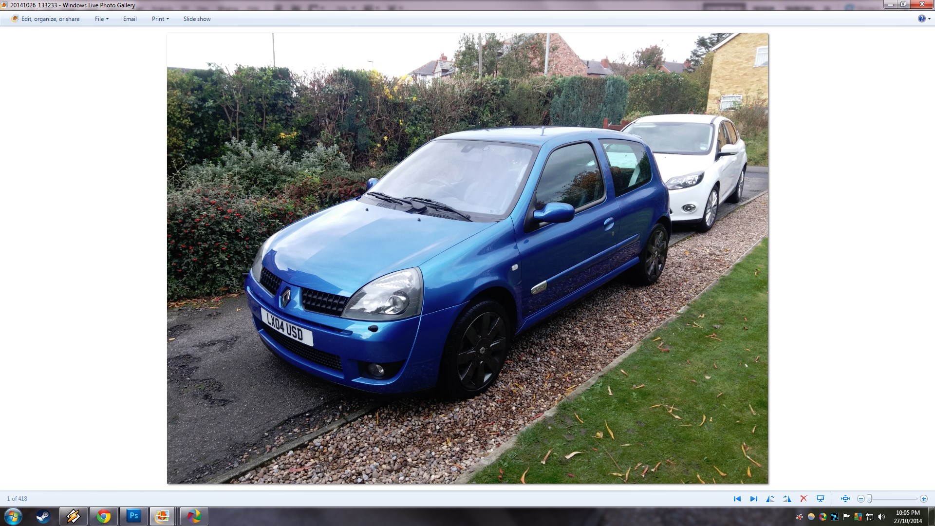

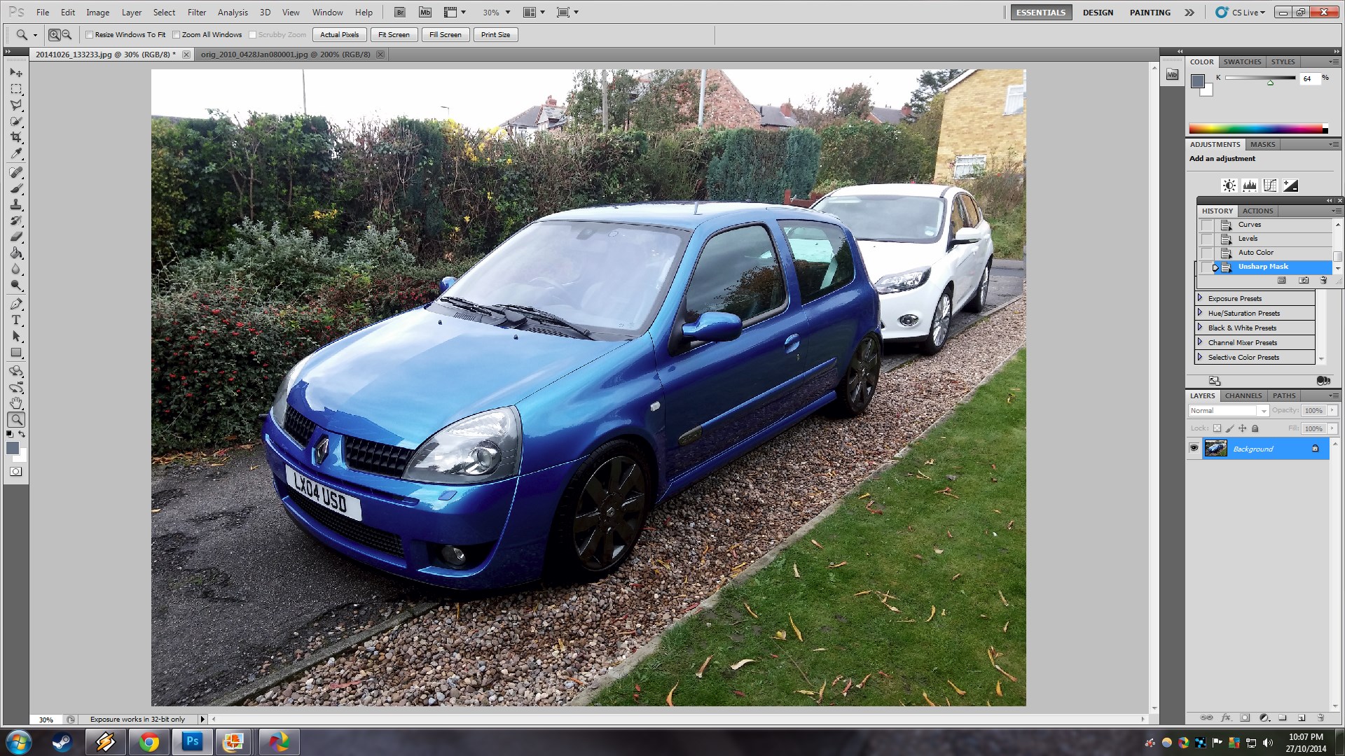

I had a further play with photoshop :D and I'm pretty much dead set on this now.
I've darkened the side bullets, lowered and put the headlight washer blanks on.
Before:
After:
What are people's thoughts?
I much prefer it when the bullets and the wheels are matching. So I'm with the after for both the bullets and the disappearance of the rake you had [emoji13]

Really very nice job on the painting, the difference from a flat and polish is mental.
Thank you Rob. I never used to do that with stuff I've painted before with fearing that I might damage it but it turns out it's not that scary after all. I'm really wanting to do the whole car now to get rid of the Orange peel.

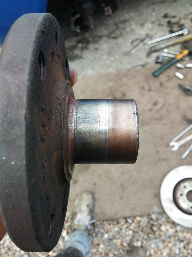

Did the top mounts sort the knocking?
Sadly they didn't. But when removing the old ones the bearings were absolutely destroyed so I'm glad I changed them anyway.
Changing the nearside wheel bearing actually cured the knocking. Must have been so loose that it enabled something to catch when changing gear /coming off the power.
Really glad it's sorted though as it was driving me up the wall.
dann2707
@tomhunt85

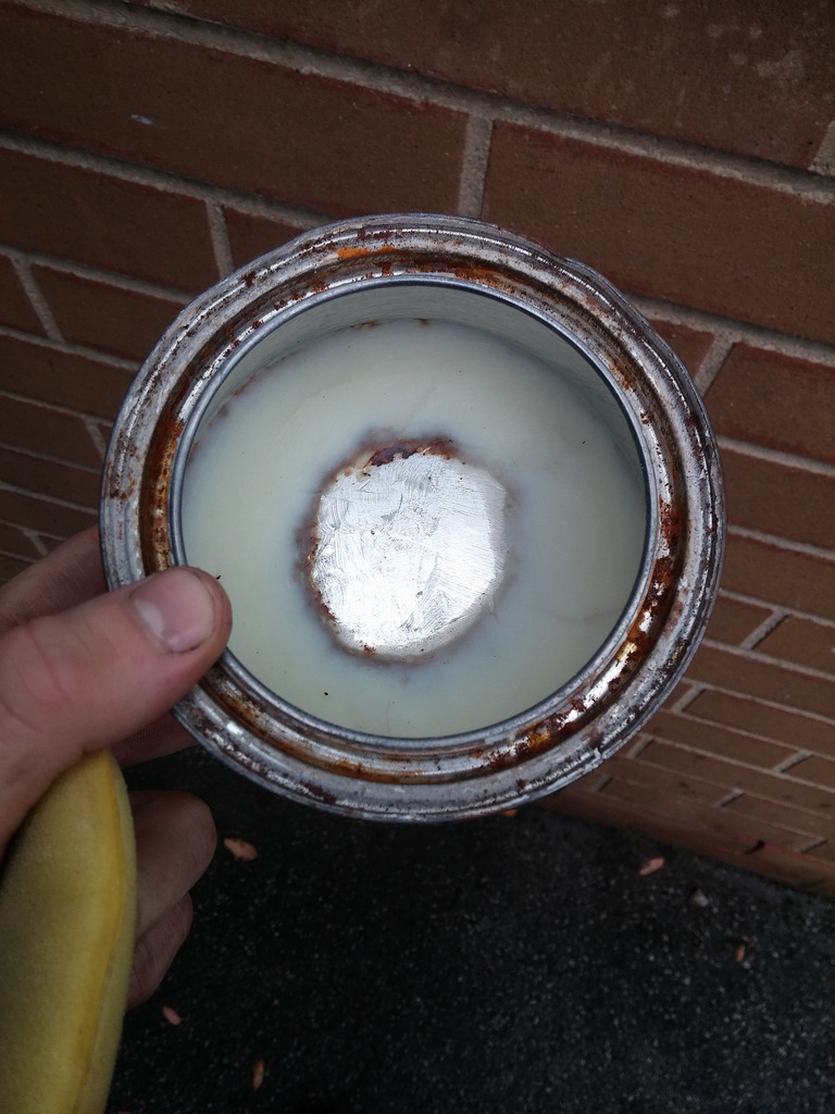

Found the source of my problems!
20141025_112620 by dann2707, on Flickr
There is a lip on the bearing carrier. Picture doesn't really show it but running my finger along that shaft :)D) shows a big lip. I'm not exactly sure how long it's been like that. When I first got the car the bearing was loose so maybe tightening and loosening, tightening again has worn away some of that material.
The new bearing is still sat in my bedroom as I am just using the one that came with the replacement hub that I bought yesterday. I'm not sure whether to just run this one into the ground or replace it anyway seeing as though I have it here anyway.

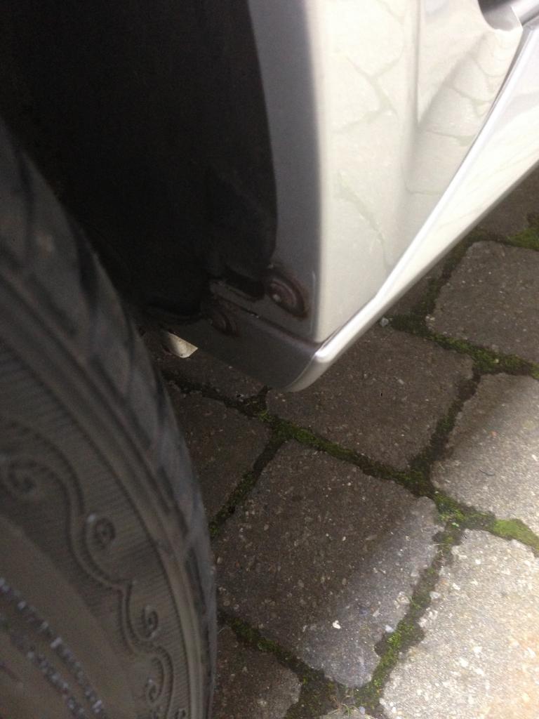

Thank you! (I think??) lol are these the ones that hold the bumper edge to the arch liners?
Can't remember me saying I needed these lol
  FRP - Clio 182
Yes thats correct, arch screws.
No you didn't but its the small things that make the difference and for £1.99 once fitted you will see why I recommended them to you.

You get 10 screws with that link, its two each behind the front wheels, then a few others in different arch positions.
  FRP - Clio 182
Yeah I did notice that, so I am assuming its a mistake, hoping so anyway.
I did inquire from Renault direct and they sell them at 55p each.

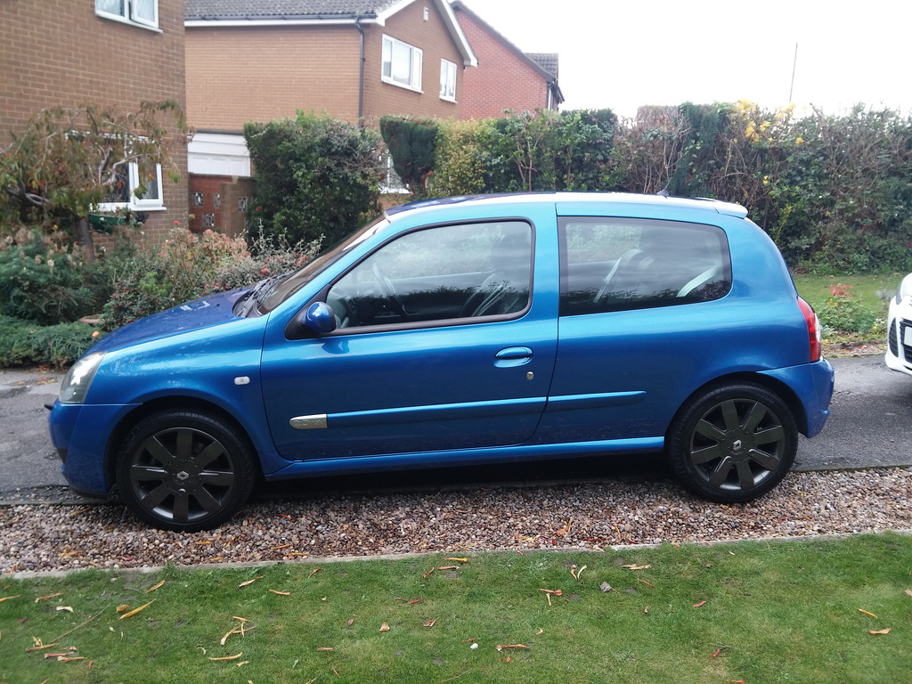

Big thanks to @Nick_Leeds for donating me some Eibach springs for the front. I fitted them Sunday with my mate who wanted to get his hands dirty. Also fitted a new front caliper and bled it suing the eezibleed system as I stupidly managed to snap my bleed bolt on my other a while back. Lesson learnt = Always GT85 that bast the day before you're thinking of bleeding brakes.

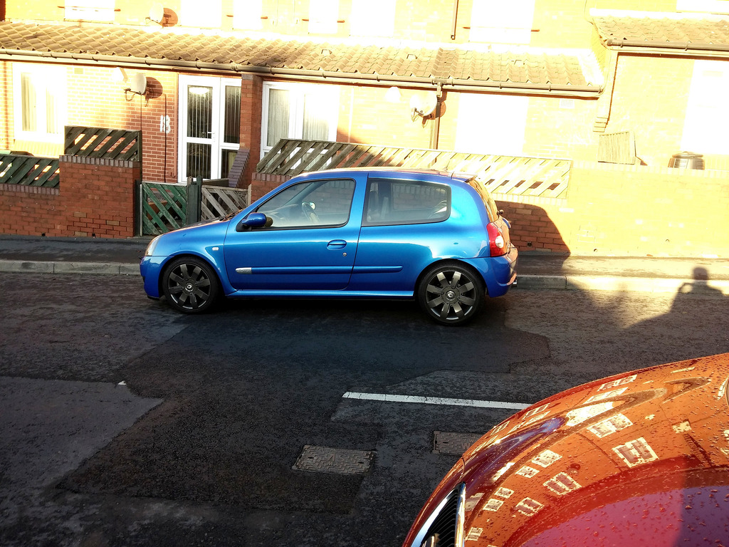

Anyway, really happy with how it's evened out the suspension up
2014-11-03_07-55-47 by dann2707, on Flickr
Seems to have levelled it compared to what it was like before
Will still be going for a full suspension refresh with Bilsteins at the end of year/ first quarter of 2015.
