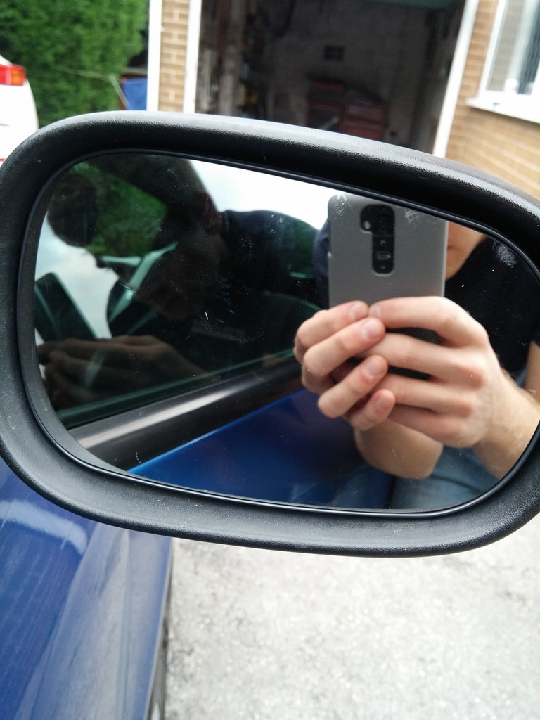

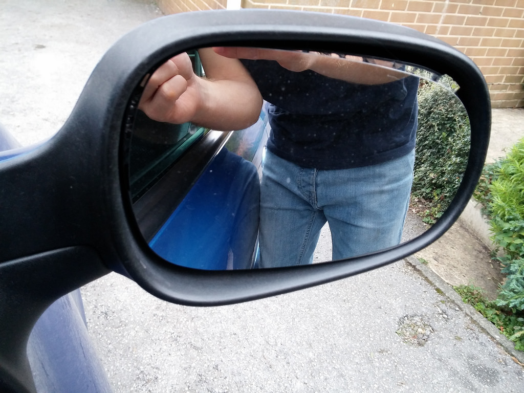

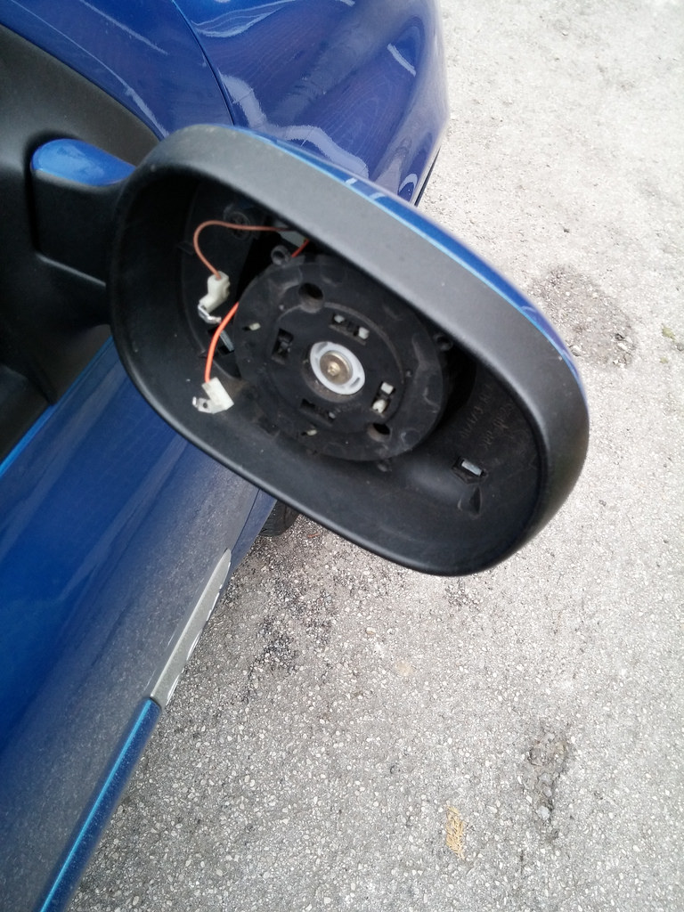

Finally changed my mirror glass. From my picking up the car it had one of those stick on wing mirror glass as the current one was broken. I had absolutely no idea I could just buy the glass replacements from eBay haha. So changed it... realised that this pic is just showing my crotch haha
2014-09-04 18.43.23 by dann2707, on Flickr
So annoying how it wasn't even put on at the right angle haha
2014-09-04 18.43.34 by dann2707, on Flickr
Glass popped off and the terminals for the heated elements disconnected.
2014-09-04 18.44.28 by dann2707, on Flickr
And the new one on. Not sure why the pic is showing up that distortion on the top right :/ it's clear in real life haha
2014-09-04 18.46.03 by dann2707, on Flickr

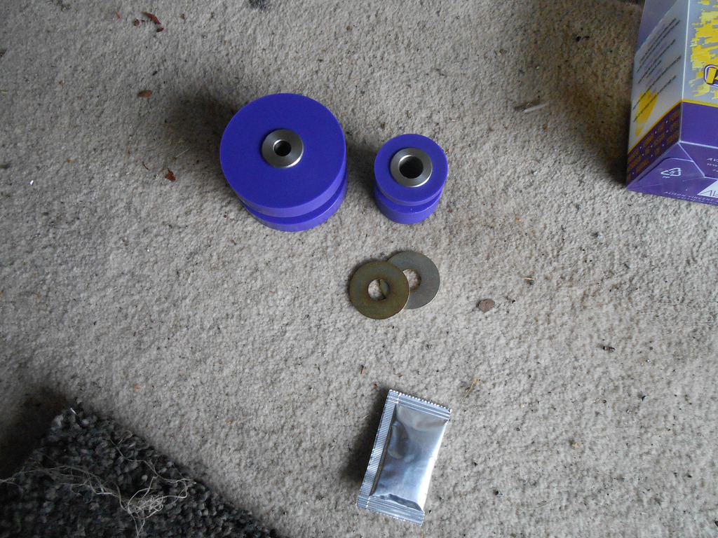

when you removed the washers.. are you still able to slide the seat back and forth easily? Ive done mine and now my seat wont slide easily. Have i done something wrong or is yours the same? Thanks
dann2707
cars looking good mate
Just read the thread, Top Job buddy, quite a transformation
Nope you've done it right mate. Mine is stupidly stiff now. I'm tempted to remove the bit of carpet it's pressing against as a few slices with a Stanley blade will fix it :)
welshname
Found the exact same thing! Did mine this weekend along with a ph1 gearstick conversion (if you've not already you really should).
I'm going to have a look at cutting away the carpet at the weekend.
dann2707
What does the ph1 gearstick benefit matey? Never heard of this conversion!

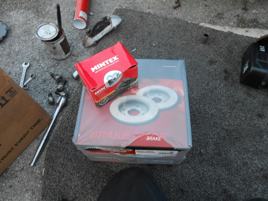

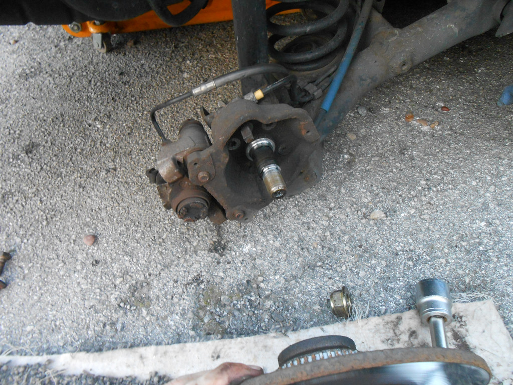

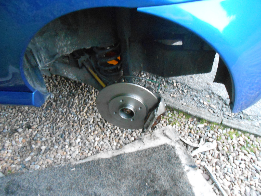

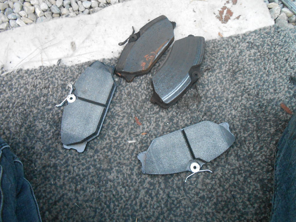

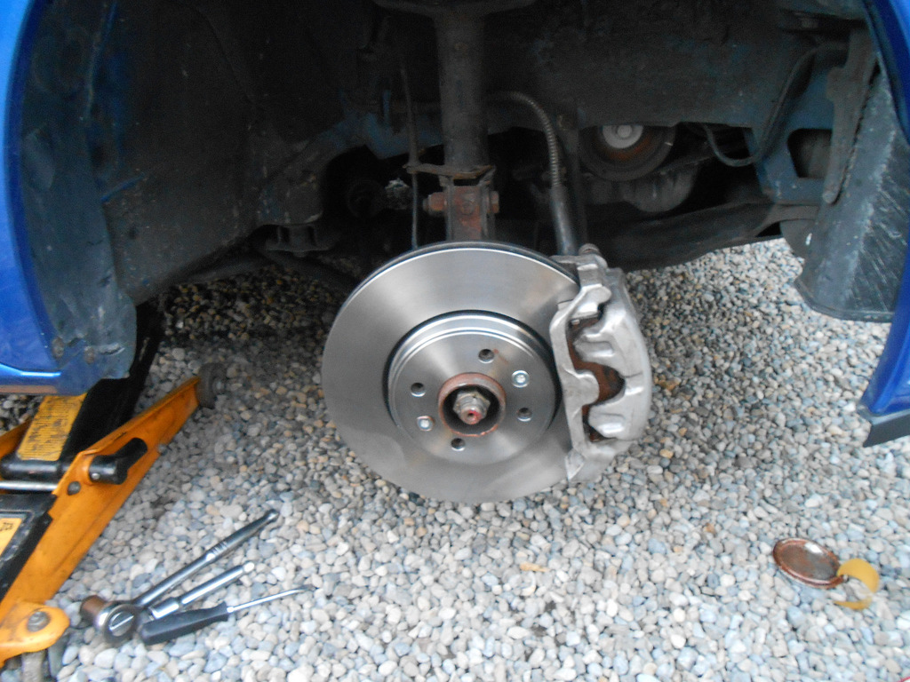

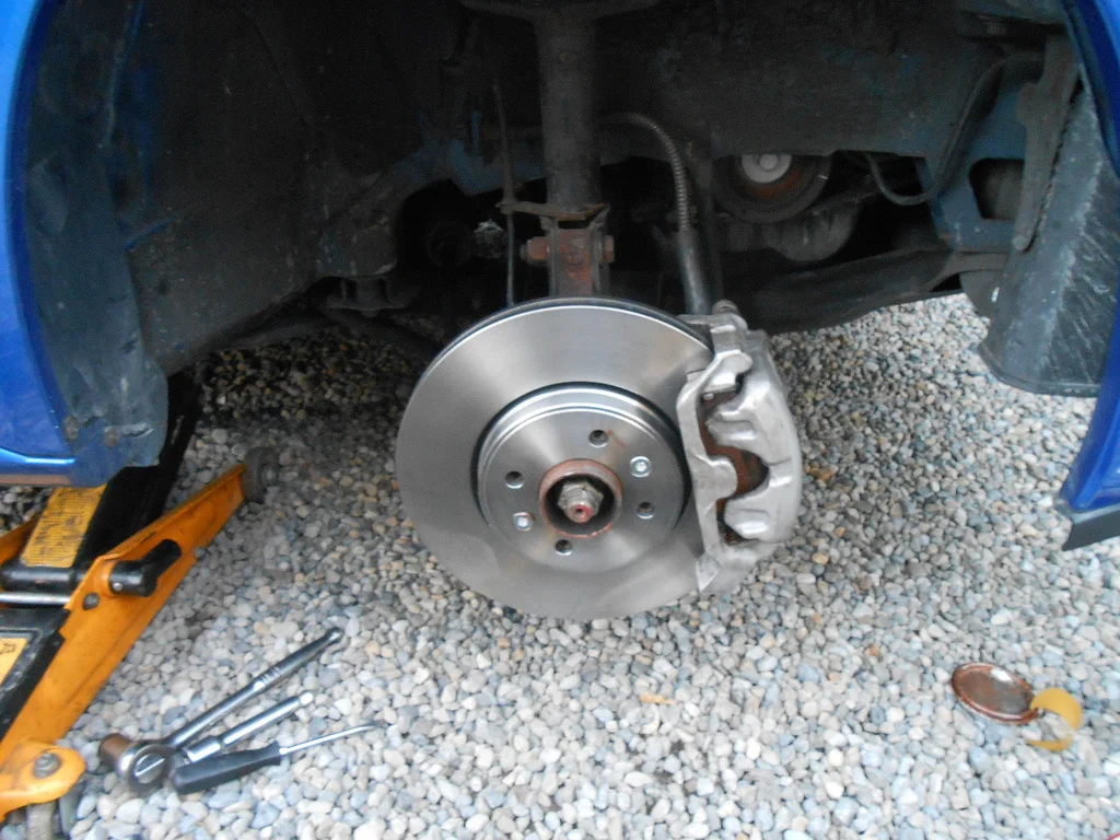

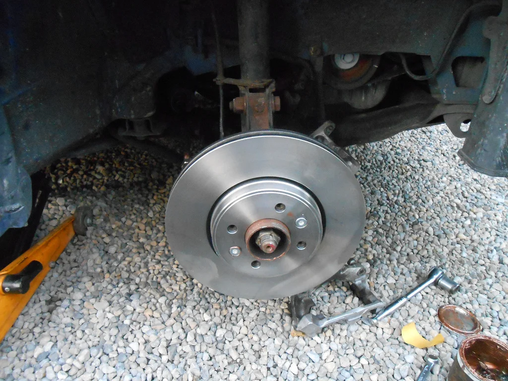

I've got a lovely and boringish update haha but it's something that's been bugging me for a while.

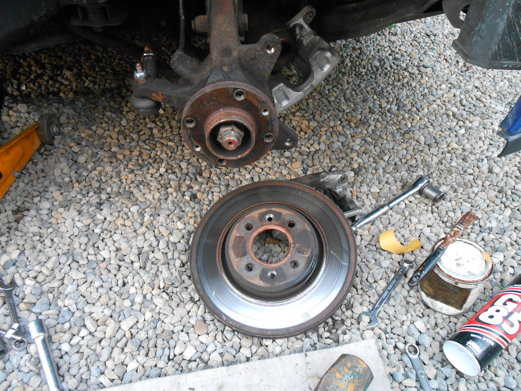

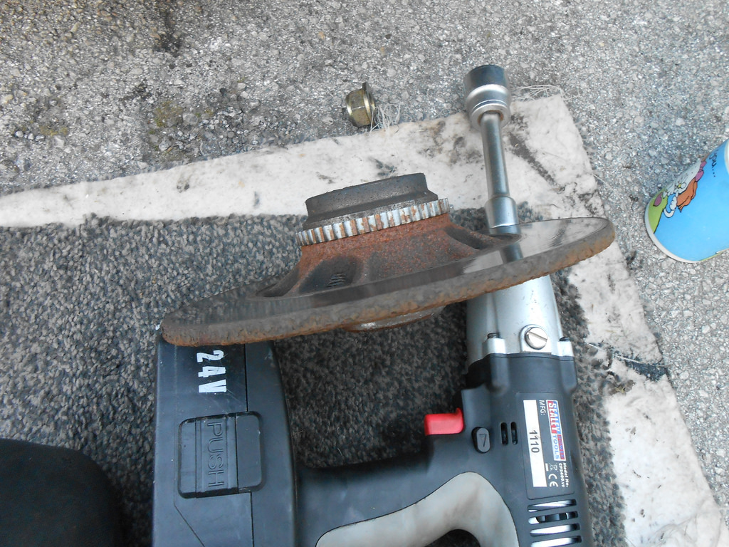

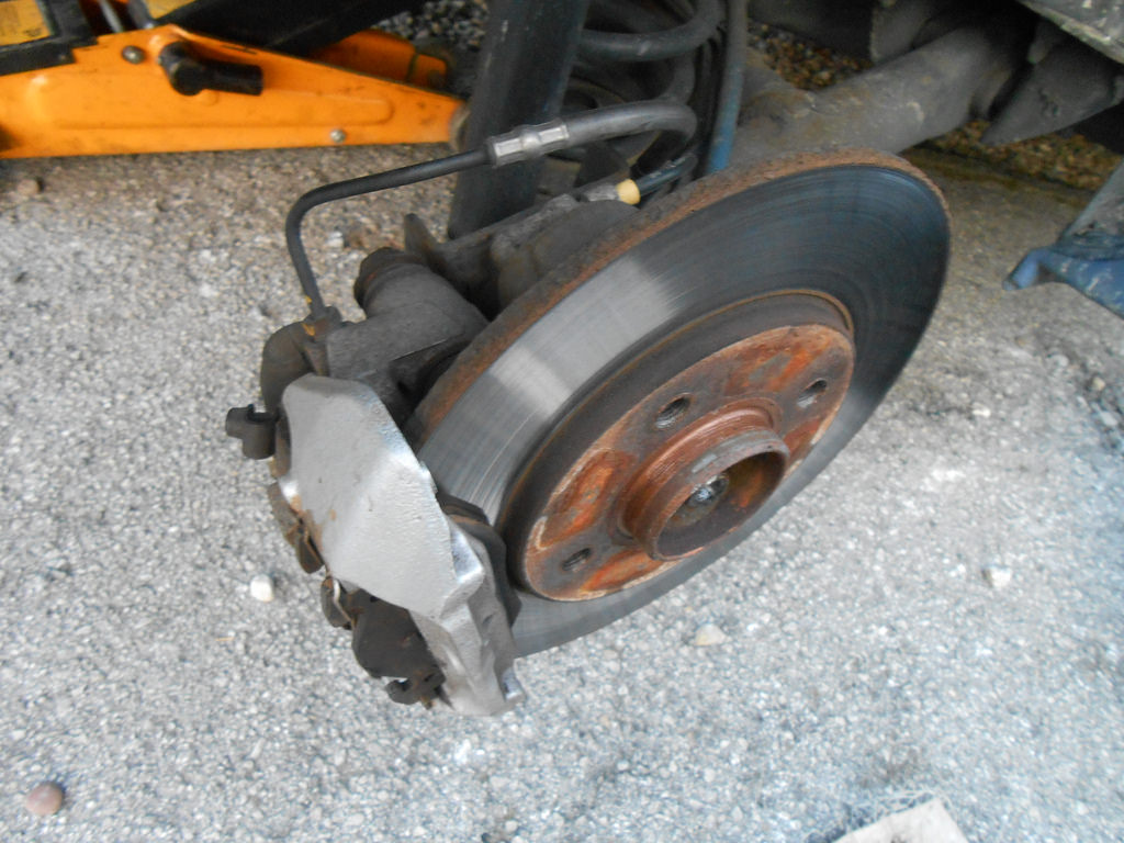

Completely changed the brake discs and pads all around. The discs were worn a lot and just didn't feel confidence inspiring. This coupled in by the fact that the rear o/s wheel bearing was humming at 35mph+ and the bearing being a part of the disc just made sense to change it all.
This was the front.
DSCN2617 by dann2707, on Flickr
DSCN2618 by dann2707, on Flickr

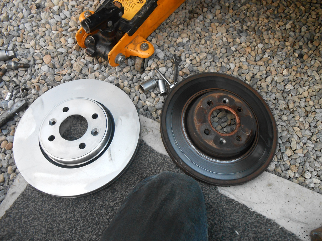

I simply undid the two bolts holding the disc on and hit it gently with a soft mallet and it came off :)
DSCN2619 by dann2707, on Flickr

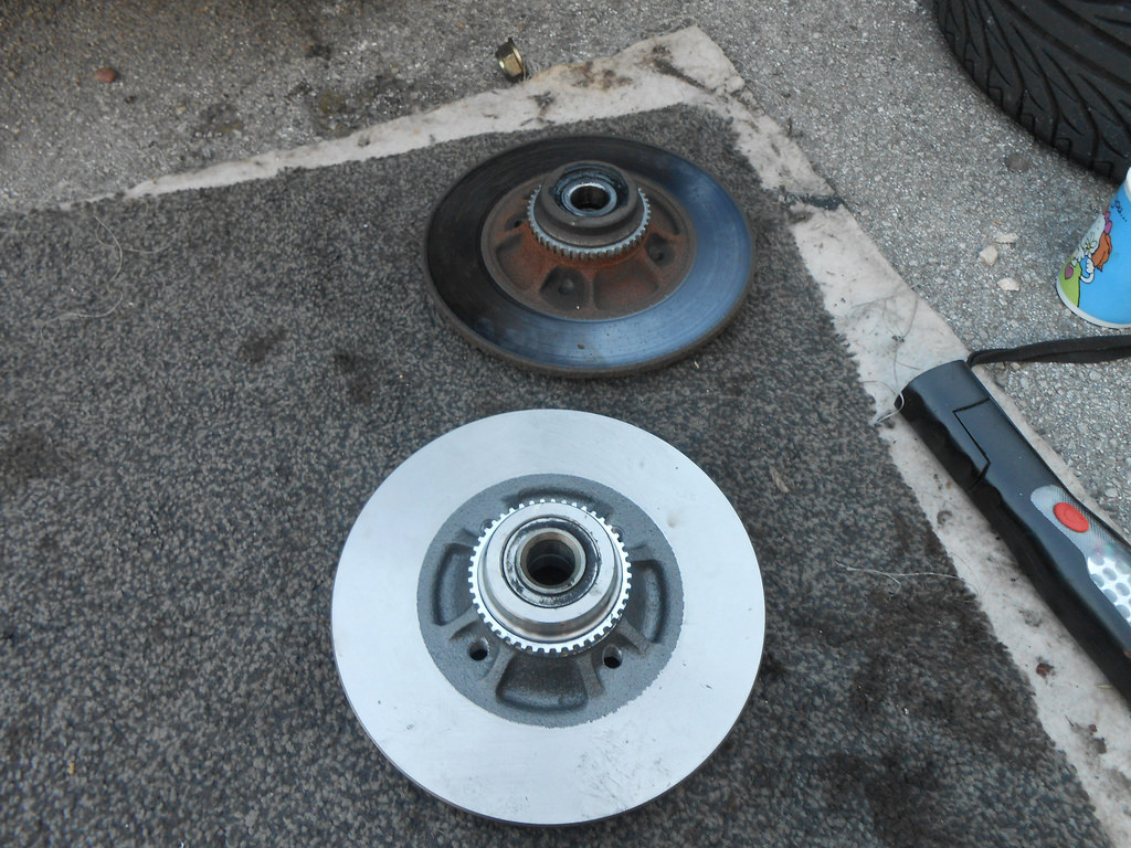

New vs old
DSCN2620 by dann2707, on Flickr
New discs on. I went for Brembo HC's as heard they work really well with the clio set up. Lots of copper grease on the hub to prevent the disc seizing on.
DSCN2621 by dann2707, on Flickr
And then I changed the pads. I went for Mintex M1144's
DSCN2622 by dann2707, on Flickr
All on
DSCN2624 by dann2707, on Flickr

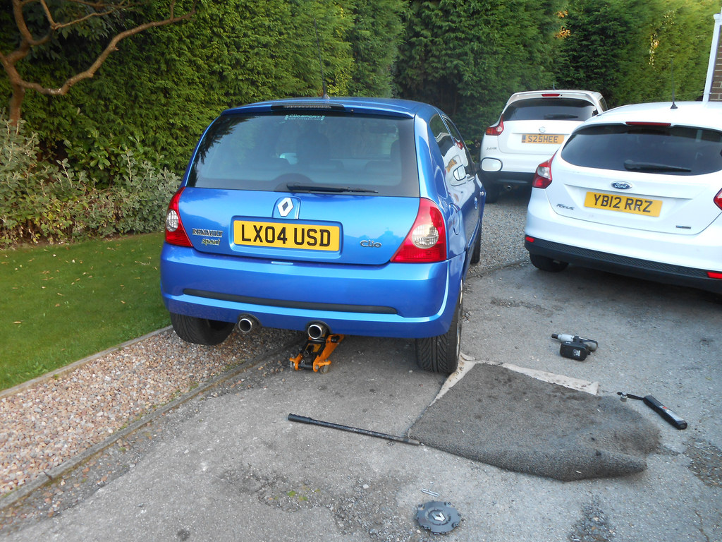

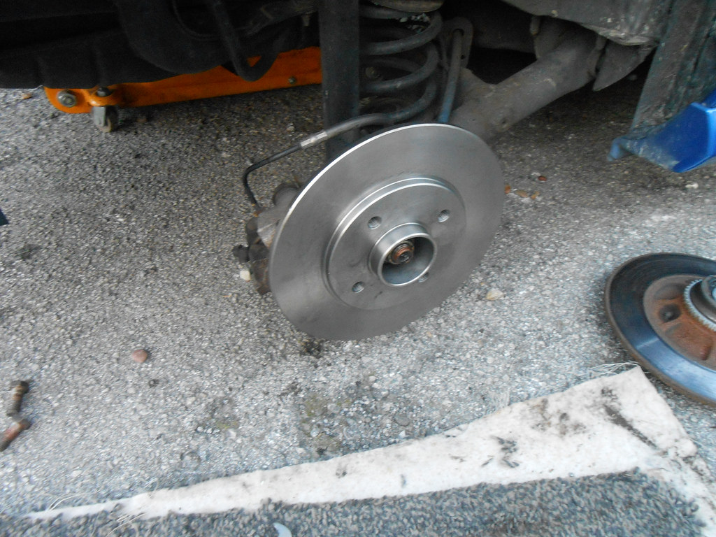

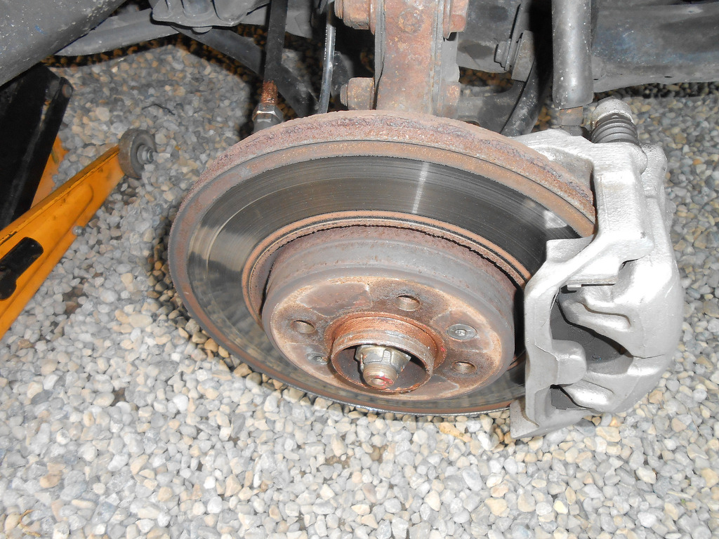

Then two days later (Today) I changed the rears. Started by jacking Boris up.
DSCN2625 by dann2707, on Flickr

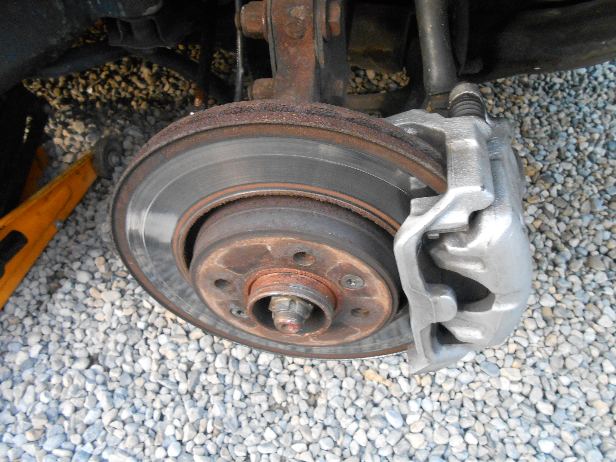

This was the state of the rears. Quite a large lip on the edge of the discm on both the fronts too actually
DSCN2626 by dann2707, on Flickr

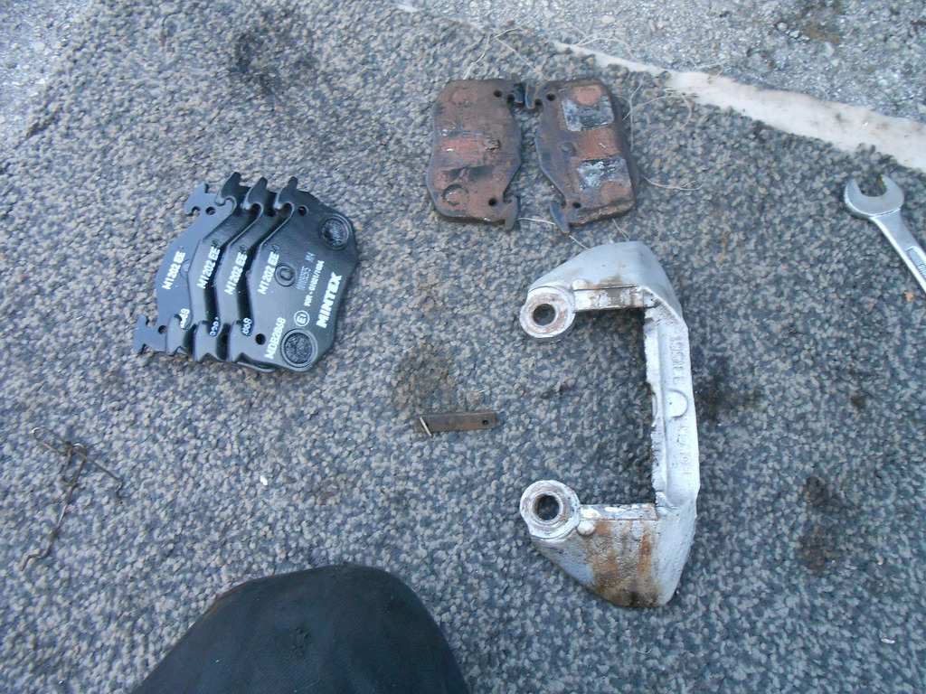

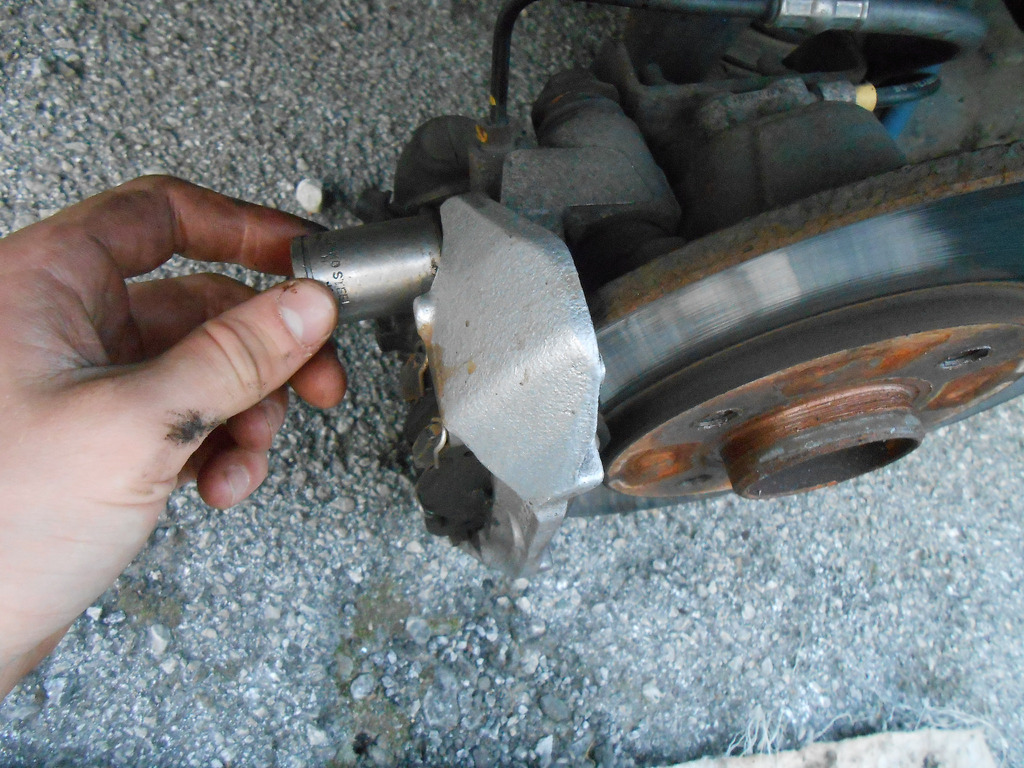

17mm nut on the rear of the carrier and it simply comes off allowing changing of the pads. I then undid the 30mm hub nut.
DSCN2627 by dann2707, on Flickr
All off.
DSCN2628 by dann2707, on Flickr
DSCN2629 by dann2707, on Flickr
This is the washer that i'd heard so much about, people not re-fitting them back to the new hubs/discs after changing and it giving massive problems afterwards. I made a note of which side up it was when removing.
DSCN2630 by dann2707, on Flickr
New stuff.
DSCN2631 by dann2707, on Flickr
DSCN2632 by dann2707, on Flickr
Made a right mess of my carriers from all the grease. Need to clean them down when I get the time.
DSCN2633 by dann2707, on Flickr
And finally all on.
DSCN2634 by dann2707, on Flickr
DSCN2635 by dann2707, on Flickr
welshname
Ph1 gearstick has no REAL benefit. It just feels better, surprisingly so actually. It's a solid metal ball on top, weighting is better and the size/shape is spot on.

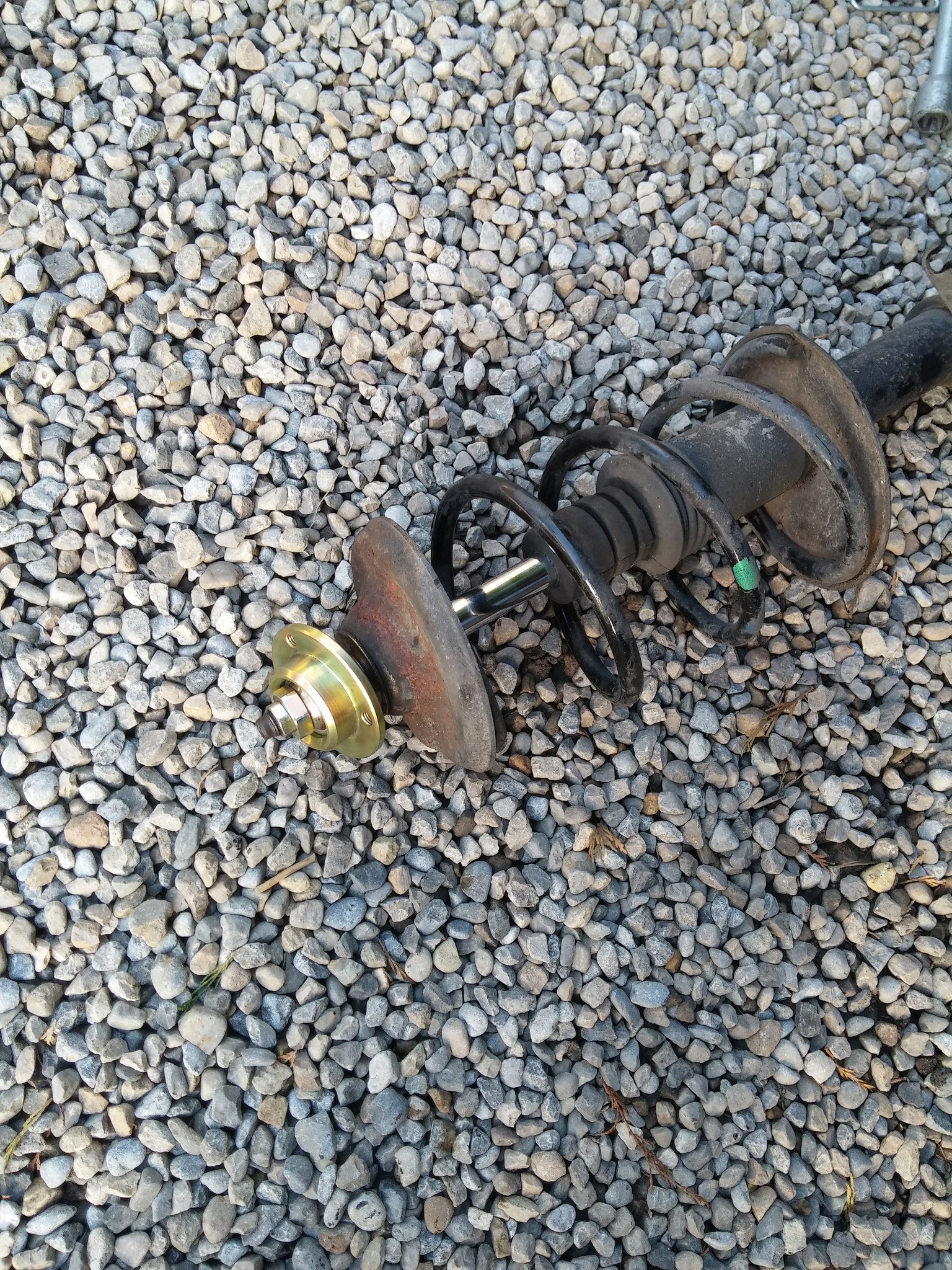

dann2707
Update time.

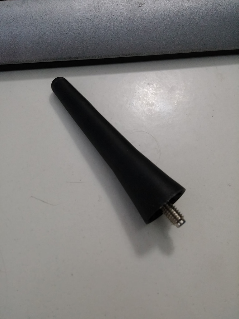

This arrived, so happy with it, made a massive difference in my opinion. It's a c2 stubby aerial.
2014-09-11 21.24.33 by dann2707, on Flickr
Before:
2014-09-12 07.51.48 by dann2707, on Flickr
After:
2014-09-12 07.52.14 by dann2707, on Flickr

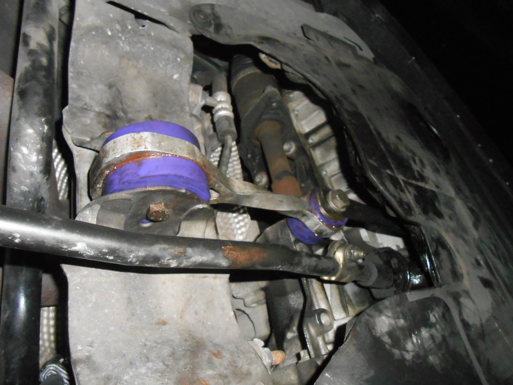

I'm getting a wandering feel when driving at speed, accelerating etc pulling left and right so im trying to find the root of the issue! New shiny parts always makes me happy :D
DSCN2636 by dann2707, on Flickr
Got the old ones off
DSCN2637 by dann2707, on Flickr
I haven't driven it yet but i'm hoping it's solved the problem :)

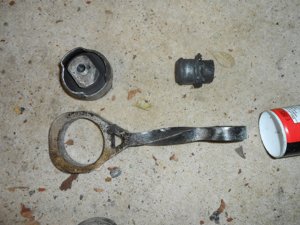

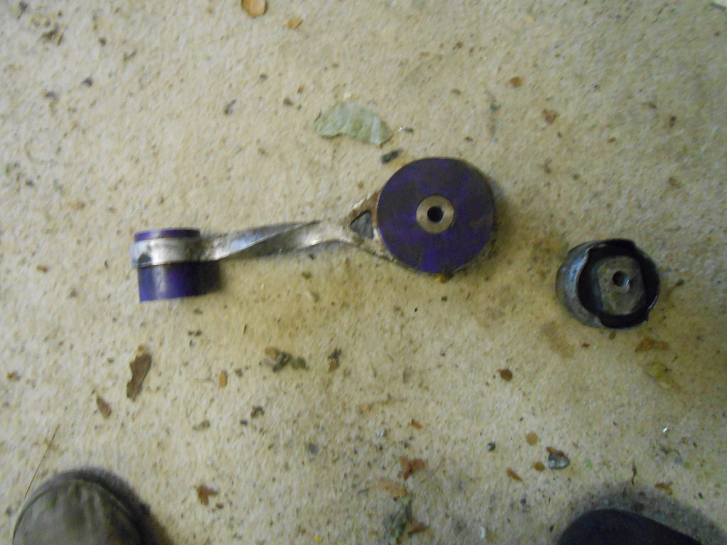

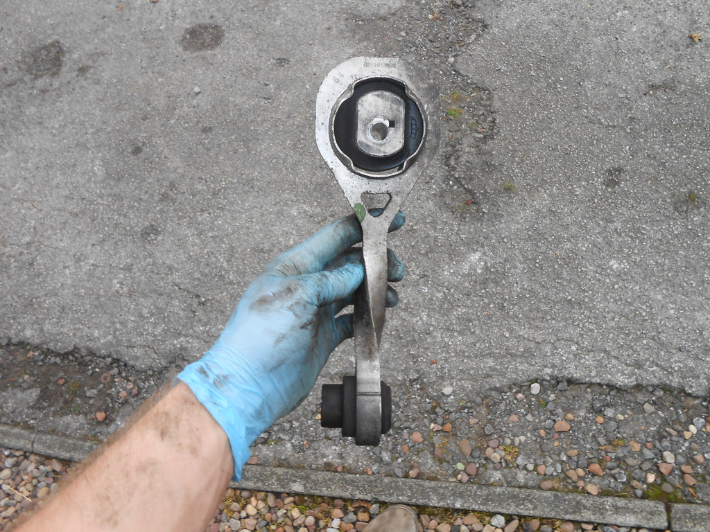

dann2707
New parts :)
DSCN2640 by dann2707, on Flickr

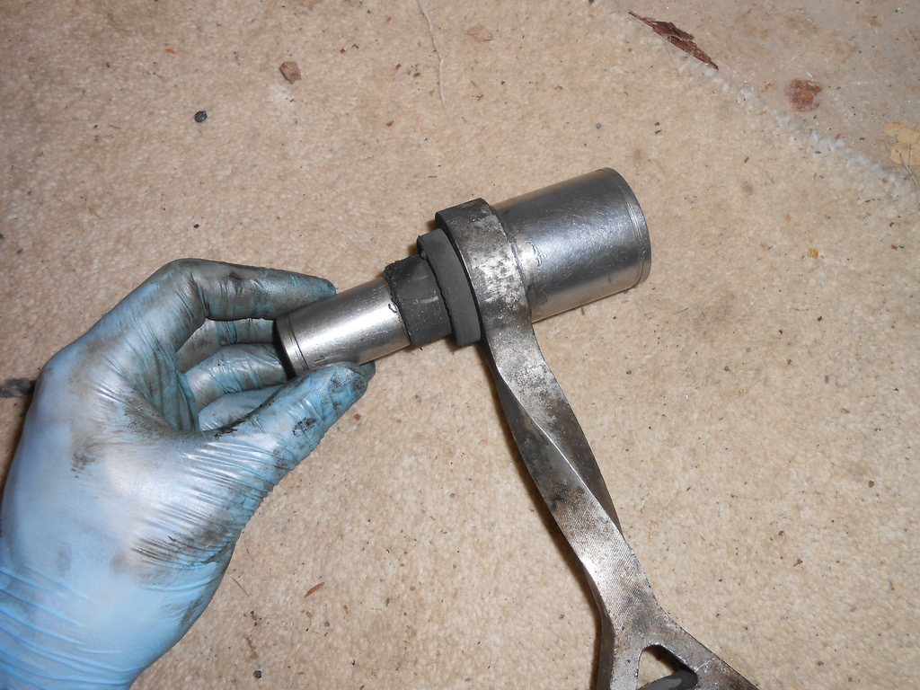

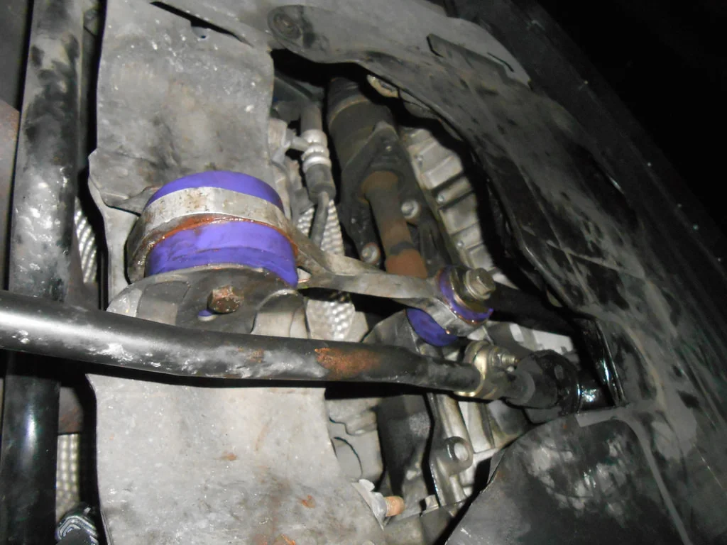

Powerflex dogbone bush kit
DSCN2641 by dann2707, on Flickr

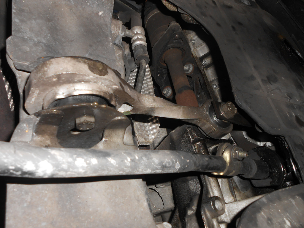

This is the old one in situ
DSCN2643 by dann2707, on Flickr
Removed with 2 x 16mm nuts that came out fairly easy with a bit of leverage.
DSCN2645 by dann2707, on Flickr
Then to remove the old bush at the gearbox end I pressed it out using two sockets, one the same dia as the bush and a larger one for it to push into :)
DSCN2646 by dann2707, on Flickr
The other one came out with a few hits with the persuader
DSCN2647 by dann2707, on Flickr
New one fitted and put in :) Sorry for how dirty it looks there, flash is way too bright haha
DSCN2648 by dann2707, on Flickr
DSCN2650 by dann2707, on Flickr
I then went for a drive, apart from the remap I would say hands down it is the best mod i've done so far. Absolutely love it!!

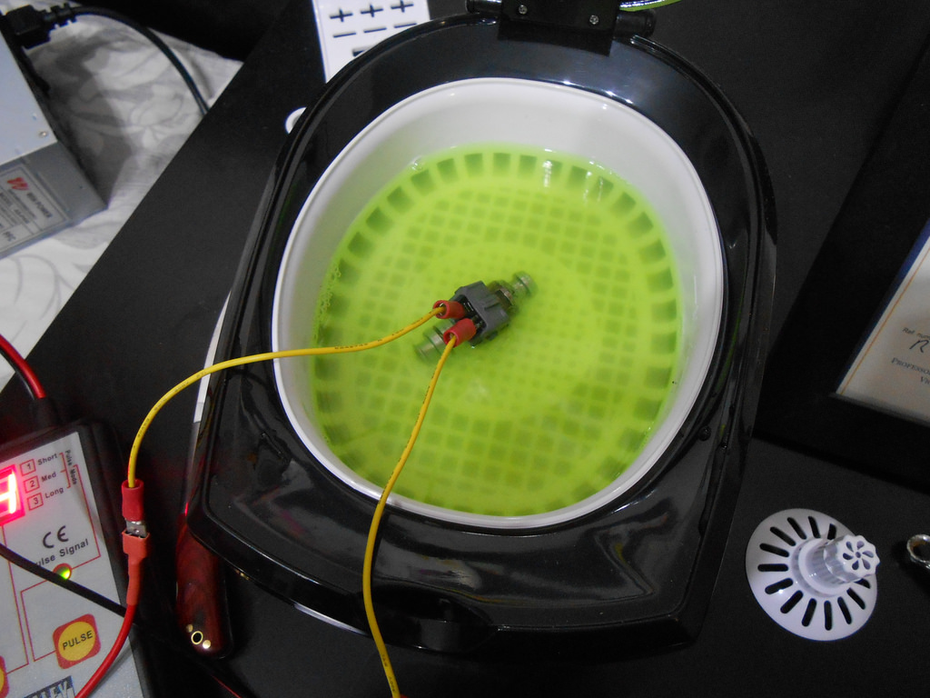

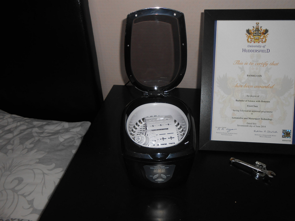

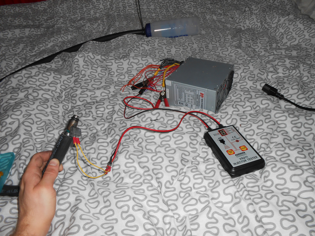

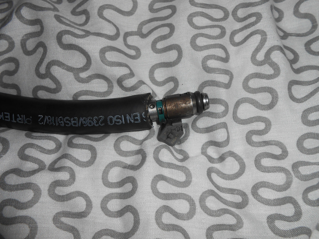

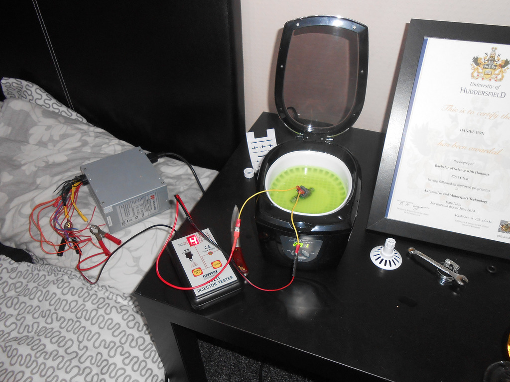

Okay so this update can either be seen as ghetto as f**k or awesome. You can all decide haha.
But basically, I wanted to clean out my injectors properly! The redex crap is exactly that and I think the only way to clean them properly is to leave them in an ultrasonic bath.
I researched into it whilst on my lunch breaks at work and saw that simply leaving them in an ultrasonic bath wouldn't do that much in comparison to with them being pulsed like they would be in a real life situation. So I had a search, and bought an ultra sonic cleaning bath!
DSCN2652 by dann2707, on Flickr
It had loads of great reviews online so went for that one.

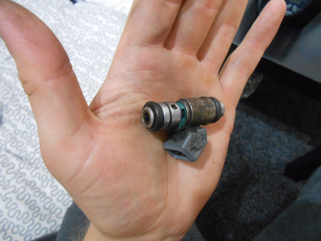

I had a spare injector from when I replaced mine a month ago as it was giving me hassle.
DSCN2655 by dann2707, on Flickr

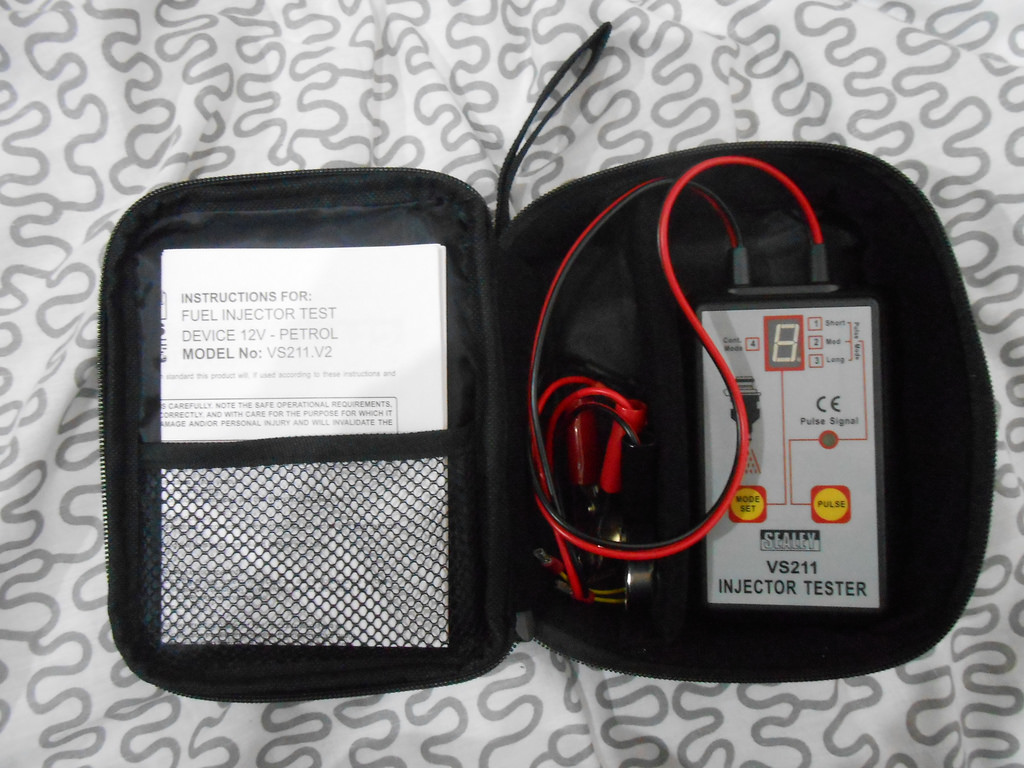

I then bought a petrol injector pulser.
DSCN2657 by dann2707, on Flickr
However this gave me a bit of a problem (known to me already). It only worked on the car battery as in 12v, which wasn't ideal as everytime i'd want to do this i'd have to be in stupidly close proximity to my battery in the freezing cold = not comfortable at all.
DSCN2660 by dann2707, on Flickr

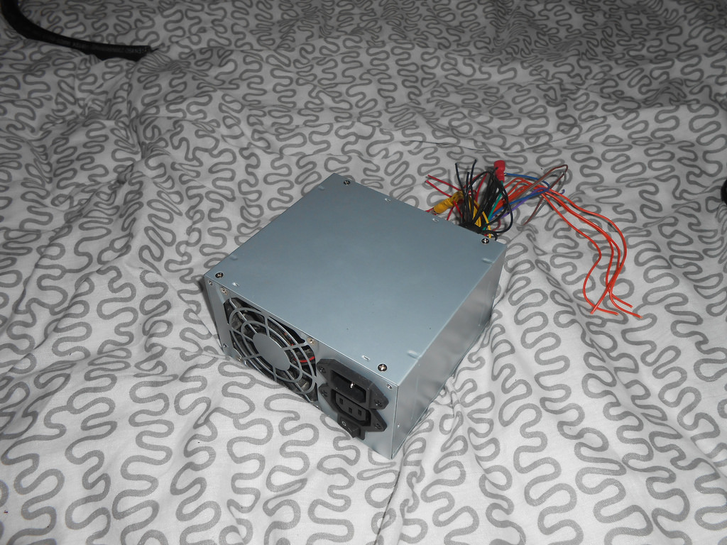

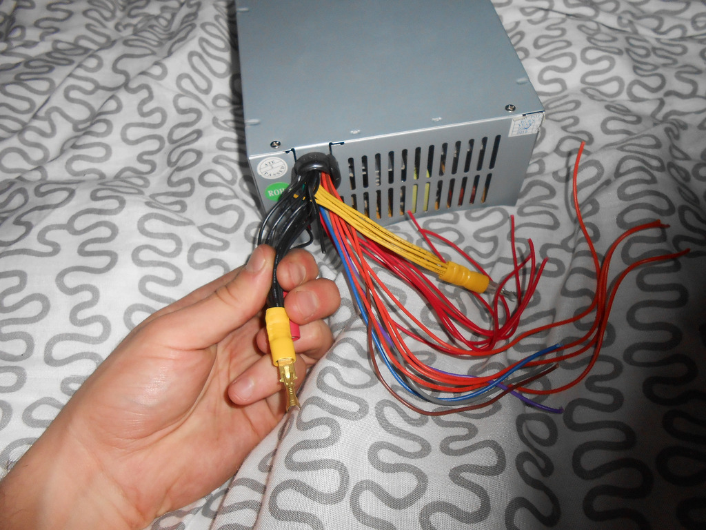

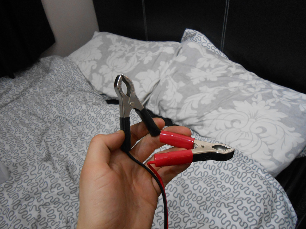

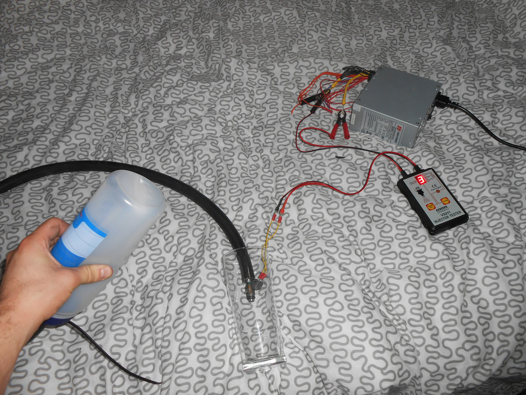

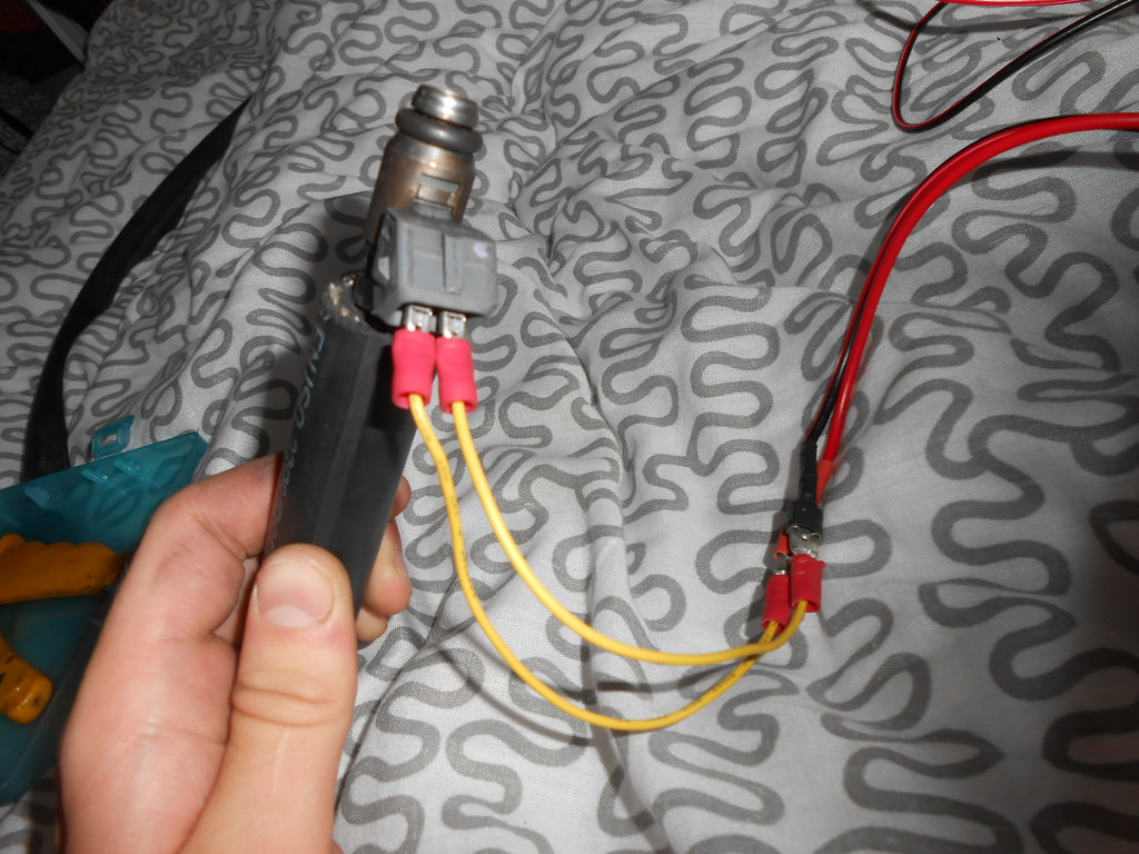

So a bit of googling returned results that I could actually use a spare computer PSU to get a 12V feed by simply crimping the yellow wires together.
DSCN2663 by dann2707, on Flickr
So I did just that, crimping the blacks together for the earth and the yellows for the 12V. I can actually use the reds for another feed, think it might be 5v or something :)
DSCN2664 by dann2707, on Flickr
I can then (crudely) hook up the injector tester to my PSU and voila, it powers up. I do intend on making it more secure in the future as now it is simply crocodile clipped onto the wires of the PSU as shown.

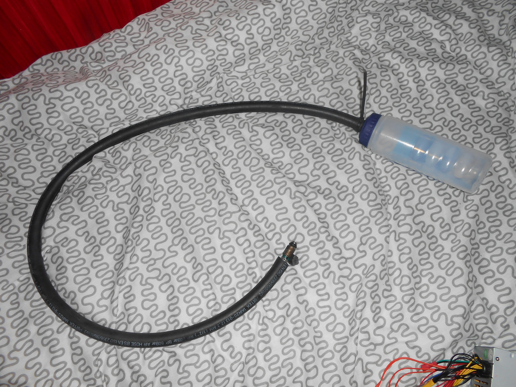

I then needed to test the injector using the pulser however I obviously need to get some pressure behind the injector. This was really just to see how it was looking prior to cleaning. As said, it was giving me some issues that's why I changed it. I then found some pipe that it would fit into snugly!
DSCN2671 by dann2707, on Flickr
I then hooked up a squeezy bottle to the other end, again this was air tight so my intentions were to fill the pipe with fluid through the blue bit and screw the bottle on and then squeeze that to apply pressure to the injector.
DSCN2672 by dann2707, on Flickr
I then hooked up the terminals to the injector
DSCN2673 by dann2707, on Flickr
DSCN2675 by dann2707, on Flickr
And now I can squeeze the bottle whilst pulsing the injector.
DSCN2676 by dann2707, on Flickr

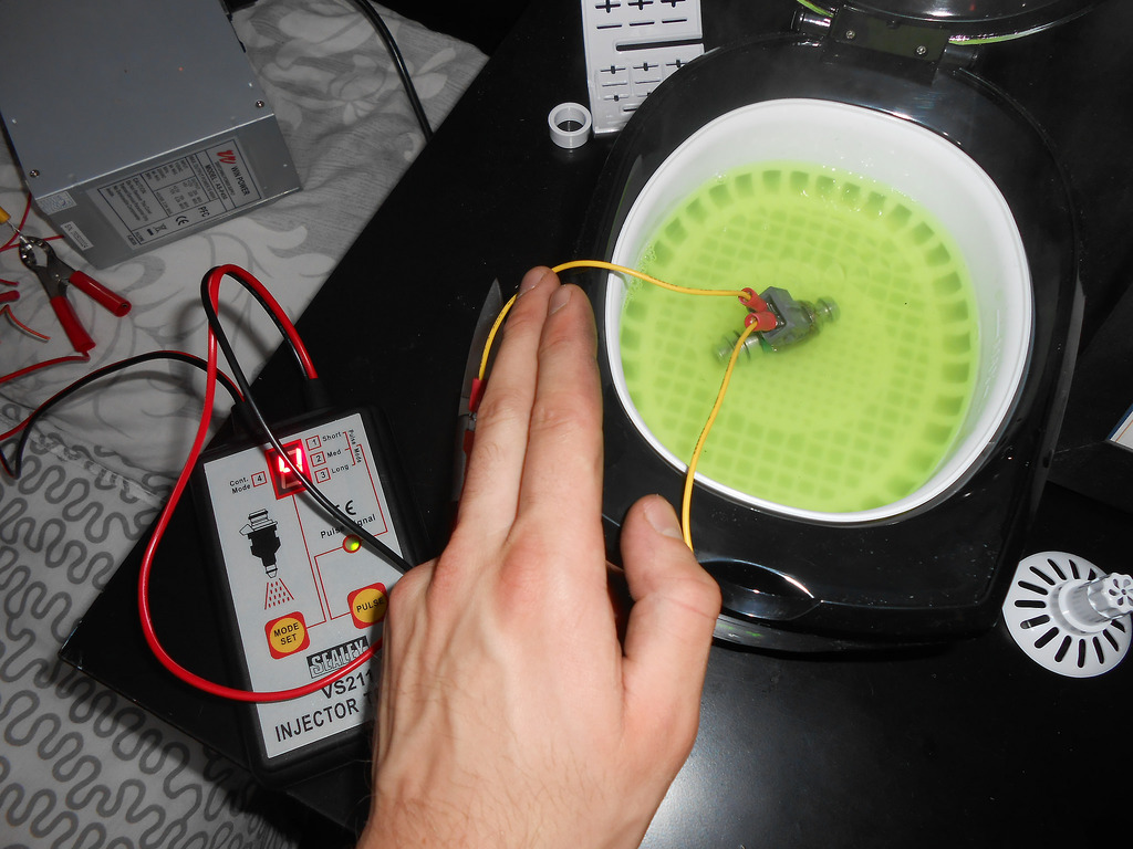

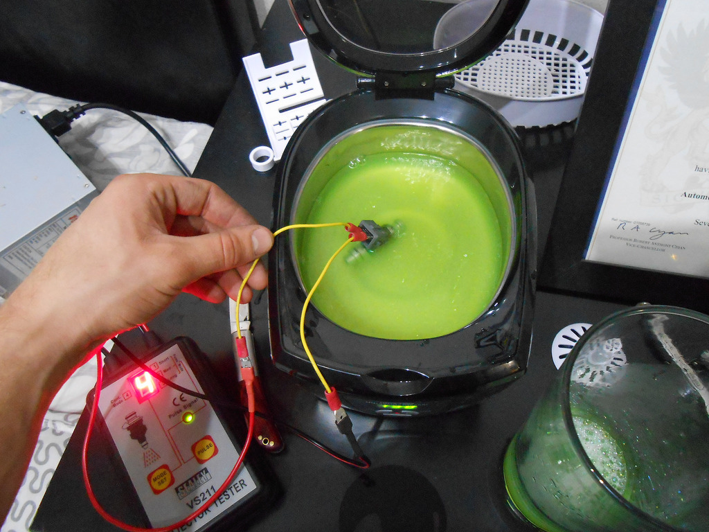

When doing this test I noticed that the injector only appeared to be spraying out of two parts and hitting the glass in two clear parts, much like a car windscreen washer. I couldn't get a picture of this as I don't have three hands.
I then filled the bath with near boiling water and all purpose cleaner (actually got some proper cleaner waiting for me to collect at work)
DSCN2679 by dann2707, on Flickr
DSCN2680 by dann2707, on Flickr
I then turned the pulser to constantly pulse and turned the bath on for 480 seconds.
DSCN2682 by dann2707, on Flickr
DSCN2683 by dann2707, on Flickr
I could see the dirt coming off, not as much as what I expected however.
Hooking up the injector back to my homebrew pressure tester lead to some interesting results. I thought I had completely broken it as it wasn't spraying any fluid...
or what I thought anyway, I just couldn't see anything?? So I got my torch shining on the injector and it turned out it was actually spraying but instead of clear droplets that I could see before it was more of a mist and that's why I couldn't see it! I also noticed that instead of it spraying out of two nozzles like before it was actually spraying out of all 4 of the micro holes in the end.
This is proven that it worked as the injector should ideally be spraying in a mist rather than like a hose pipe like it was before!
Glad my little ghetto testing and cleaning rig worked :) Going to be doing my actual ones at the weekend with the proper cleaning fluid.
Thanks for reading, it's been a long one haha

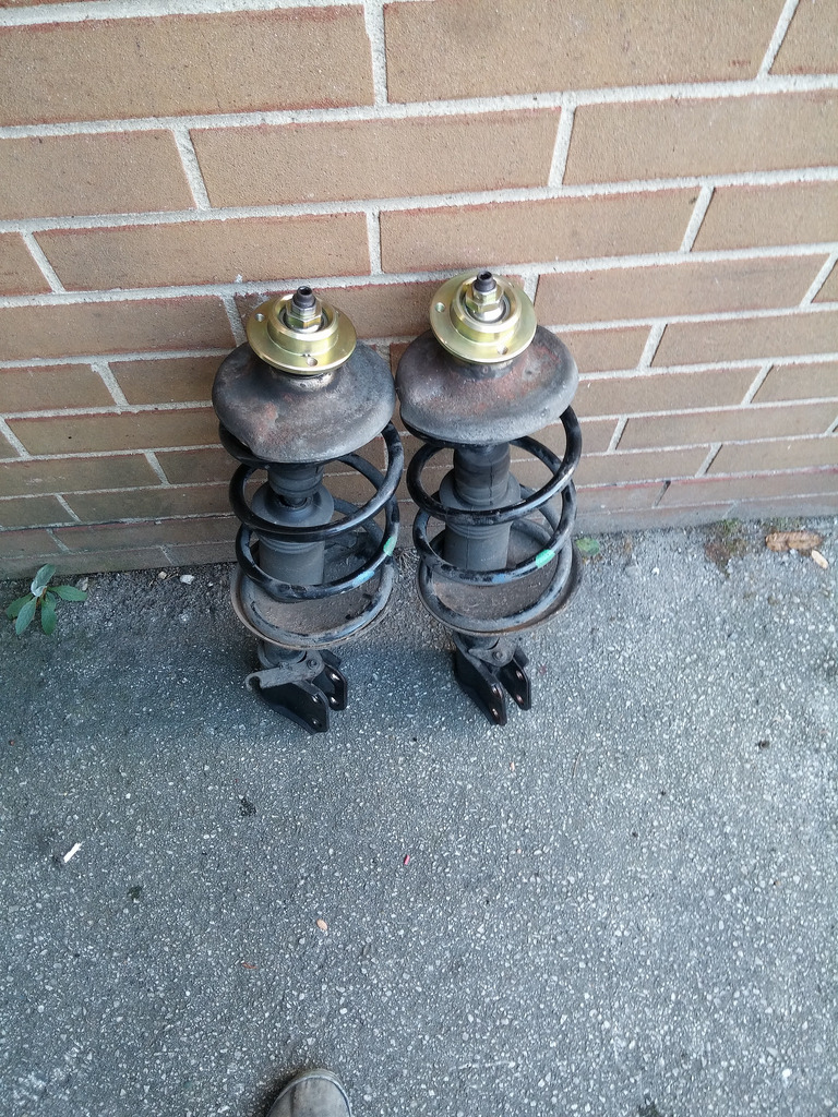

Haven't done much to the clio lately apart from just getting back from a 300 mile round trip going to the lake district with the mrs.
Ended up averaging a nice 42mpg too which was cool despite enjoying some of the roads.. :D

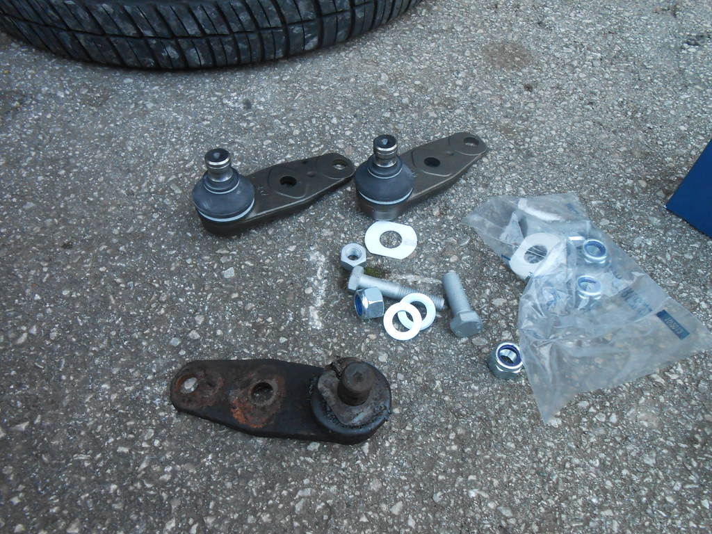

However i'm getting a horrible feeling when driving, clunking when accelerating and changing gear, pulling to the right when accelerating, steering pulling left and right when braking. So far I have...

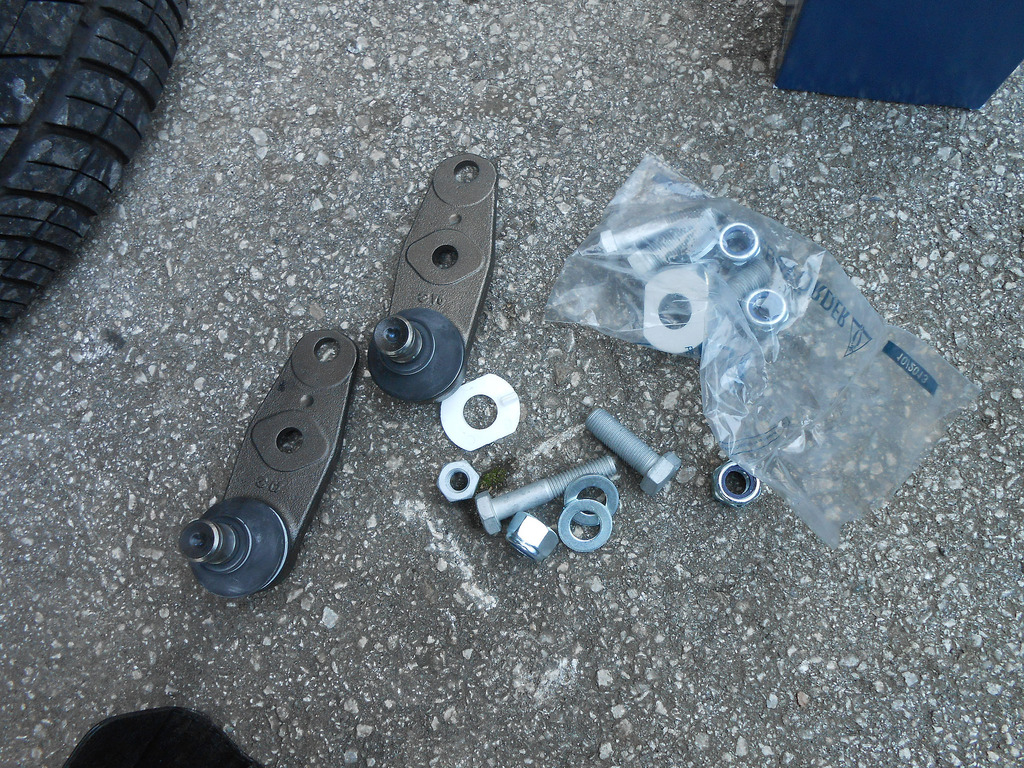

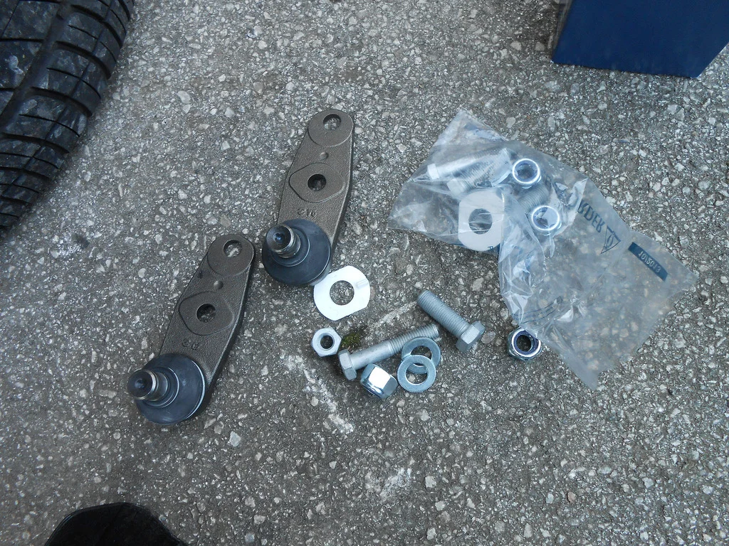

New track rod ends and inner tracks
new lower wishbone ball joints
lower polybushed engine mount
fully tracked using hunter system
new upper gearbox mount
new bearings at the rear, tightened up to 175nm etc
new nearside bearing
Still feels horrible.
