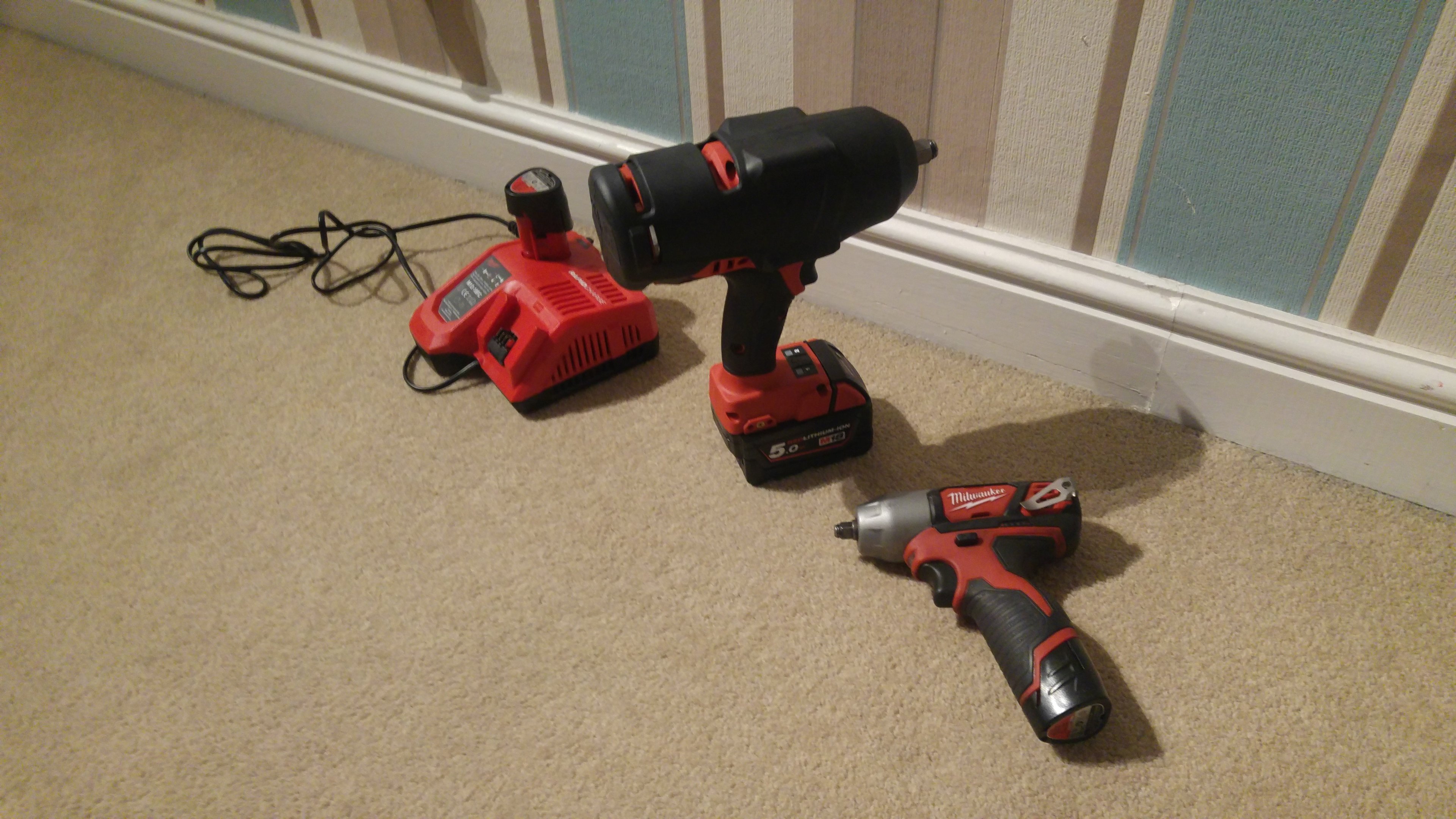

Well the little boy has a bigger brother now :D I'm so excited haha. Just tightened a bolt in the vice as hard as I could and it just undid it with absolute ease. I can't wait to properly test it.
I'm now looking at getting a milwaukee 3/8 ratchet haha turning into a right brand whore. I don't even need it.

You have a Milwaukee problem. I know first hand.
I have both them guns one in between, ratchet, screw driver gun and vacuum 😂

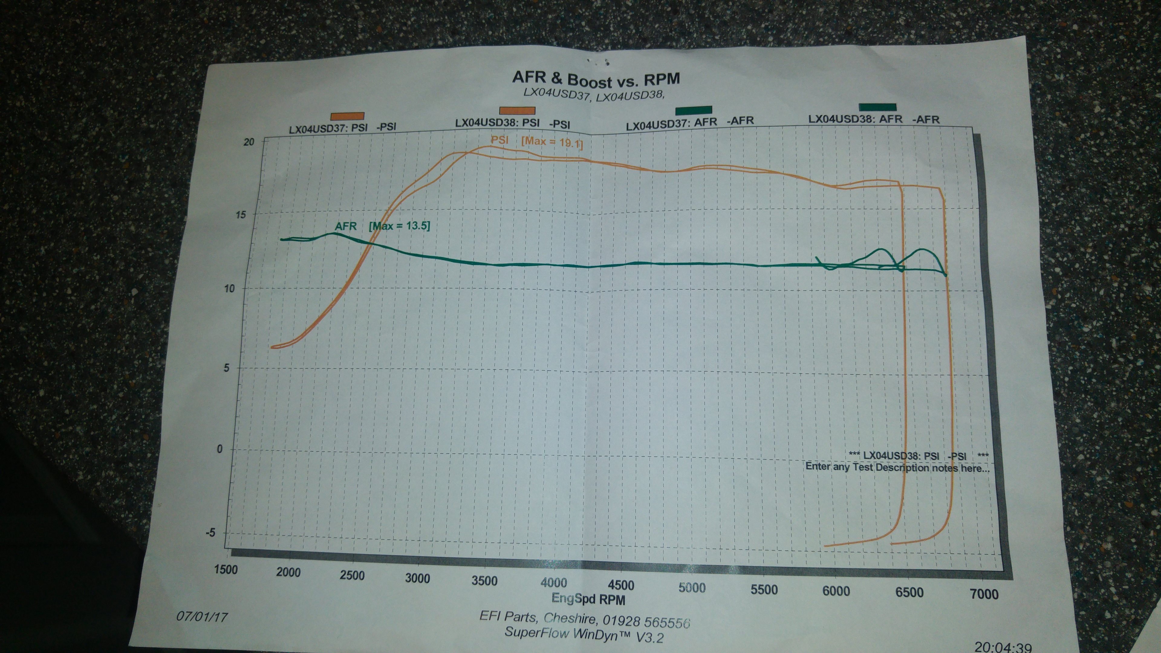

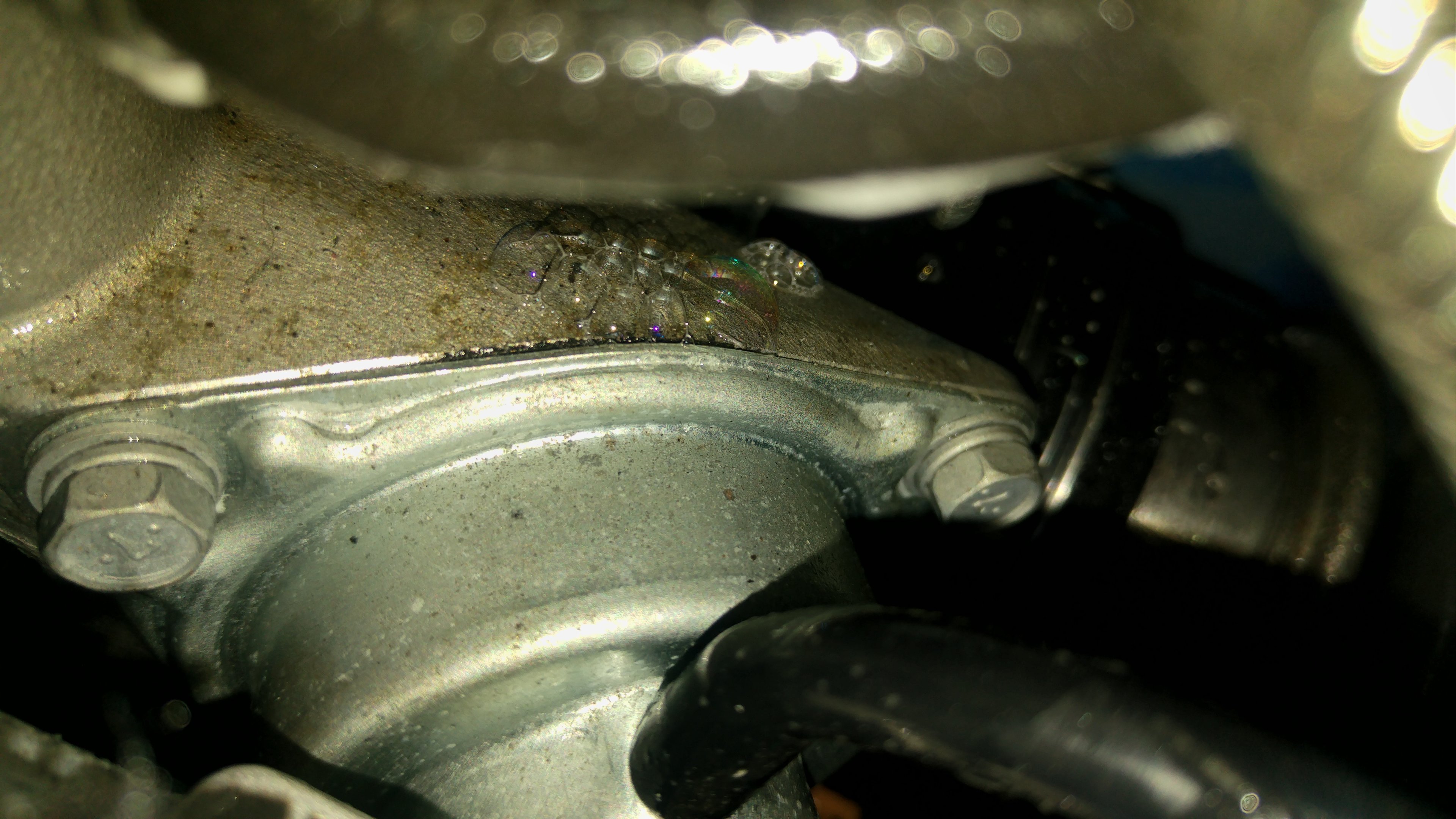

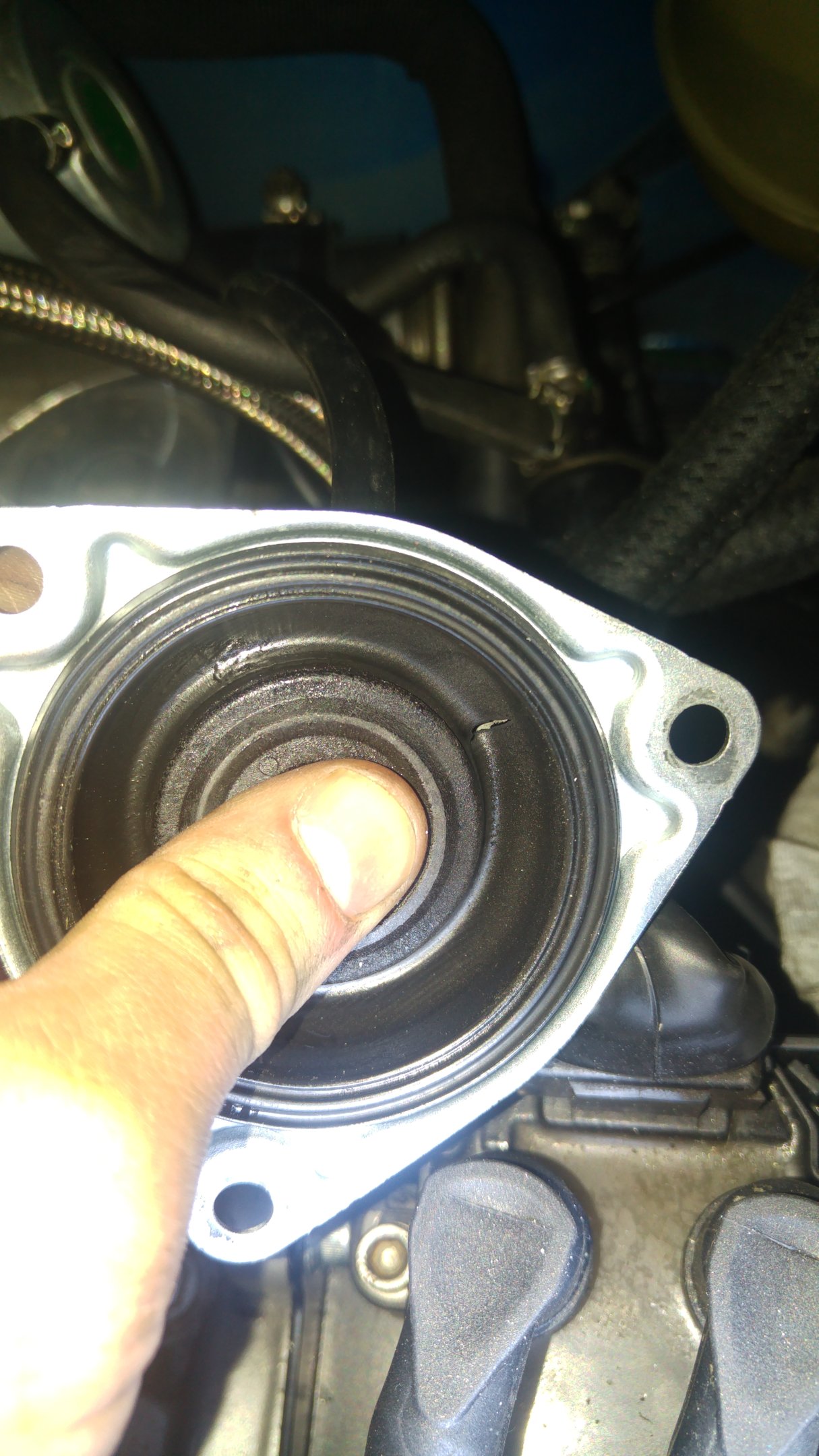

So, one thing that was irking me out was that christ at efi said that my engine wouldn't make as much power as he felt like there was a boost leak somewhere so... Boost leak checker in hand I tried it tonight and voila. Absolutely f**k loads of air coming out from the recirculation flange!! I thought maybe it's not tightened up so I tightened more but the leak was still there. Maybe the seal holding it on is fucked?
Nope. Turns out there's a bloody great big split in the diaphragm on it letting out all my boost. I'm so glad I tested it. So I've ordered a blanking plate as I have a dump valve anyway.
I'm genuinely wondering if that was causing me a loss of power as the hole is significantly big. It was pissing out after one pump of my foot pump.
dann2707

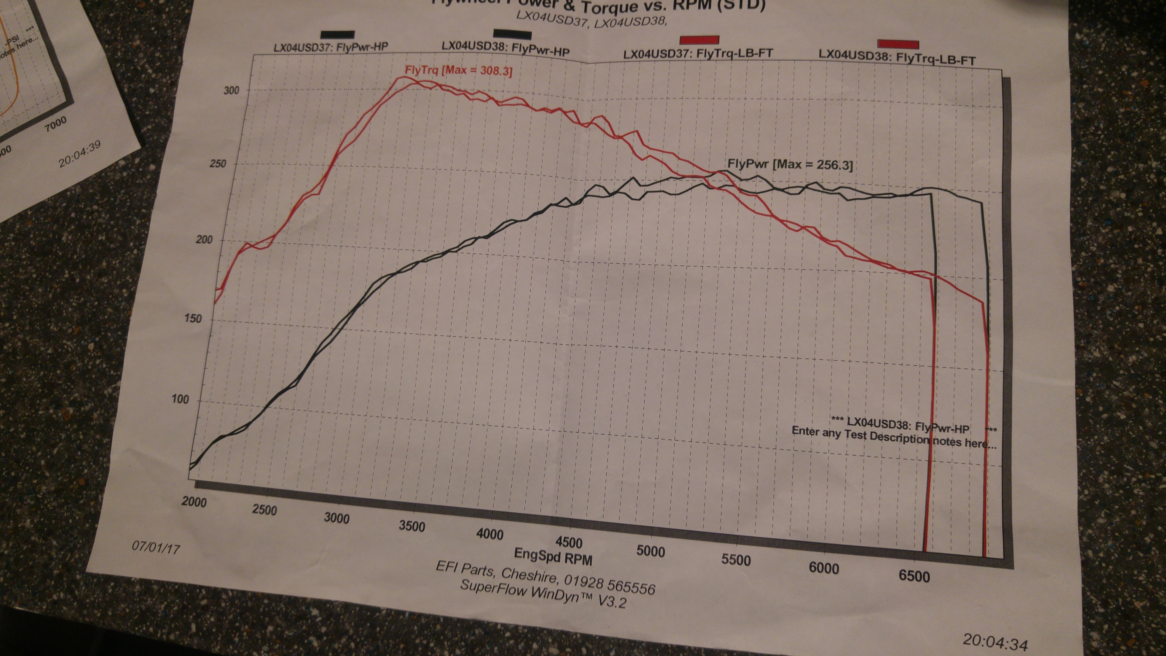

Torque is mega on that graph!
I'd expect it to be another 20-30bhp on top of that now the boost leak is fixed.
I really hope so, I guess it can only improve things now.
Got a ktr blanking plate on the way, I'd love to do a test with it before and after fitting this though to see how it's affecting the boost. I'm going to retain this part and something see if I can see how wide that hole is under pressure.
