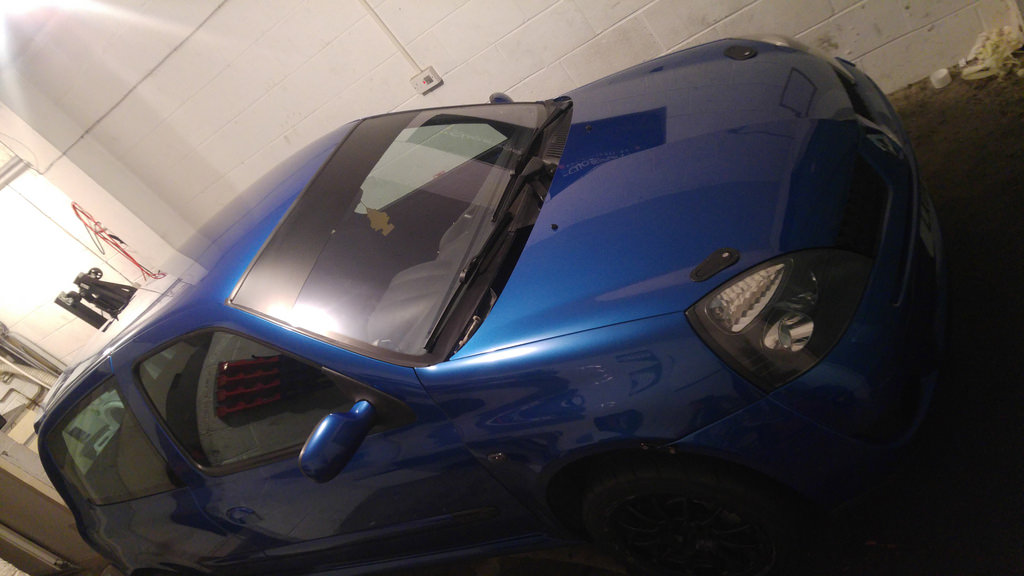

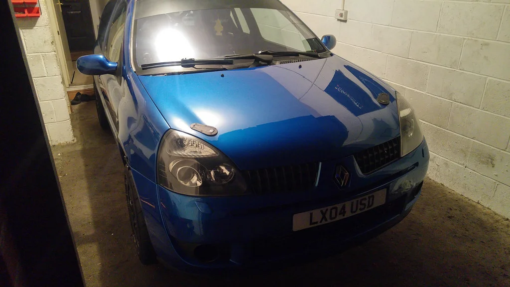

Daniels Blue 182.
Bumper is on which can only mean I feel like I'm close...
Fuel line arrived today so I neatly fed that to the return in the sender. All works fine. No lambda control though so it sounds absolutely horrible and obviously there's no exhaust.... Haha
Tomorrow I'll see if I've got time to give it a nice going on with the clay bar etc

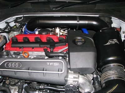

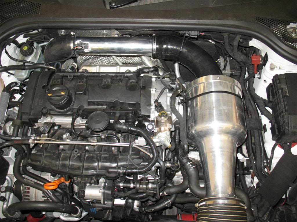

Not so much of an issue this time of year Dan, but I would look into an enclosed air box for the filter to keep summer intake temps as low as possible,
something like a ITG maxogen from a Audi TT.
Cheers for that Dave, I'll be sorting something like that luckily there's quite a lot of space in the bay. Where it's positioned now it's directly taking heat from the header tank so it certainly needs work.
Heatsoak isn't a major problem on boosted cars really, that's what the intercooler is for.
You'd be surprised at how much of a difference it makes. Had a similar experience at work last month where the unit that delivers same temp air to the intake was down and power significantly dropped up to a point where it was considered the engine wasn't deemed representative.

I think you're right really. Cooler intake air can help a little bit, but better gains are found by improving intercooling. Either better flow of cool air over the intercooler or a bigger intercooler. Water/meth cooling helps too.
Doesnt the air get sucked through the turbo anyway which is about a million degrees celsious?
Sorry if thats a load of bollox, its just what i would have thought why heat soak on a turbo car doesnt matter as much.
Essentially yeah, but the air only goes into the cold side and then straight into the intercooler.
For the power Dan's will be running, the intercooler shouldn't have a problem cooling the intake temps to the ideal temperature tbh.
I don't know if heatsoak is a major problem on boosted cars, but getting the air from outside the engine bay is definately worth putting some thought into. Because of the turbo under the bonnet, the underbonnet temperature is much higher than with a normal aspirated car.

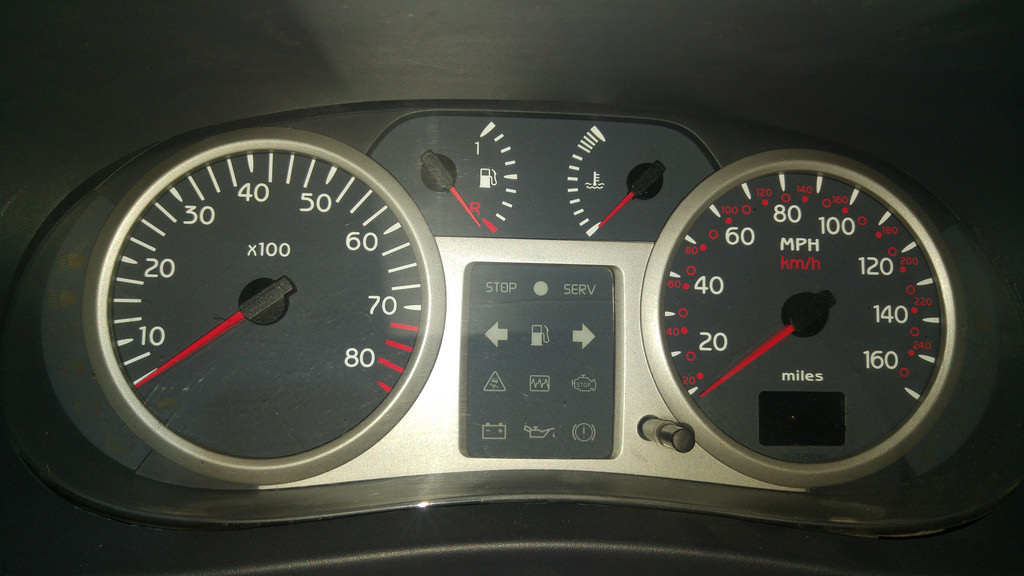

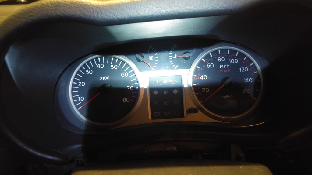

I had some issues with my fuel needle not displaying correctly as per the below picture:
20171126_144413 by dann2707, on Flickr
I remember going on the road trip and being massively disappointed with the rate the fuel needle was going down compared to my friends in their n/a clios but as it turns out my needle was just way off haha
Sorted that by removing the clocks and taking the needle off and putting it where it should be..
Nice easy fix.

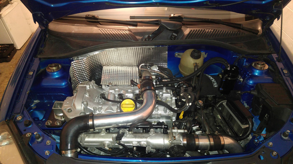

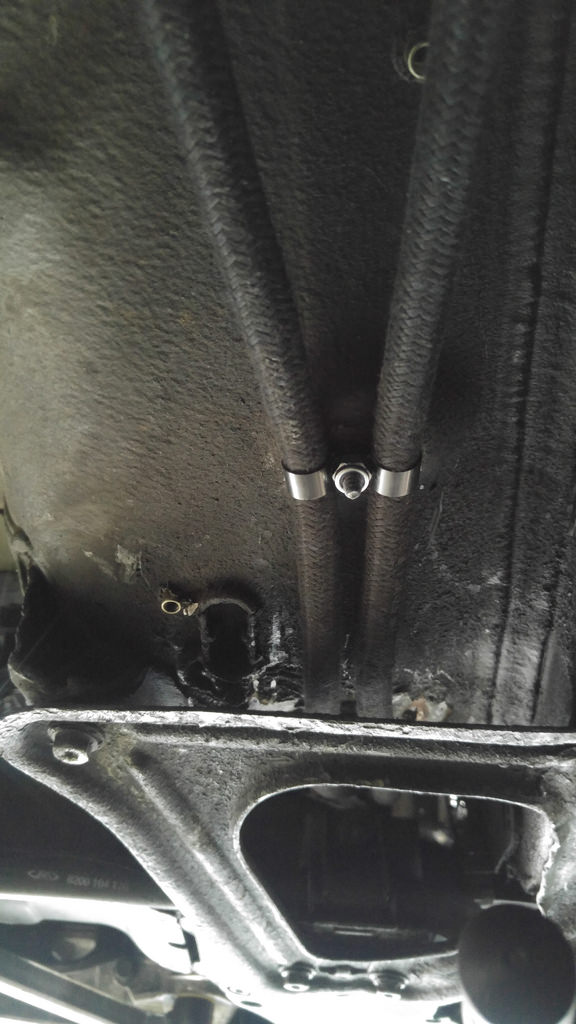

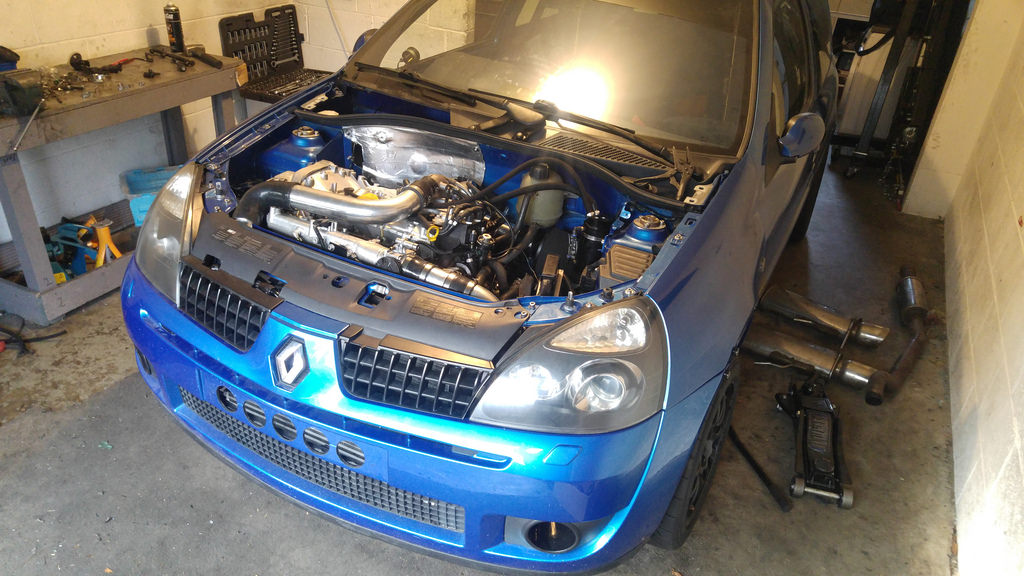

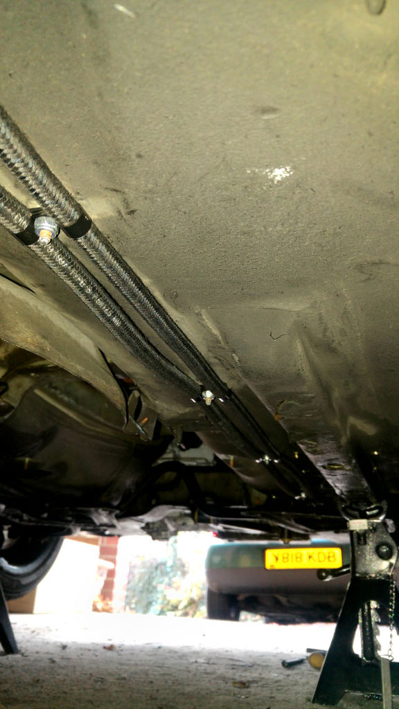

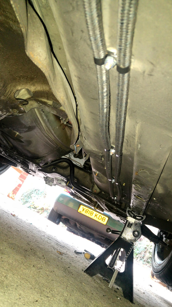

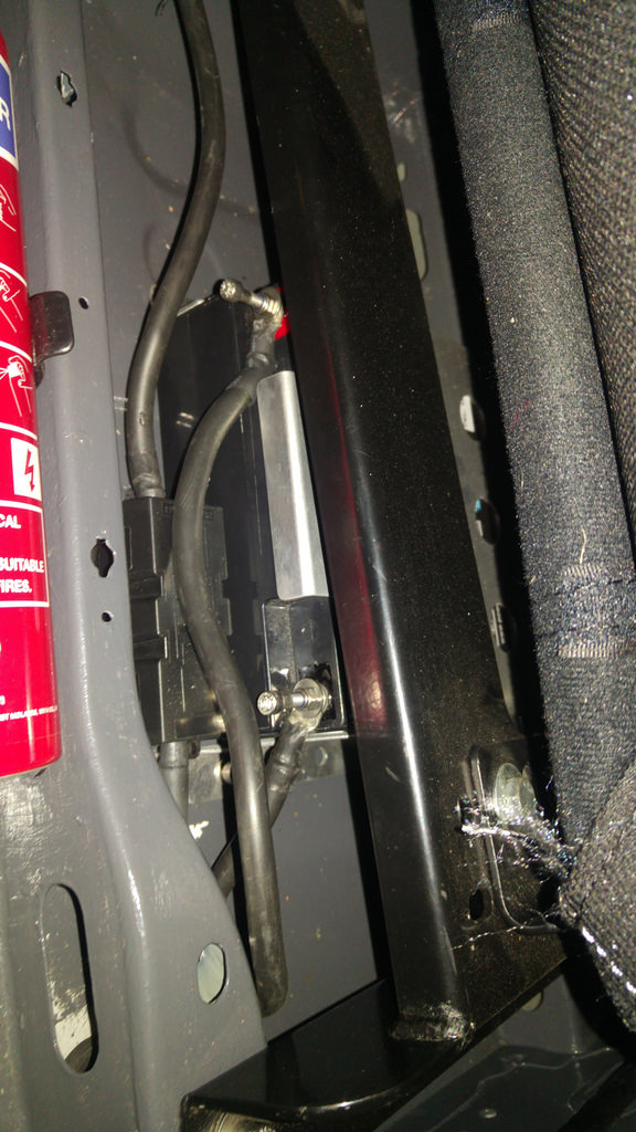

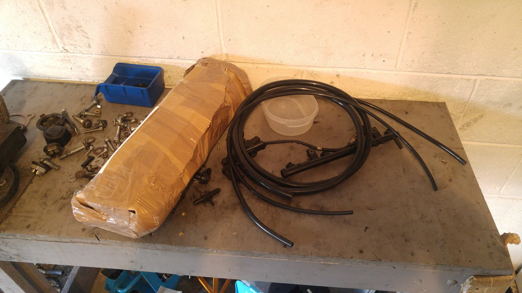

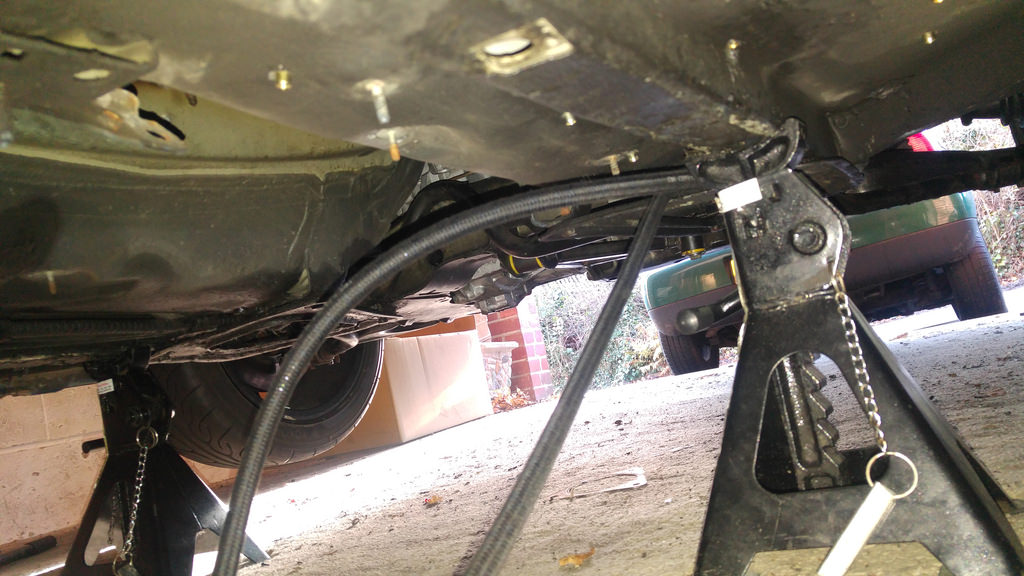

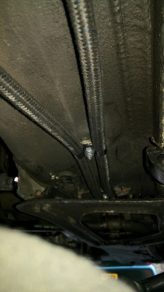

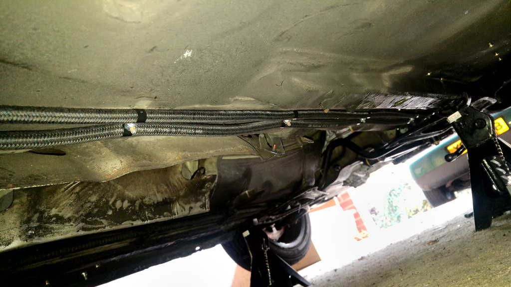

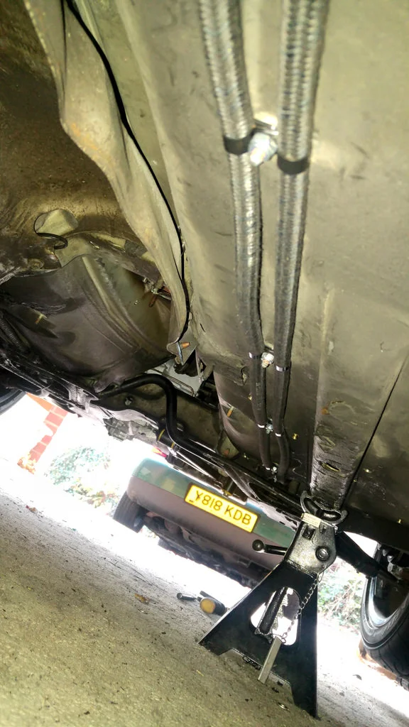

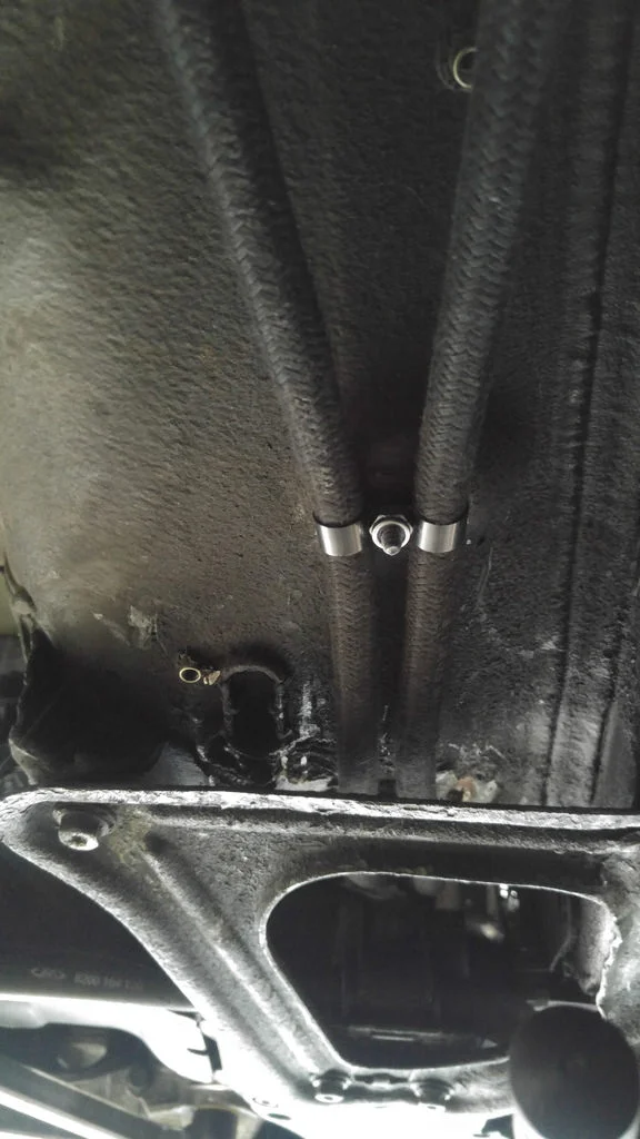

So the past few days has had me re-routing the fuel lines which I never put on here. I've used some black P-clips to route the lines as neatly as possible. The original fuel line clips were too small so didn't allow this fuel line to be clipped in.
Before
20171128_123933 by dann2707, on Flickr
Afters
20171128_124925 by dann2707, on Flickr
20171128_124945 by dann2707, on Flickr
20171128_130522 by dann2707, on Flickr
20171128_130529 by dann2707, on Flickr
20171128_130536 by dann2707, on Flickr

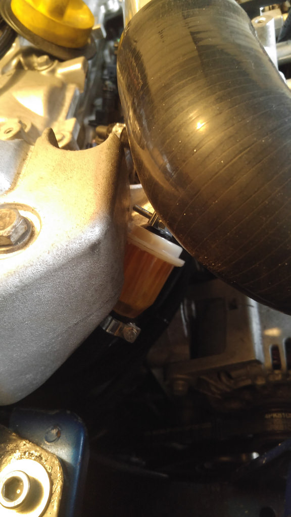

Fitted a fuel filter too as that arrived. Nice and neat behind the boost pipe.
20171128_141633 by dann2707, on Flickr

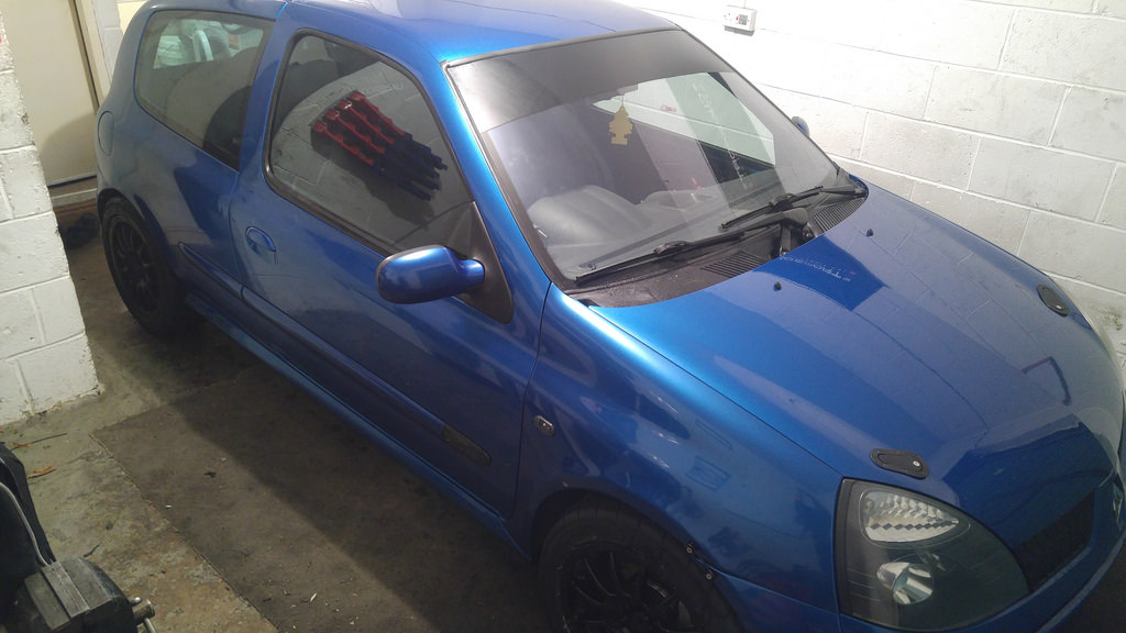

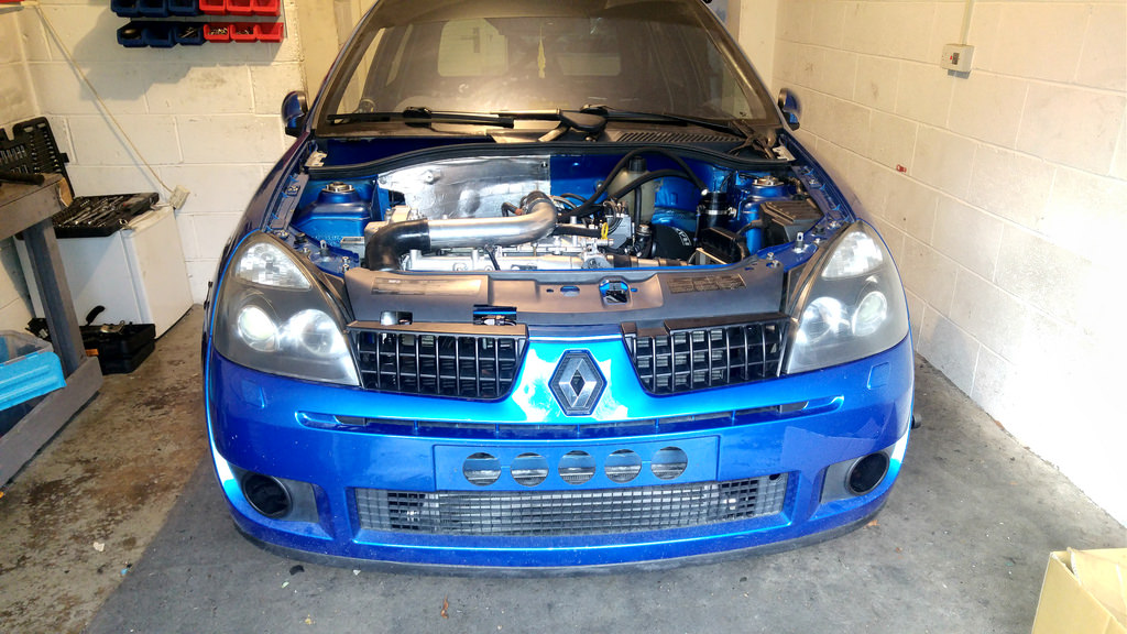

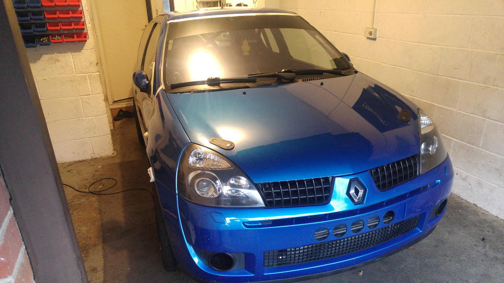

I was then ready to put the bumper back on which is always a good sign
20171128_141506 by dann2707, on Flickr
20171128_141656 by dann2707, on Flickr
20171128_144522 by dann2707, on Flickr
Then on to today, I received some goodies in the form of vacuum lines for the FPR and for the brake servo. Along with something shiny....

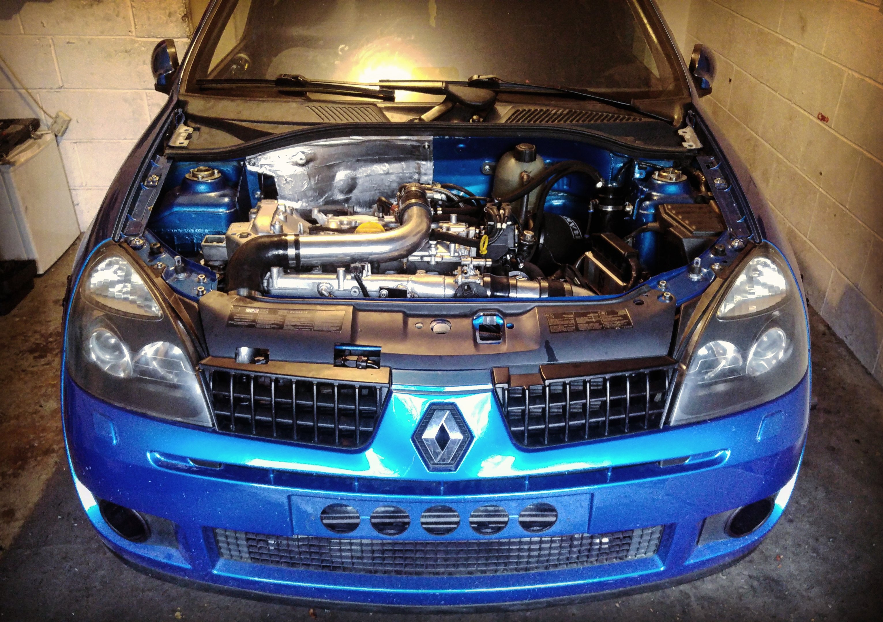

I then started mocking up where the Nimbus is going
20171129_144906 by dann2707, on Flickr
A few bends later
20171129_153536 by dann2707, on Flickr
Needs properly fixing in place but you get the idea of where its going and what it's protecting.
20171129_154259 by dann2707, on Flickr
20171129_154304 by dann2707, on Flickr
I already have an idea of what i'm going to do with the smaller bit and it involves making a heat shield for the turbo as there are loads of bolt holes around it where the original heatshield used to be on the meg engine
Suffice to say I genuinely think it looks f**king ace back there and really makes the engine bay a bit nicer!

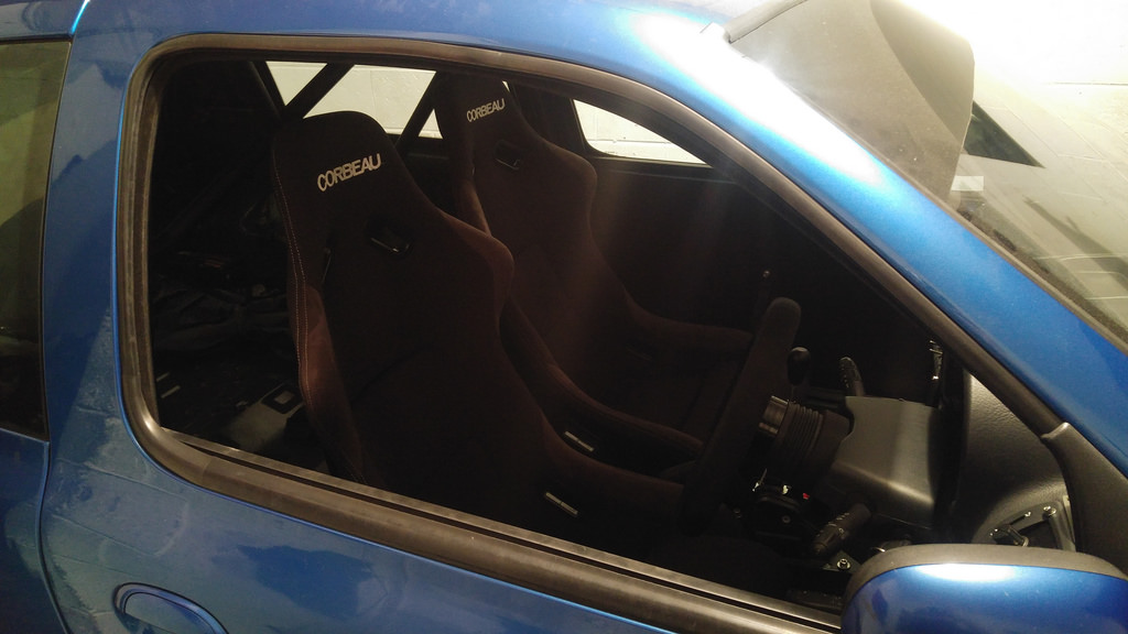

I then got the seats back in, easy peasy.
20171129_164717 by dann2707, on Flickr

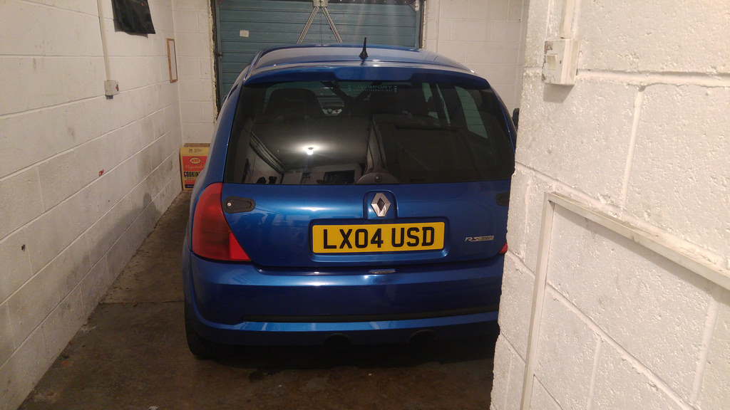

I sat in the car feeling pretty accomplished with the work this week knowing that I am 1000000000000000% happier with the new OEM pedal box, servo assisted brakes etc etc which was always on the back of my mind that the pedal box I had in there before just didn't feel that great for a 80/20 road/track car.

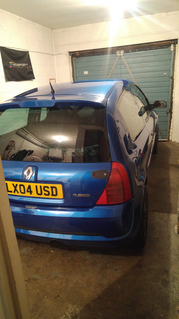

Tomorrow if I get time i'll wheel it out of the garage, give it a wash and wheel it back in ready for claying and detailing it in the garage over the period of a few weeks. I want to get it as shiny as it used to be as I was looking through some old photos recently and it used to be crazy clean.

Thank you. Yeah that's pretty much it now, drove it out of the garage today and it feels amazing to be sat in him properly again. So excited. I would 100% never ever do this conversion again. It's just not worth it with it being not plug and play. It's been a fun journey, I've learnt a lot of skills along the way. Made some new friends through it too which is always a plus.

Looks good, how comes you've fitted a fuel return pipe now or am I missing something. Not read the whole thread tbh.
I know you had driveshaft issues so I thought that was all that needed sorting.
Thanks Scott, the whole point why it was off the road was because the gearbox failed so I fitted a new one and whilst it was out I changed the aftermarket non servo pedal box to one from a kangoo which uses a hydraulic clutch so it works with the Megane gearbox.
Then whilst it was off the road I took it upon me to change the fuel set up as you may have heard about the Megane cylinder 1 issue? Essentially as the megs don't run a return rail system the fuel pressure is inadequate when the car is mapped or pushing more power than standard as they're currently an in sender Fpr which is no go really. So now it's return which should prevent thst issue from happening.

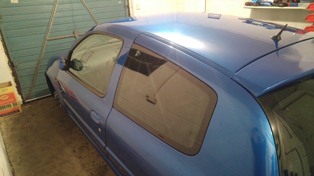

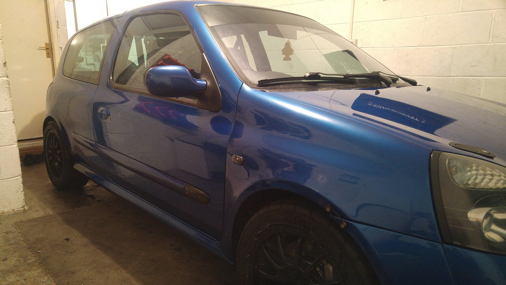

Last week I did some claying...
I haven't polished anything yet as I really want to get a DA and do it properly. I can't justify spending all that money on one though.
Anyway Boris looks shiny now pre-polishing

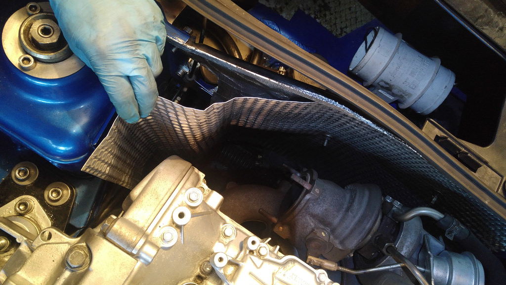

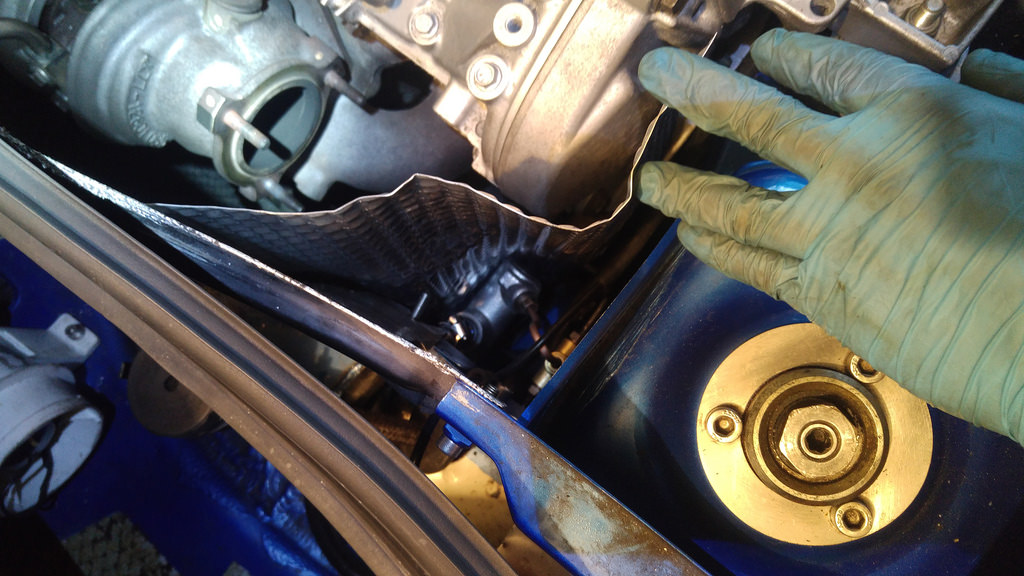

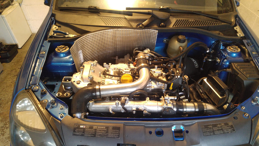

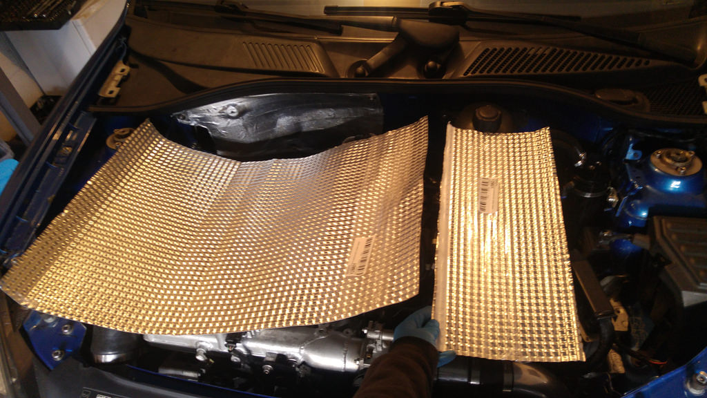

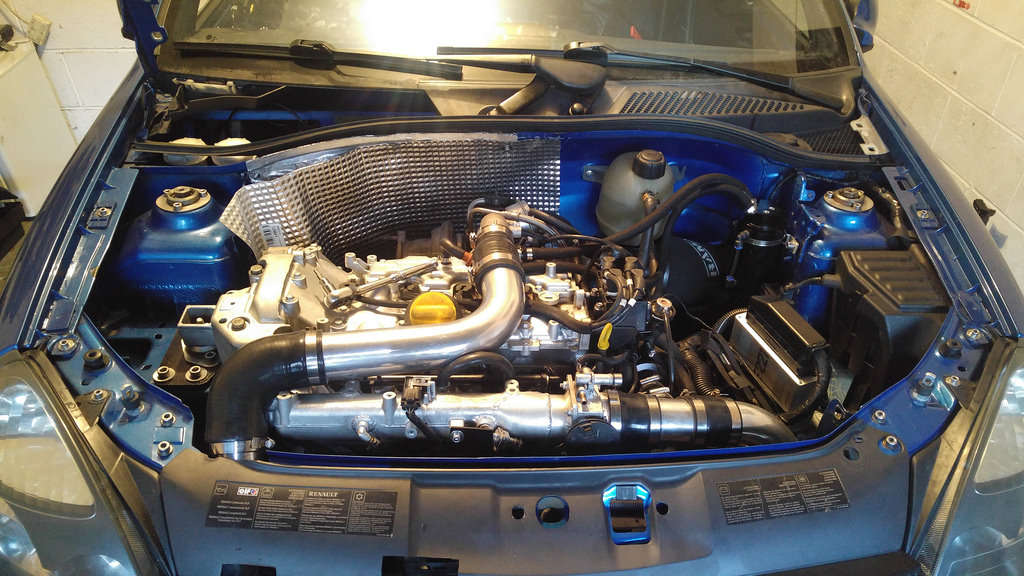

Then tonight i've secured my heatshield at the back properly and also used the smaller excess I had to create the ultimate turbo coverer upper aka turbo heatshield. Looks a bit blingy now but it's doing a job and i'm mega happy with it.
No flash
20171209_185254 by dann2707, on Flickr
Flash
20171209_191113 by dann2707, on Flickr

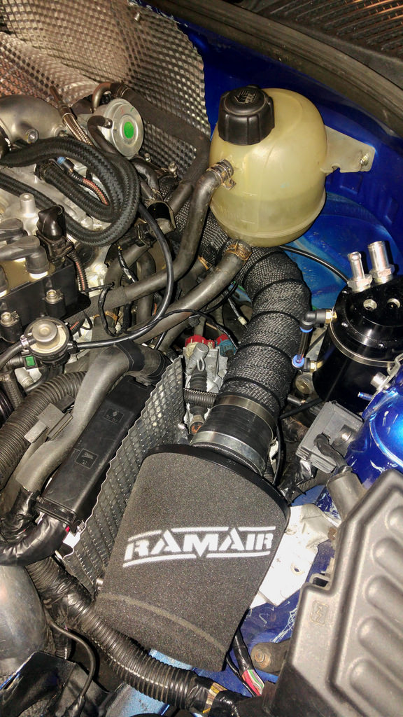

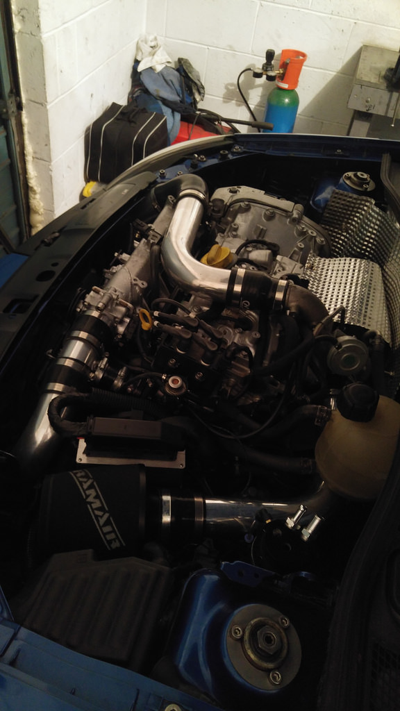

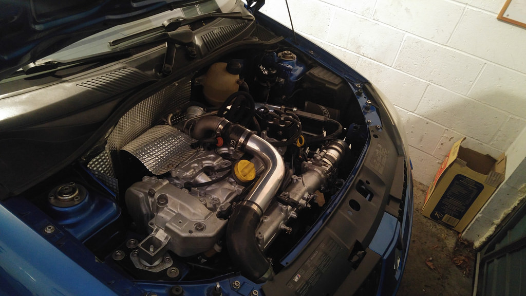

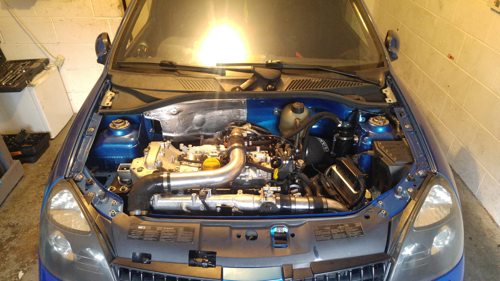

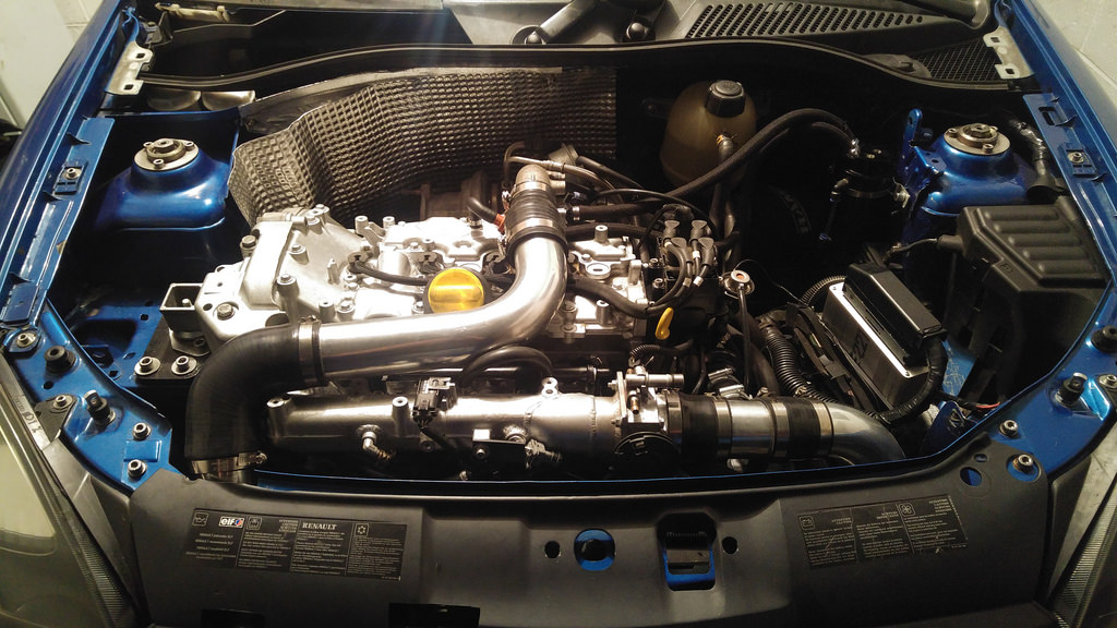

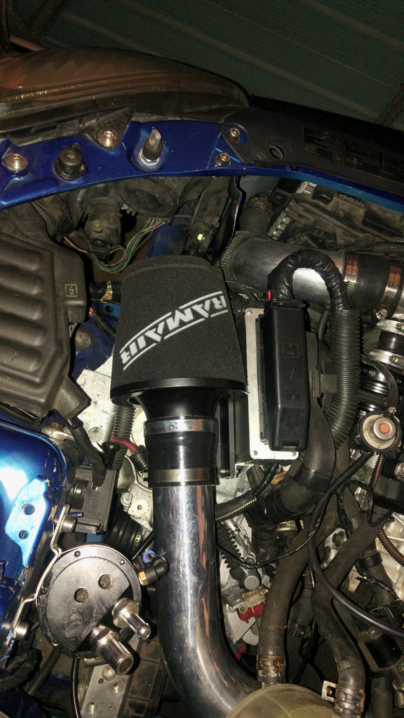

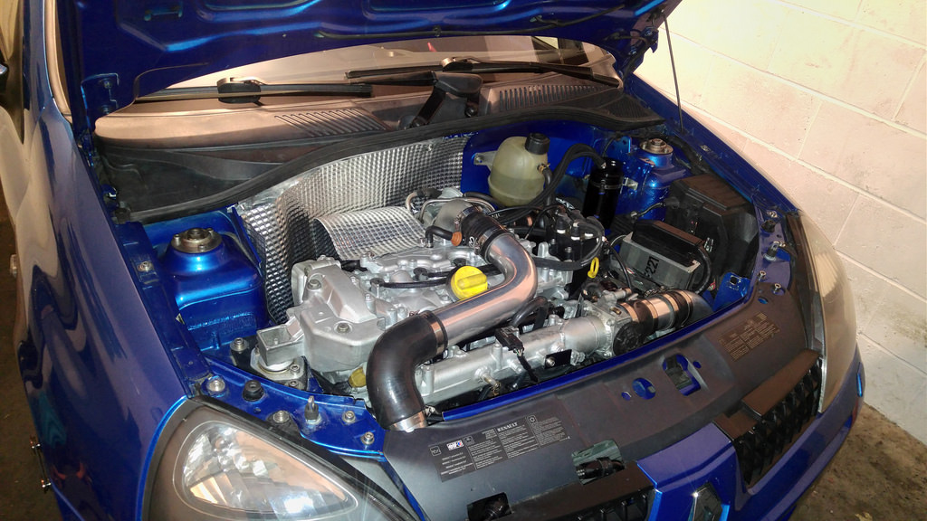

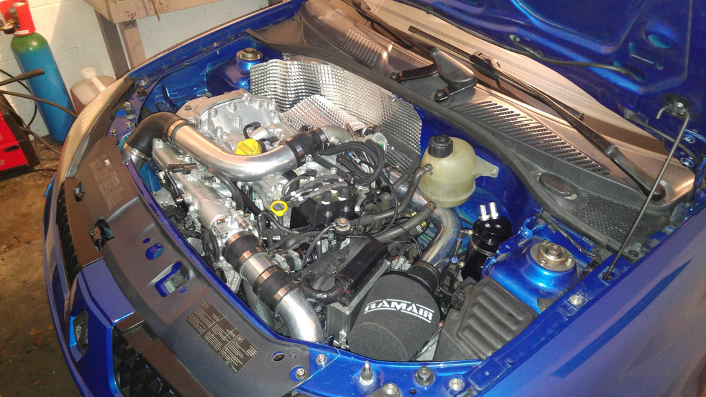

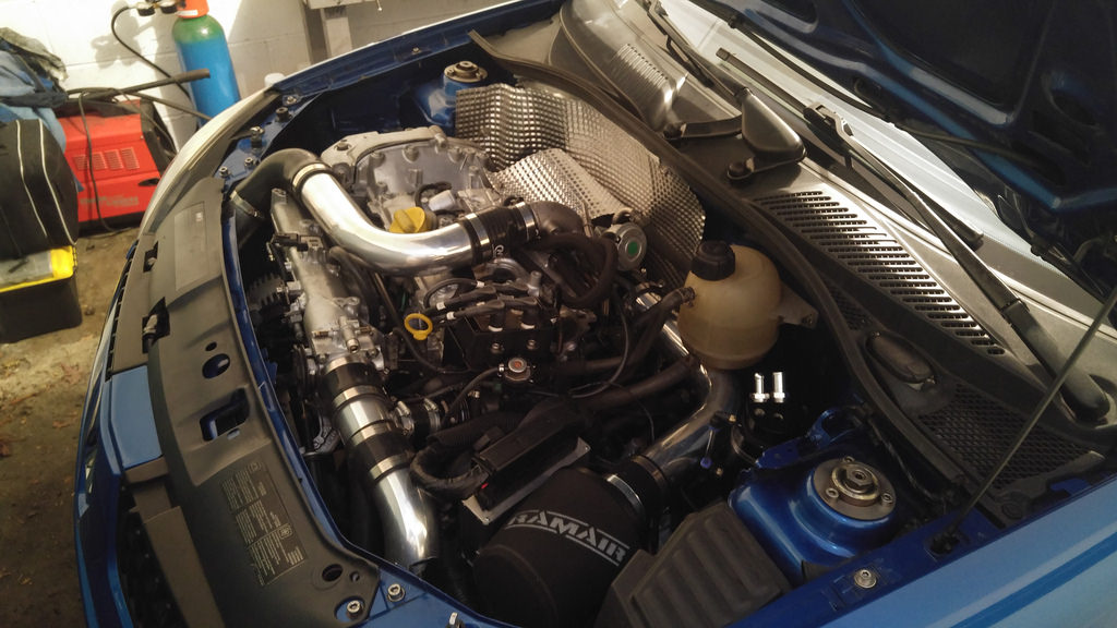

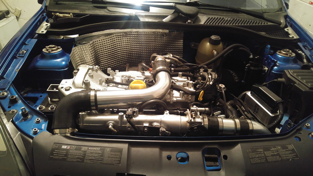

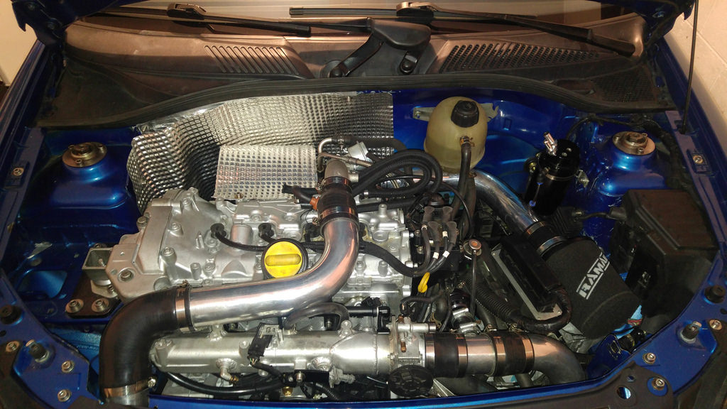

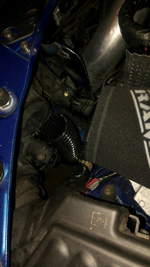

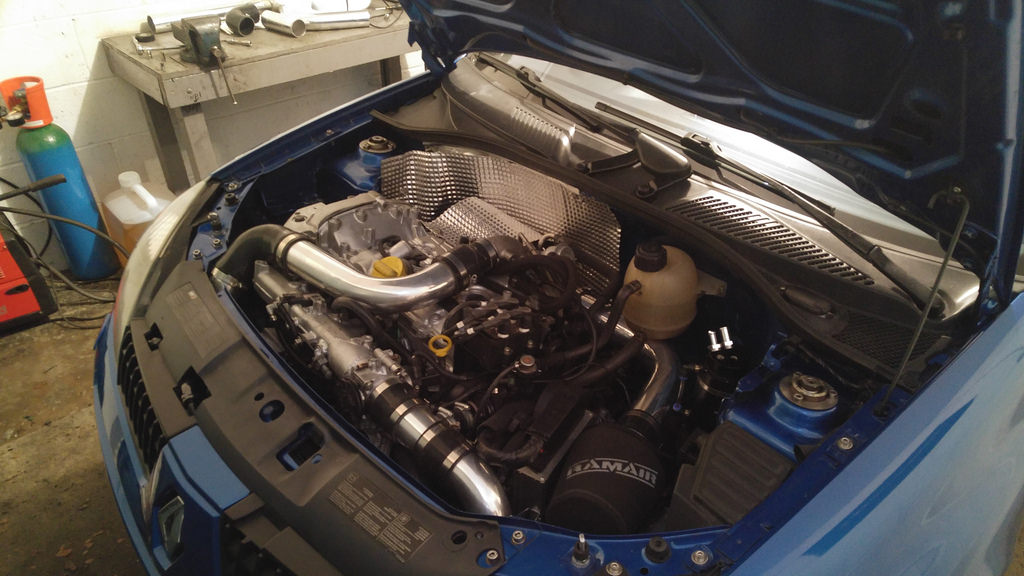

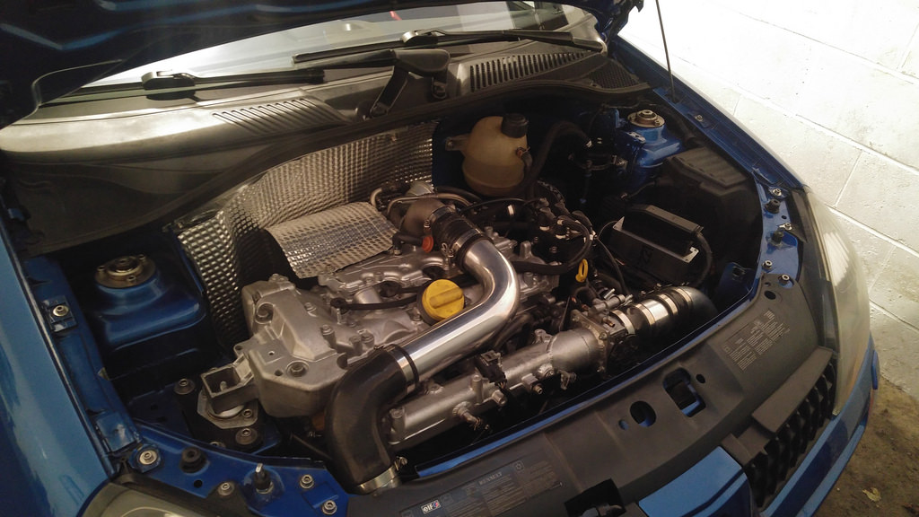

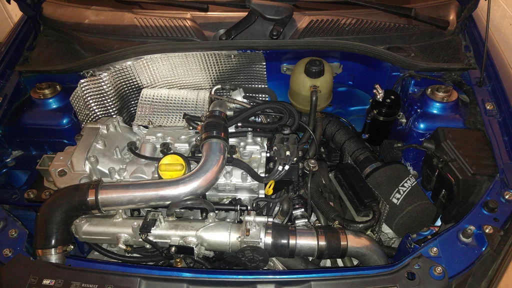

Then after listening to @bashracing 's advice I spontaneously decided to move the air filter. Can't stress how much happier I am with where it is now. Especially as I can happily run an air feed from the fog light duct up there now.
Before (its sucking up alllllllllllllllllllllllll the heat from the oil catch can and the coolant header overflow)
20171209_191125 by dann2707, on Flickr
After, had to move the ecu by flipping it over on it's bracket. No biggy
20171209_200336 by dann2707, on Flickr

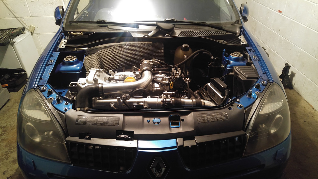

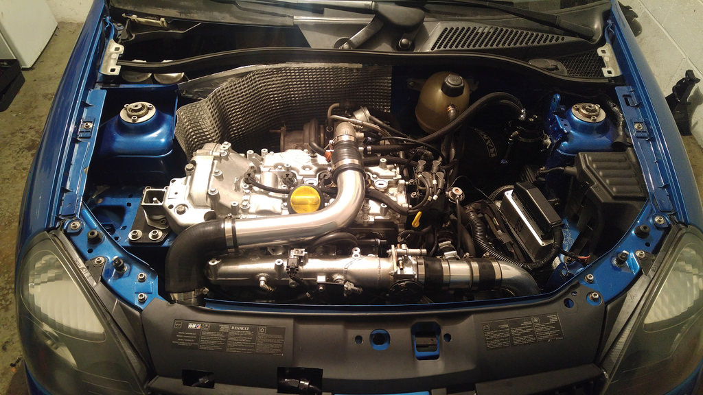

Then heres an absolute tornado of pics cos I think it looks super sexy now haha
The coolant bottle is on loan from @Akay (cheers again mate) that i'm using to flush out old rusty coolant then I will fit my fresh new bottle with green alien jizz.
20171209_200357 by dann2707, on Flickr
20171209_200406 by dann2707, on Flickr
20171209_200457 by dann2707, on Flickr
20171209_200526 by dann2707, on Flickr
20171209_200552 by dann2707, on Flickr
20171209_201412 by dann2707, on Flickr
It's also worth noting that next year i'll have had Boris for 4 years which is absolutely mental. I've never held on to a car for that long ever, what a journey it's been. Here's some pictures from when I first got him...

Another small update from today..

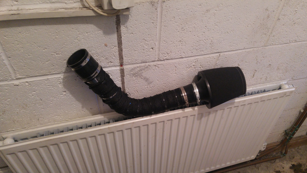

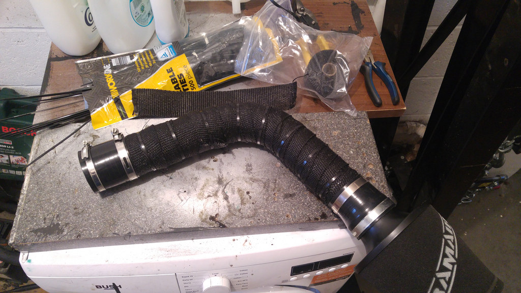

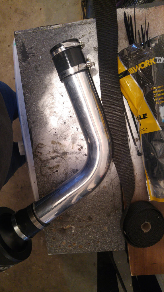

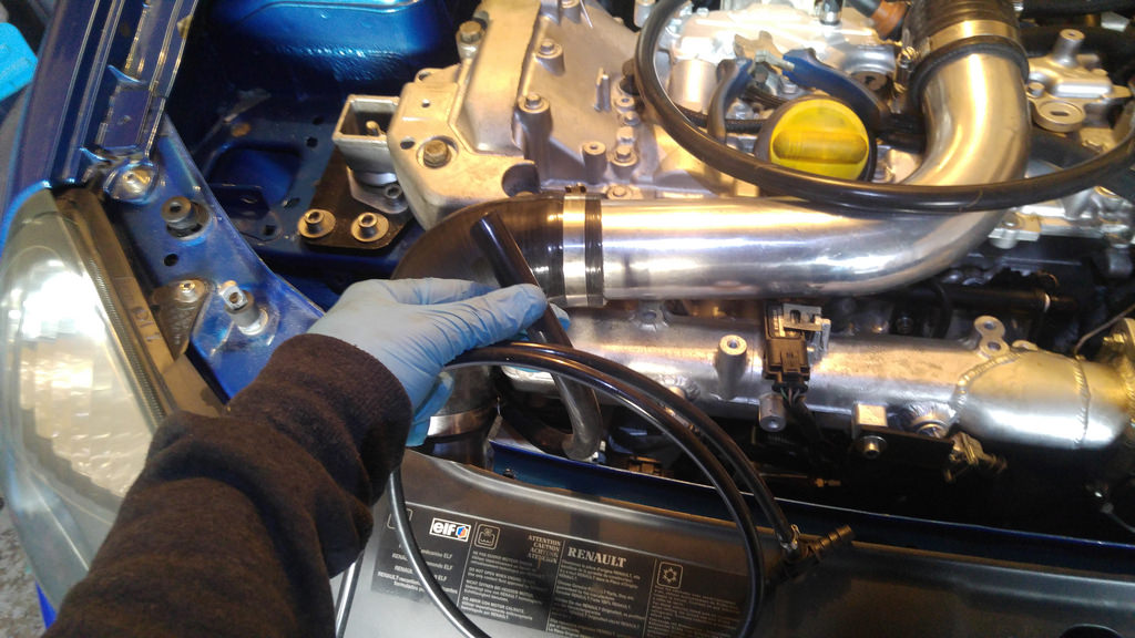

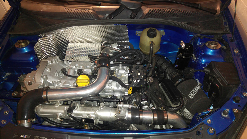

I removed the intake pipe as I wanted to insulate it with some heat wrap I had, due to the header tank and catch can still resting fairly close to it.
20171210_141213 by dann2707, on Flickr
Then all wrapped and secured. Easiest way to do this is to apply it wet then when it dries it nicely tightens against the pipe.
20171210_142610 by dann2707, on Flickr
20171210_143345 by dann2707, on Flickr

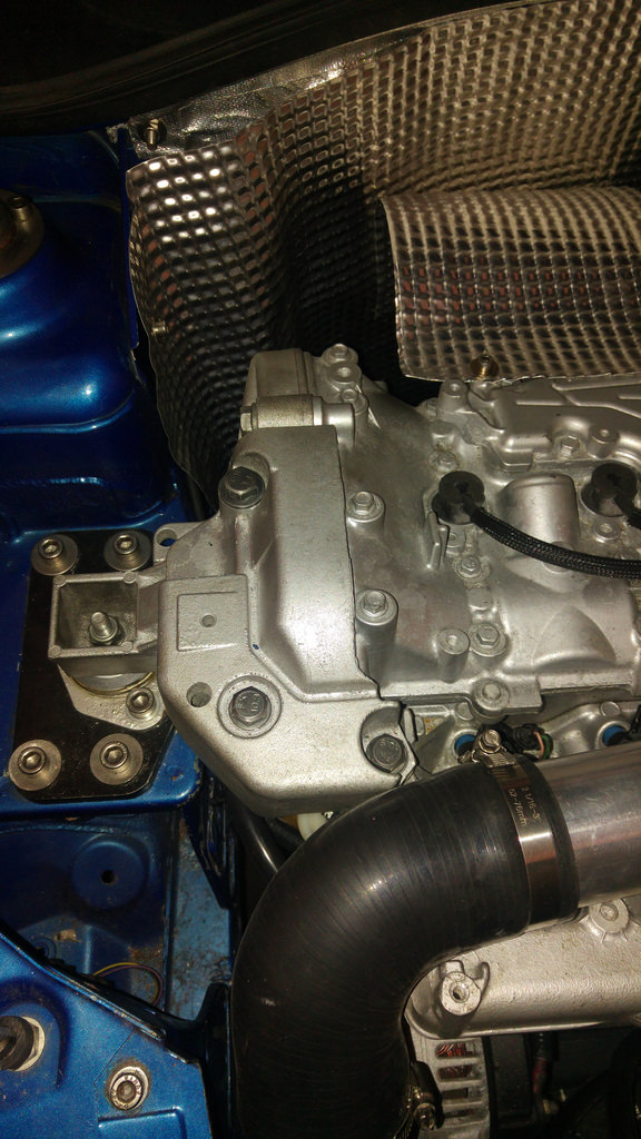

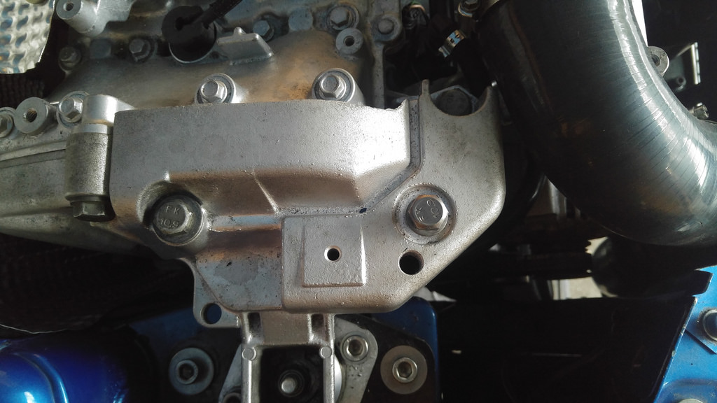

My engine mount bolts always looked a bit manky so I wanted to clean them up a bit with the wire wool attachment on the drill...
Before:
20171210_143357 by dann2707, on Flickr
After on the right
20171210_143403 by dann2707, on Flickr
Done
20171210_160544 by dann2707, on Flickr

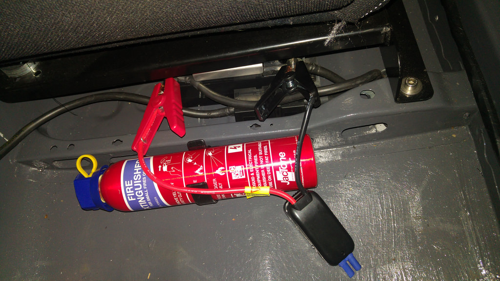

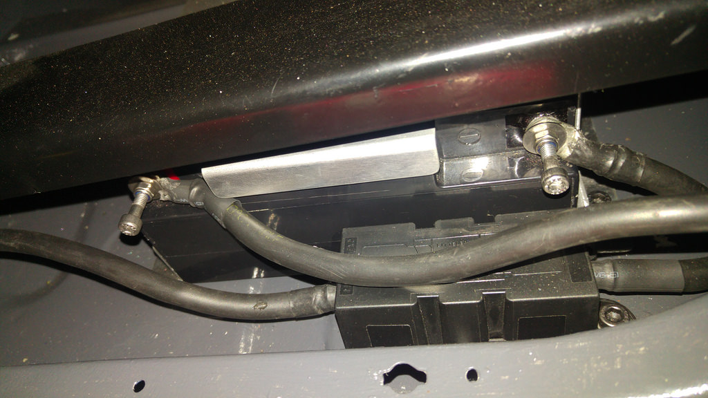

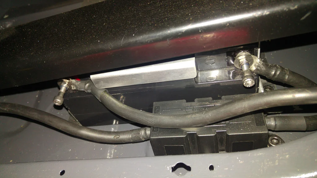

Another little job that was on my mind, when I had to jump start the car before the jump leads wouldn't clip onto the battery terminals as it was such a small little m5 bolt head so I made an extension using a longer m5 bolt as below:
20171210_151807 by dann2707, on Flickr
20171210_151812 by dann2707, on Flickr
Now it clips on and stays on
20171210_151853 by dann2707, on Flickr
Whilst I was doing that the heatwrap had dried so refitted it into the engine bay and also used the last bit of nimbus I had to act as a guard to the left of the filter. It probably won't do much but every little helps.
20171210_160446 by dann2707, on Flickr
20171210_160457 by dann2707, on Flickr

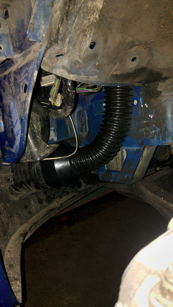

I've also connected one of my foglight ducts up to act as an air feed to the filter.
20171210_160507 by dann2707, on Flickr

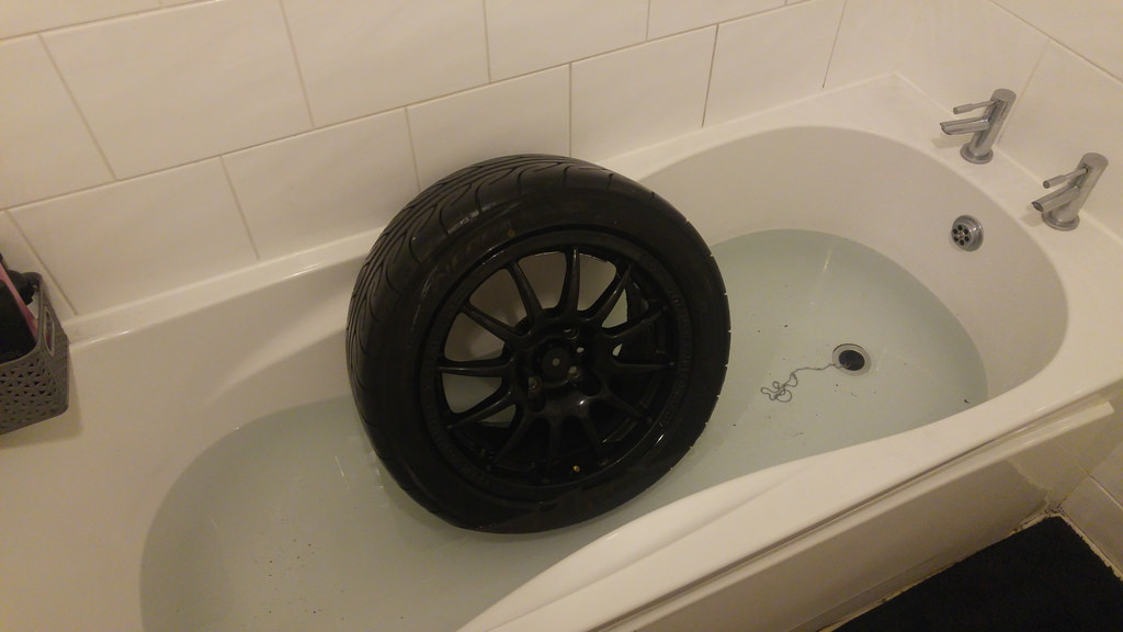

I finally took one of my wheels to the bathroom to locate a slow puncture, turns out the valve is leaking every so slightly where it's seated against the rim. The below method, as expected, works very well!
View attachment 134855820171210_141213 by dann2707, on Flickr
View attachment 134855920171210_142610 by dann2707, on Flickr
View attachment 134856020171210_143345 by dann2707, on Flickr

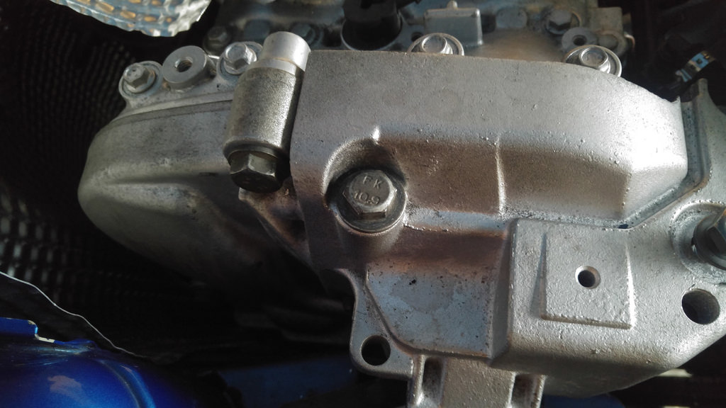

Before:
View attachment 134856120171210_143357 by dann2707, on Flickr
After on the right
View attachment 134856220171210_143403 by dann2707, on Flickr
Done
View attachment 134856320171210_160544 by dann2707, on Flickr
View attachment 134856420171210_151807 by dann2707, on Flickr
View attachment 134856520171210_151812 by dann2707, on Flickr
View attachment 134856620171210_151853 by dann2707, on Flickr
View attachment 134856720171210_160446 by dann2707, on Flickr
View attachment 134856820171210_160457 by dann2707, on Flickr
View attachment 134856920171210_160507 by dann2707, on Flickr
Desperately needs a clean under the arch haha
View attachment 134857020171210_160526 by dann2707, on Flickr

Great update mate, it's good to see you're back positive and making good progress.
Only point, id try to find a suitable plastic cover for those protruding battery terminals? It just looks a bit easy to accidentally bridge them at point point with those bits sticking out like that.. then you'll need that fire extinguisher!
Awesome work Dan. Glad you kept with it. Make sure you insulate/cover those battery terminals [emoji106]
Thanks Rob mate :) yeah I was thinking of getting some rubber bungs or something to go over them, should be easy to source something that's easily removable when the time may come to it. Cheers for the heads up though, it's appreciated.
Nice work Dan, looks good mate.

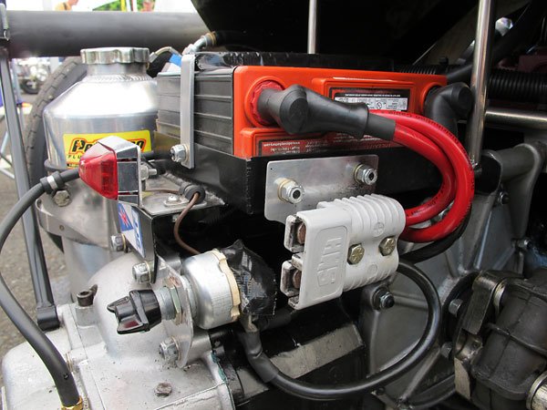

Re battery, if it was me then I'd look at fitting an Anderson plug set up mate, much safer.
I would hate for anything to happen and all of your hard work go up into flames.
We had them fitted to our race cars and fixed to the inner part of the side sill, all you had to do if you had a flat battery was to open the door and plug the other half in.
I like your battery mod for jumping it. As the battery in my E34 is under the back seat there is a positive terminal under a flap under the bonnet then just use a bolt for the negative. Might have to do what you’ve done as the top mount bolts are tiny to get a good grip on it.
Also a right faff as the bonnet opens the other way and you can’t get a second car nose up to it easy to get around the bonnet.

So i've finally machine polished Boris. Really happy with the results, I only gave it a heavy cut on a medium pad and didn't go around everywhere with the super finishing stuff from mezermemeeme as honestly it bored the absolute tits off me. But the results look good none the less I think.
I need to go over the black trim tomorrow, and put a few coats of wax on too.

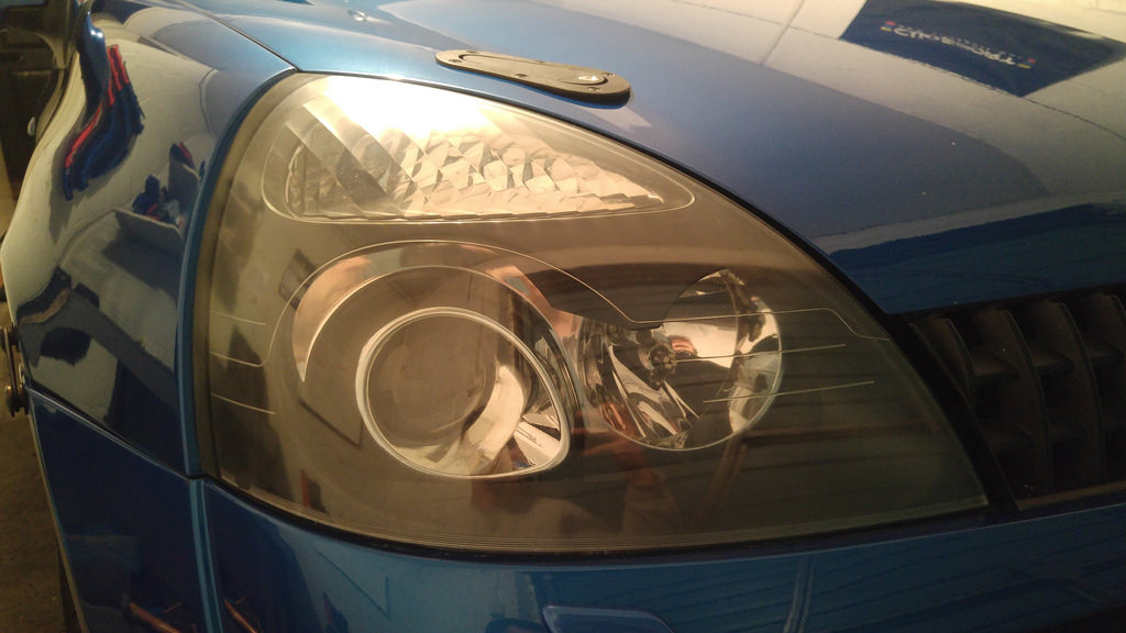

Headlights look clear again, i've ordered some clear film wrap stuff to go over it so they don't fade again.
20171231_165947 by dann2707, on Flickr
