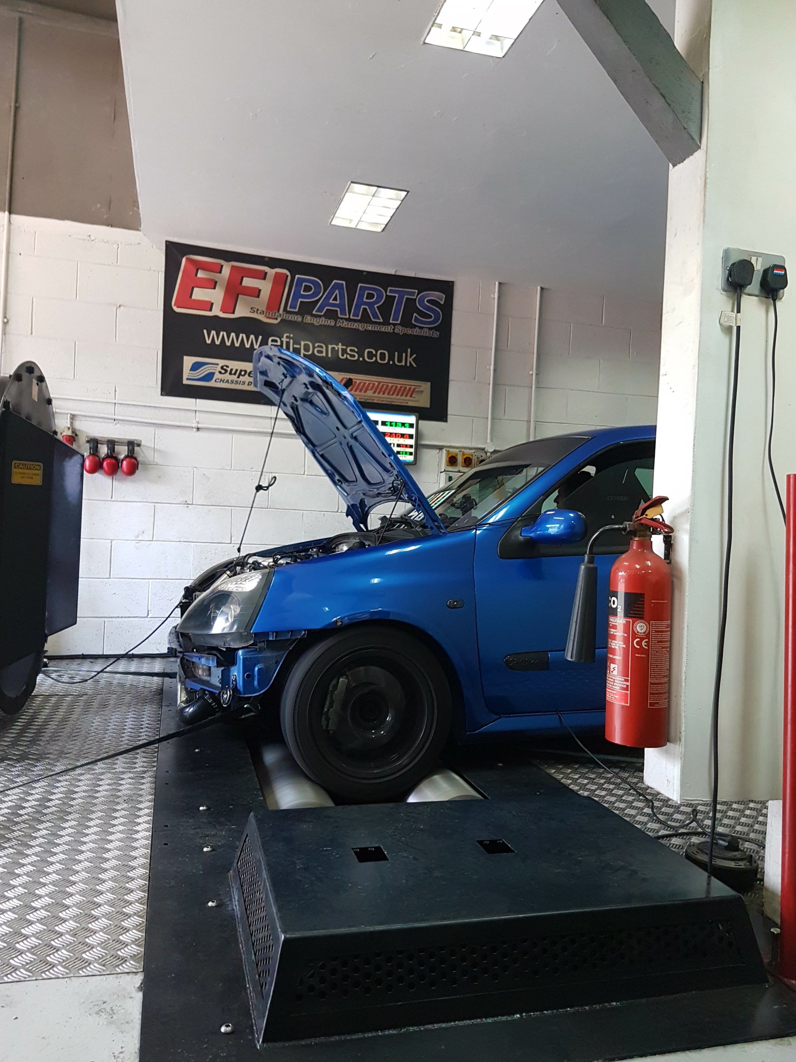

Well, what a crazy day.
I'm taking nominations for the fastest radiator swap known to man. Had it off in about 4 minutes flat.
I got to efi and noticed my coolant had dropped a fair bit and thought maybe it's just the system balancing out as I hadn't driven it for ages. Turns out the radiator had split in like 3 places?! Never seen a failure mode like that before. No signs of stone chips or anything. Looks like potentially high pressure has caused it to split? It's a new ish unit too last year bought etc.
Anyway so with the massive help of my friends they managed to source one at a gsf in Manchester and as @leeds2592 was coming to meet me in his volvo I asked him to collect it for me.
Seriously can't thank you enough for doing that mate, if you hadn't have done that this whole day would have been wasted so cheers man :) owe you a beer or 9 at the beer festival.
So the car went on after swapping the radiator again in the fastest time ever.
Unfortunately there's an issue with boost control, its like the N75 is on the blink and only controlling when it wants. It's either that or the ecu that's at fault. I seriously hope its the former.
So in the end we couldn't make full power sadly, it's pushing a 228/225 I think. This is because Chris has mapped it just on open waste gate so it's essentially a low boost clio.
I'm getting an N75 valve to change over then got a test to do to see if it is that.
