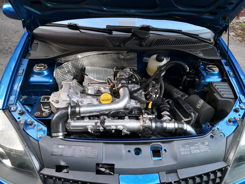

Switchable maps would be awesome, that’s what I’ll be doing when i forge mine! I’d hate to go mental power and loose the amazing 250/240 map I have now, it’s a fantastic balance without causing it to be unsettled and too much of a handful... saying that there are a lot of places on the uphill sections of the ring where I’d like to be hitting the Rev limiter in 5th! (Another reason I envy your 6th gear [emoji23][emoji23])
I have to agree mate, 300 would be brutal and at that point where you're wondering what's going to fail next.
But on the contrary it's all set up for it now so it would be rude not to.
May look into seeing if I can get switchable maps on the ecu.
No it's an open diff from the meg.
Need to get an R26 box or stick a Quaife in that bad boy.
Even mine on standard power it transforms the car.
Could you not setup boost by gear with your ECU? That way then you get the best of both worlds and don’t have to switch maps by toggling through a boost controller etc
Ahh that's no where near a replacement for switchable maps is it lol. I'm not going to want to go on a track day in 3rd gear am I when it's wet lol. I'd want a switchable map so that it limits power as I'm going through the gears.
It is on a standalone mate, me221
Yeah basically ^
Like you can set it to 15pounds on 1st gear, 2nd at 20 psi etc etc
Just so you’re not lighting up the tyres in the first 2/3 years and that the car is gonna go like s**t off a stick without banging 25 psi into it straight away

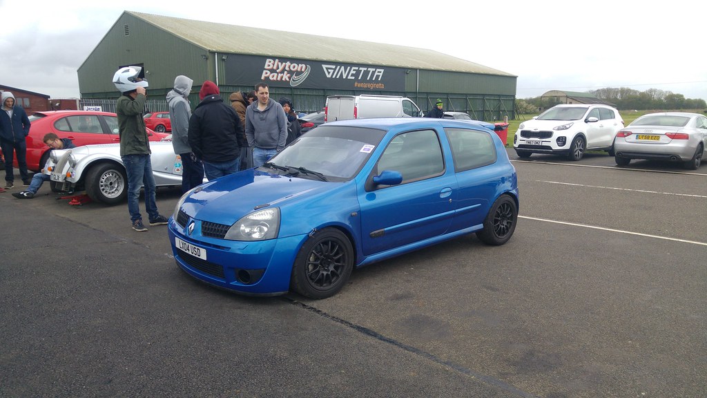

My god I love this car!! Hahaha went for a blast to fill up fuel for Blyton tomorrow and check the camera height. Think it's in a decent position thank you Mr roll cage for the support.
Should hopefully get some decent footage tomorrow all being well.

Unbelievable day.
Car performed amazingly well, I boiled my fluid many times and I definitely need new driveshafts due to it still bottoming out slightly but other than that the car performed flawlessly.
I got through a full tank which involved me driving there and back 160 miles so not too bad I guess. I have just got home and got one hell of a smile on my face. The power was just right for the conditions today, the weather was weak in places and managed a few slides but hell I absolutely loved it.

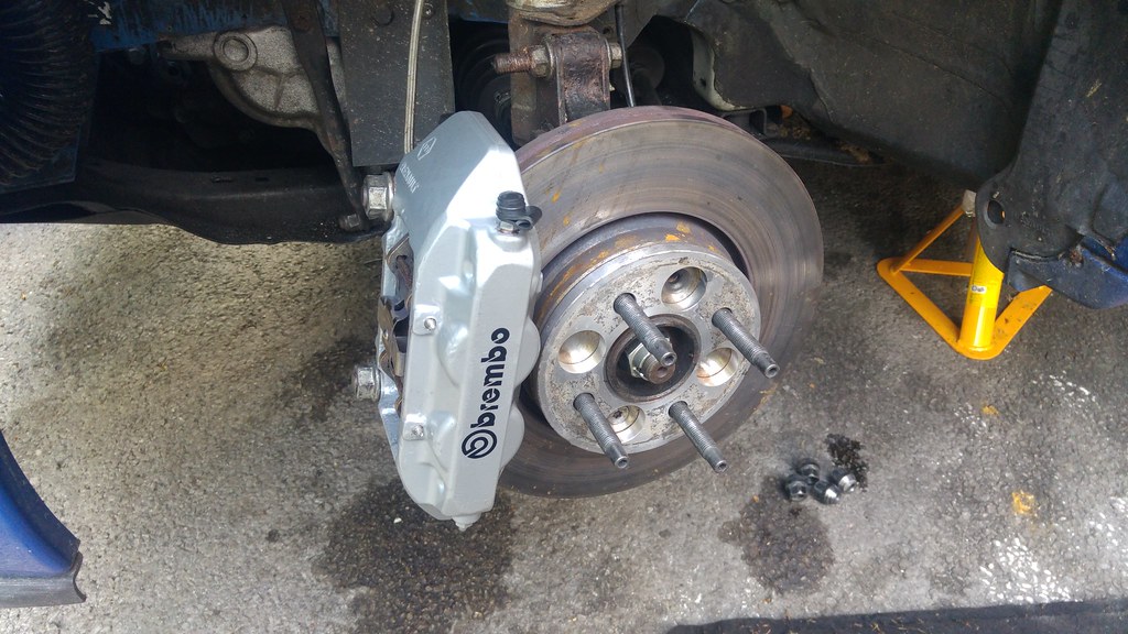

I've removed the brembos and they are currently at a powder coaters near me. They're shot blasting and powder coating for £30 all in :o I looked around at their work and it looked excellent so fingers crossed it holds true to my brakes.
I will be then rebuilding the seals up as I bought a kit recently. Excited to get stuck into that as it's something I've never done before.

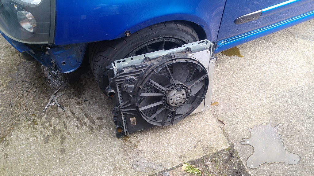

Mapping when I had to change the rad super fast.

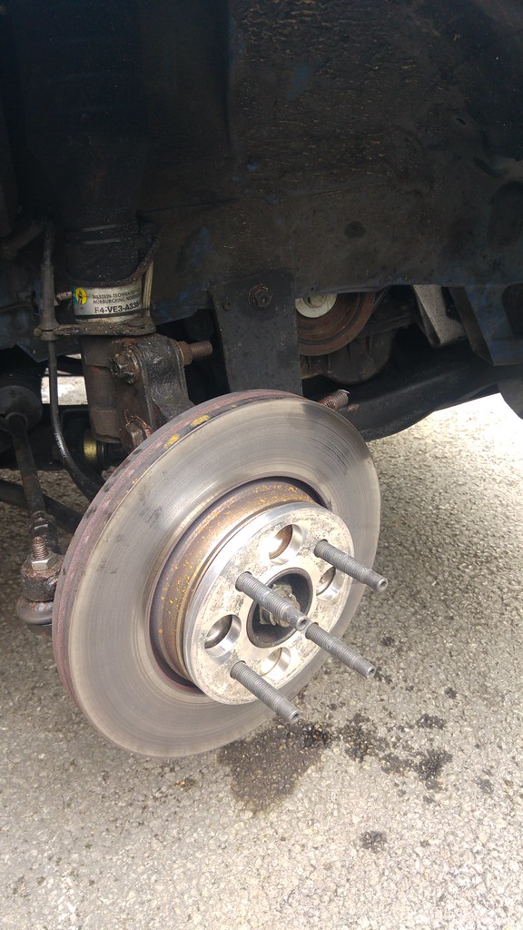

I also tried moving that hub and f**k me.............the bottom ball joint was barely hanging on. Perhaps that was my vibrating issue on track or perhaps that was the secondary failure mode. tightened it up and raised the suspension so i'll never know now.
I must say, using my ex's tights was the best thing ever for coilover covers. Simply unsnipped the cable ties and peeled back and the adjusters are SO free. Good idea. Also really good for prancing around the house in when you're so so alone.

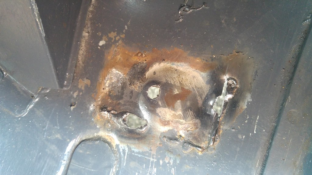

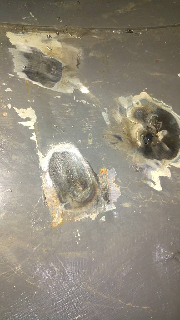

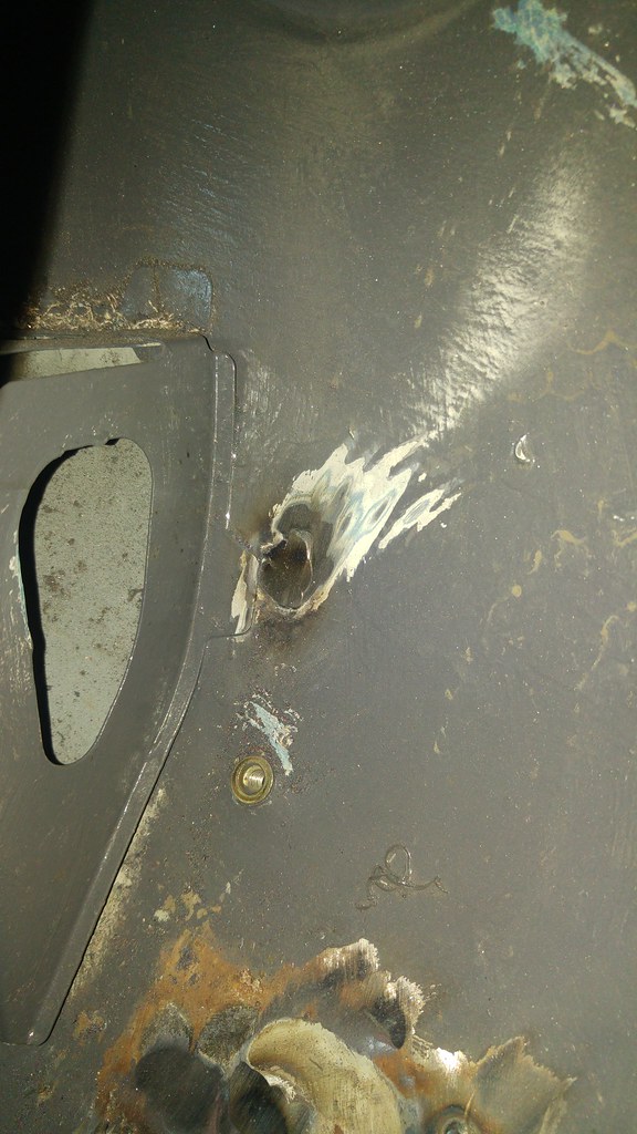

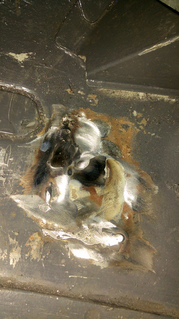

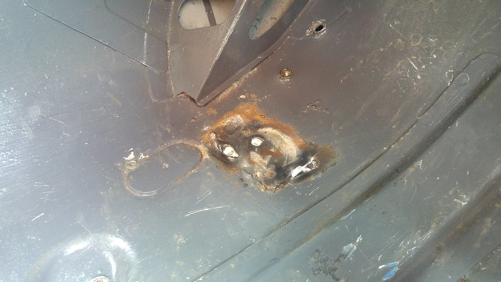

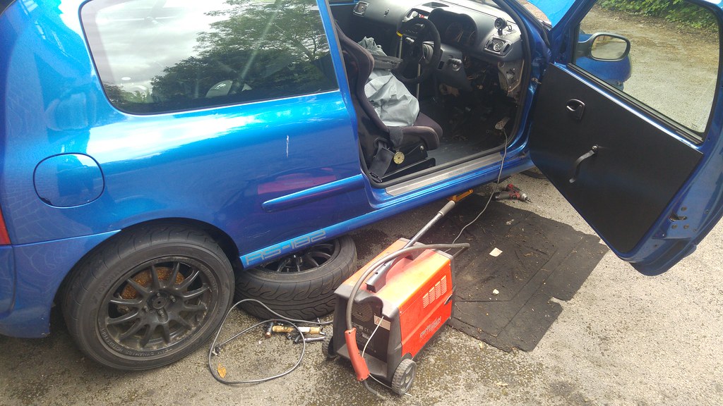

Then yesterday was ace. it involved welding which I'm always scared to do on my car.
20180512_124309 by dann2707, on Flickr
So my gym and old biking mate came around to try this cool welding technique. Basically, when I fitted the pedal box I used box section welded to the footwell, removed that and left some disgusting holes. This technique involves holding a piece of copper or alu behind the hole (weld wont stick to it) and allows the hole to be filled in. safe to say it worked f**king amazingly well.
Befores:
20180512_124316 by dann2707, on Flickr
20180512_124321 by dann2707, on Flickr
Afters, does need sanding back a bit more but the holes are gone so it's all good.
20180512_155454 by dann2707, on Flickr
20180512_155459 by dann2707, on Flickr
20180512_155507 by dann2707, on Flickr

So I got my brakes back from the powder coaters on Wednesday. Definitely the best £30 i've spent in a while. I'm trying to fathom how they even made money from it as they popped the pistons out, sand blasted and powder coated them and the finish is excellent.
This was before. @leeds2592 this is all your fault. He kept reminding me how badly painted they were you see... haha
20180428_111611 by dann2707, on Flickr

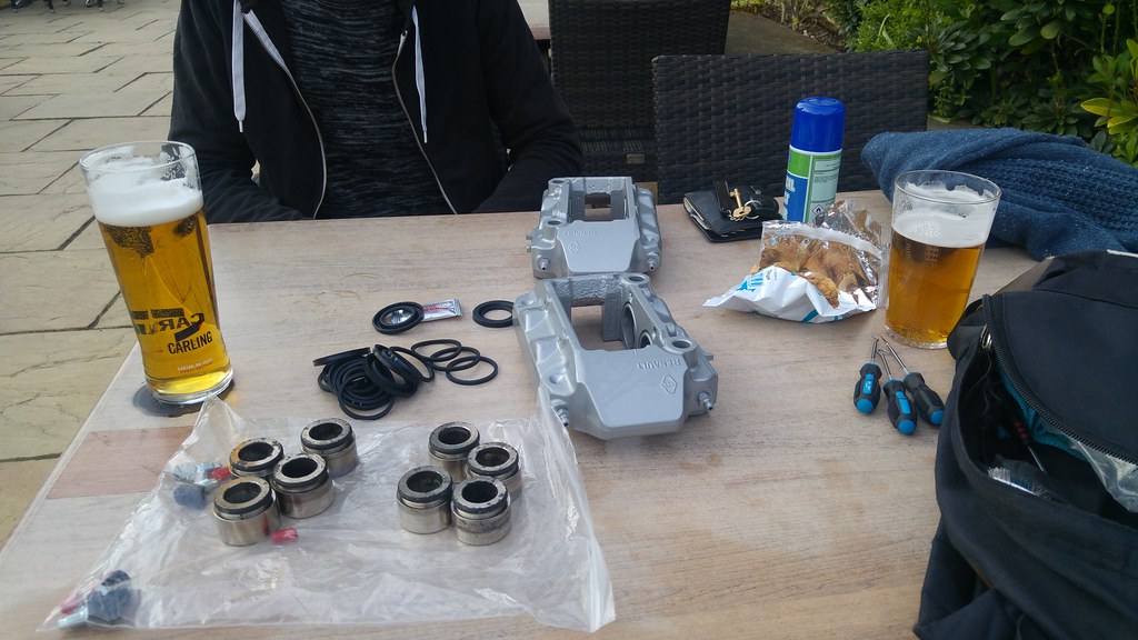

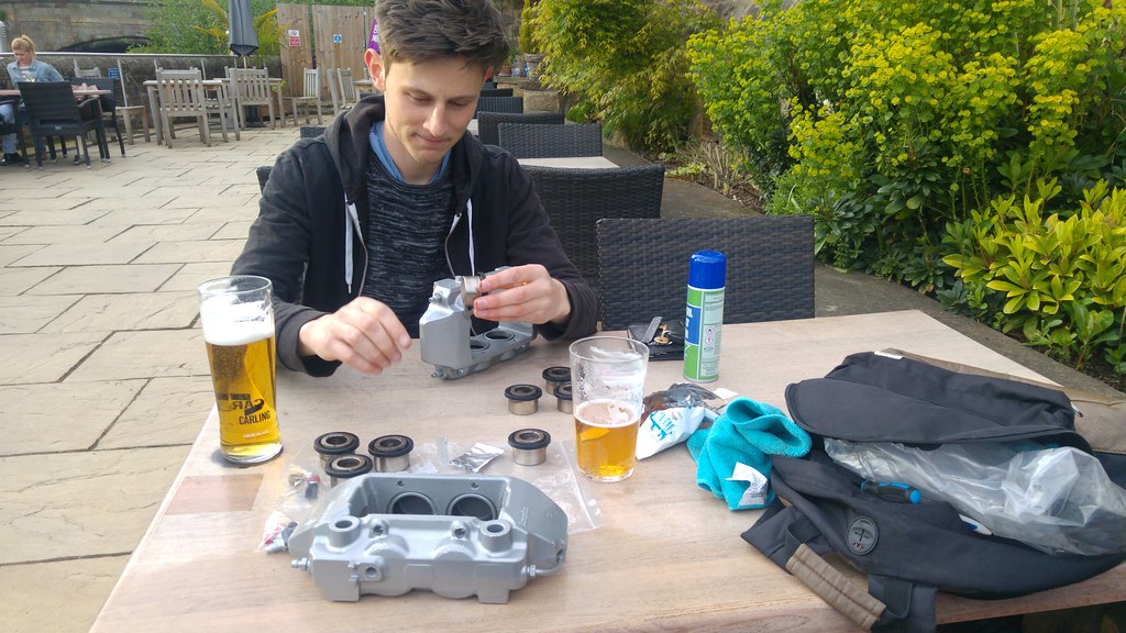

So that night I needed to get them rebuilt with the new seals but I also needed to go to the pub to see @James172C and @Panda sooooooo let me introduce a new fun game and it's called re-building 4 pot brembos at the pub
20180516_192917 by dann2707, on Flickr
20180516_194040 by dann2707, on Flickr
All on with new stickers
20180517_195235 by dann2707, on Flickr

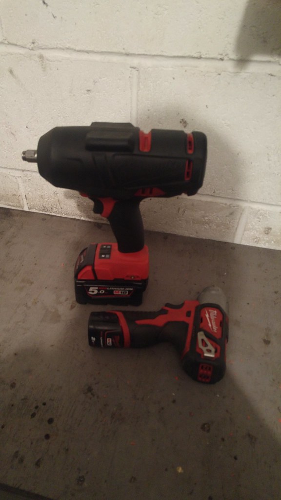

Yesterday I went to @leeds2592 's house to do some maintenance work on his car
That went really well. I'm hoping i've convinced him to get an ugga dugga after these absolute beauties coming into their own. Can't stress how much I love the combo of them together. One for running bolts, one for undoing pretty much everything you can throw at it.

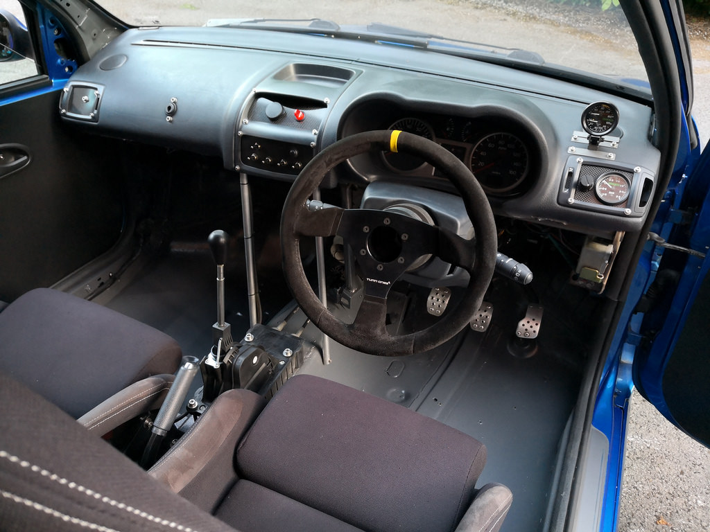

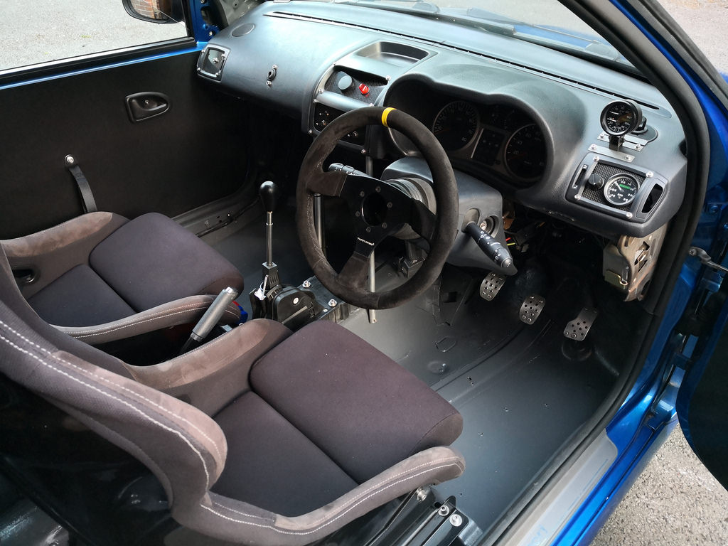

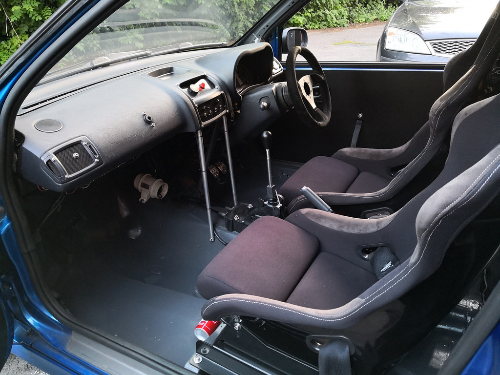

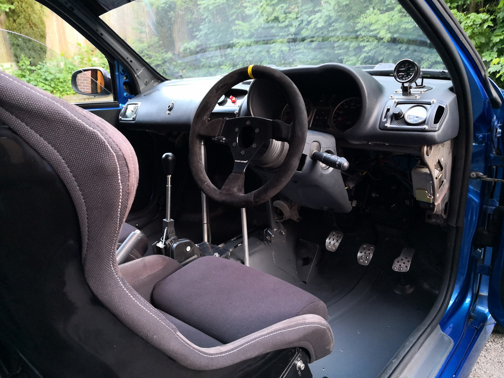

Today I repainted the driver and passenger footwell as I had welded it up recently so was full of.... no paint.
Also hoovered and cleaned the interior. Took some pics. Mega happy with it now
