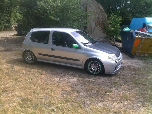

So a year has now passed, and during the summer a Friend bought a Ph1 172 from PH and we done a few trackdays in it. He offered me the car and I thought about it but didn't want it, after another couple of trackdays I knew I wanted it.
So, it had had a couple of members as owners on here I believe, and had been confirmed it was a freak of an engine with 184 bhp, proven a couple of times on reliable rollers at SRR. The car was basically where my first was at before it got Supercharged. This was now my 7th Ph1 172!

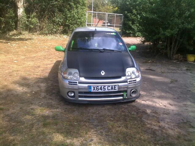

So, I got it home and first changed the wing mirror covers!

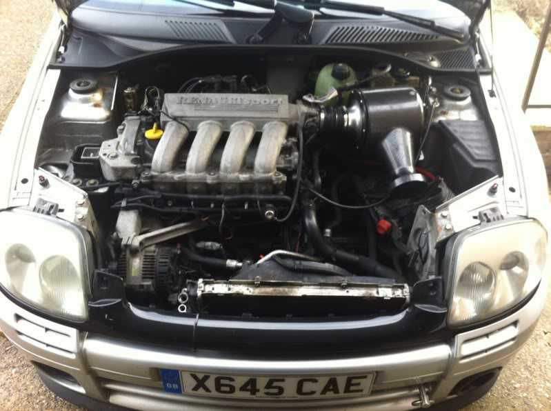

The Spec of it was;
ITG Maxogen
YozzaSport Race System
182 Exhaust Manifold
Matched Inlets
Group N Pops & Bangs map
Gaz Coilovers
Ferodo DS2500
Brembo HC Discs
OMP Rollcage
Sparco Bucket Seats
TRS Harnesses
Aluminium Bonnet (wrapped in Carbon Fibre)

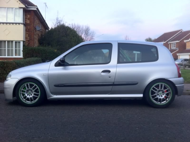

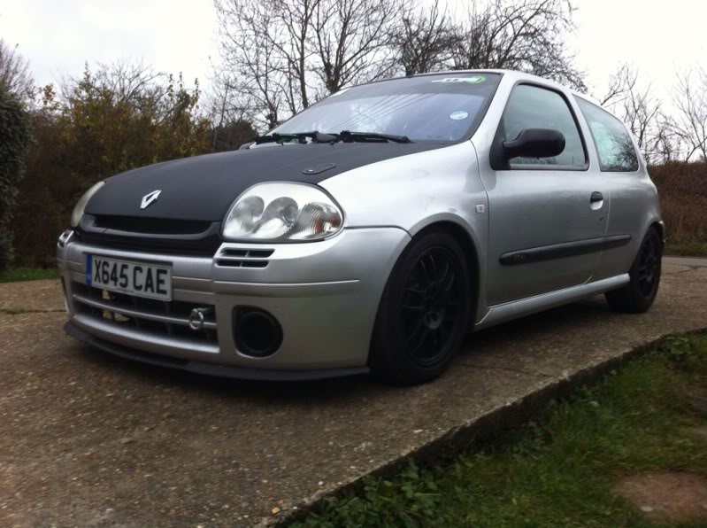

I wasn't keen on the CF wrap bonnet, but with it being a rare Aluminium I kind of stuck with it. The GAZ coilovers were also not great for what I wanted, they were good for lows but not track work.

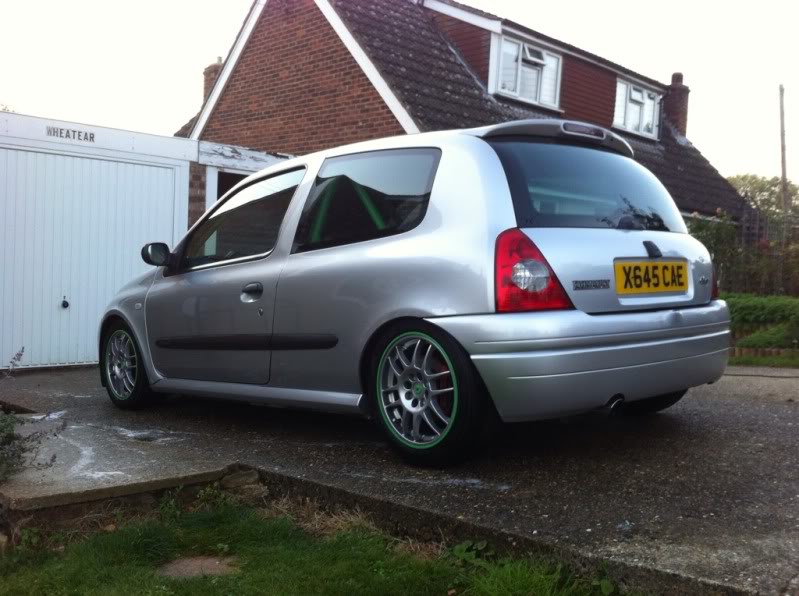

Sitting far too low
So I got a second hand set of FK KonigSports from .Kev. on here, have had these on 2 others I've had including the original SC'd one. Excellent Coilovers. Anyway that got the suspension sorted and sitting at a decent height/stance again. I also found some AeroCatches I had had under my bed for 3 years so got these fitted and removed the bonnet mechanism and bits. Also had a battery box ready for another car from before that I hadn't used so chucked that in the back too. Still need to wire my fuse in.

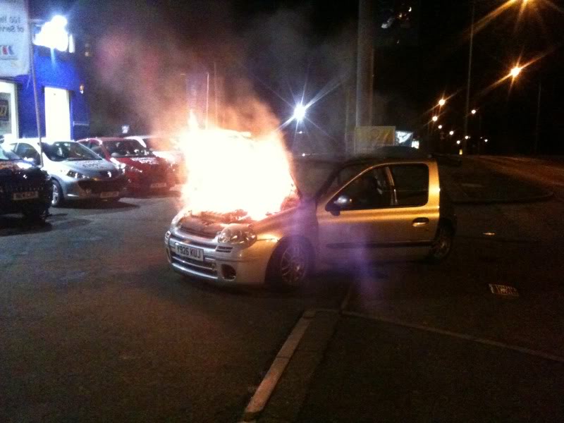

WHAT THE f**k HAPPENED TO THE 1st?
Apart from setting on fire obviously.
The sound deadening behind the manifold caught fire, it dropped onto the manifold and started to burn. Then spent few months rebuilding it from nearly a bare shell. Then it failed twice so I broke for parts, missed it ever since :(

I like how when the car was on fire you parked it next to some new Peugeots lol.

Kev, it was actually next to a Shell garage, was the only place I could think of that might have an extinguisher!

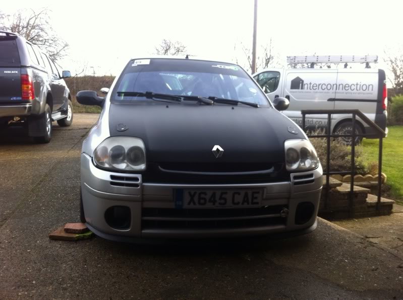

Got my 25mm wheel spacers fitted up today as well which makes it look a lot better, just need the tracking and alignment done, but will get new ball joints and track rod ends all fitted before then, will only be £40 odd quid, but fairly sure I've got a couple new bits in my old garage.

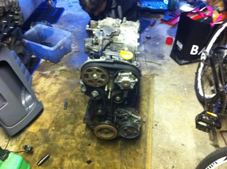

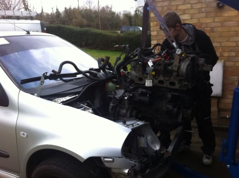

Got the engine out today, quickest time for me I think in just over 2 hours.
Got the loom and ancillaries off and onto the engine for now. Also checked Cambelt condition which I was worried about and it all looks ok and not as worn as I would of imagined.
It then got a little bit too dark so will put it back in in the morning.

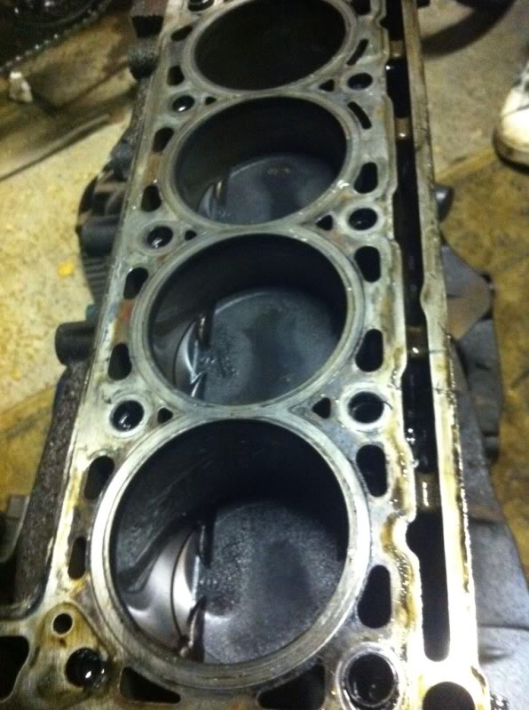

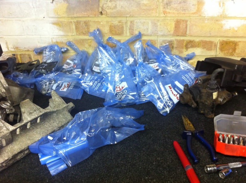

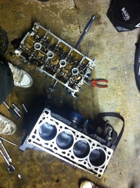

Old engine was fairly tired. Stripped all the ancillaries and bits off ready for powdercoating and labelled up all the bolts.
All the hone marks had gone from the bores, it was a mirror finish! No wonder I was losing oil

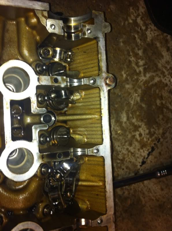

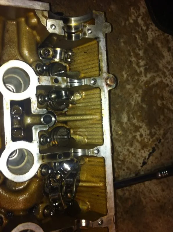

Also the head look like it had some scoring on the inlet cam journals, but it looked like they could be meant to be there. If anyone know what would be great. Also the cams were scored so that means I now need some different cams :)
Any one have a photo of a normal head with the cam journals showing these marks?

Yea the engine in pieces is the original one in the car. Possibly changing the block and head now though as I have one with hone marks still on and in good condition. And just need to find out about them scores in the cam journals

Will probably get engine stand setup tomorrow, I think the other block on there at the moment is bored to 83mm though :(

Could be wrong but those scores on cam journals are probably there to let oil down and round once cams in place
  SQ5
That's what we're thinking too but the cams were slightly scored too, and they seem to get bigger the further away from the belts side
