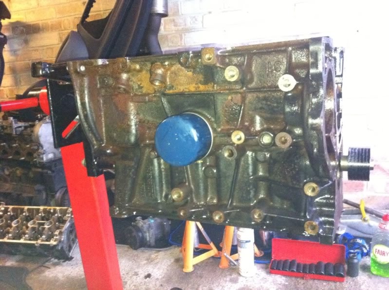

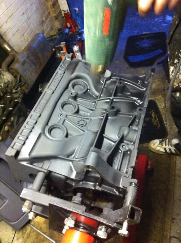

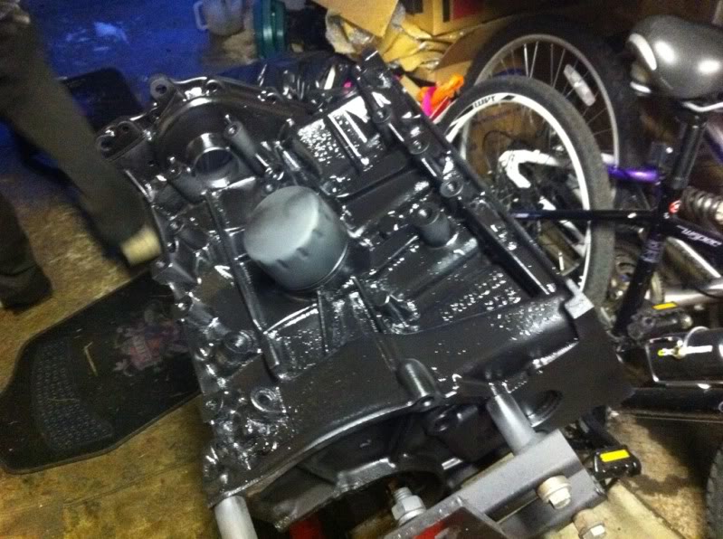

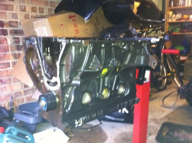

Went and got my engine stand today and decided to use the block already on there. Got it cleaned up an degreased ready for a bit of paint.
Then went for some black VHT and everything else will be powder coated silver
It's a pity the back of the engine looks the best!
Now just need to get some pistons, rods and bearings sorted out

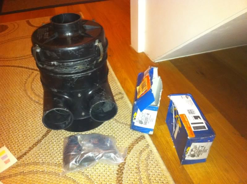

Post man has been busy the last couple of days.
Only a few serviceable items.
2x new ball joints
2x track rod ends I had from last build
1x Ph1 airbox and ITG filter to replace my ITG Maxogen (anyone want it?)
And also a CS delivery :)

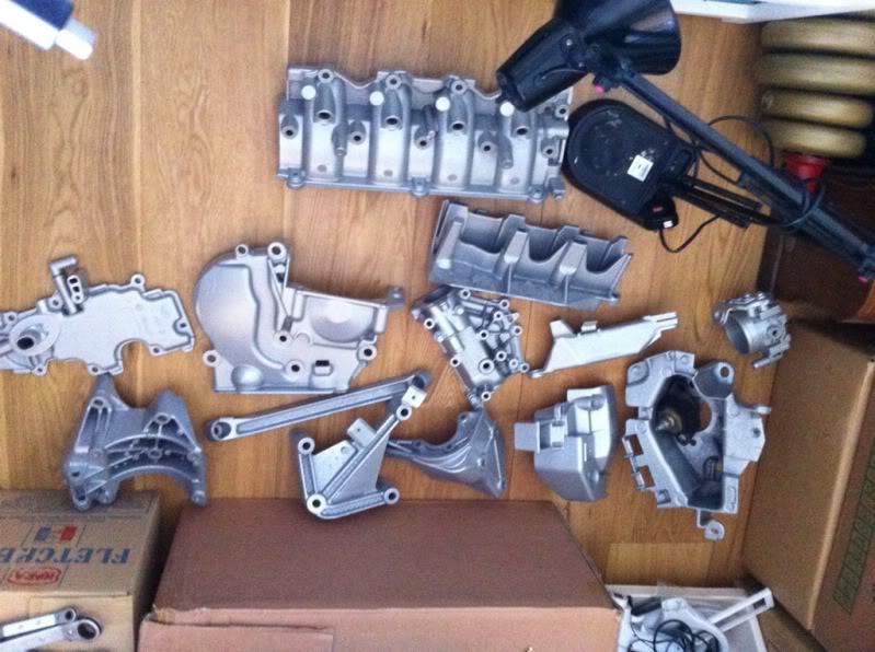

Gunk came today to do parts should powder coated next week!
Looks good Danny,where are you getting the charger and associated parts from,still want to charge mine just don't want to lump out 4k in one go.Was thinks of getting the charger from tts what FMI are you using.
I'm using a small intercooler, best bet is one from eBay. Try another company for SC, in Scotland, forget their name now. It's only TTS and this company that can sell them in the UK direct from Rotrex.

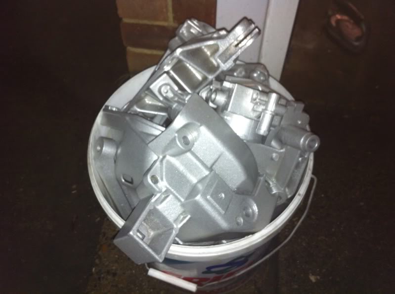

My parts came back all powder coated today. Sent them off Tuesday so quick turn around, luckily there were a load of bits need doing silver at my dads work ;)
Still a few other bits to be done as and when needed!

Had a bit of a clear out in the garage today and got my powder coated bits indoors and in the clean. Still a couple of brackets left to do just need a Cup alternator and brackets.
