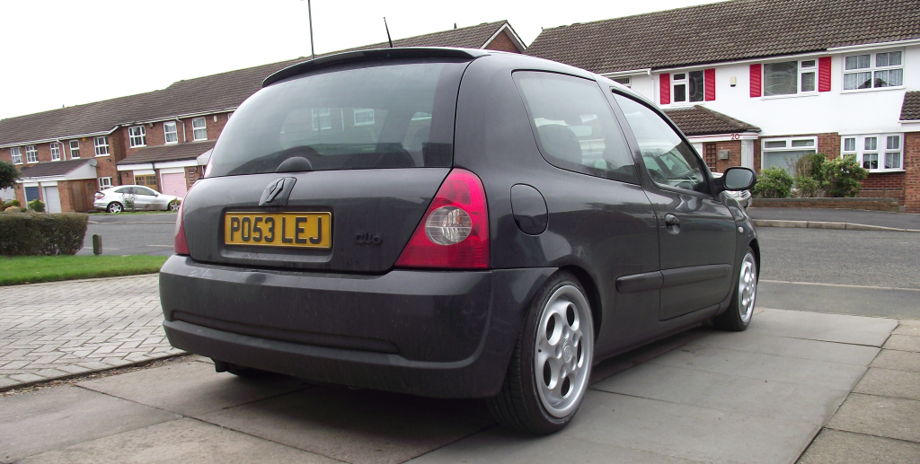

They will sit nice. This was mine when it was 7j et22
then added 15mm 2 dagree hub spacers making it et7. So you have room for spacers if you want.

ok they will sit a bit further out . has anyone had these wheels before on a clio and have pictures of how they fit?
  Clio 1.2 Mk2 Ph2
ahh so there not actually that bad thats how i want them to sit. almost on the arches as i have 60mm springs ready to go on aswell. cheers guys. ill really consider getting them

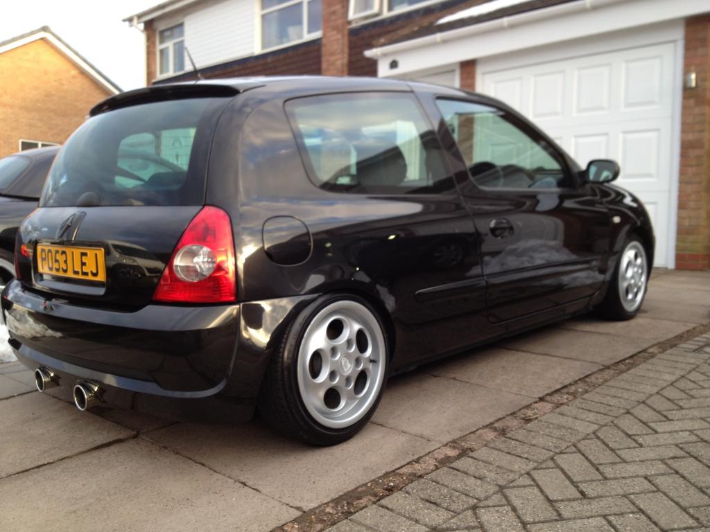

First pik was around 60-70mm rear didn't scrub. last pik is around 90mm rear and did scrub a little on large bumps. Thats with stretched tyres and rolled arches.
  Clio 1.2 Mk2 Ph2
awesome, thatll do me perfect. quite looking foward to doing this as its my first clio project. done other cars before. but only jap cars
