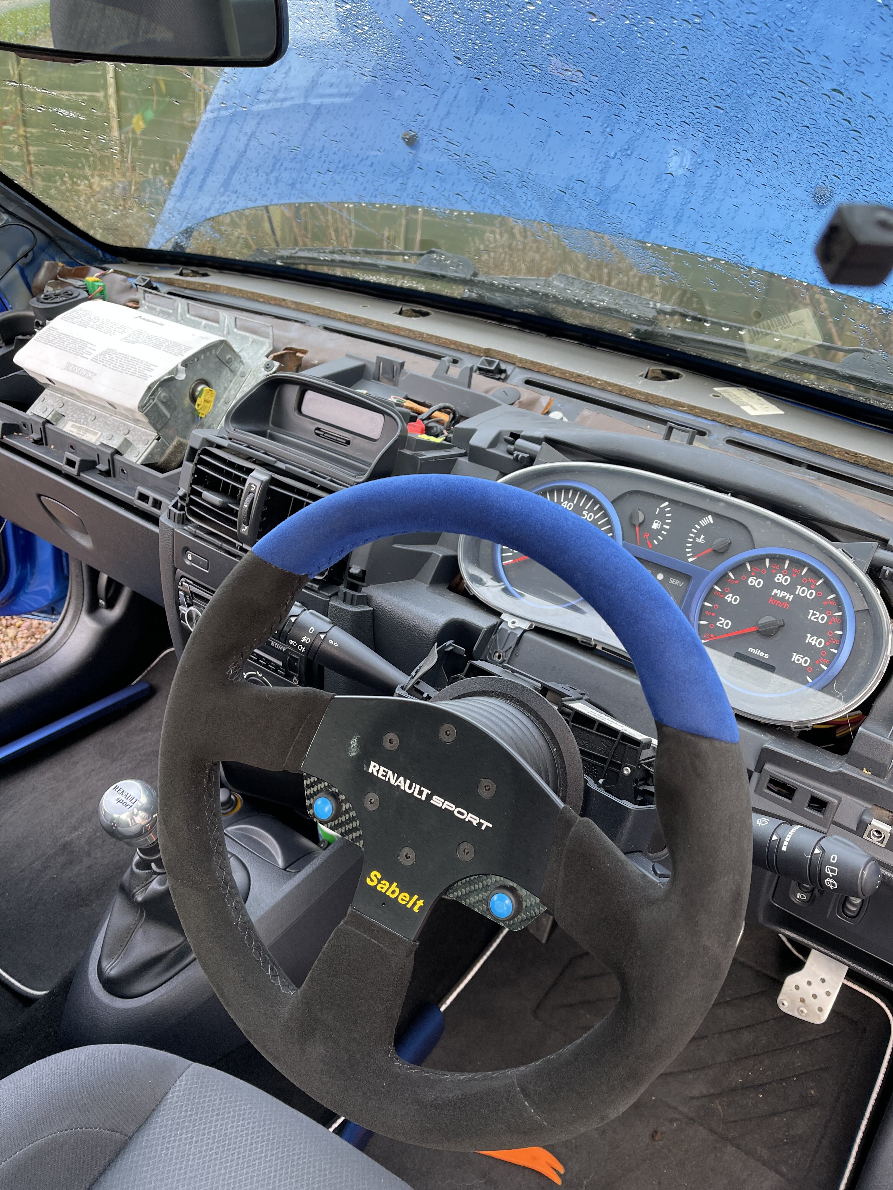

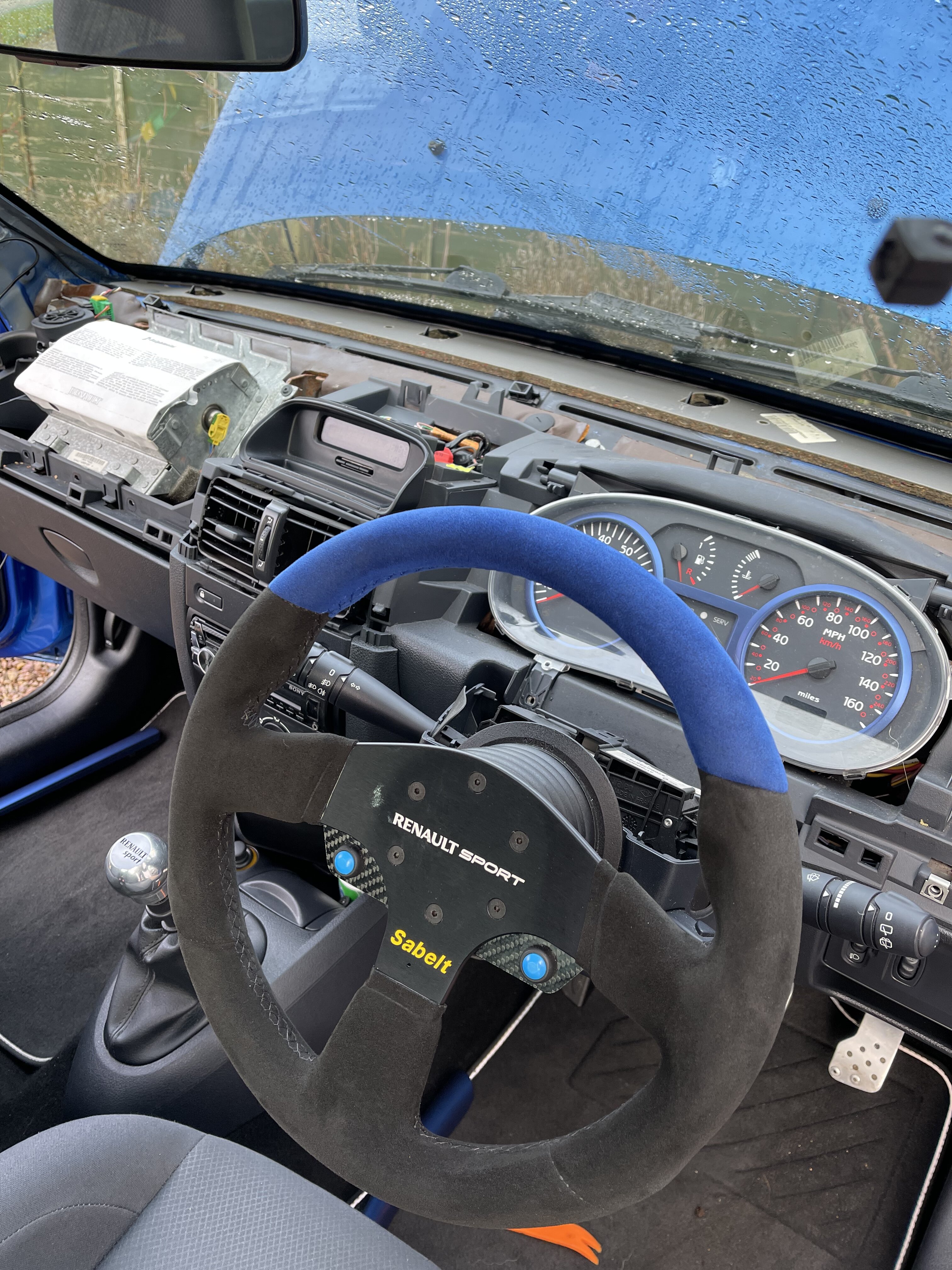

I only needed to fit new plastic slats in the air vents and by removing the top dash, this exposed the air vents.
  Clio 172 Cup
So you replace the slats the whole vent? The vertical arm has snapped in two so only one half of the slats operate
I think you can buy the slats/individual bits separately instead of replacing a whole vent.
For me, a couple of my slats had pulled out from attaching a phone mount + weight of my iPhone. They weren’t actually broken, I just needed to put them back in which is a really fiddly job lining it all up with the vertical arm etc (and the top dash needs to come out to provide more access).
