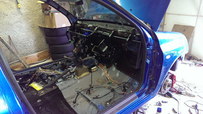

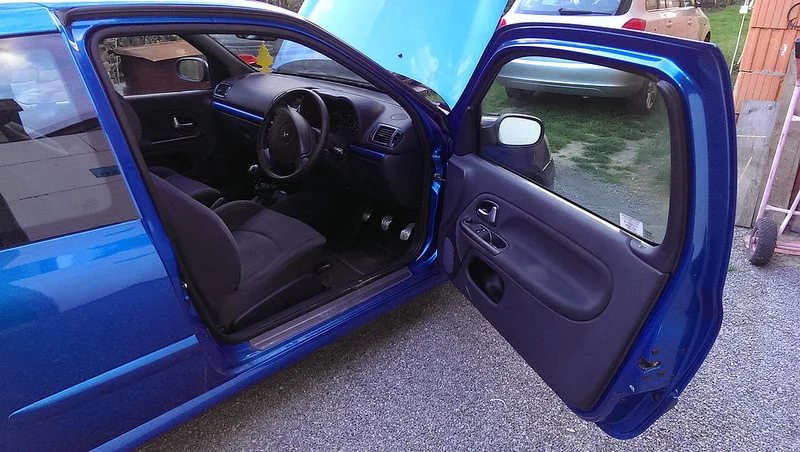

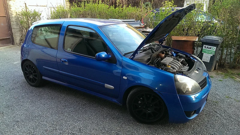

in 2015 a car appeared in the Czech Republic for sale, in a terrible condition.
Still, I bought him for about 1100£ , with the idea that it will be a toy for a trackday. I live in Brno, Czech Rep, 15 minutes away from Grand Prix Circuit, so ideal :)
All modifications arise in my head and at home

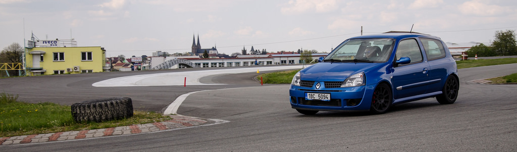

first photo in 2015
And this season

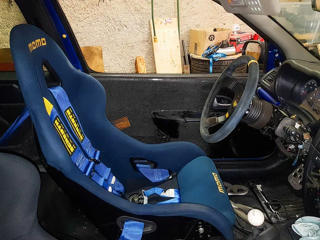

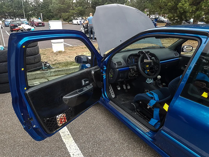

I will try to list the car's modifications:

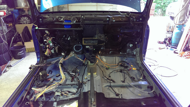

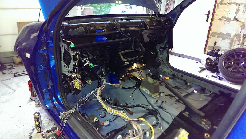

RHD > LHD conversion
Removing AC & HPAS, instal EPAS from clio DCI
weight rediction ( 940kg )

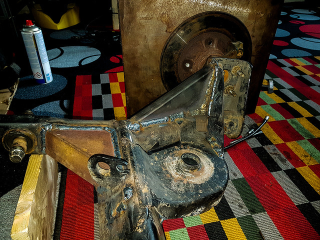

Rear axle with bearing kit + stiffening by metal profile

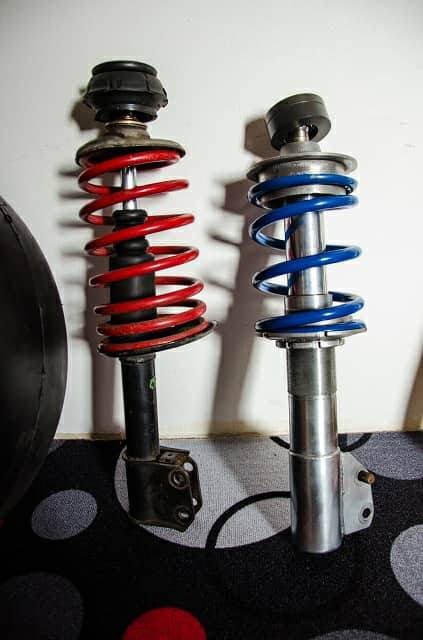

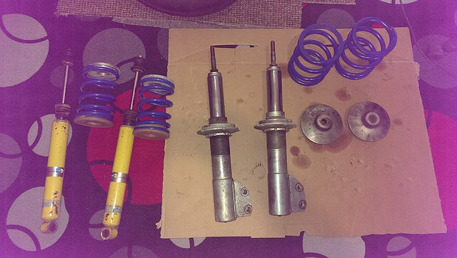

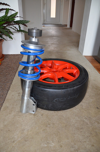

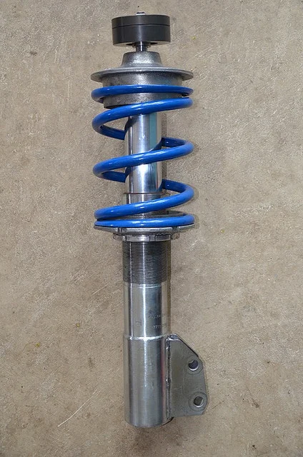

Suspension Bilstein Gr. N with asphalt spring, and B14 in box.

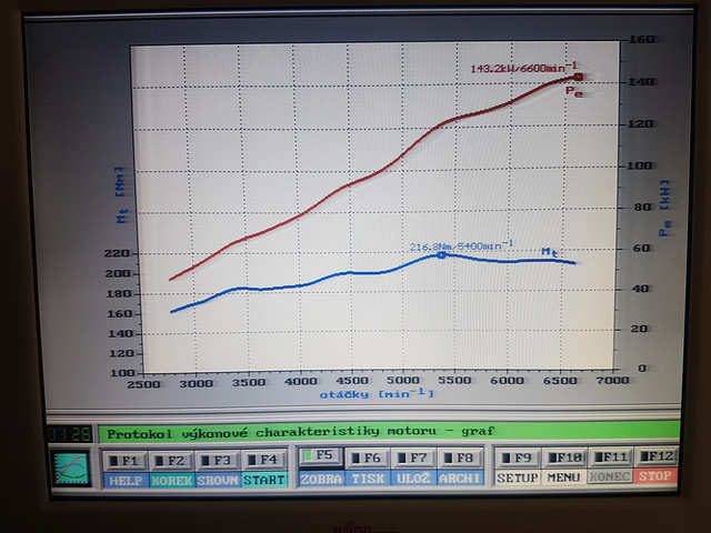

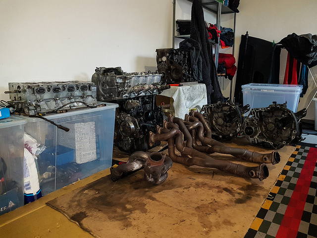

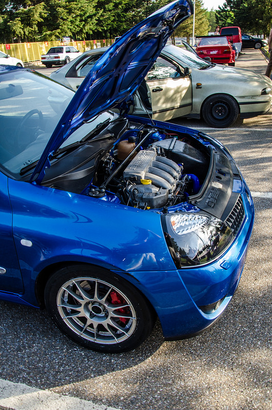

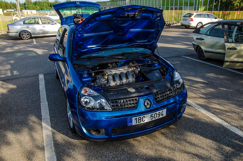

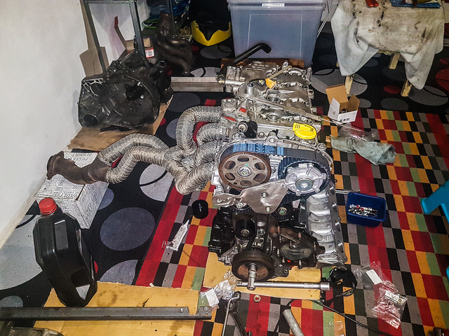

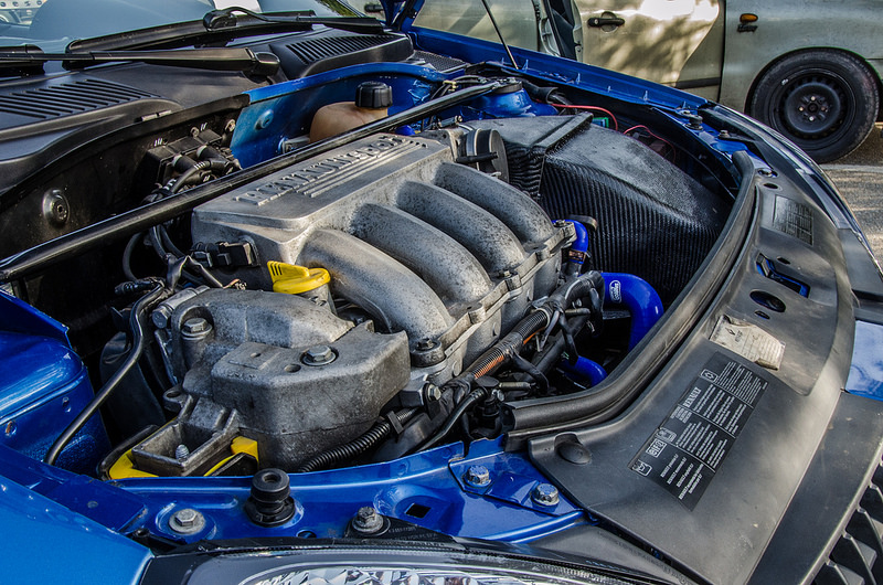

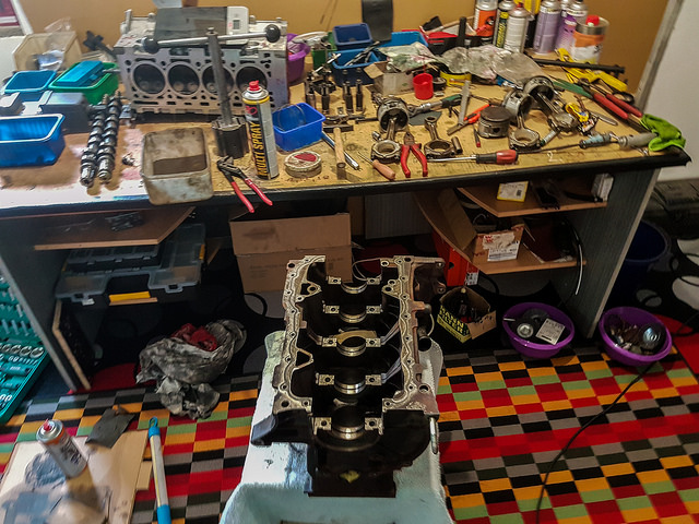

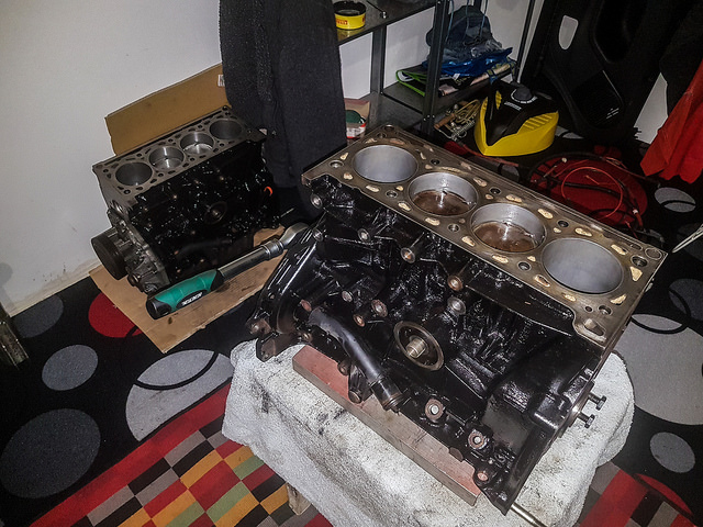

engine with modified head, ported canals etc - 143kw/216Nm
4-2-1 exhaust manifold

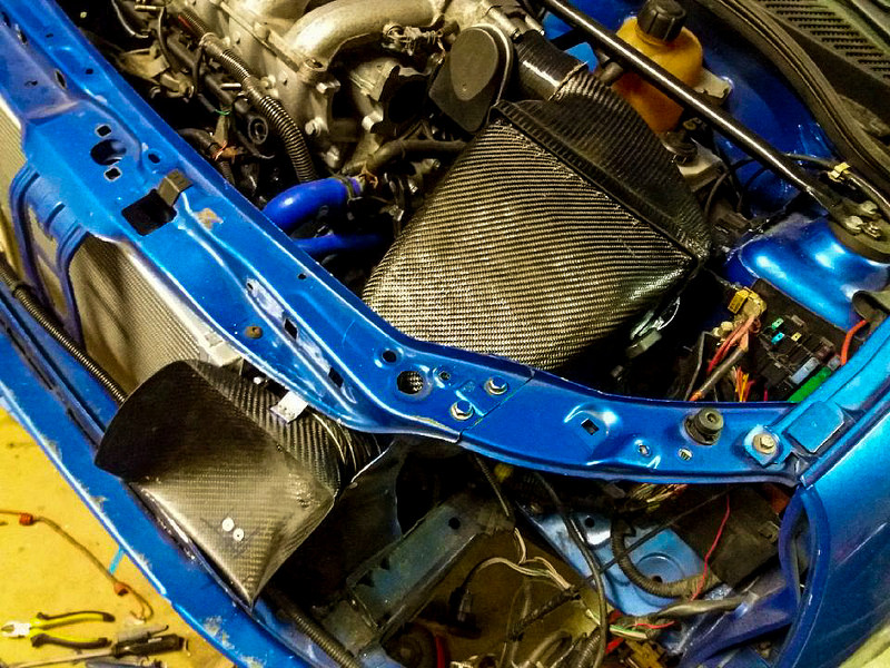

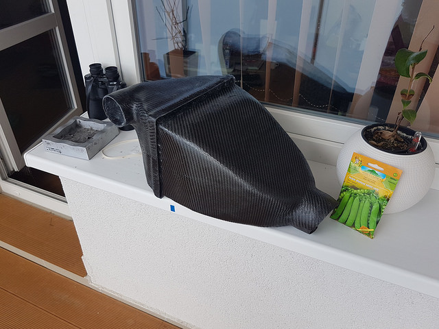

Homemade carbon airbox
alloy radiator
relocation battery, ecu, coil

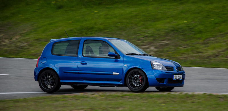

Turini 16 road
Ultralleggera 15" witch slick
Evo Corse X3MA 15" with rally slick for small track

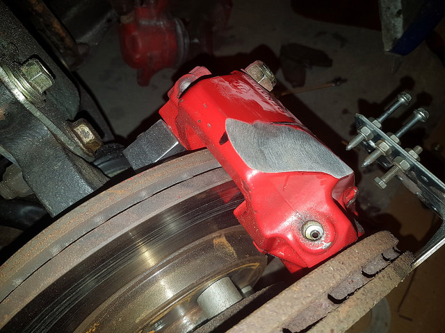

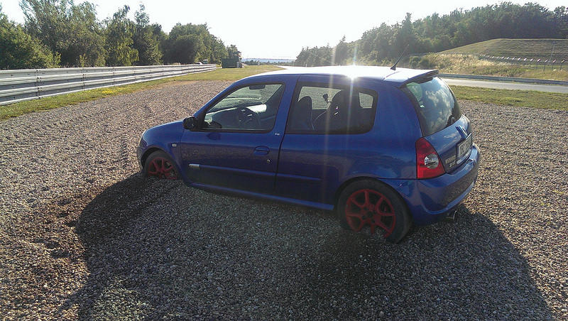

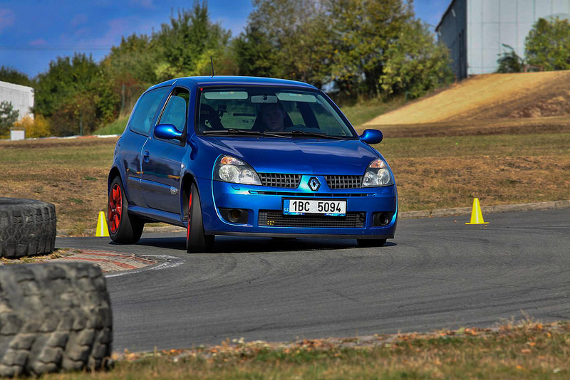

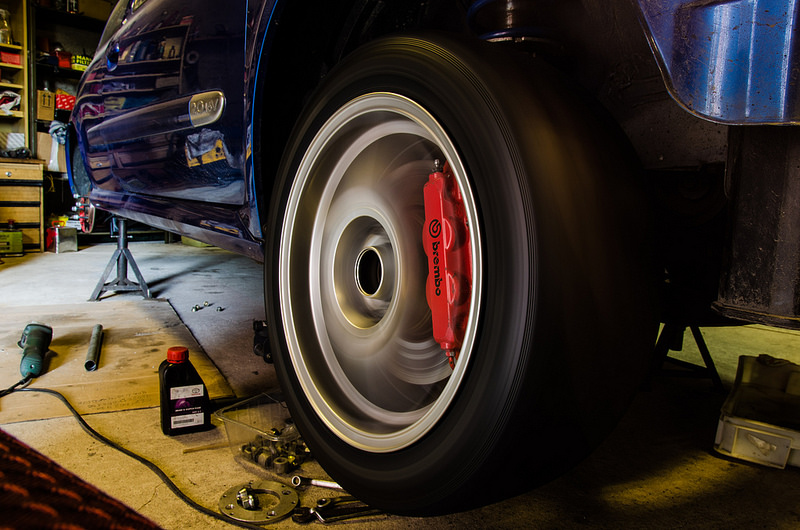

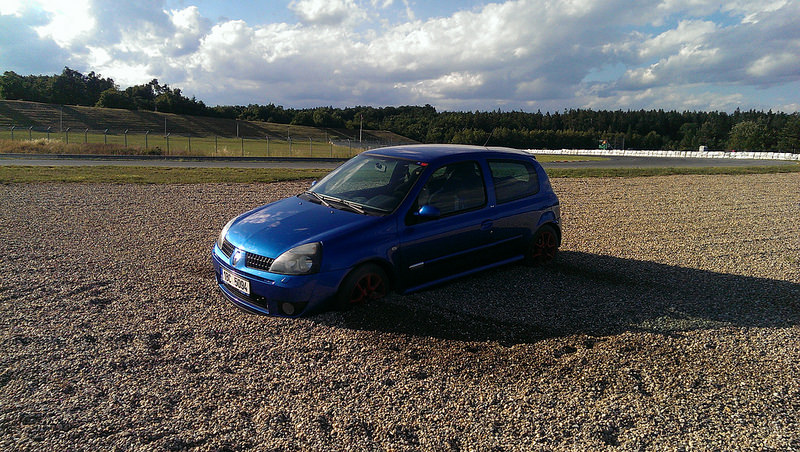

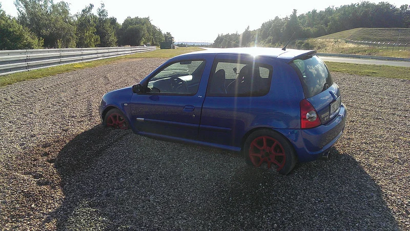

The first year I had red track wheels, and always had problems with the brakes. High temperatures, high wear etc ...
At the end of the season on timeattack I ended off the track, and had to buy better brakes.
usual choice - twingo R2 Brembo gravel 280mm set
Brembo monoblocks were abraded, to fit wheels without pads

Does you 172 cup lower inlet manifold have RS stamp on it?
If so did you fit that or did it come with the car and what year is the car please?
It seems some 172 cups got RS lower inlets and some did not.....
  Clio 172 Cup
Thank you, it's never ending work :)
Yes, I have the RS lower inlet and car is 2003
But i would like to try inlet from Clio 197 to F4R736 this winter, can you recommend this? Will this change have any benefits?

I have no idea, my car is a 52 plate and does not have RS lower inlet, so I have ordered a lower RS inlet from ebay to try.
