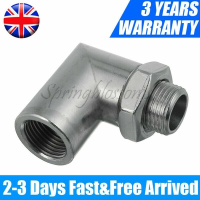

Spacers are cheap and work. But obviously rely on the sensors still working.
90deg spacer works for most of the time. Worth getting it mapped though.

These are a good style as I've seen some that are just a straight thread. Was wondering if they arent keyed properly theyd end up perpendicular to the decat 😂
